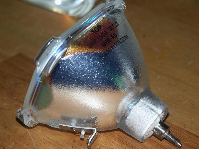

Video Freak said:I was looking through ebay today and found a seller that sells the lamps/reflector for lcd projectors. Just the lamp no cage etc. Anyway the interesting thing is he says for instance 120 uhp projectors can use the 150 w UHP Bulbs and since they are being underpowered will last many more hrs . Sounds interesting and I am wondering about this but dont have the confidence yet to try it( I would just hget the 150w one from YWH By the way. Any thoughts???? Here is a Ebay link for a example 5842299522 PS NOTE IM not saying BUY THIS LAMP FROM THIS EBAY SELLER................IM just using it for information........ 😎
yes,120 uhp projectors can use the 150 w UHP Bulbs and since they are being underpowered will last many more hrs .

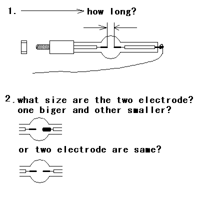

you need a JYD250w,but give me a pic of your originally lampe,the pic of two electrode in the bulb.

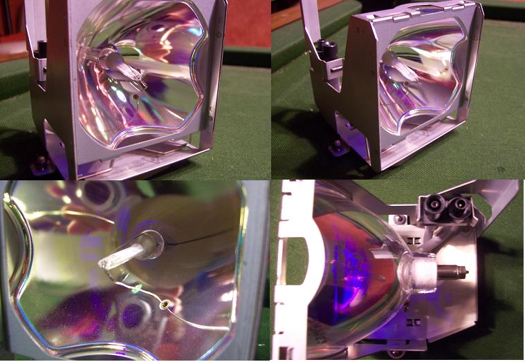

Good luck!chasse said:Got my new 120 watt UHP lamp from YWH,i have installed the lamp in a commercial projector with very good result.The reflector is very small,about 1 1/2 inch diameter but the lamp fit very well,i had to make a small 1 inch hole on the back of the projector to make it possible .
My projector is very small ,7 inches wide by 6 inches large, 2 inches high. OLYMPUS VP-1 ,1024 *768,1000 lumen with 2000/1
contrast ratio.I can't see the difference with the original lamp,the result is incredible.
Thanks to YWH and 18wheeler for their support.

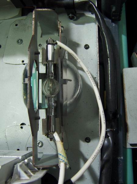

messiah22 said:Hi all!
That's my first post and I have a few question to YWH and 18wheeler. Recently I've bought an ASK IMPRESSION 960 projector. It is not a modern one, but got it rather cheap. It uses MH 575W GS dual ended bulb. Bulb has 750h lifetime and still has 300h left. After it burn out i wonder what would be better:
1. Modify projector to accept metalohalogen lamps (eg.250W HQI lamp approx 23000lumen 8.000h life time) Would the picture in this case become too dim?
2. Find a cheap 575W bulb - i found one at you store around 40bucks. But - I live in Poland. Would it be a possibility to sent this item to Poland? Do i have to acquire paypal account or maybe any other methods are to make a transaction?(These Bulbs in my country are for approx 180bucks)
Last question is - when my lamp reach end of its life - 750h - should I uncoditionally remove it or can I use it longer? In other words - will it explode and damage my projector or slowly fades to black??
Thanks in advance for replying
http://www.projectorcentral.com/ASK-IMPRESSION_960.htm

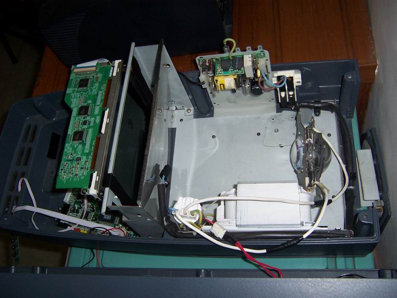

I have ASK too.
you can get a 575W bulb from 18wheeler,it is a HMI.
or like me, set a 400w UHP. 1500Hr at least.
the 575W HMI is bright but hot too! I think I dont need this bright, sometimes, the image is a vast expanse of whiteness,the light is supersaturation.
happly Chinese New Year! every one.
ASK rule, indeed 😀
on your pics - there is a 400W UHP bulb in projector?? look like 575W bulb... did you simply place this 400W instead 575W with no modding??
Otherwise - what will I need to do to mod my ASK to accept lamp like this? (400W UHP) What with electronic and tft - isn't it set to detect 575W bulb and run only with that lamp?

Hi!
messiah22
I simply place this 400W instead 575W with 400W ballast of HQI.electromagnetic ballast.
I give up 575W bulb .
there are two way to choose,1,575W HMI,simply place . 2,400wUHP with 400W ballast of HQI.electromagnetic ballast.

that is JYS200w,but AC or DC?test it.
http://www.projectorcentral.com/Epson-ELP-3000.htm
that is JYS150w,but AC or DC?test it too
Give me the pic of your bulbs.

single ended version is OK
JYs 250W DC bulb is OK too.
but answer my questions in the picture. and test the V of your lamp.
