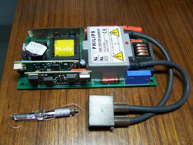

150w jyd AC lamp and the ballast

Re: 150w jyd AC lamp and the ballast
My projectot takes a 150W shp lamp. Will I need the ballast or would I be able to just use the JYD lamp straight from the internal transformer of the projector. Also If I do need a ballast, I really want to know how much that cute ballast and lamp kit would be and to ship to UK.
By the way, how many hours do you get out of the JYD's????
if your Original ballast is OK, you would be able to just use the JYD lamp straight from the internal transformer of the projector.
what model of your projector?
I'ts 11.00am here in the UK now. So these lamps are UHP/SHP and not metal halides, so my infocus ballast should operate these lamps without a problem I take it. So what is the minimum order to the UK and how much per lamp.The UK voltage here is 240V.
Also do these have restike times? and why are they called JYD lamps?
the price of jyd is 85$ each, minimum order is ONE, pay to 18wheeler .
you dont bother the voltage if you dont need replace ballast.
