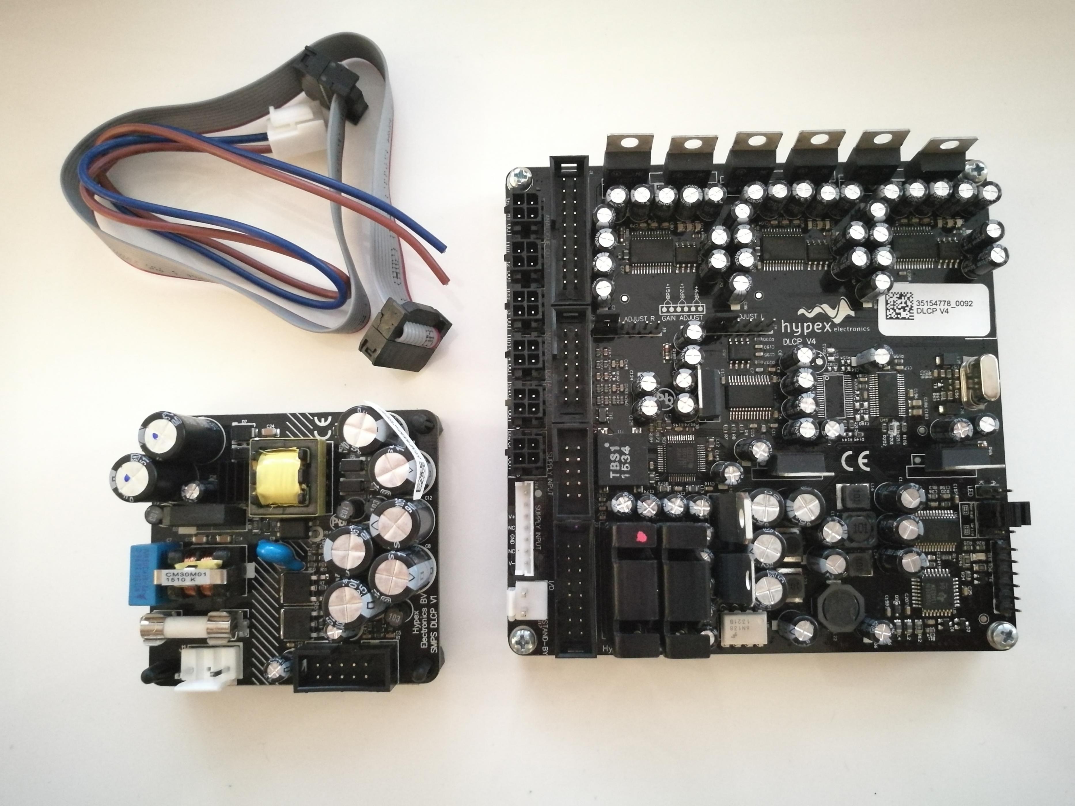

DLCP has arrived.. 🙂
Now it's time to do proper wiring.
I wont use official MOLEX connectors for outputs (I can't find them in my country) so I should find some nice way to connect all theese small parts..
Hope I'll do it before New Year so I'll post some pics during the progress.
