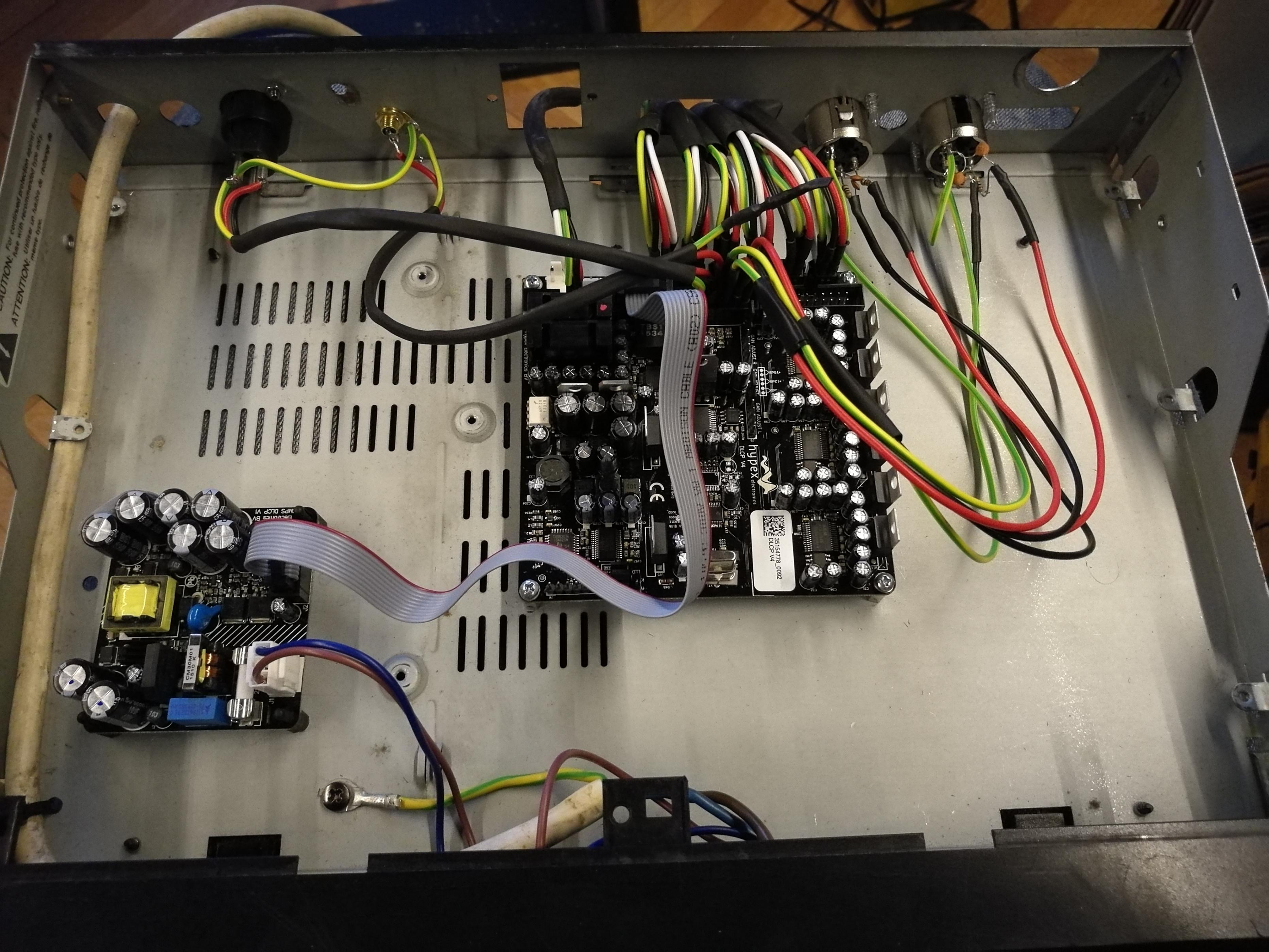

Finally I finished my DLCP.. 🙂 (its just test box from some old satellite receiver)
I did some 3 way configuration but I still have a couple a question:
1. When I put some 2nd order LowPass and HighPass filters at frequencies that I previous had use, I'm getting big holes in crossover range. OK, I read from the manual that I can combine two second order biquad and get 4th order crossover but there are only examples and calculations for Bassel and Butterworth filters.
So, what do you suggest to use as crossover filter? Previously it's been Linkwitz–Riley 4th order and it was OK, the same freq for Lowpass and Highpass, without any holes in that region. Can I use Linkwitz–Riley filters and if I can, how?
2. After first measurement (of left sub driver for example), I get some magnitude and I want to correct that magnitude to be the closest to flat response, so I use filters. Do I need always to send filters to device to check my correction or there is some way to put all filters which will apply to measurements without always sending to device, and just to send them at the end of correction?

1. If you get a big dip, you may have to reverse polarity or adjust delay on one of the drivers.
You can use whatever crossover topology you wish I guess, ït's a DSP 🙂
To make higher order filters just add a biquad, two 0,71 Q filters make up a 4th order LR filter i belive.
When you choose the HP2/LP2 option you can adjust the Q to Your liking.
2. You may make several adjustments and send them all at the same time to the DLCP. But it's advisable to send one at a time and check with a measurement sweep.
It will give you more control when making adjustments to your speakers.

Thank you for explanation! Now it's obvious where I made a mistake(s)..🙂
