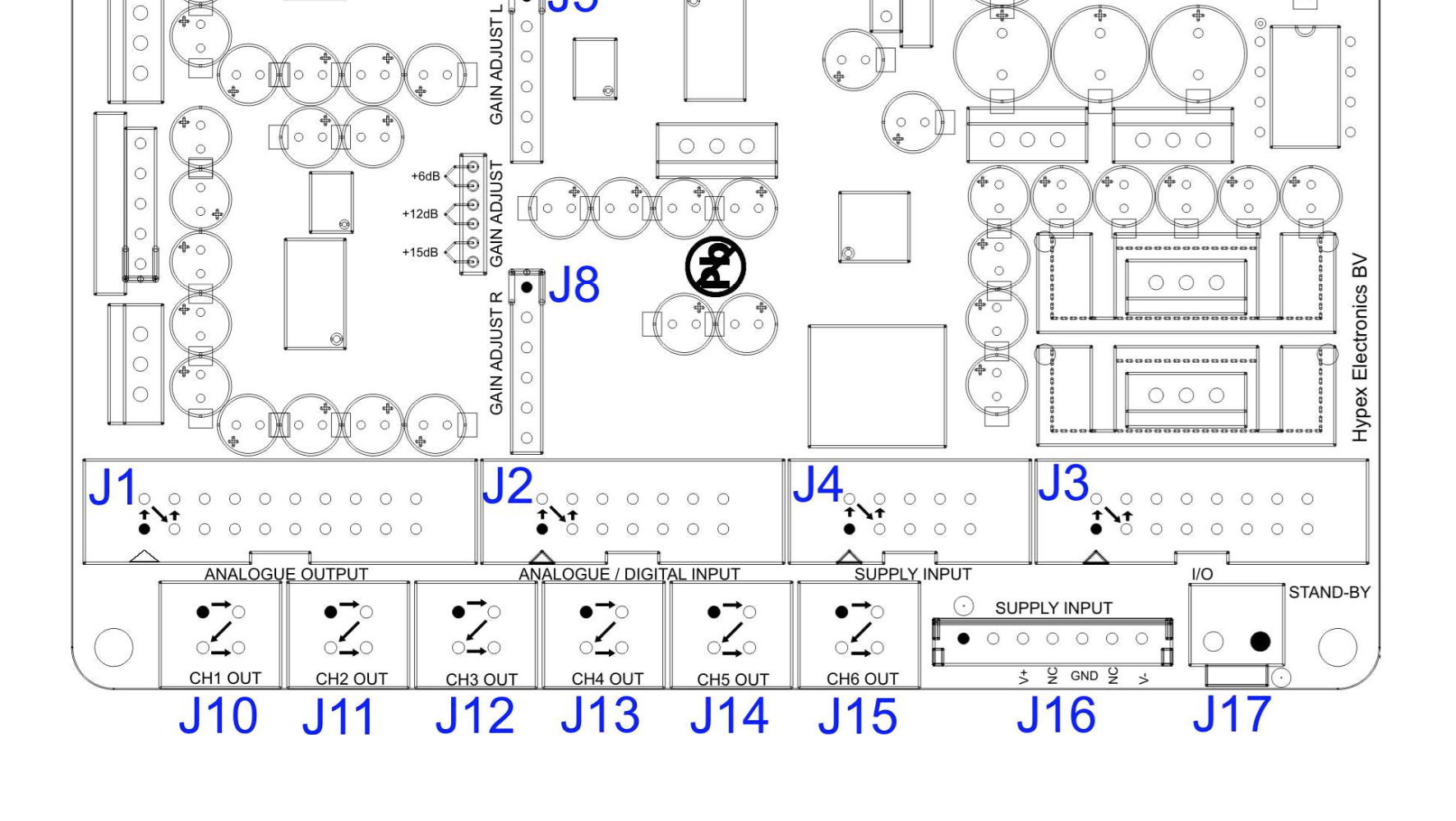

I'm considering purchasing a DLCP to use intergrated with my UcD modules for a 3 way xover so over the past few weeks I've skimmed through the 145 pages of this thread and the DLCP manual as best as I can understand it, but have a couple of tgaps to close out.
The DLCP addon is essessive for my requirements which are digital inputs, volume control and USB input for programming the DLCP. However, I'm somewhat stuck on what I actually need if I don't go down the DLCP addon route.

1. J2 I/O socket lists pins for SPDIF, AES, Optiical etc.
3. USB - is marked as pins 5-8 of socket J3. Is this as simple as wiring a USB2 plug to these 4 pins?
- Does this mean the DLCP takes care of conveting to each format?
- Do I simply wire in the appropriate jack to these or is there more to it? Does anyone have an example they could share?
- I read the digial inputs are autosensing. Does that mean it doesn't require a source selector?

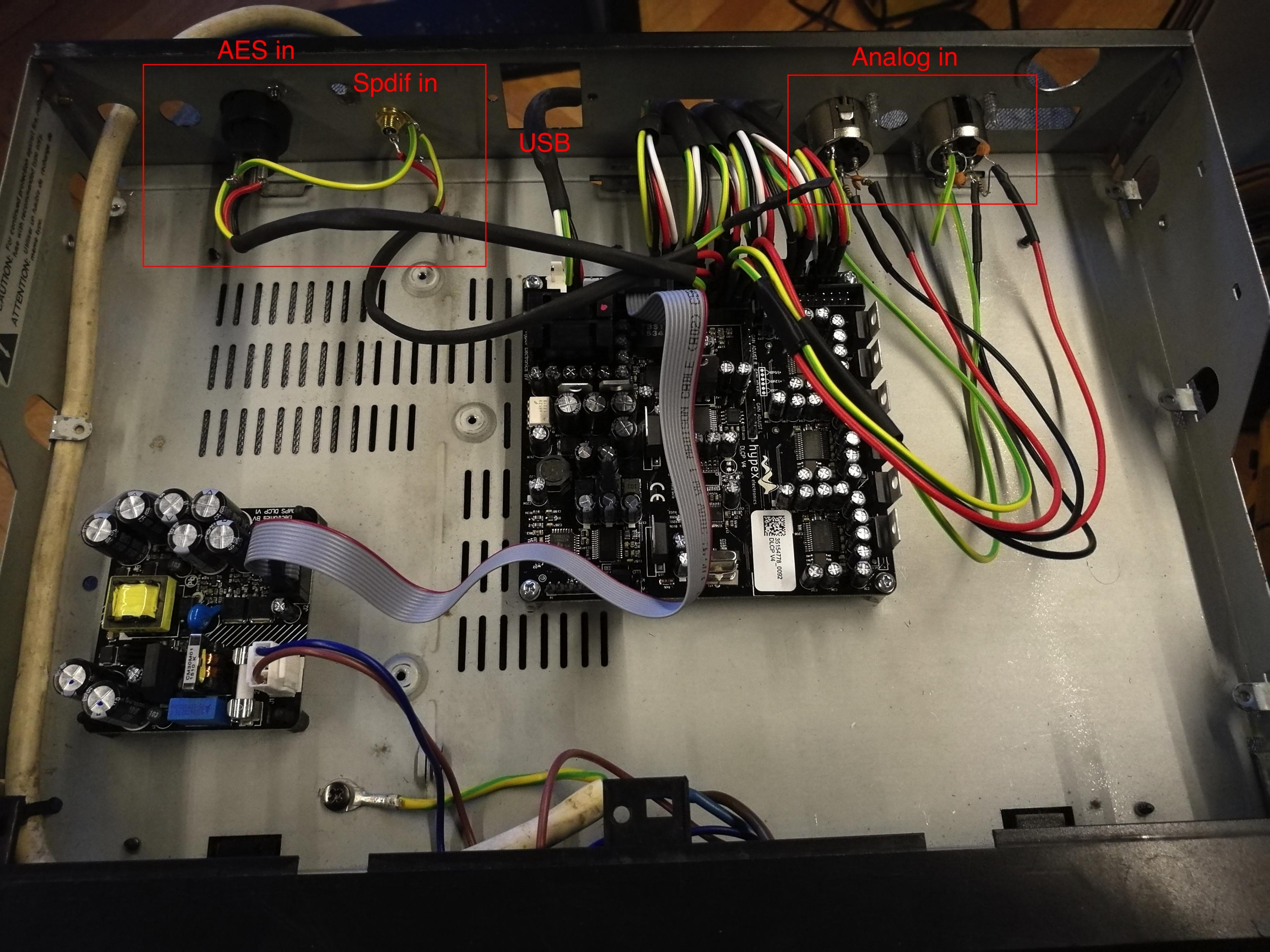

1. I did a simple connection, just as it is written in the manual and everything works fine (Spdif with female RCA connector, AES with female XLR connector and analog). Unfortunately, It's hard for me to get proper Fiber Optic Receiver (for optical Spdif) but I'll do it soon, I hope so.
2. Don't know that, I'm using main volume knob on my sound card to control volume, but also would like to know if it is possible to connect some rotary potentiometer to control all 6 outs from DLCP, and where to connect.
3. Yes it is simple as it wiring USB2. just connect 4 pins to the proper legs on "female USB type B". (or any other you wish, but it is standard printer type).
hope I helped a little..

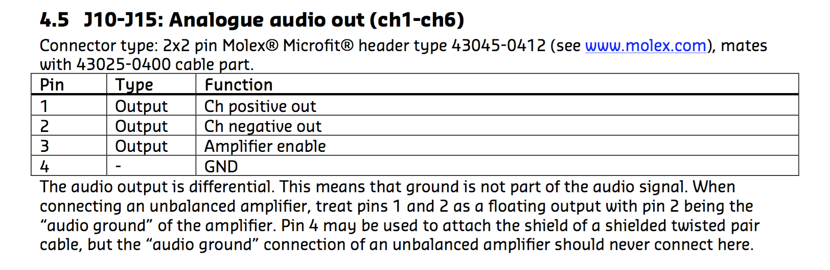

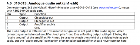

Hello Sonocon,
Looking down on the micro Molex connector on the DLCP PCB from memory it is Top Left Hand Side Pin1, Top Right Hand Side pin2, Bottom LHS pin3 and Bottom RHS pin4. Again from memory 1 is balanced signal +ve, 2 is balanced signal -Ve, 3 is a mute signal for Hypex amplifier modules, and I cannot remember what 4, although it is probably screen for pins 1 and 2.
It is in the DLCP info downloadable from the Hypex website, so please double check, as this is from memory and I am in work mode, not relaxing DIY mode.
Ray.
Ray.
