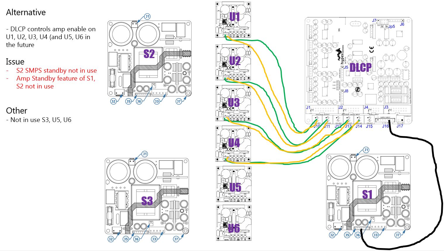

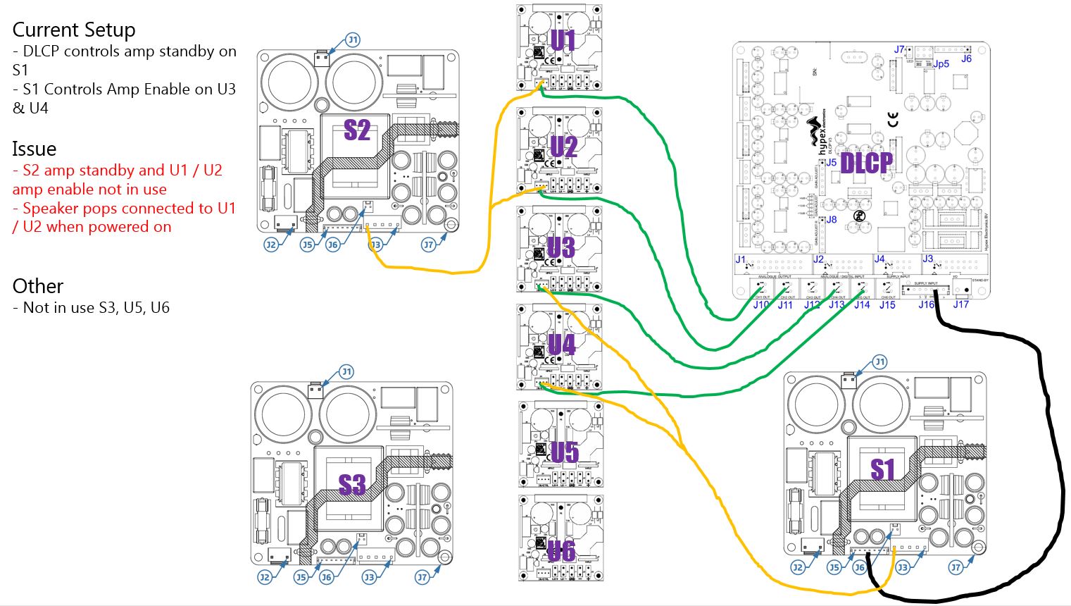

With the USB issue fixed I'm back onto completing some final aspects around my build which I'd like some advice on.
My next step is to work out how to get features like SMPS, AMP Standby and AMP enable working for all my devices. I’ve read the datasheets several times, implemented some aspects but run into issues trying to achieve this across so many components so I’ve posted here for some input.
The setup consists of the following to drive a pair of speakers bi-amped. This is up and running.
  • 4 UCD’s 180’s w/HXR’s
  • 2 SMPS’s
  • 1 DLCP
Once I build my SUB’s I will be adding
  • 2 UCD 400’s
  • 1 more SMPS
n.b. I have elected to not use the DLCP control input board as my plans are to use only a SPDIF from 1 source
  • My current setup has the DLCP controlling the SMPS and AMP Standby of 1 SMPS and that SMPS controlling AMP enable of 2 UCD’s. See attached diagrams. With this route I’m not sure the DLCP can control 3 SMPS’s and achieve standby functionality across all devices.
  • I’ve been communicating with Hypex who I could resolve this by purchasing a DLCP SMPS and Softstart module. In this case the DLCP SMPS controls power to the DLCP. The DLCP could then control the Softstart and the softstart the SMPS’s and UCD’s. Do others see this a viable option? Seems like a lot of components? Has anyone tried this? I’m dubious about whether I need another SMPS.
  • J17 on the DLCP is a Standby Supply Connector. I think this suggests the standby mode of the DLCP can be used by applying a DC current here 6.5-12 Vdc. Silly question, but what part do others see I need to make use of this? This way I’d continue to power the DLCP as I am now.
  • Could a customer cable be made up so the DLCP can control 3 SMPS’s. I’m wondering whether a parallel split of the DLCP’s SMPS / AMP Standby output (pins 1 and 2 J16 or J4) could connect to the equivalent inputs of the SMPS’s. I’m happy to make up custom cables as required.
Any other thoughts appreciated.

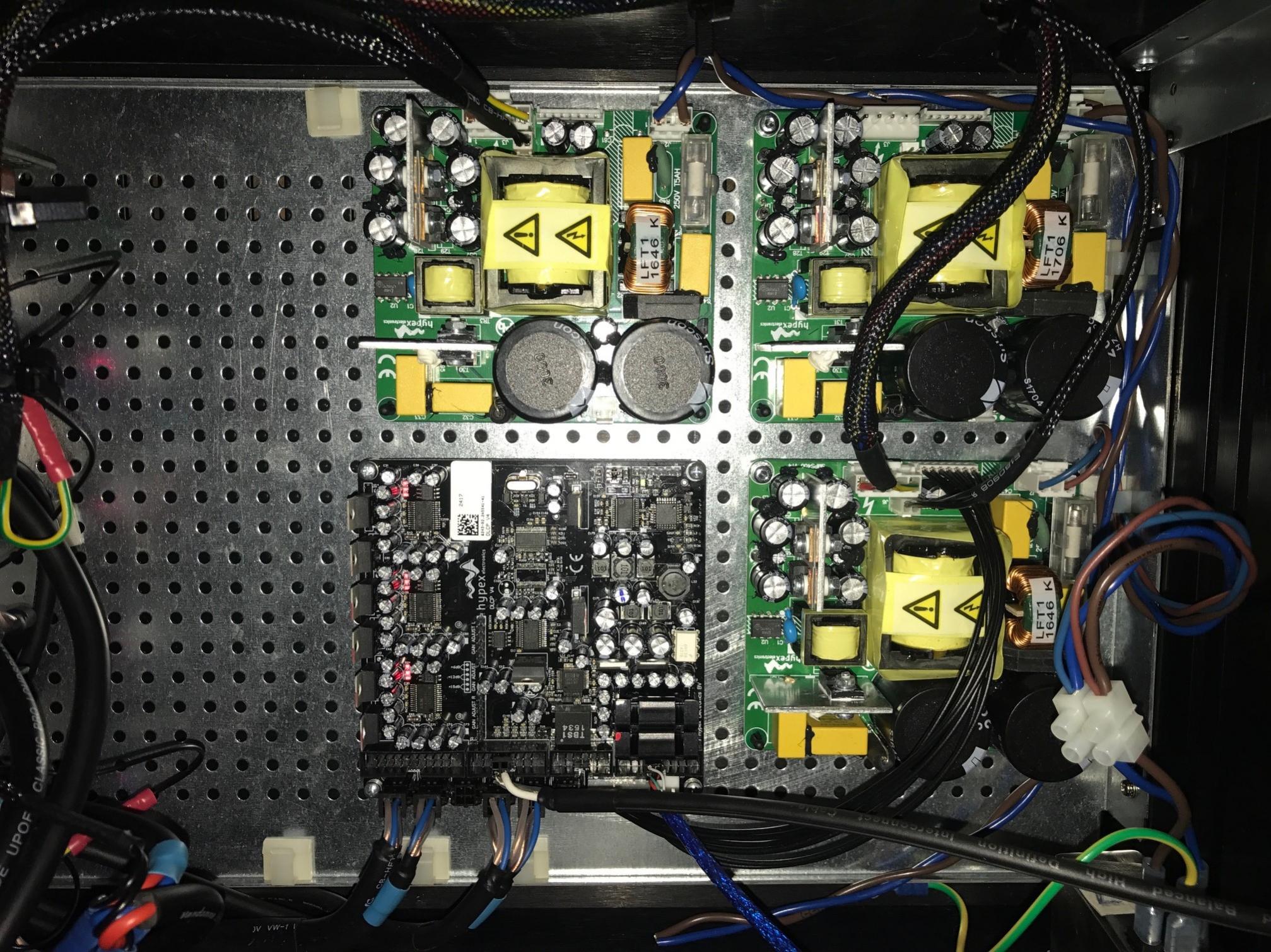

Sure Antana,
I have 2 * SMPS400A180's and 1 SMPS400A400.
One of the SMPSA180's is powering;
- the DLCP connected via J5 on the SMPS to J16 on the DLCP (the black line on my diagram 1 Current).
- The same SMPS is powering 2 * UcD180's from J3 on the SMPS.
My 3rd SMPS is a SMPS400A400 which will power my UCD400's. Not currently in use but will be when I build my Sub's
Now is see the images, they did not show on my phone. In your setup wou will always have at least one SMPS enabled. Thats why the DLCP SMPS is introduced.
Anyway, Amp standby and Auto Amplifier Enable on the SMPS units is used as s sort of 'wait for' function. If the DLCP or another sort of logic applies a DC voltage on the Amp Standby pin, the (Auto) Amp Enable output of the SMPS is deactivated. If the Amp Standby pin is pulled low, the (Auto) Amp Enable output is pulled low, providing that the SMPS is fully started. This ensures plop free enabling.
I can explain more, but my time is running up. Have a look at the SMPS DLCP, it will save you on your electricity bill.

It is perfectly possible to use a DLCP without the ***-on set, but you will lose some features, like the volume control and stand-by (or you have to implements is your self).
I would not recommend putting some analogue volume control between the UcD's and the DLCP, just use your PC's volume control (if connected via SPDIF).
If your use the DLCP SMPS (in combination with the add-on set) you can put all your connected SMPS400's in standby, saving the idle power. You can use the remote to switch the whole set on.
Or you go for the Softstart. Although it is not meant to use with SMPS unit's, the DIY community had successfully used it with SMPS's. With the Softstart you can use a pushbutton with a fancy LED to switch on your set. In this case you safe the idle power of all the 3 SMPS's.
Naturally, you can also use simple, hard on-off switch. Connect the amps to the (auto) amplifier enable of the powering SMPS's and connect the amp-enable of the DLCP to the Amp-Standby of the SMPS's. In this way the amp's should be in standby/mute as long as the SMPS's are not on working-voltage and as long as the DLCP is not fully booted.
At least, in theory. All by heart, so please check it 😉
