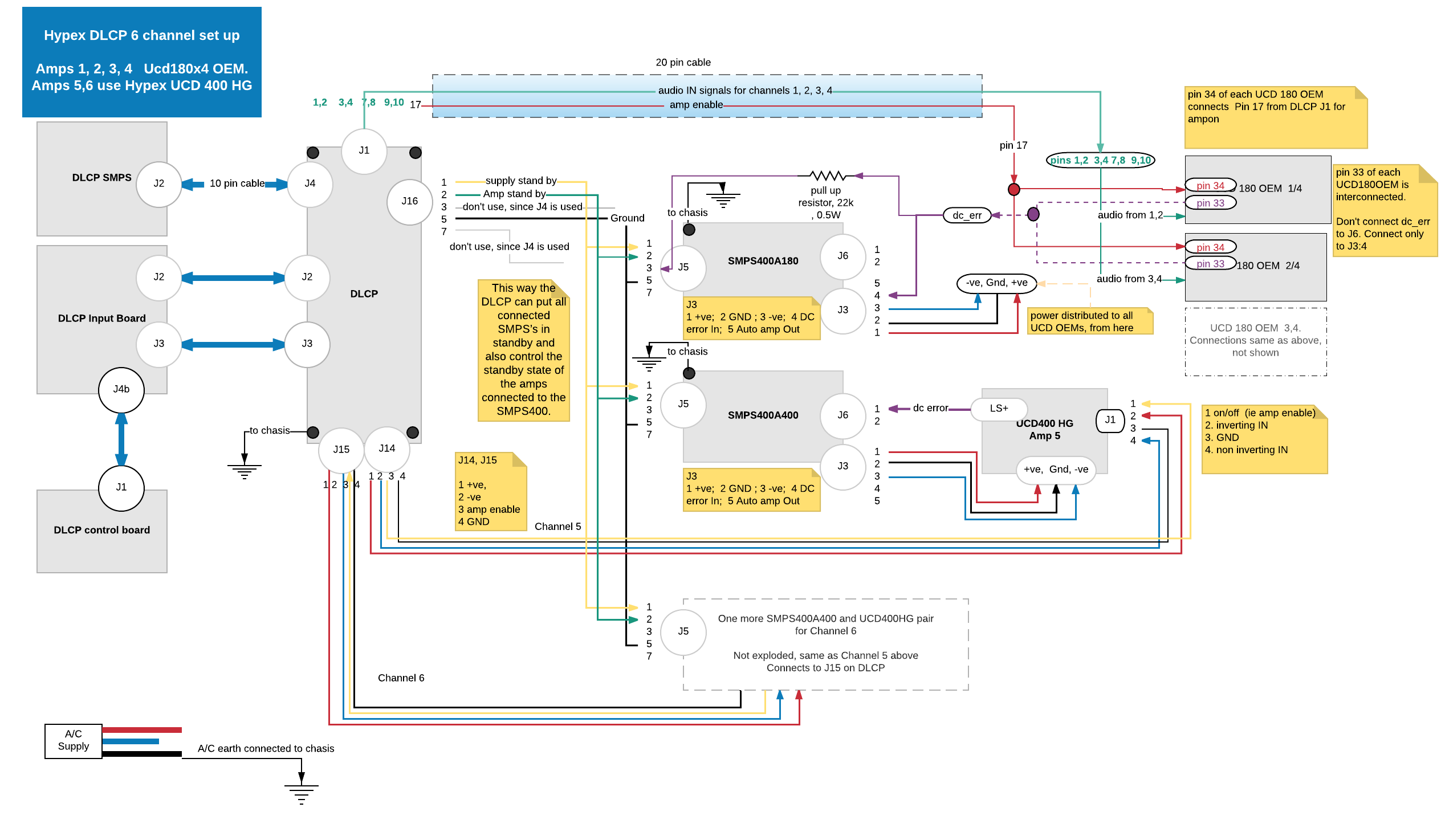

Also wanted to share 2 more experience notes and fixes, as it might help other newbies who are struggling.
Issue 1: System used to shut down arbitrarily. The set up schematic is as attached. Note that it uses 4 Ucd OEMs and 2 Ucd HGs. After much head-banging and cussing, I found out that it was because of a loose-contact in the connection between UCD HG LS+ to SMPS400:J6:1. I was using a fancy connector that was broken internally.
The dc-error handling of OEMs are different from HGs. Note the circuit. Thanks to various folks who helped here.
Issue 2: As explained earlier, when DLCP/Control board does not respond to commands, I have to shutdown system using IEC. There is a loud pop when I do so. The connection approach used was:
Control the SMPS on/off from DLCP J16. Control the amps using amp_on available in DLCP J1 (for the 4 OEMs) and J14,J15 for the UCD HGs. However, as the DLCP itself is not shutting down (I am assuming this, as control board says "Waiting for DLCP"), this arrangement doesn't work.
So, we have to handle individual power off scenario of all 3 SMPSs. I will modify the schematic to "DLCP controls SMPSes, and SMPSes control Amps". Schematic attached (Ver 9). This way, it should handle Power-Off of DLCP via Remote and power-loss via IEC-switch-off, gracefully. Will update how it goes.

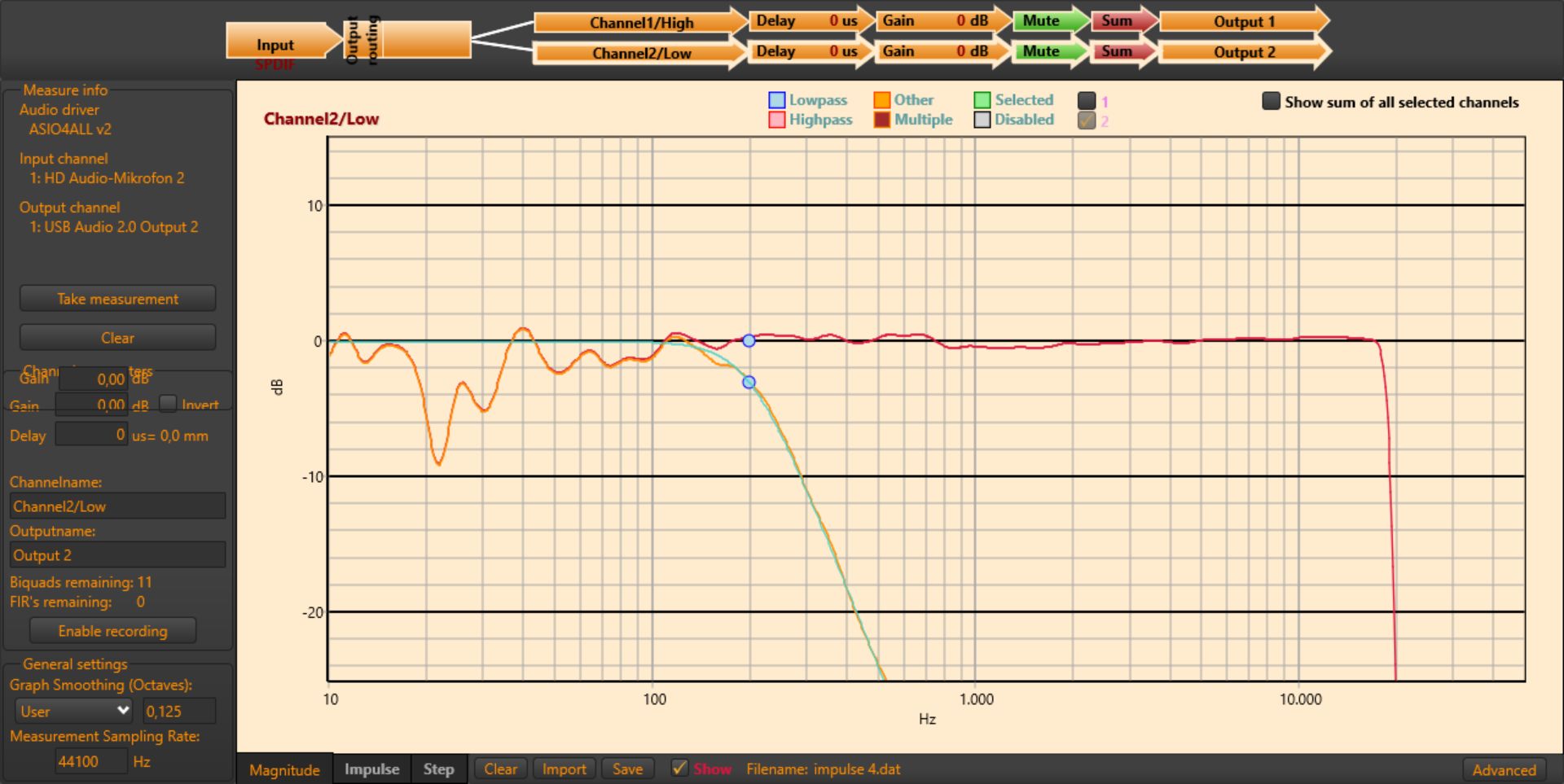

PSC2.400D Measurement Problems
Hello to all,
I have great problems to measure my speakers. 4 weeks ago I bought two PSC2.400D to activate my speakers. The speakers are two way open baffle Carver Silver Edition with 48" ribbon. Crossover setting at 200 Hz 18 dB no problem, works perfect. But I can not make measurements with the 4.6 software. I've installed asio4all, set the right in- and output (I think), but the internal sweep measured all, but not the frequency response from the speakers. It measured also impulse files when I unplug the mic.......
Can somebody please help me?
Christoph
Hello to all,
Christoph
Here are some more information of my system:
Windows 10 pc with foobar and 2,7 tb flac and wav files. Output USB in Gustard U12 XMOS Audio Device. Output AES in the first PSC2.400D and from there in the second with AES.
Microphone is a Behringer ECM with a phantom power supply. The mic is working on other pc's.

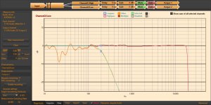

The tweeter file looks always so, with or without filters
