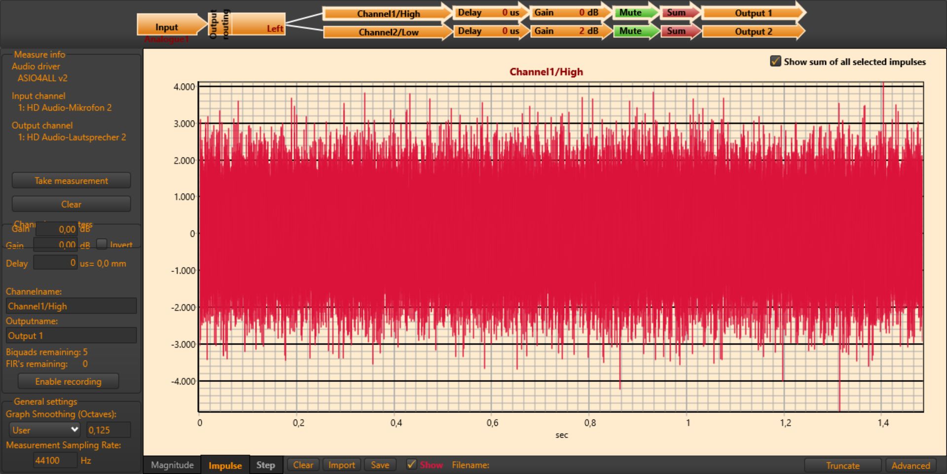

I just tried with the onboard soundcard, but same problems. Do I need a extern soundcard?
I have also tried to import from holmimpulse a file as in post 1394 was explained, don't work, I could not see any file........
There is somehow the worm in it!

The problem was the incompatibility between asio4all > soundcard > HFD.
I took a Tascam audio interface and it works now.
