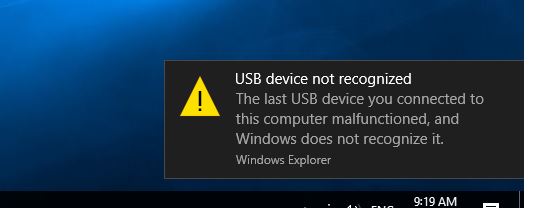

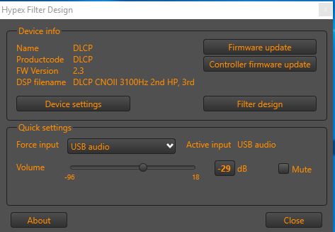

I had the DLCP up and running, set a filter and was running well a few hours. All of a sudden USB audio dropped out and I can't get it working again (note I haven't setup my other inputs yet so just testing USB to start with).
  • The USB DAC driver is showing as malfunctioning (see images). I can still connect to the HDF, upload filters and I even re-flashed the firmware to see if this would correct the issue.
  • I then, uninstalled the USB driver, rebooted and plugged in again. Finally I tried on a 2nd computer with the same result.
  • No wiring changes had been make from when the USB audio was working.
Anyone come across this issue with the USB Audio/Drivers?
