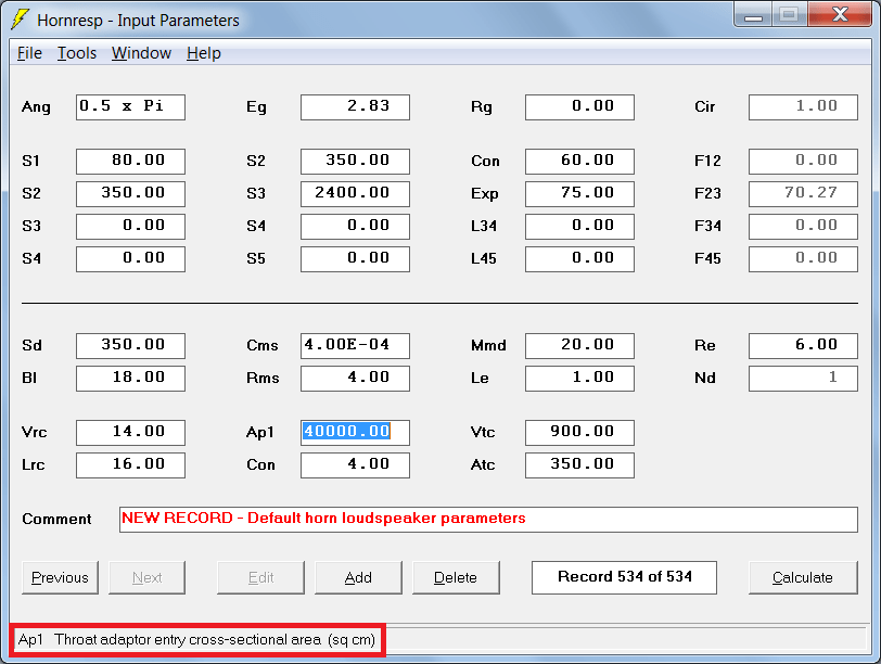

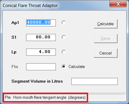

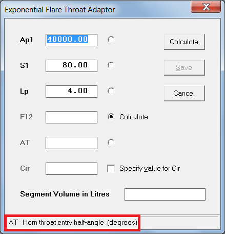

I managed to bring up the throat adaptor wizard by clicking on Ap1 text box, but I dont understand the meaning of the paramaters (what they refer to) Ap1, S1, Lp, Fta in the conical adapter and the whole list in the Exp adapter wizard.
The meanings are given in the Help file, and can also be seen by moving the mouse over an input box, as shown in the attachments.
( I noticed a bug in the wizard which will be fixed in the next update - the Ap1 description is not being displayed).
Also no matter what values I input in the wizard, the adapter is not displayed, it is alway a 2 segments horn, not 2 segments + adapter.
It is necessary to specify a throat chamber for the adaptor to connect to. For obvious reasons, the adaptor cannot connect direct to the driver diaphragm.

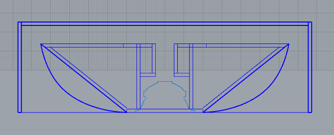

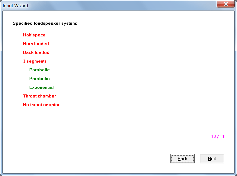

I'm trying to figure out what kind of input params to use for this box.
The horn is back loaded while the front is direct radiating. It looks like it uses a rear throat chamber as well. I'm wanting to see if I can slim it down enough in size to make it work for 100hz to 1kHz with the right 12" drive unit. This may be wishful thinking, but the simulator seems like my first best step to find out!
Can someone help me figure out what input parameters to use with the input wizard? Also willing to put in any time reading if there is a specific section of the manual I should look at.
Thanks!
