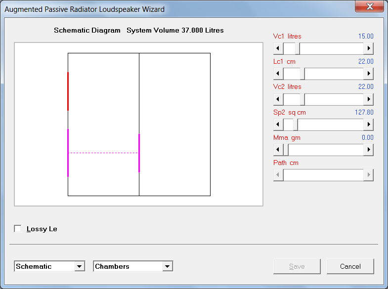

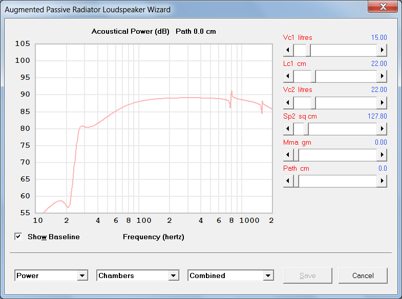

Augmented passive radiator loudspeaker systems can now be simulated. My thanks to Dr Bjørn Kolbrek for providing the APR model used in Hornresp. Following is a copy of the relevant section in the Help File relating to the new feature. Probably the best way to start is to create a template using the Input Wizard and then adjust the input parameter values to suit the required design.
The APR Input Wizard options are:
Half space > Direct radiator > Passive radiator > Augmented
|Closed-Box With Inline Driver and Augmented Passive Radiator
Select the Augmented Passive APR option from the Loudspeaker Configuration tool or press the Ctrl key and double-click on the ABC label in edit mode to set the APR flag.
Double-click on the Mmp label to specify the total extra mass in grams to be added to the augmented passive radiator diaphragms. The input parameters window Mmp label changes to red when mass is added, and the value of the mass added to the diaphragms can be seen in the bottom status bar panel by moving the mouse pointer over the Mmp label or text box.
Press F5 or click the Wizard button to open the Loudspeaker Wizard.
An augmented passive radiator can be created by taking two normal passive radiators and physically connecting their diaphragms back-to-back. The required Cmp, Mmp and Rmp input parameter values for the APR are calculated as follows:
Cmp = Cmp1 * Cmp2 / (Cmp1 + Cmp2)
Mmp = Mmp1 + Mmp2 + mass of the link connecting the two diaphragms
Rmp = Rmp1 + Rmp2
Where Cmp1, Mmp1 and Rmp1 are the parameter values for the first passive radiator and Cmp2, Mmp2 and Rmp2 are the values for the second.
It is not possible to specify more than one APR.
If the piston areas Sp1 and Sp2 of the two connected passive radiator diaphragms are the same then the forces due to the pressure acting on them will be equal and opposite, and the diaphragms will not move. The system performance will be identical to that of a closed-box with inline driver.
If piston area Sp2 is set to zero then the performance of the APR will be identical to that of a conventional passive radiator having the same Sp1, Cmp, Mmp amd Rmp specifications.

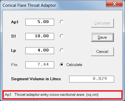

When used with a throat adaptor, the Horn Segment Wizard was not showing a description for Ap1 and only generalised descriptions were given for S1, Lp and Fta. All descriptions are now shown, and are specific to the throat adaptor.
Post #13,903 refers:
https://www.diyaudio.com/community/threads/hornresp.119854/page-696#post-7442587
