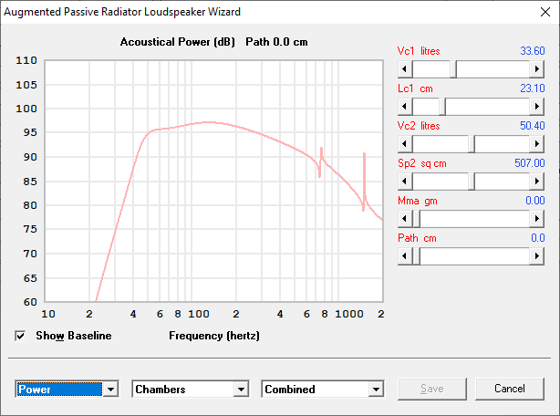

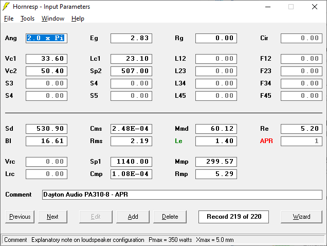

The value of Mmp seems quite high at almost half a kilogram (431.75 gm) and the value of Rmp is definitely way too large at 350.00 newton.sec/m. Should Rmp perhaps have been 3.50 newton.sec/m? That would be a much more realistic value.

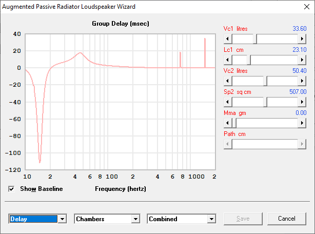

Yup, that looks like it. I rejigged the PR parameters a bit and now I'm getting something a lot closer to what was predicted by the LDC calculations.
Of note is that the stated advantage of the APR, that the null is driven a lot further down in frequency, basically eliminating the "notch" caused by a typical PR, is correct. In this example, it looks like the notch is driven down to somewhere around 13 Hz, and there's no sign of it in the system's FR.

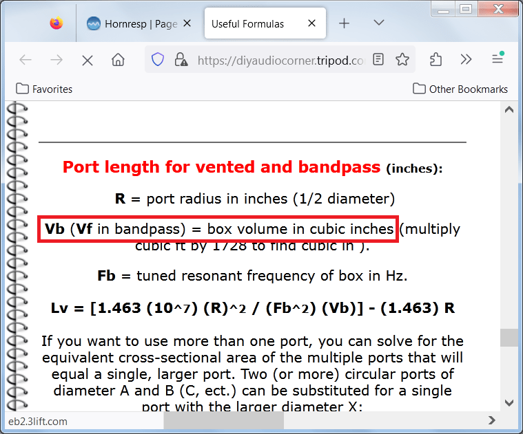

how about adding this for sealed and BR?
There are already many existing design tools out there for closed box and bass reflex loudspeakers...
Besides, there is something radically wrong with the Lv formula you quote.
Given:
R = 10 cm (3.150 inches)
Fb = 50 Hz
Vb = 10 litres (610.237 cubic inches)
Lv = (1.463*(10^7)*(R)^2/(Fb^2)(Vb))-(1.463)*R
Where Lv is in inches.
Then:
Lv = (1.463*(10^7)(3.15)^2/(50^2)(610.237))-(1.463)*3.15
Lv = 35434303.84 inches
An option for a starting point is to use the method proposed by King using LDC formulae kind of ‘unifying’ sealed, vented and TL enclosures sizing described in http://www.quarter-wave.com/TLs/TL_Alignments.pdf . Manual calculation could be error prone though. If I understand correctly, this is used for the Hornresp TLdesign tool with the additional Brian Steele option. Noting sealed and vented enclosures can be initiated in the input wizard and fine tuned in the loudspeaker wizard, would there be anything gained by aligning the input wizard to King/LDC method?
Sure, but it's incredibly handy e.g. in the bp4 simluation to get a very good FR for any driver just by the push of a button.
Sorry, i only did use the Vb and Fb part from the formula to start a simluation, since HR does anyway the better job for the port's diameter and length. Probably a typo in the formula ...
Given:
Fb = 50 Hz
For the formula to work, Vb should be in cu.ft., not cu.in. :)
In any case, that formula, a well-known one btw, even mentioned in the LDC, produces results that don't match Hornresp sims. See this post for a reminder :) - https://www.diyaudio.com/community/threads/hornresp.119854/page-688#post-7423148
If so, then the information given on the site rertrobaer referred to, is incorrect :).
