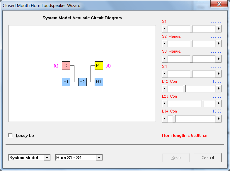

3) Still struggling with how to specify "Path".
The driver radiator and the port opening outside the cabinet are considered to be acoustic point sources. The path length is the straight line distance between the two sources, assuming that the cabinet does not exist.
(The system model in the loudspeaker wizard shows how the design is interpreted by Hornresp).

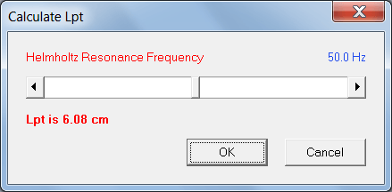

CHANGE 1
The operation of the Helmholtz resonance frequency calculation tool has been reversed so that Lpt is now calculated given the Helmholtz resonance frequency, rather than the Helmholtz resonance frequency being calculated given Lpt. Attachment 1 refers.
If the Helmholtz Resonance Frequency label is double-clicked the Helmholtz resonance frequency can still be calculated given Lpt.
(Any slight changes in frequency or Lpt values when switching from one calculation mode to the other are due to frequency input values being rounded to one decimal place and Lpt input values being rounded to two decimal places).
For a given Helmholtz resonance frequency, because of the way that the Lpt value is being calculated, the Hornresp result should theoretically be more accurate than that produced by most other box programs, particularly when the port tube is relatively long.

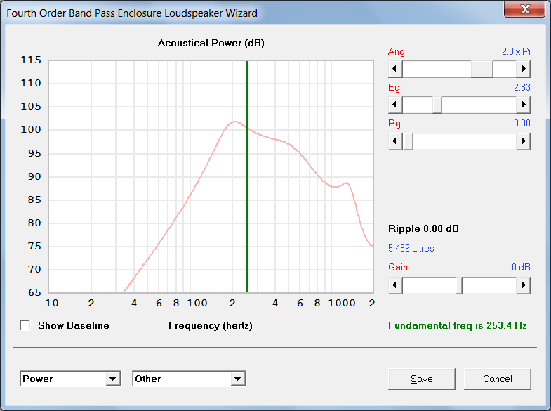

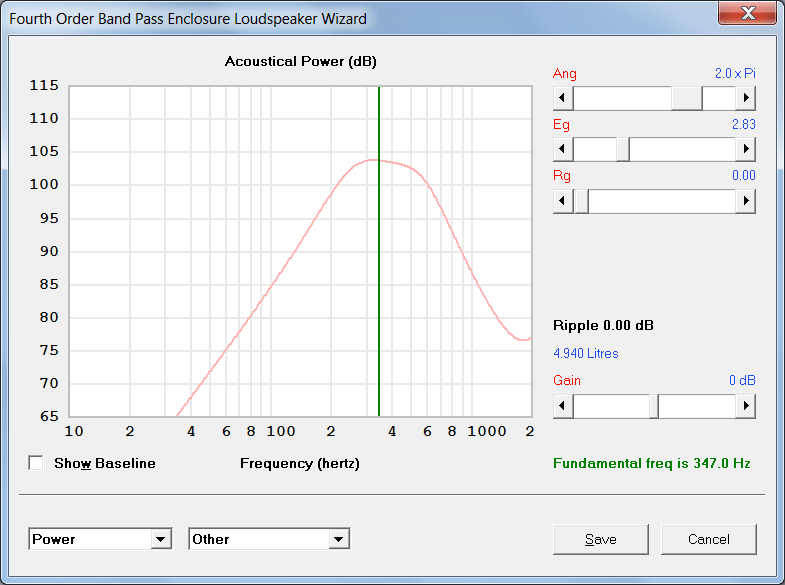

CHANGE 2
The BP4 wizard auto design feature has been enhanced. The calculated results are now closer to the optimised ideal. Attachment 2 shows the old result for a given driver. Attachment 3 shows the new result using the same driver, gain and ripple settings.

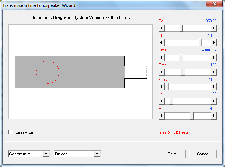

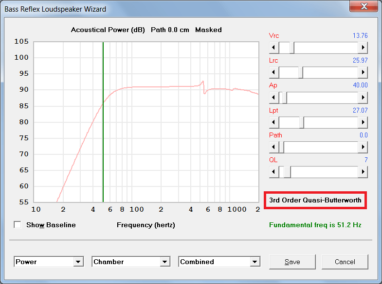

The closed box loudspeaker design tool now has two alignment options:
Default Alignment
Leach Alignment
The bass reflex loudspeaker design tool now has four alignment options:
Default Alignment
4th Order Butterworth
3rd Order Quasi-Butterworth
4th Order Chebyshev
Attachment 4 refers.
See the 'Design Wizard - Closed Box' and 'Design Wizard - Bass Reflex' sections in the Hornresp Help file for further details.
