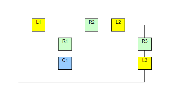

Would I be correct using thee same analogy and call a Bass Reflex an acoustic transformer as well?
Acoustically a bass-reflex loudspeaker acts as a Helmholtz resonator. The electrical equivalent would be a RLC resonant circuit as shown below, where:
Given that the pressure and volume velocity on the rear side of the diaphragm (input) are different to the pressure and volume velocity at the port outlet (output), I guess it could be argued that the values have been "acoustically transformed" from input to output... 🙂

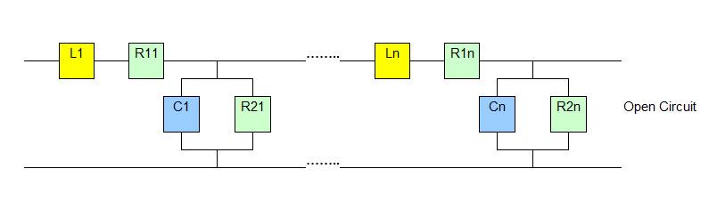

@David McBean Thank you so much. Can you display the Quarter Wave circuit, in the same format, for comparison?
The electrical equivalent of an acoustic quarter wave resonator would be an open circuit transmission line stub as shown below. If lossless there would be no resistive elements.

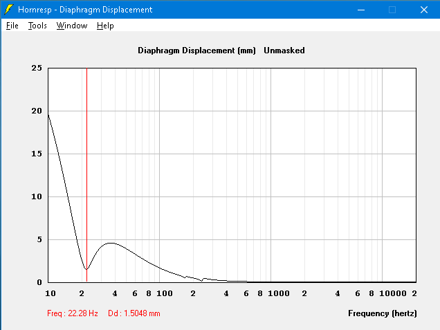

Thank you again, I have another question.

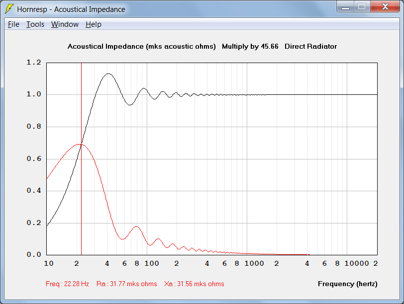

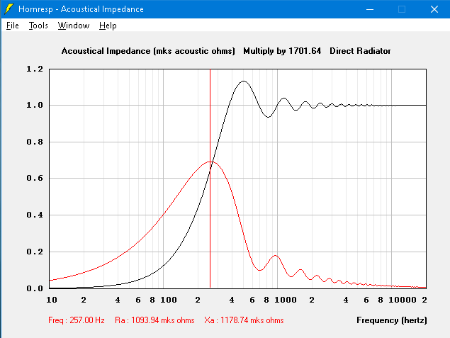

This is a BR tuned to 22hz...Why does it not show the peak in Xa and the roll off of Ra and 22hz?
For a bass reflex system, the chart shows the acoustical radiation impedance loading the front side of the diaphragm. The frequency at which resistance Ra equals reactance Xa depends on the radius of the diaphragm and the solid angle into which the driver radiates. The diaphragm would need to have an unrealistic radius of 1.7 metres and radiate into 0.5 x Pi space for the frequency to be reduced to 22 Hz, as shown in the attachment. System topology has no effect on radiation impedance - the only parameter values that matter are those of Ang and Sd.
For a horn system, the chart shows throat acoustical impedance, quite a different thing.
🤦♂️Ty I should of known. But I cannot figure this one, I bet its easy for you

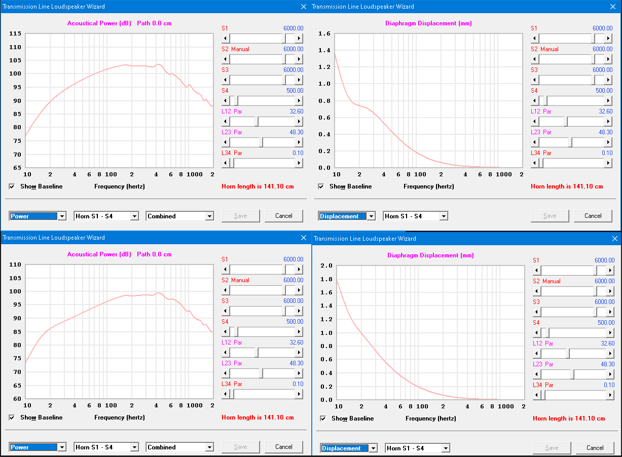

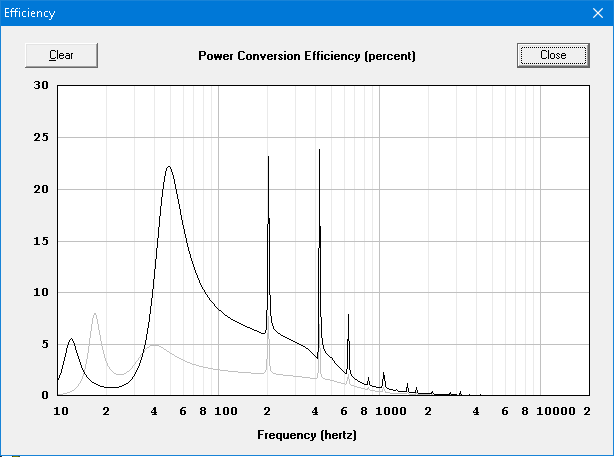

In the above graph in a Vented line, I only changed the sd. One is 600 and one is 1200... why do we see this higher efficiency of the 600cm2 example ~15hz-34hz?
Below shows 1200sd on top of 600sd
Here with damping material, the relationship changes....
Below, without damping material, the huge peak at tuning.
Changing the value of Sd changes the acoustical impedance loading on the diaphragm. The effect that this has on power conversion efficiency depends upon the frequency and the values of all the other driver and enclosure parameters defining the system.
Increasing the value of Sd could be expected in general to improve the conversion efficiency, but in the vicinity of the system resonance frequency the situation can be reversed, as you have observed.
The calculations required to determine power conversion efficiency are extensive and complex, and everything interacts, so it is not possible to manually identify a specific reason why the results are what they are, for any particular case.

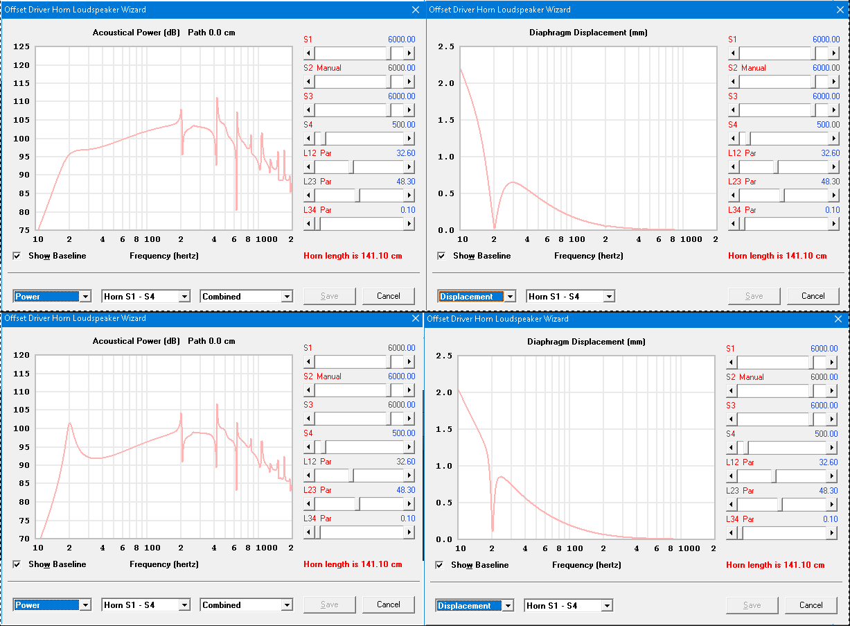

by chance is there any room left in the math of the TH and PH sections of horn response to include the Q losses feature?
that works really good in the other sections
When you say the "Q losses feature" I assume that you are referring to QL, the vented-box enclosure quality factor parameter. If so, then it only applies to bass-reflex type systems. TH and PH system losses can be allowed for by specifying absorbent filling material.
