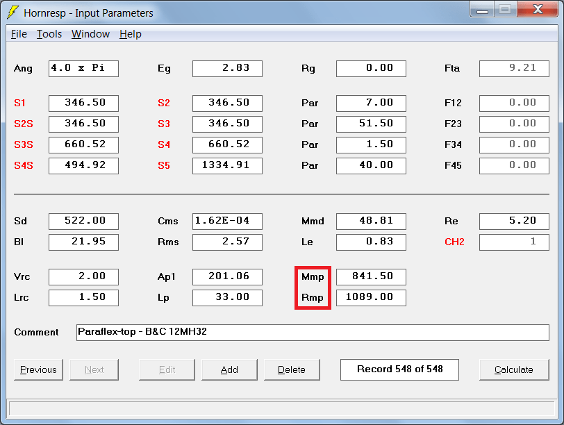

Hi Marcelo,
Vrc and Lrc (RC) are being used to specify what is in effect a throat chamber, and Vtc and Atc (TC) are being used to specify what is in effect a rear chamber. The values shown do not appear to be consistent with the design. Vrc = 2 litres would seem to be perhaps too large for the throat chamber, and Vtc = 841.5 cubic centimetres would seem to be too small for the rear chamber.
Kind regards,
David
Bug Report
I have already found a bug as a result of the latest release. In the attached screenprint Mmp and Rmp should be Vtc and Atc respectively. Will be fixed in the next update.
Reactions: Kravchenko_Audio
It was the best way I found to match the box design with current hornresp models available once it needs the chamber feeding a offset horn while the back the horn is in series and only CH2 has this configuration so it was needed to invert the chambers.
I will double check the numbers and finding for mistakes, I played around changing some number to see a sign to fix the dip without success.
Thanks to take a look.

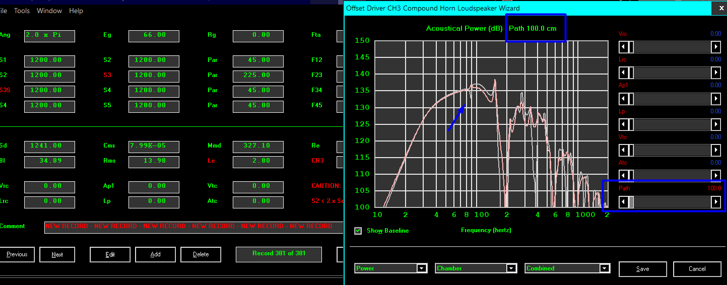

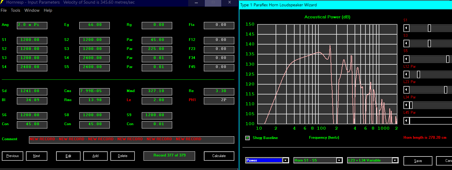

What’s the ‘difference‘ thats creating the little sliver of phase discontinuity? As zero path in Ch3 or parallel to the same L45 (PH1) @ 0.01 cm
The discontinuity at 87.92 Hz seen in the CH3 design but not in the PH1 design is possibly due to the difference in the way that the two signals are combined. The CH3 discontinuity is sensitive to changes in L23 and L45 but the acoustic circuits of the CH3 and PH1 designs are just too complex to be able to identify a specific reason for the variation using manual analysis. Considering the difference in the topologies, I am pleasantly surprised that the results actually compare as favourably as they do.

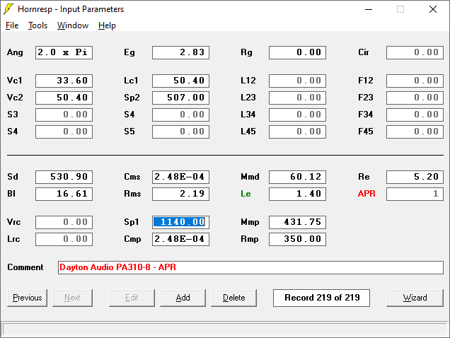

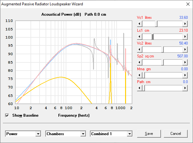

I can't seem to get the APR model to work.
Here's an APR to sim, based on the calculations in the LDC, and I driver I use in many test boxes:
Vas=
99.67​
litres
Qts=
0.30​
Fs=
39​
Hz
Alpha=
1.25​
H=
1.2​
F3/Fs=
1.15​
E=
0.4​
Vb=
83.9​
litres
V1=
33.6​
litres
V2=
50.4​
litres
SP1=
1140​
cm^2
SP2=
507​
cm^2
Fb=
51.5​
Hz
F3=
48.9​
Hz
But when I put this information into Hornresp:
I get this...
Where am I going wrong...?
