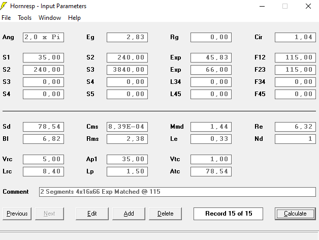

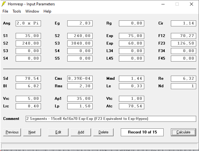

2 segments Esponential Matched VS Unmatched
I attach screenshots of two similar horns, one where the two segments (adapter and array) are matched, and one where they are not matched and F12 is made lower to compensate for the higher F23.
I briefly mentioned this two posts above.
Making such compensation (i.e. not matching the two segments flare frequencies) seems to be necessary since the array must be made shorter in order to improve dispersion figures.
These are still way below what is desirable (16-18° angle cell to cell) according to practice derived from Altec design.
I guess this is the price to pay in order to have a usable crossover point of 200/250 Hz. vs minimum 4-500 of the Altec Multicells.
Looks like the unmatched segments display a (marginally) more linear behavior and a LITTLE better low end, so the only real advantage of the "unmatched design" is that the shorter array results in broader dispersion without apparent drawbacks, at least in power response.
I am not sure if there's any drawback to this in other areas.

Thanks Gumbo. I have no idea how the corrupted schematic diagram could have been produced, and as far as the height and width profiles are concerned, they are different because a rectangular rather than a square cross-section has been specified. Although the profiles are not the same, the overall area expansion rate and cutoff frequency remain unchanged.
David, of course I agree the different width/height profiles of the array are due to it being previewed as rectangular. If I would preview it square though, the actual width and height would differ even more from the actual physical array.
This is not at all a problem as far as the CAD design of the array is concerned, because it must be done based on the single cell design, which is perfecty accurate in hornresp.
I wonder (and would like to hear your thoughts about this) if these inconsistencies can make the result of the simulation less accurate/reliable than usual.
In a previous post, Bjorn Kolbrek mentioned that the shape of the profile such as square vs rectangular, or conical width associated to exponential height (i.e. "radials") is not so relevant to power response figures. However in this case we are facing not only a different "shape" of the flare but also of the surface of the four faces which constitute the array.
I do believe that S1, S2 and F12 are probably the elements which "rule the game" also in this case, regardless of the actual accuracy of the resulting profiles, still I would like to hear your thoughts on the subject.
Also, since dual segments can't be simulated with Hypex horns or with hybrid Exp-Hypex (F12 Exp - F23 Hypex) i have bypassed the problem by filling the F23 part of the form with paramaters of a Exp horn with same F23 frequency of a previously simulated Hypex.
I hope this will result in acceptable approximation.
In this regard, should you decide to "find another challenging", following Lordsansui suggestion, I believe the possibility to simulate multisegment Hypex's and Exp-Hypex hybrids would be a worthy improvement, and perhaps not so difficult to implement, since the two types basically have quite similar behavior.
Not sure what else to say. The obvious bottom line is that the closer the actual build matches the simulated design then the closer the measured results will be to the predictions.

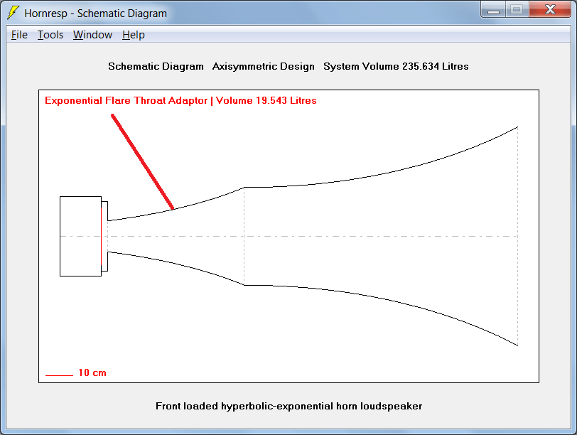

Exp-Hypex is already possible using an exponential throat adaptor, as shown in the attachment.
Multiple segment horns using flares other than Con, Exp or Par are not going to happen.

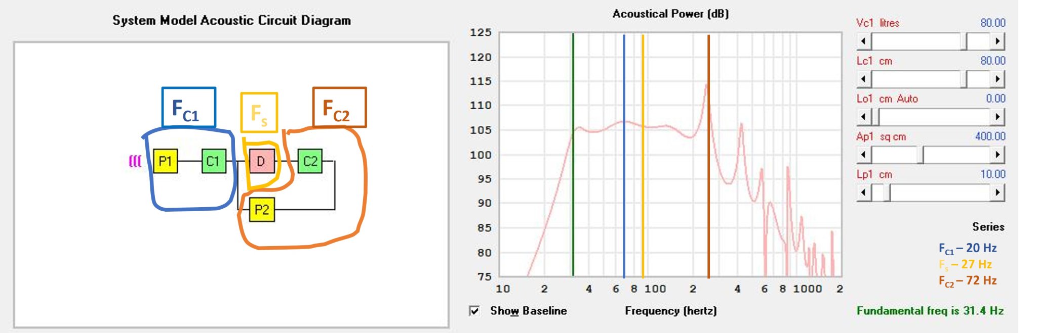

Feature request - chamber(s) resonance display and markers
Hello David,
Couple of years ago, I requested that system fundamental frequency be highlighted in frequency response and impedance charts.
Now, with more experience and I try higher order designs. I find the system response to be highly non-linear to any change in parameters. The cause and effect are difficult to visualize.
Please consider request to add a feature that marks and lists the fundamental frequencies of the sealed chambers/BR chambers/ TLs/horns/driver(s) in a particular design, along with the overall system fundamental frequency.
Giri
Reactions: Booger weldz

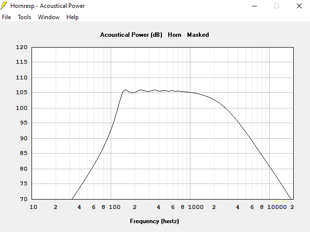

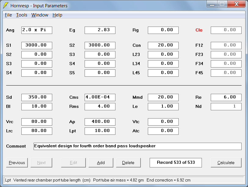

I'd like to check a BP4 simulation for port velocity and Xmax at different Pmax values, it seems it's not possible.
What alternativ enclosure(front loaded horn, closed rear chamber?) is suitable for that task to convert the BP4 to?
The method suggested by stv does not take into account the port tube internal end correction included in the BP4 model.
To make the results identical to those produced by the BP4 model, specify a closed mouth plus rear chamber and port tube as shown in the attachment, and use the chamber resonances 'Not masked' option. The ported chamber is defined using Vrc, Lrc, Ap and Lpt, and the sealed chamber is defined using S1 = S2 and L12 (Con) with Clo closed mouth .

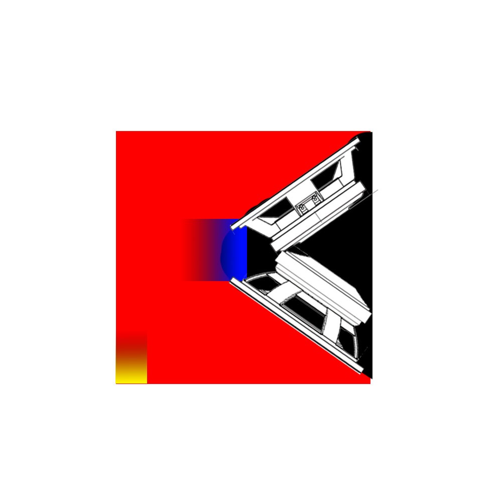

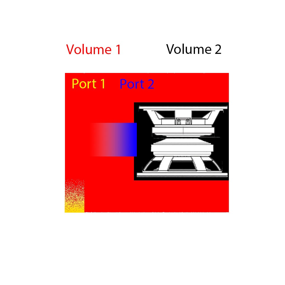

This is the record:
And I'd like to know if I can do it this way (I imagine it has nothing to do with isobaric as there is no sealed chamber):
or maybe (longer Lc1&2 i imagine):
And in the fist picture, the Lc1 should be the space between (the center of) each woofer and the wall, right ?
(thank you and again maybe sorry for my english level)
The speaker Re changes if i wire a dual voice coil differently but not if i wire two different speakers differently ?
If the Re of each driver is 6 ohms, then two connected in series will have a combined resistance of 12 ohms and two connected in parallel will have a combined resistance of 3 ohms.
I am not sure how to interpret your drawings. In any event I suspect that it is likely to be a judgement call, in which case your guess would be as good as mine.
