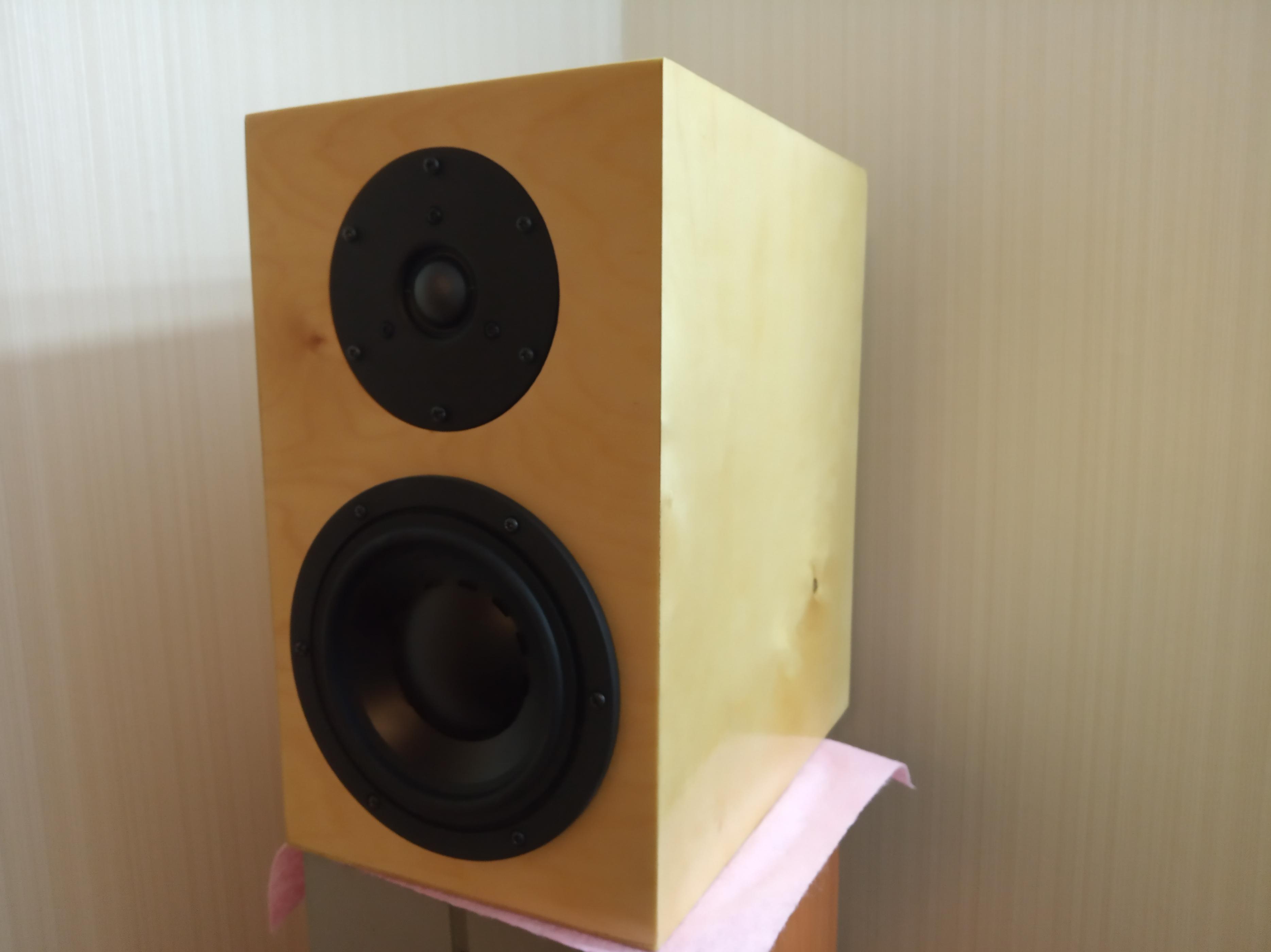

ekbrus: that looks amazing! Much better than my low-budget paint job.

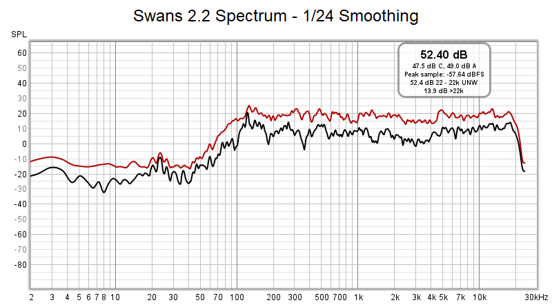

I took a step back to use my calibrated mic and REW for the white-noise generator as well as for recording. (It is a bit fiddly to get things set up.) Hopefully this is more accurate than my previous attempts, although, it is not ideal, as the speaker sits in a rack (the normal location for it, listening to it currently). I guess I need to play with the REW settings and get a better range. Shown like this, it doesn't seem unusually peaky in the treble? Still sounds a tad bright, but depends on the source.

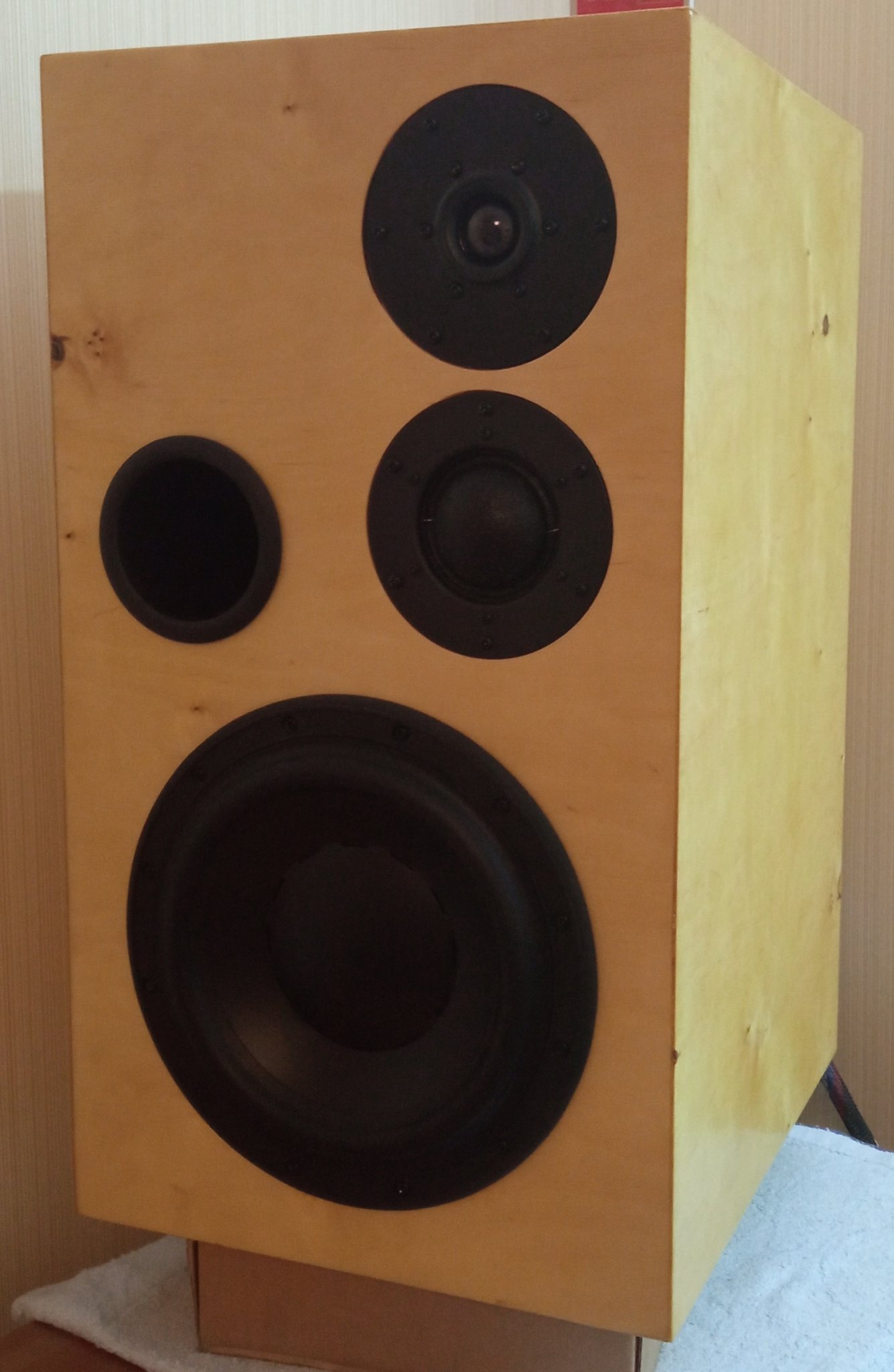

made from floor repair waste, from the costs only glue. I did it for the first time.
many many thin layers of inexpensive varnish and polishing.
there was no goal to make it beautiful.
the sound is bright.
in this picture, the next step.

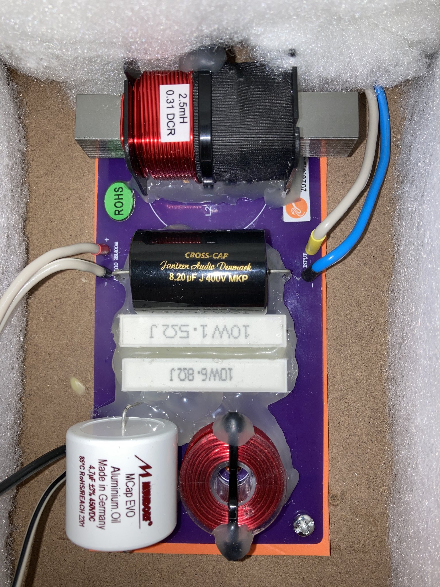

Hello again everyone,
It’s been a while since I started this thread and after all this time there are certain things and updates about the speakers that I’d like to share with you. As you probably remember from my original post, I suggested the crossover modification based on the (allegedly) original Swans D2.1SE crossover design. Additionally, I introduced two more networks - a notch filter and an impedance compensation for the tweeter, as well as a slightly higher value of the coil for the low-pass filter (2,7 instead of 2,6 mH).
However, to cut the long story short, I ended up using the original D2.1SE design using 2,5 mH coil and since I really like the sound of these speakers I’ve built another (better looking) pair with 2,6 mH inductor and some others small changes. I still insist that using the stock crossover provided with the speaker kit is a terrible idea which is limiting thee speakers to live up to their full potential.
So, what have changed you might ask. Well, a lot of things. First of all, I discovered that the test amplifier (Tangent Ampster BT II) which I was using back then has a terrible shelf-filter-like elevated frequency response, adding some 3 dB to the top end. Not good, especially when using it to measure speakers. The FR measurement which I provided in my second post is not taken with this amplifier, just so you know. On top of the +2 dB that the Q1R is inherently producing at around 18-20 KHz it seemed like a good idea to tackle this with an impedance compensation (CR) network, hence the 1,5 uF capacitor and the 6,8 ohm resistor across the tweeter. In the light of this discovery (about the amplifier), it might prove futile using this network, but there’s definitely nothing wrong with it either. As for the second (LCR) network which I also suggested, again nothing wrong, but you may as well skip it. The audible benefits of using these two networks are hardly noticeable, unless you are planning on using the speakers as near-field monitors toed-in and on axis with your ears.
The amplifier misadventure was not finished yet, though. After failing twice within just one year my 3 years old main amplifier I decided to get rid of it a bought a new one. I noticed that with the new amp my speakers sounded somehow lean if you know what I mean. After a couple of months I opened them and took out the crossover to examine it. To my surprise I found out that the inductor in the low-pass filter was far from its rated value of 2,7 mH. It was around 2,85 instead. Unwinding the coil was not an option as everything was glued to the board and I had to build a new crossover again. This time I decided to keep it simple and to stick to the D2.1SE crossover design, without anything else. I couldn’t find a 2,6 mH coil as it is supposed to be, but I sourced one which is 2,5 mH and even managed to use the original board from the kit crossover (see the picture below). That was a noticeable improvement and now there is no sign of the lean sound I was experiencing earlier.
Unfortunately, I can’t measure the frequency response, because currently I don’t have my measuring equipment, but I hope in foreseeable future to be able to do it and I’ll post it here. For now, I can only confirm from my listening experience that the D2.1SE crossover is just fine, even with 2.5 mH inductor in the low-pass filter. And one more thing as an observation - I recommend using a powerful class D amp for these speakers. It gives better control in the bass.
