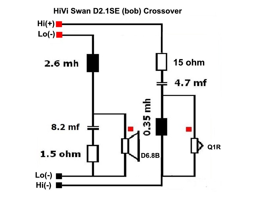

The 3k Hz issue is easily solved by reversing the polarity of the tweeter. That's your cheapest upgrade (free!), however, it may be an intentional part of the original crossover design, so I would be careful about making this change in isolation.
I think the 2.1SE crossover is a relatively cheap and simple upgrade and is the best bang-for-the-buck. Which is what I did. It's similar to stock, except you change the tweeter's cap for a 4.7uf and the woofer's inductor for a 2.6mh one. I had trouble finding a 2.6, so I got this one:
https://www.madisoundspeakerstore.com/sidewinder-16-awg/sidewinder-2.5-mh-air-core-inductor-16-awg/
This is the biggest expense of the modification. At the moment of this writing, these are $33, and you need a pair, so already you're up to $66 not including shipping and the caps.
This mod (2.1SE crossover) doesn't do anything for the elevated treble above, say, 4KHz, Allex had additional components to tame the tweeter. However, this did what I wanted to do -- relatively flat response from the bass to upper-midrange. And the upper treble is no worse than before, as it's unchanged, but it sounds less harsh, now that mids and bass are raised a bit. If you try other values (than the ones in the 2.1SE schematic), you probably should model them in software to see how it changes, or at least measure when done. Differences in DC resistance as well as the induction value will change the output. The stock inductor's resistance of 1.1 ohms seems like a bit much, but maybe it doesn't make as big of a difference as I expect. Model and measure and see for yourself.

So the 2.2s went down to $191 so I ordered some yesterday. I will be making them using the 2.1se crossover. My biggest question is because I will have them closer(.5 to 1.5ft) to the wall than is ideal I understand that the bass response will be higher than if it were 3-5 feet from the wall, and raising the inductor will increase the bass response as well. I was thinking of only going up to 2.2mH. Now I will have this connected to my AVR with a sub that can be set to cross at 60,80, or100Khz. What bass frequency area does the different inductor affect? The lowest under 100Khz, or the 100-500Khz, or the entire curve? If I'm not concerned with the lowest bass (<60Khz) what inductor do you guys recommend? I am looking at the Jantzen 5280 2.2mH 20 AWG P-Core Inductor with a DCR of .40 ($8.73) or a Dayton Audio IC182-5 2.5mH 18 AWG Laminated Iron Core Inductor with a DCR of .31($7.98)
The capacitor to 4.7uf seems like a universal recommendation and I will use a Jantzen crosscap ($5.55 ea.) For the other cap I will use a Dayton film/foil DFFC-0.22 0.22uF 400V By-Pass cap ($1.28ea) to bring the 8uf up the the 2.1 value. I've heard using a better quality cap in parallel with a cheaper cap brings up the quality overall. Not sure if it will be audible or not but for a dollar I don't think it will hurt.
As for the series 6.8ohm resistors on the Tweeter I might replace that with a Dayton Audio DPR20-7.0 7 Ohm 20 Watt Precision 1% Audio Grade Resistor ($4.98ea) because I heard anything in series with the driver should be of higher quality. Will the .2ohm difference matter? I can't source a 6.8ohm resistor.
I am interested in everyone's opinions as I am still learning all this stuff. Thanks in advance!

Hi Travis,
Changing the value of the inductor for the LP filter would affect only the upper midrange and not the bass response. The bass is basically determined by the properties of the bass driver in combination with the enclosure (volume and port). So, I would stick to the 2.5mH as the best possible value, IMO.
As for the bypass cap, it doesn’t hurt to try and see if there is any benefit, but for me it make sense to use it in parallel to the cap which is in series with the tweeter, namely 4,7 uF and not the 8,2 uF.
It’s a bit strange that you can’t source any 6,8 ohm resistors as this is actually a pretty standard value compared to the 7 ohm you can get. Anyway, it shouldn’t be a big difference.

Thanks Allex, I will go with the 2.5mH inductor and I will use bypass caps on both of the caps. As for the resistor, I'm only shopping on parts express.com to save on shipping and they don't stock the 6.8ohm resistors so a 7ohm it is.

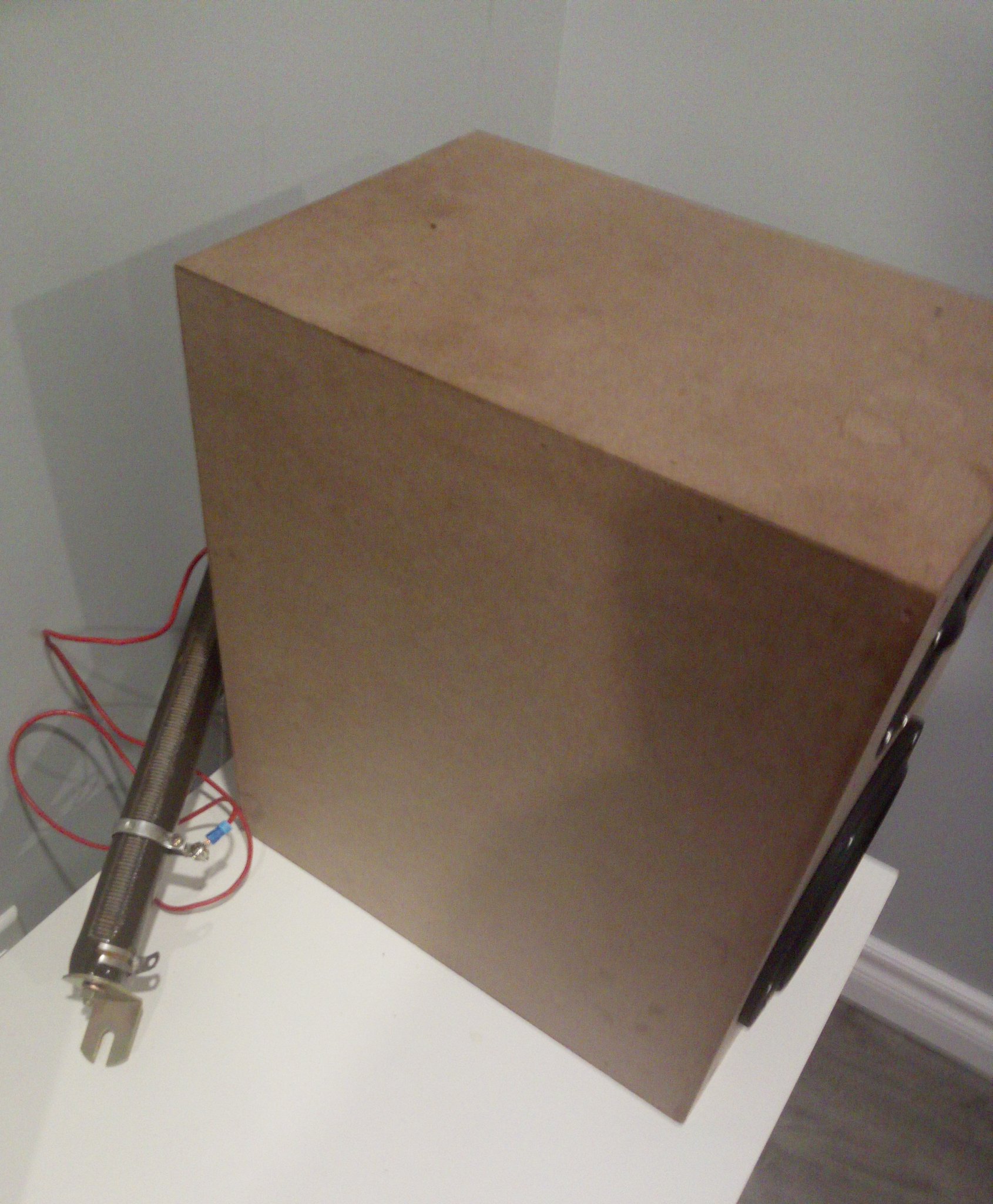

What I can suggest is to connect the crossover components outside the cabinet so you can make changes with different values and decide for yourself which ones suit your needs and taste best. Of course, if you can combine this approach with measurements, that would be even better. Unfortunately, I’ve sold my speakers and cannot be of any help with additional measurements on my part.

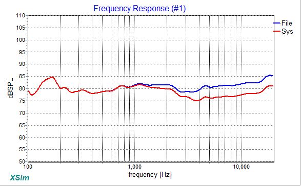

I was able to build the 2.2s with the SE modification. I found the tweeters very harsh and loud so rewired the crossover to Bi-Amp them, since it already came with the right binding posts. I was able to control the level to the tweeters with a separate amp, but since then, I am using a Carver PM1090 (amazing!) and am using the A + B outputs (A Lo, B Hi) but unable to separately control the gain. Again, the highs were too loud and harsh, so I used my adjustable resistors in series with the tweeter input and was able to quite down the tweeters. I'm sure I changed something with the crossover frequency, but whatever I did made an amazing improvement. I ended up with a 15 ohm resistor to replace the 6.8 ohm one and these little things sound spectacular. I have documented all of my changes in this modified drawing. Happy Listening.
15 instead of 6,8 Ohm sounds like way too much, in my opinion. I can hardly imagine these speakers having even remotely decent treble with so much resistance in front of the tweeters. You made me dig for the old files of this project and load them in XSim. Let’s have a look…
OK, now ignore the ramping up frequency response in the top end - it’s a result of a bad amp used for the initial measurements. In reality it’s much better. The red trace is the response with 15 Ohm resistor and the blue one is with the SE modification (6.8 Ohm resistor). The deference appears to be around 4-5 dB!

This could have to do with his musical preference, position in the room, and speaker spectral balance preference.
1. He is in a corner and right next to a wall
2. He may listen to compressed rock music
3. He may prefer a polite tweeter with a BBC dip due to the other 2 criteria.
I don't think his response as you modeled it is actually all that terrible.

Yes, 4-5db is about what I hear, thanks for modelling that. I am playing very high end DSD files ( jazz, contemporary, dire straits, lol) and am in a loud room, right speaker is near a corner. I have burned in the speakers for over 100 hours and treated the floors and walls (not shown in the picture). I do believe that separating the high and low drivers with bi- amping has made a huge difference in the punch and soundstage. I am doing this with my Kef LS50's and they need more gain on the tweeters, again, very subjective to ones taste. The nice thing about bi-amping is it allows the flexibility to do the separate adjustments, either with separate amps or with external resistors.
On xsim I tried the impedance compensation (CR) network, with the 1,5 uF capacitor and the 6,8 ohm resistor across the tweeter that Allex came up with and it seems to do a similar thing to the FR as changing R1 to 15ohms. I was going to change the 6.8ohm for a better quality resistor anyway because it's in the series path with the tweeter, so I only have to buy a 1.5uf for a few bucks.
