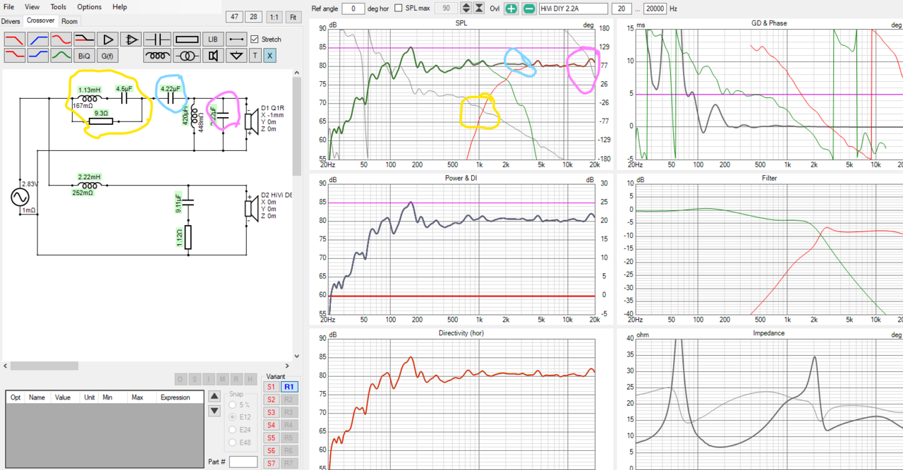

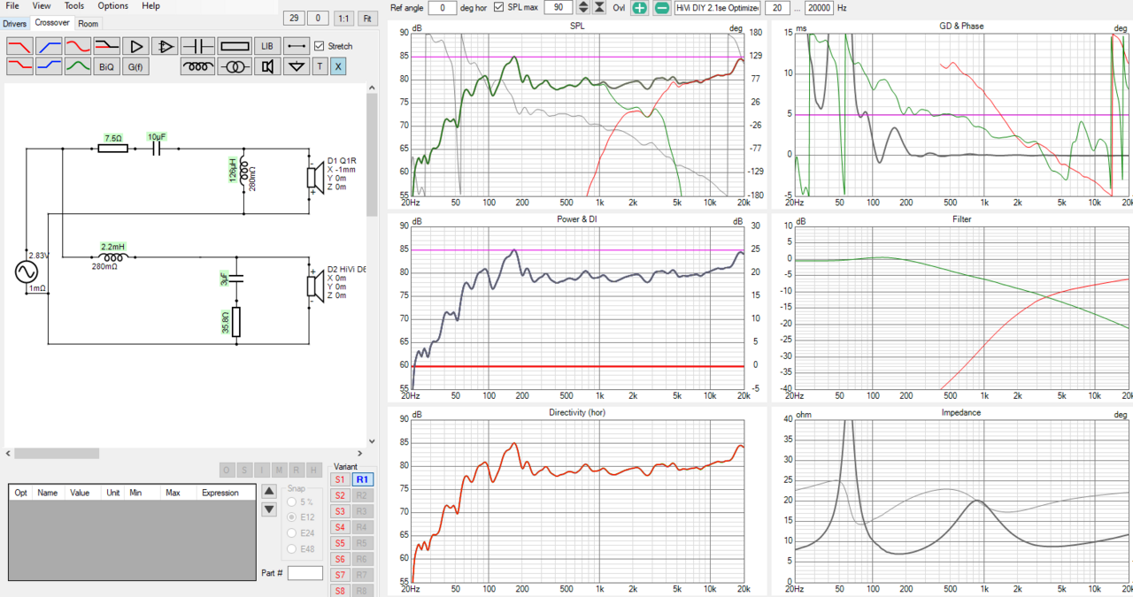

Hi, here my learning process update, which by the way don't know the names of what i did. So what i learn is:
1. the yellow thing --> inductor + cap in series with a resitor in parallel will kill the pick to the left of the high pass filter.
2. the blue --> cap controls the high pas filter and controls the pick at this point
3. the pink --> cap in parallel at the end controls (lowers) the high frequencies (15k+) picks
here for comparison 2.1se and the one i just said. sorry for my lack of terminology

I've not seen the 'yellow' done before as you have. Normally, the rise towards Fs is treated by an LCR across the tweeter's terminals. Not that what you did does not work.
Pink- I would not leave that alone without a series resistor on it, as that will be shunting to a very low impedance in that range.

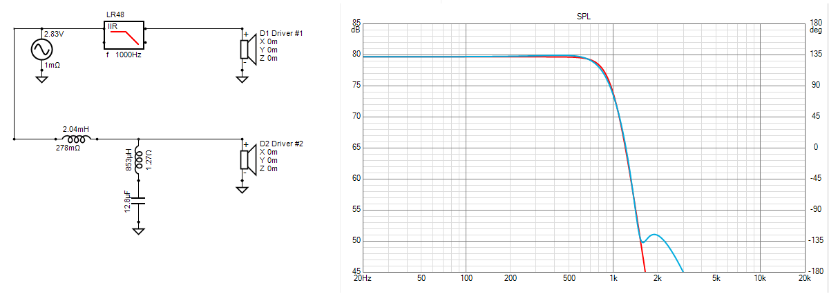

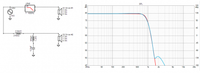

72 components for 48dB? Not a chance.

Once again... second kit 1 damaged the other with only one front baffle
will i ever get to build my first DIY speaker?

Hi michaelcpu. I have was about to write up a follow up on my about the mods i have was simulating. i have come to a crossroad. i started working with the FRD files on this thread which are the measurements made by Alex with the drivers mounted on the cabinet. recently i went back and forward with the tweeter hence i found the lump and dip in the 2000 and 2700 hz threw me off hence i did not see this in the spec sheet's response graph of the manufacturer.
so i started learning to extract the graph (what a head ache). when applied this frd files to the crossover this was a hole different ball park.
this lead me to look at the b6.8b frd file from parts express and OMG rad change.... so extracted the graph from the spec sheet. Now i have 3 different FRD for the same driver all of the really different from one to the other. further more found a forth frd for the woofer from another driver reviewer with totally different result. the main difference on the woffer's files is at the (forgot the proper terminology) breakout/distortion point around the 1000-2700 and placed at different frequency in each different frd files.
at the end, i sent for my version 3.9uF .33mh on tweeter and just eliminate the woofers resistor until i buy a calibrated mic and generate my own frd files and build a crossover based on my drivers and box assembly.
Or if anybudy can direct me to the wright path.
