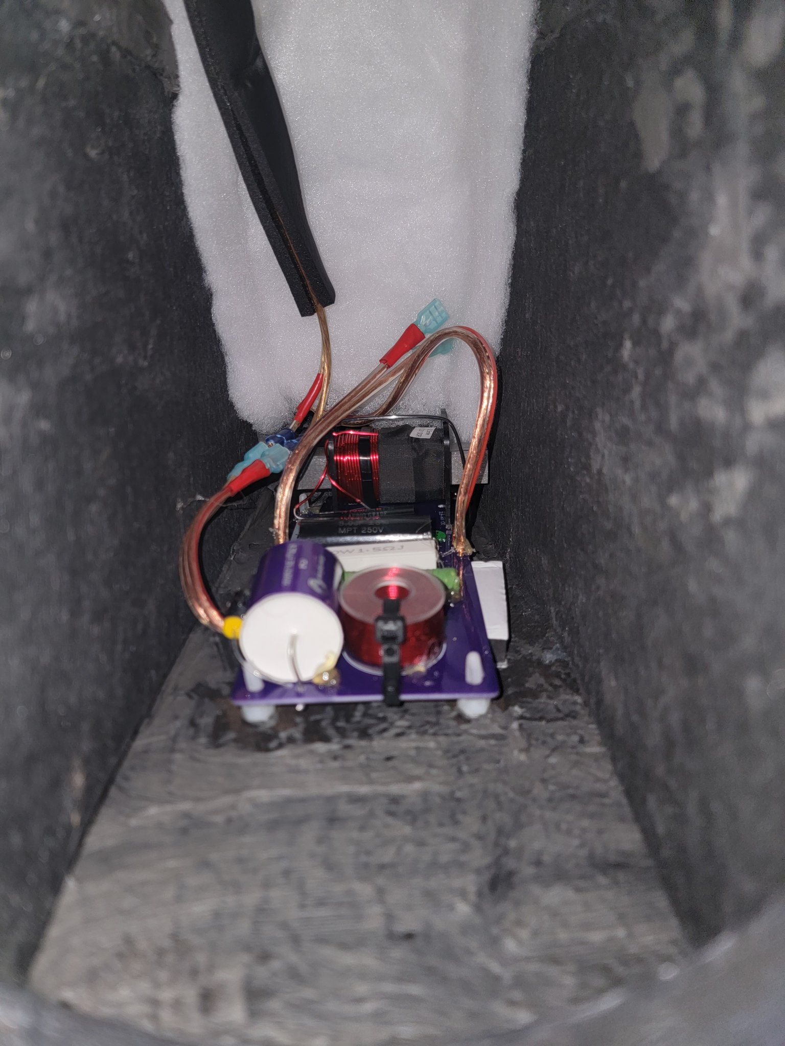

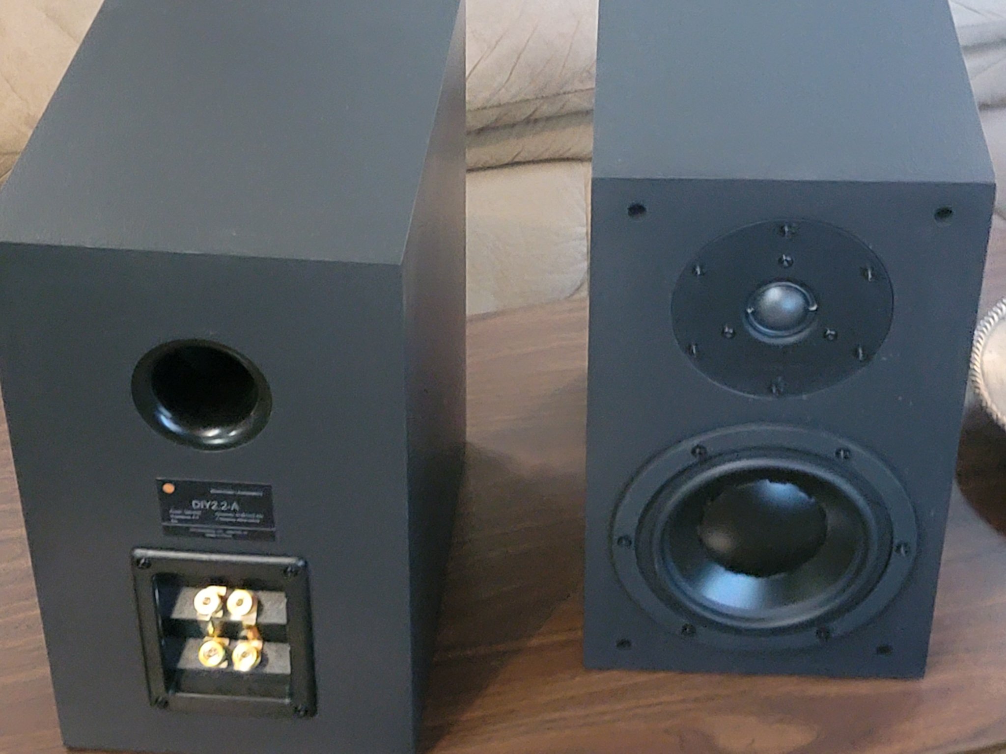

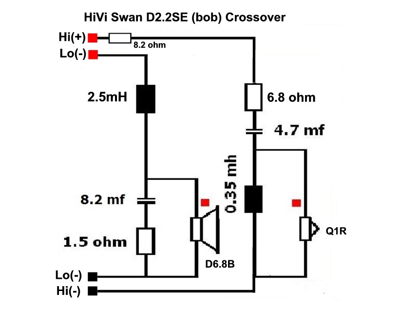

Finally got my babies finished. I ended up adding an 8.2 ohm resistor inside the box between the hi input binding post solder tab and the wire to the hi section of the crossover, so I didn't have to change the 6.8 ohm on the board and can easily adjust later for different setup. These do sound really good.

Be aware of the effect of burn-in!
I bought the kit recently. Right after assembling, it sounds plain. I ran 20 Hz sine wave on them for around 10 hours. Bass came out and was amazingly full. I decided to run the Stereophile burn-in track for another 10 hours at a reasonably loud level. The speakers sounded bright afterwards. The bass level did not seem to change much based on the KRK level meter app on my iPhone. Sound level jumps up around 2K Hz and are 5 dB higher above it.
My listening room is 15" X 20". I placed the speakers against the short wall. They are 3 ft away from back wall and 5 ft from the side walls. I tried them in my large living room and kept them 5 ft away from any wall. They sounded clean/dry and required a lot more amp power to reach loud listening level.
So I replaced the 6.8 uF capacitor with a 4.7 uF blue Rifa PP film capacitor. This reduced the brightness. XSim indicated substantial drop of tweeter level at 2K Hz. This may explain the change. But the bass is still too weak to my taste. I will let them play more before replacing the inductors with 2.5 mH ones.
I think the kit has the potential to be great. I listened to the tweeter and woofer output at 2K Hz. Unlike some of my other speakers, the woofer and tweeter sound quite coherent. The only concern I have is that violins can sound harsh for some recordings. Maybe I also need the 8.2 ohm resistor in the end.

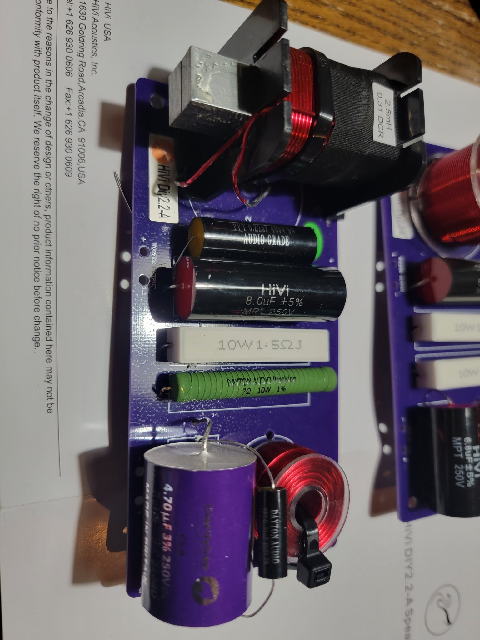

Just finished my speakers and in the middle of breaking them in. Went with the 2.2se crossover, went with the 2.5mh inductor, Clarity 4.8uf, a better resistor for the tweeter, and some Dayton DFFC bypass caps- .01uf tweeter/ .2uf for the woofer. They sound great! A little bass heavy, I don't think you would need a sub for music but these will be used as my mains for my surround system. I might try a 2.2mh or 2.0mh,but I will use them like this for a while and eventually measure them.

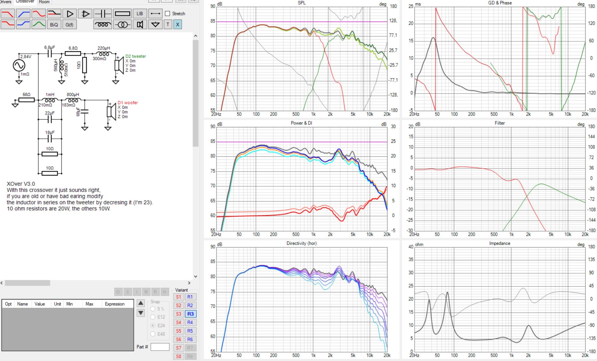

these are my measurements and the crossover.

definitive crossover:
10ohm resistors on the woofer are 20w, the 10 ohm resistor on the tweeter is 5w;
on the woofer use a 0.8mH inductor (jantzen ferrite core 0,8mH - 1,0mm, 0,182ohm rdc) less resistance is better.

the crossover has been tested and create no, problems. The resistor isn't mandatory as it doesn't change the response, it just helps the amplifier by smoothing out the generator load phase. it is a 10watts resistor and by raising the voltage up to the maximum tolerable by the woofer and tweeter it dissipates less than 9 watts
This is still not a good practice to add. That resistor alone is a bad idea. If you want to use an LCR across the input and limit the range the resistor sees where the swing is problematic, this is usually a much better scenario. Please, do not place a resistor across the input, nor advise others that this is okay. It is a bad idea.
Using a resistor in parallel on the input could cause problems, but in this case the absorptions of all the resistors have been calculated and none of these give problems. It is a very high resistance so in this case very little current passes through it and helps those amps that don't like 45° loading. I haven't mentioned this before but the 6.8 ohm resistor on the tweeter is rated at 20watts while the 10 ohm resistor on the tweeter is rated at 5watts. For the capacitors, those in parallel on the woofer are electrolytic, you can put smaller mkts in parallel if you want to spend more.

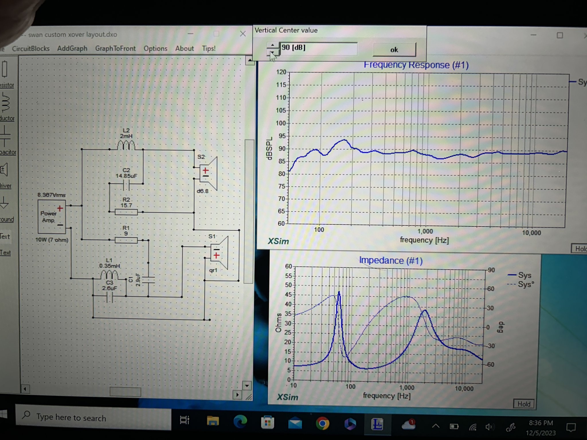

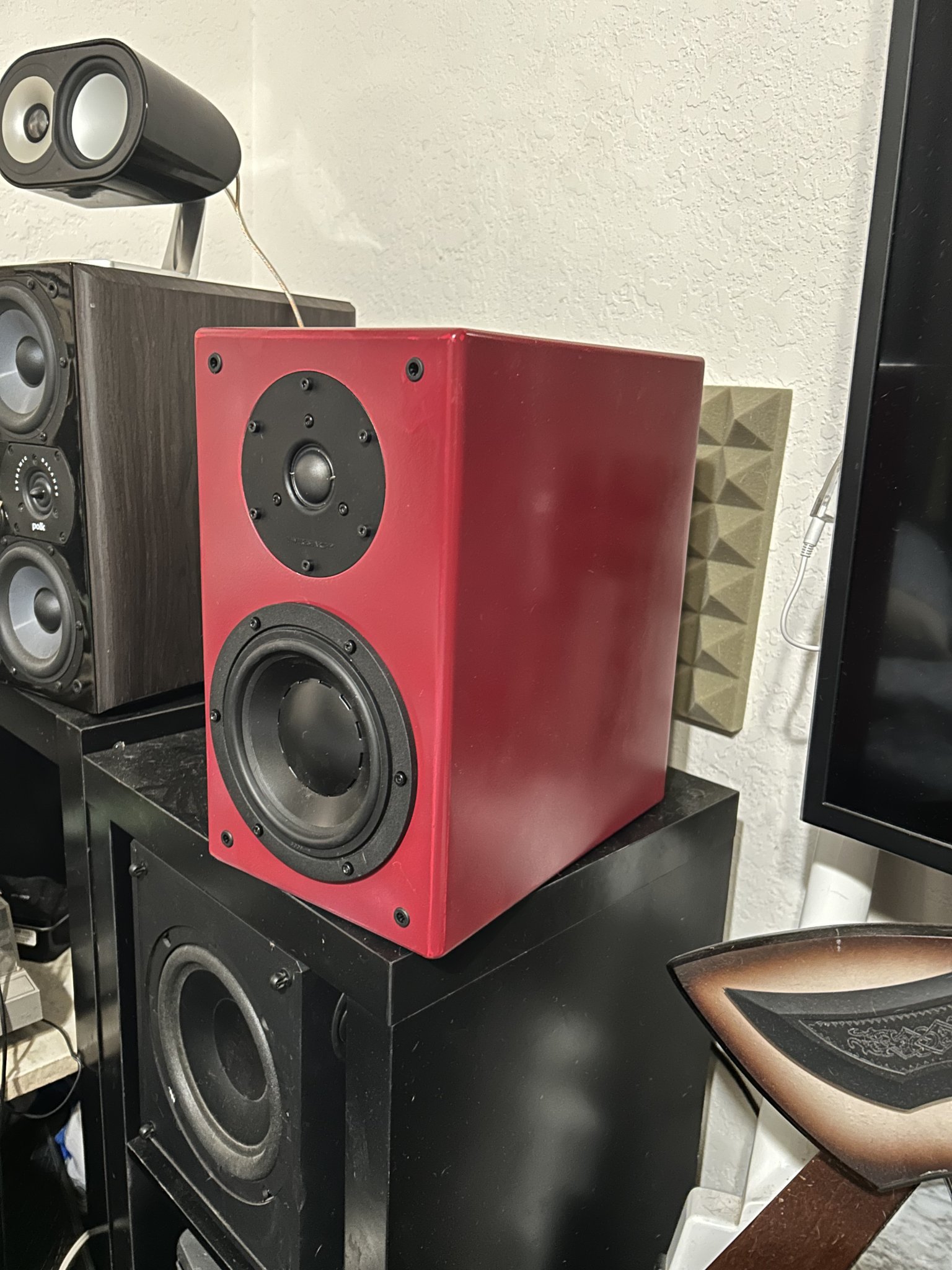

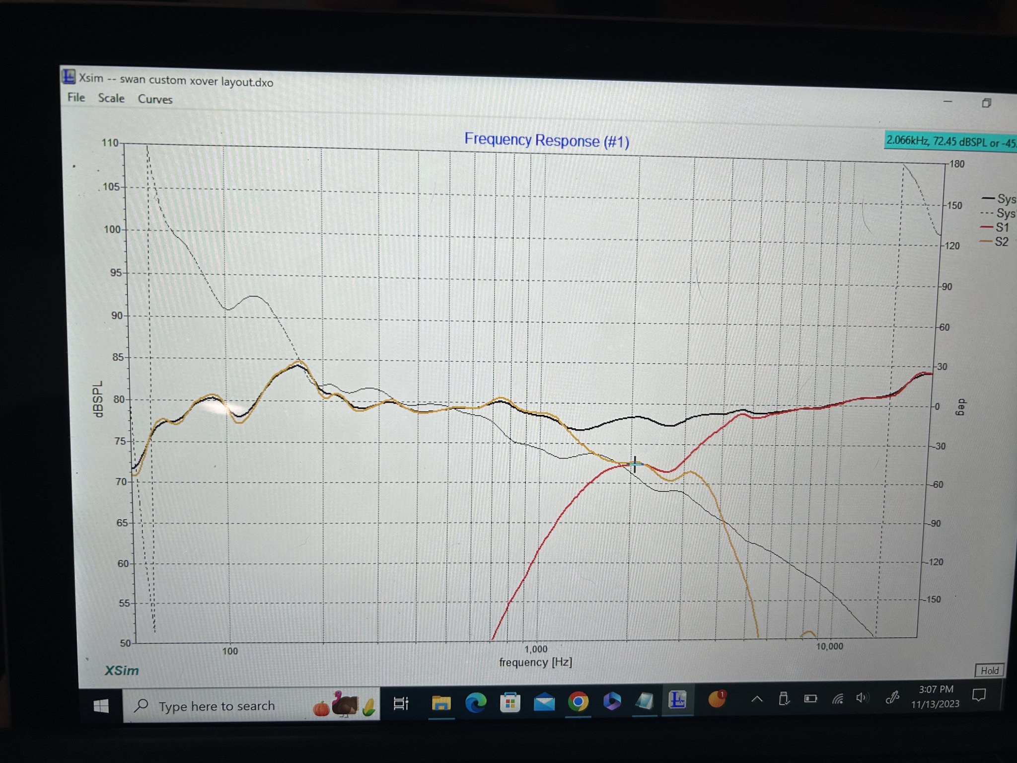

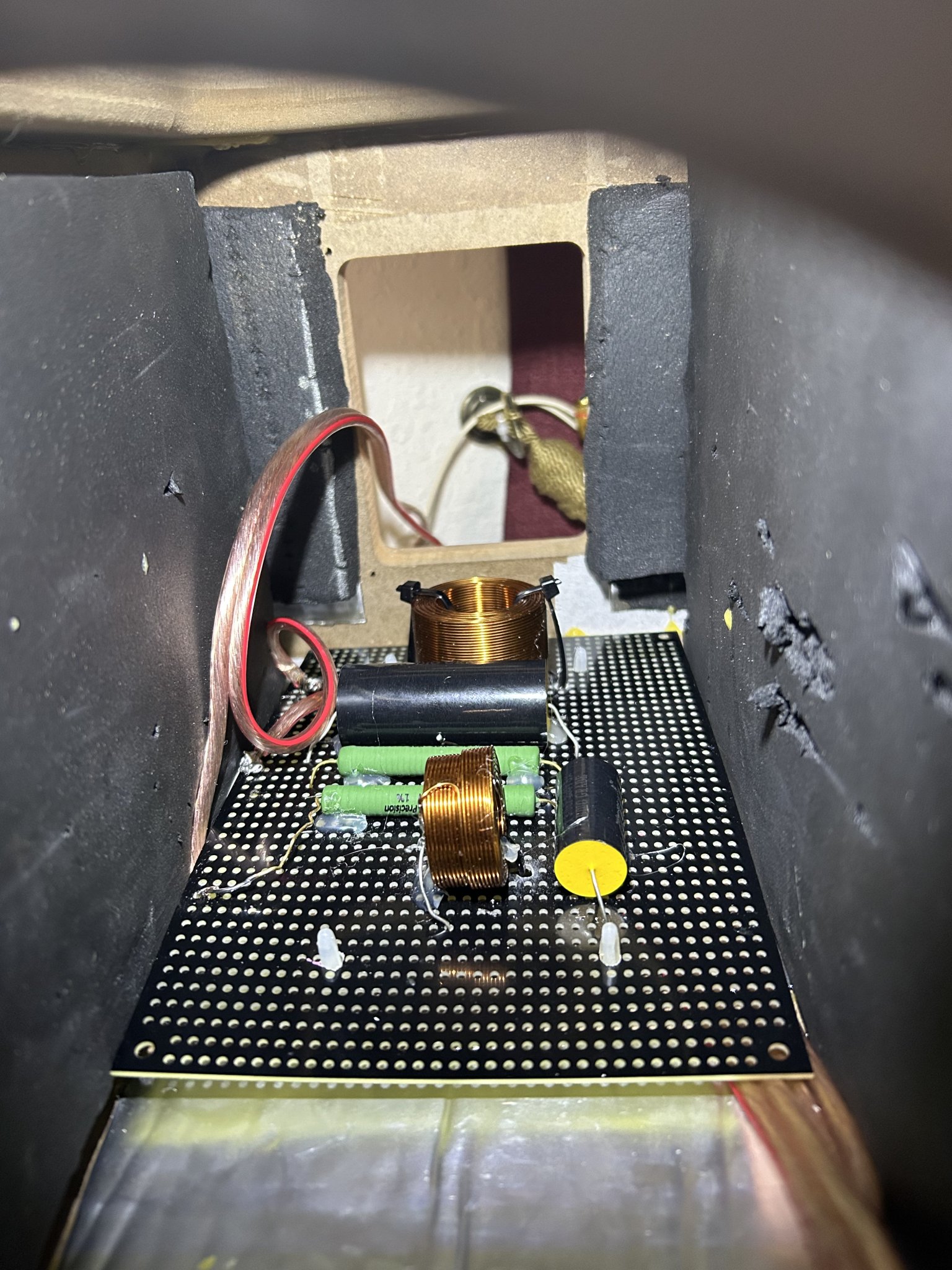

First time doing this sort of project, ended up just doing my own crossover in xsim. Don’t know if there are any problems in the design, they sound a lot better to me than the original crossover.
Thanks AllenB, appreciate the feedback. Don’t know about the software to much or other considerations (such as baffle step compensation etc) My original crossover sounded harsh (graph pic below), so I added the 2.6 cap in Parallel with the .35 inductor. Also did put some foam in the port to reduce boom on certain music tracks.
This will probably be my only diy speaker build, but had fun and learned a lot from all the people in this forum, so thank you to All.
