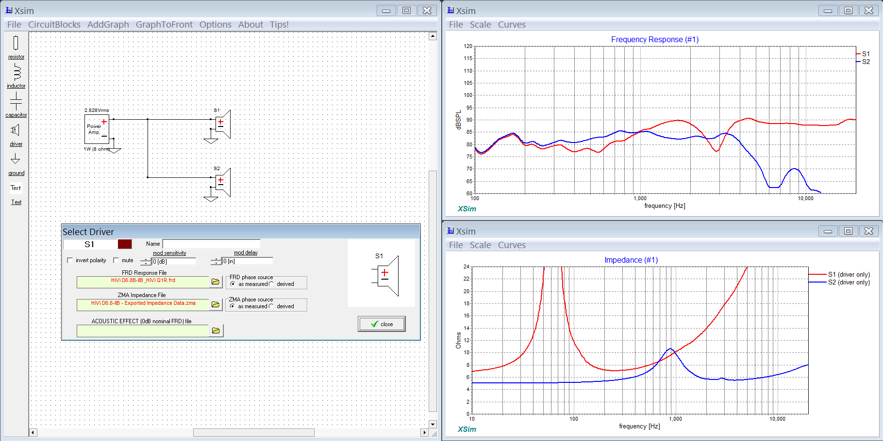

I think it'd be helpful to get Allex's files and use Xsim to play with different values for the crossover parts. I just haven't taken the time to do that. When I have a lot of free time, I'd like to play with that.
In general, I would think tweeters should not be crossed-over too low. It's not obvious to me where the crossover point is, thus the desire to get Xsim working. I'm a bit confused as to why there's a difference there in the 2.2DIY and the 2.1SE, and hopefully the xsim plots would clarify that. I'm wondering if the mids actually are raised that much with the .5ohm that it means the tweeter can then be crossed higher to get out of the way? Also, Xsim should let us know how much bass we really gain out of that inductor change.
Below you can find the files from my measurements that I used for the simulations. You might be interested to use them until you get your microphone. The file “HiVi D6.8B-IIB & HiVi Q1R.frd” represents a measurement from both drivers in the speaker cabinet without any crossover. I used this file to determine the relative delay between the drivers - something that is quite often neglected. The ZMA files are taken with DATS v3 as a “free-air measurement”. I hope that would be of help.
-@llex
I have downloaded the Xsim software this morning, it say it is something wrong with .frd and .zma files when I try to load them in to the speaker tuning in the software.
//Peter
There is still this dip at 3k. I also tried it with the original 6.8 mfd caps, only changing the woofer’s inductor, and that dip was still there. I couldn’t tell much difference between the two, really, but decided to stick with the Swans 2.1SE design, and ended using the new caps. Will listen for a while, but happy to have the missing bass.
I got Xsim to work so I have been playing around a little with different crossover configurations tonight, to get rid of the dip at 3k you should change the polarity on the tweeter. You might get a small hump instead but that is possible to correct by increasing the value of the 1.5 ohm resistor to 5.6 ohm. The increased value of the resistor will also give a little more of bass.

If it is a Linkwitz-Riley 2nd order filter, which it looks as if you look at the electric behaviour of the filter in Xsim, the polarity of the tweeter should be inverted.

I finally got the circuit modeled in Xsim. I played with the 1.5 ohm resistor, substituting different values, and I only see it affecting the midrange, not the bass. I don't see this as making it better. I flipped the phase of the tweeter (there's a menu entry for "invert" that makes this easy), and that does fix most of the dip around 2 to 3khz. I can't believe the other designs don't have that. SO, I think I'm just going to make that one change and maybe I'm done tweaking. (I already have the 4.7mh cap change, which I think is probably an improvement, as the 6.8mh gives it a peak at 2khz, although that, too, is kind of hard to tell if it's an overall win, as the 4.7 has a slight dip at 3khz, even with the tweeter inversion.) Xsim shows the treble with a gentle increase, but it seems so slight, I'm not concerned about that. I think I'd like to try to invert the phase and see how that goes. Unfortunately, I didn't use slide-on clips on the tweeters -- I soldered the wires to make them more secure. So, that'll have to wait .

Seems odd. I can't say I can tell much of a difference after reversing my tweeters. Measuring, it does eliminate that 3KHz dip.
