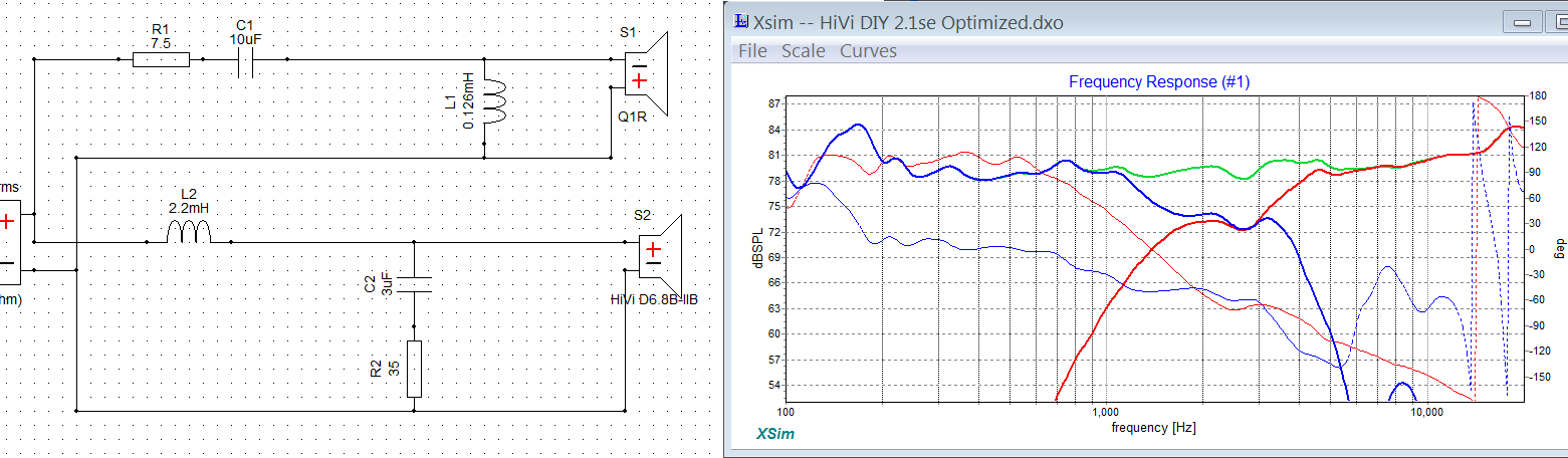

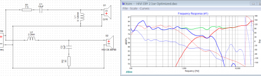

First this is my first DIY and learned a little about crossovers with you guys and a little reading. practiced a lot with XSim and the response files provided on this forum. out of that i build virtually both crossovers and the and visually (by graph) the Mod by @Alex looks flatter and the SE looks more lively or happy faced. thow, both look lots better than original. building both from scratch and using the midpoint cost of each component summed to at around 130-170 USD. this means that if i go with original price of 235 plus the crossove mod it would be 365 to 405 total cost. not mentioning the 3.1a that would come up around 470. included the frequency response graphs for both crossovers and also the tweeter polarity inversion graphs (they look nice but dont know how they would sound) please notice that all i have done is play with XSim i have not heard any of them.

(And I kept staring at the graph until I flipped the tweeter polarity. I don't understand why that wasn't in either of the plans.)

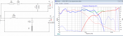

Thanks. I did the same with the polarity. Also found that raising the crossover point and eliminating the woofer resistor the curve became more flat. But then again this is my first time with crossovers and xsim. Value i changed was 3.9uh cap and .33 mh. Again in xsim.
I've layed the plots out differently. If you did the first one without looking at it this way, then I think you've done very well. In the second one you can see where it wants some adjustment.
