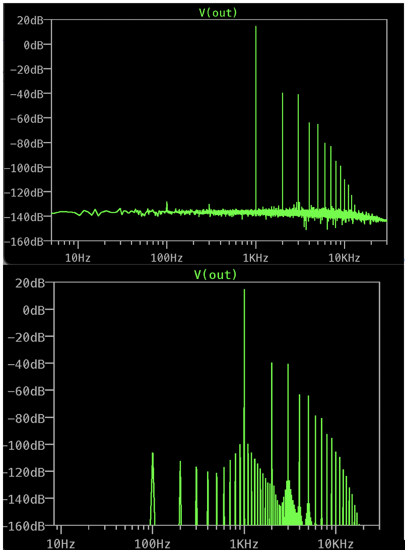

It is only a simulation, but I think the muuuccchh capacitance approach likely might not be the best option. Thinking about what PSU to use, I play with LTSpice and below are the two FFTs for "regular PSU" with 680,000u per rail vs. capacitance multiplier with 40,000u per rail. The top diagram is the FFT with CapMx at 10W RMS. I will definitely use that, as I will not go the battery lane 🙂 . CapMx looks like a good alternative to me.
I am surprised at the 2nd / 3rd levels: high and the same. That means to me the input could (should ..) be biased differently. At least - in the sim.
I was surprised too. According to Hiraga's original article (and if I understand the French->English translation correctly), this is the typical THD of the FET cascode. He says to "somehow get rid of using the right BJTs", in his case 2SC1775 and 2SA872.
At least in the simulation, I am not able to get the desired falling THD behaviour reliably.
What do you think could be a way to bias differently to achieve it, @triode_al?
In any case, I will measure the THD before building an expensive PSU.
Edit: also, @triode_al , you said the level of the THD was high. The diagrams are for maximum power of the amp (or at least near), total below 0.1% depending on R values down to 0.02%. Is this unexpectedly high? What would be the expected THD at 12W on 4Ohms?

At 10watt the amp is near clipping; so then such behaviour of same 2nd 3rd might easily arrive.
How to force more 2nd? Well first of all, don't go beyond 3 watts. That loud enough mostly. --> show the distortion at 1 watt.
And somehow measure a real performance. e.g. with REW I heard it could be done. [I never did that]
  • Then there might be some tricks to try to get more 2ndH/change the phase. But it requires some experimentation.

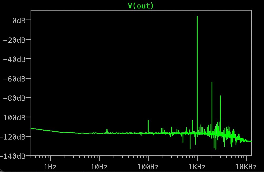

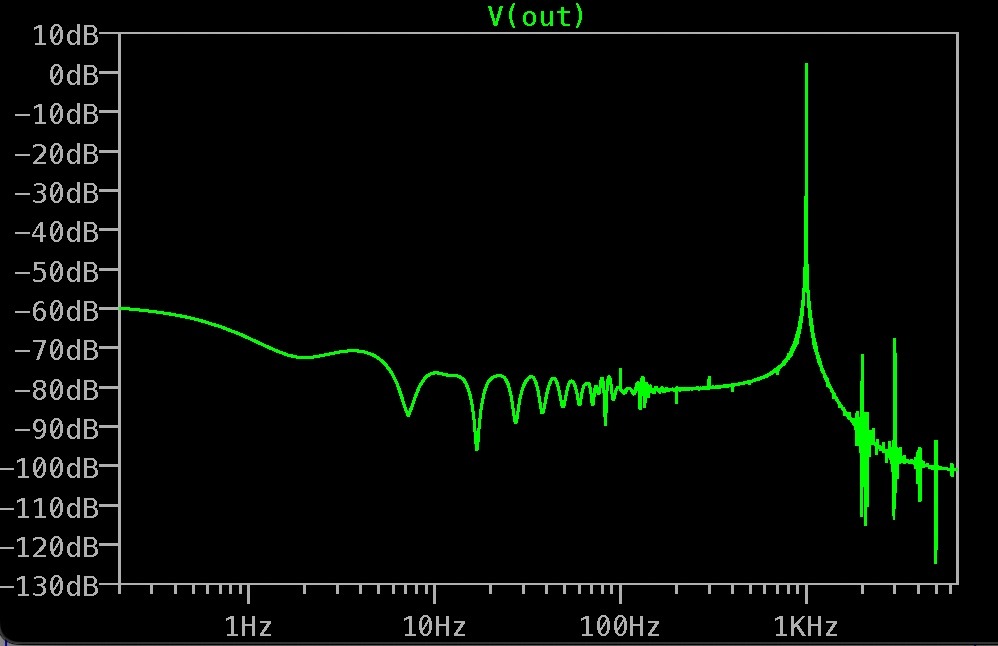

In the simulation it is getting worse with lower power, though. The attached FFT is for 1W RMS.
Need to correct myself. Had gotten lost in one of the variations I had played with. Similar PSU to before, 1W RMS looks promising.
And BTW... this is still the Capacitance Multiplier PSU. I think this is really encouraging to be tested.
