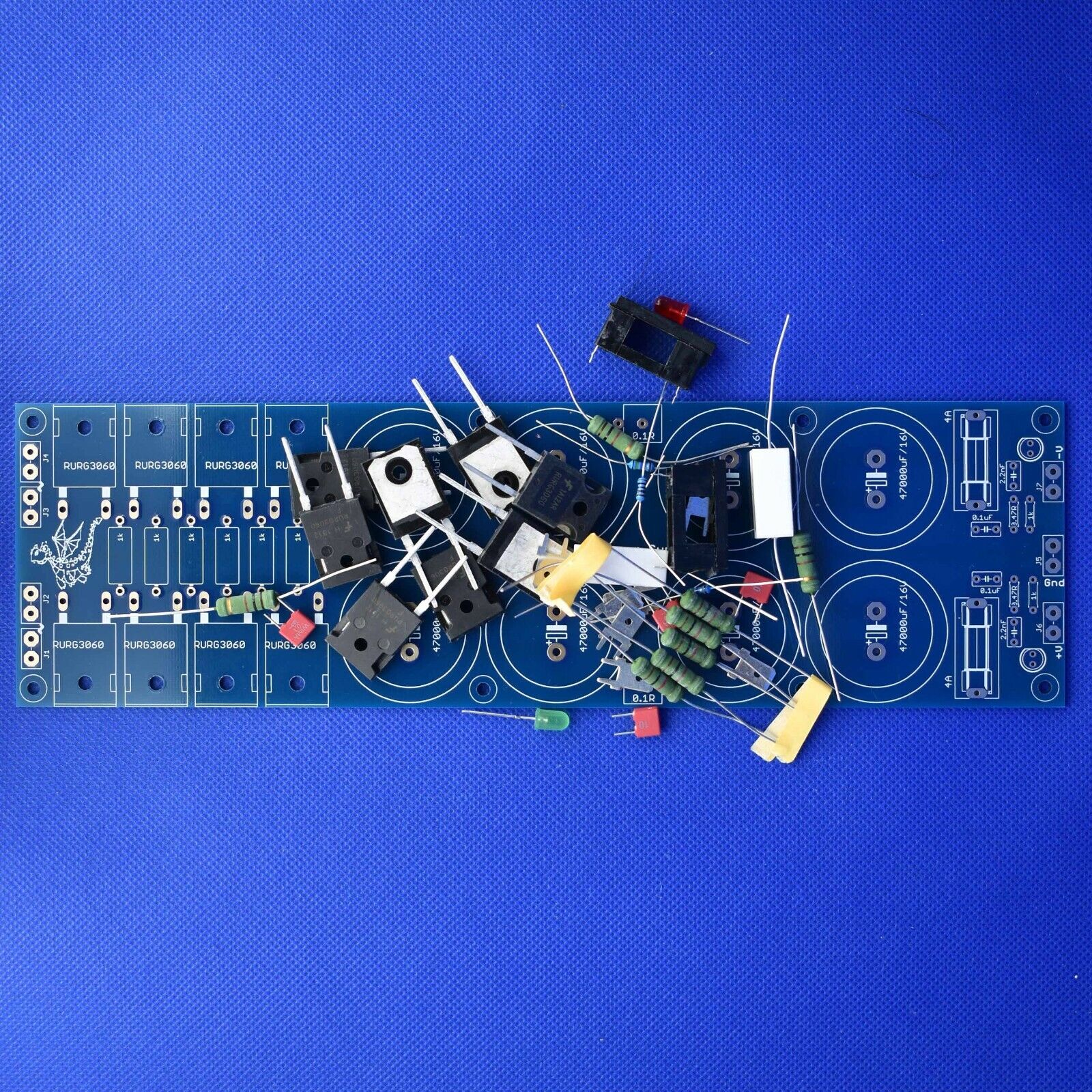

Greetings again, I already ordered the following components
Hiraga "Le Monstre" 8W A class Amplifier blue board​
Hiraga A Class Power Supply PCB D.I.Y​

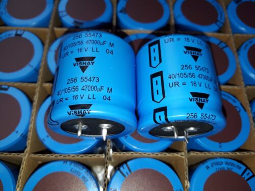

VISHAY 256 47000uF 16v Power Miniaturized HQ CAPS FOR AUDIO HIRAGA AMP​

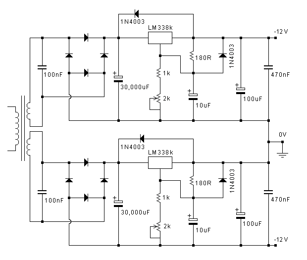

LM338 Linear Regulated Power Supply Board 15A DC-DC Converter Board​
I already have the chassis with heatsinks, it is small, which is why the psu will go in an old chassis of a sff dell 3040 pc, also have the 250 watt toroidal transformer (45-0-45-15v-0-15v).
Thanks in advance for your advice.

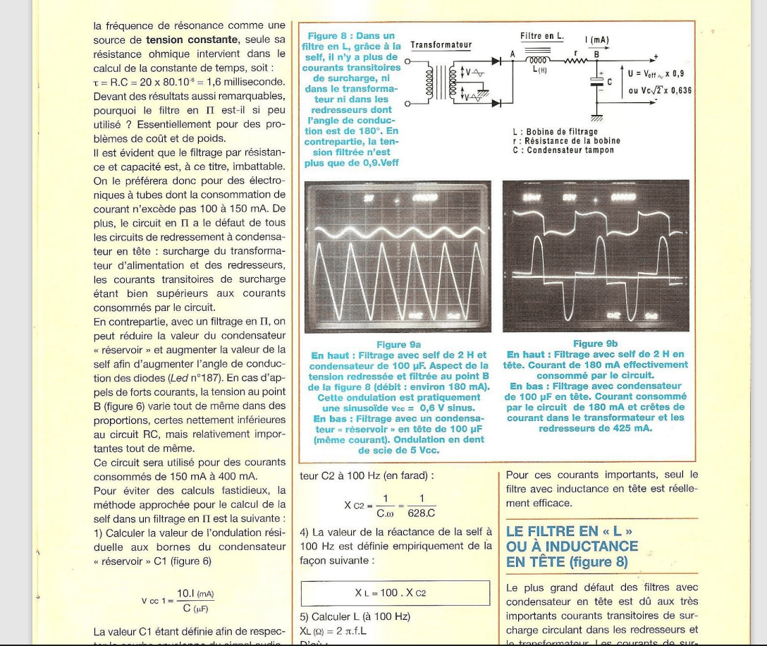

Hello,
The soft start will prevent the fuse to blow but there will still be a an on/of switching with current peaks much higher than the average current. In the attachment it is just a modest 180 mA which already has peaks up to 425 mA.
By introducing an input choke the current being drawn will be close to 180 mA ALL the time and the ripple will be smaller with a much nicer '' shape '' as you can see in the left picture.
A Tent shunt is a tiny circuit by a famous Dutch designer that is not series but shunt regulated. Just google.
Greetings, eduard

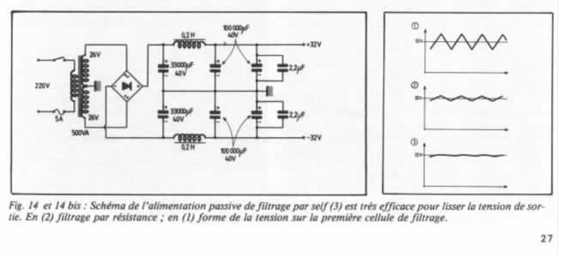

Hello,
This was published in 1988 in french l'Audiophile magazine #43 written by Mr Johannet and Mr Walther
The choke was a 200mH model 0,7 ohm dcr. I used it in my 30 watt Hiraga and it was first used in Le Nemesis ( single ended transistor amp by Jean Hiraga.
Right drawing
#1 the shape of the '' dc '' at the first cap
#2 the shape at the second cap when using CRC
#3 The shape at the second cap when using CLC.
Pretty obvious. RC is only 6DB and LC is of course a 12 DB filter.
Greetings, eduard
