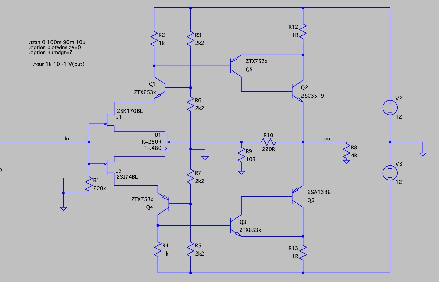

I am planning to build a Le Monstre shortly. Of course I will not be able to get hold of the original FETs, so I will be using matched pairs with about 7ma Idss.
To understand what I need to change to make that work at least similar to the original, I modelled the HLM in LTSpice. Looks like the only thing needing to be addressed is the DC pot? The value below is what works well for 4R load. For 8R load, a higher value (330R or so) worked better.
For 4R load, I am getting 12W RMS with 0.3% THD. 1W RMS with 0.04% THD. Does this sound reasonable?
Below you can see the current model and chosen transistors. I chose the Zetex because they have really low noise, I read.
As power supply, I intend to use a Cap Mx, looks extremely nice in LTSpice, with about 1-2mV ripple.

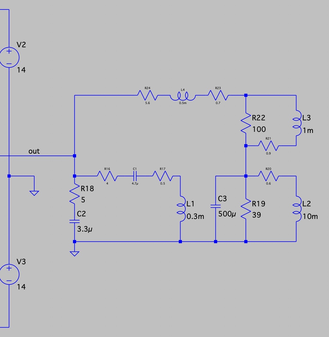

BTW, @triode_al, what is the load circuit you are using in the LTSpice model in https://www.diyaudio.com/community/threads/hiraga-le-monstre.5462/post-7075241? A cross-over?
Any comments on chosen components or else are highly appreciated.

Hi Mo, I used a traditional looking tube amplifier. But it was not: symetrical; 6J6 entrance, E90CC output. And +/- 150V.
In your implementation: please add a source resistor in the input, some hundred ohms.
As power supply, I recently like the SMPS packs, they are handsome and come 'ripple free'. [In my current amplifier, a Pass V-Fet, my output noise is . . . 0,1 mV]
There are complete filter packs to reduce the last switching noise. [For +/- use, you have to turn around the electrolytics of course yourself]

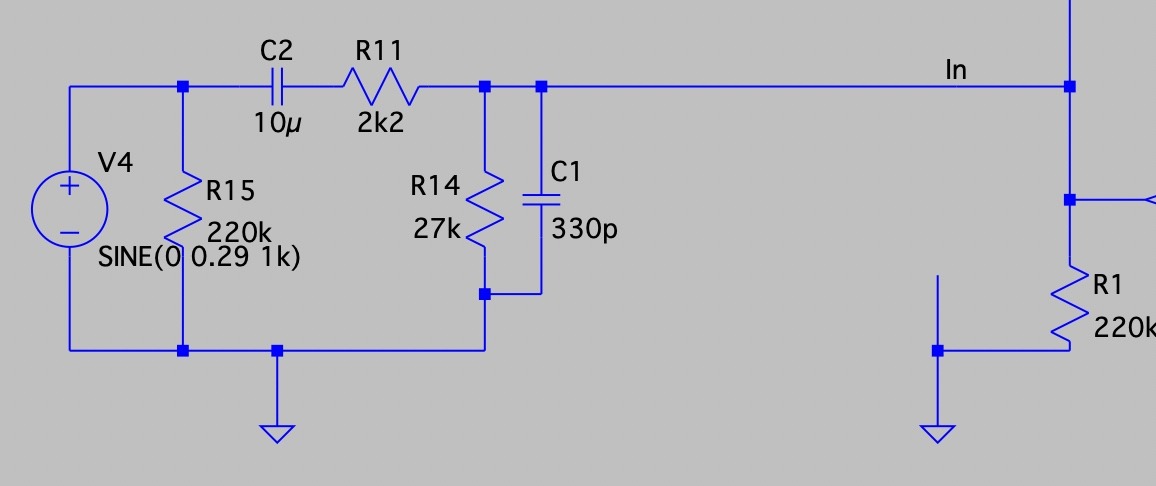

I was referring to the circuit in the attachment. This is from your spice file. Not sure how your comment about a tube amp relates to that 🤔.
Yes, I will most likely even be using capacitor coupling with the attached circuit, just to be sure I can connect any preamp.

Thanks. I have seen two approaches to get the correct idle current with higher Idss FETs:
1) Lower the 1k to what you say, like 470R-560R
2) Raise the R of the pot to about 200R-250R
In spice, both seem to have a pretty similar effect. Is there a strong pref to either? If so, why?

You misunderstood me! Use everything as the original circuit is! Only replace at the negative rail voltage side the 1K with 470R at the positive side instead using resistor use a trimmer to set up the DC. Because of your different J Fet type or grade. Use a multi-turn pot as a variable resistor and adjust according to to your need.
Do not touch the original trimmer value. I will take a look at the schematics and will post it to you with the suggested values to avoid the further misunderstanding.

Sorry, not sure I am following. The "new" schematic on the website has all Rs different and uses other FETs. And it still has only the DC offset pot.
And I think you speak about using 2 pots? What for? Finding the replacements for the 1k Rs to get the correct idle current?
According to what I see in LTSpice, I am getting a little over 1A idle current with Rs changed from 1k to 560R (needed for 4R speaker for staying in class A over the full power range). The DC pot can stay at 100R in this scenario.
Of course the 560R only work with the FET model I am using and the real FETs might differ in Idss again. So using a pot to find the correct value to replace the 1k's with sounds like a good idea.
Thanks, Mo

Yes, that is it. If you chose 1K Multi-turn pots you can set up your amp nicely after warm up with your J Fet Idds (what ever you get). You can do both 1K resistors. Set up 500R both side for start and you can increase it or decrease it based on your need. Changing the original (middle in the schematic) trimmer value it may change (alter / effect) the sound to. It is somewhat connected to the feedback, you do not want to play (mess) with that (unless if you have a working amp and do a very good listening test) A-B comparing between the two channel. This is the best way to preserve the original sound as much is possible. Listening to the amp and simulating is two different thinks. You want not just a good functioning amp you want a good sounding, reason to build one.
Absolutely true, the simulation is only as good as the models of the components and I am using it only as a validation step.
It is interesting to see though, how idle current, too low or too high, influences THD, e.g. And that can be seen quite nicely in spice.
I will also measure the final amp with the model and compare, and of course listen 🙂.

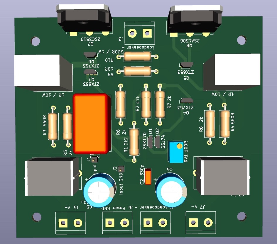

PS. current iteration of the PCB below, need to do a few optimizations, then I will send to the manufacturer.
The monstre you could, you SHOULD build without pcb.
Q2, Q3, Q5, Q6 - I would use the same, the one, complementary-transistors-pair. I would use TO-220-types.
R2 and R4 adjustable.
NO "double-mono-psus", NO channel-separate-psus! Do use one only. (Exacter: the necessary two: "+ and -" psus for the: 2 x "+ and -" amps;-)
Great pp-design! In principle, not as good as an se, but much much much better than the vast majority of pp-end-amps - price no matter!
My estimate: Both will reduce the 'amplification' in open loop. But having a higher source resistor has a stronger effect on lowering it.
albert
More than an estimate: a fact. Changing from the yellow grade to the green grade decreases the load resistor (original 1.0k), going blue grade or other types (#2189: 2SK246/2SJ103) is even more diverting from the original (2SK170/2SJ74 green grades are available still). And the yellows have the highest transconductance of the family, so other grades will have higher rs values, decreasing the open loop gain even further. If it drops to much, there will be lack of control and correction and error and distortion will increase considerable. The only way to keep to the original as close as possible is to add dc-current sources of a small value in parallel with the first stage load resistors to obtain the 'yellow' value of 1.0k again. The final values are almost always depending on the actual Idss and the stabilised setting of the Id of the fets.
Also, make sure that the Sziklai's have sufficient beta's nevertheless.
Which numbering are you referring to? The original schematic does not have any and your comments do not match the numbering on my PCB?
I will definitely go with a PCB, much easier to have control over path lengths (and keeping them short to minimize crosstalk), ground etc. The only amp I would consider building without a CB would be a SE tube. Why do you think not using a PCB is an advantage?
Same question for the advice on PSU... Why would you think one is better? Here again, I will do the contrary.

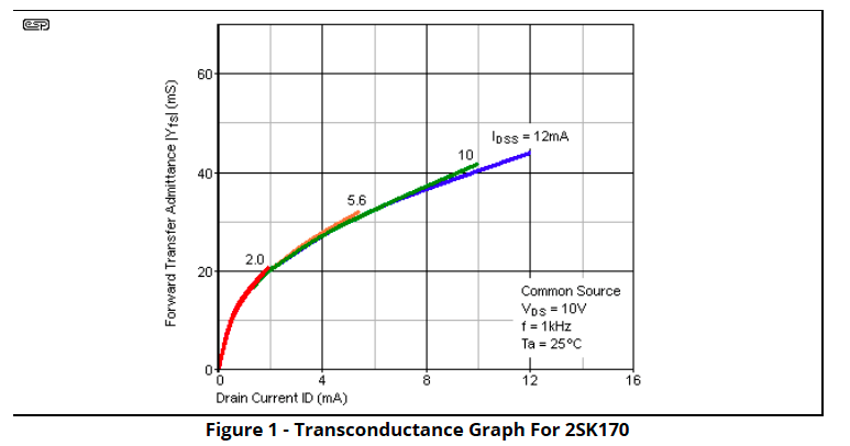

Why is lowering the Rs not enough to raise the open loop gain? Do you have a pointer to a CSS which could be used?
Ah, you said it, lower transconductance. I need to read more about JFETs. They are still rather mysterious to me.
EDIT: in the latest Toshiba datasheets I find the 2SK170A to 2SK170D (I know, all higher Idss than the Y) mentioned with same typical transconductance of 22mS. What was the typical value for transconductance for Y devices?

Here is a picture out of Rod Elliots reference article (supplied) showing the relation between 'colours' and transconductance.
Try to find old catalogues from Siliconix (late seventies, eighties) for an indepth understanding and application of Jfets.
Also, application notes from that era from various manufacturers are worth reading.
Most important conclusion is the considerable variation of specifications (Idss, Vgs) even within a colour or letter group.
Unless a 'production-stable' circuit is designed, one is obligated to select proper matches. Production-stable circuits yield less amplification in general (no free lunch) and often used for the high input impedance only.
