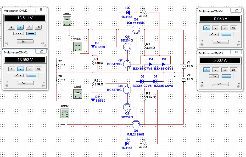

Hi. 🙂

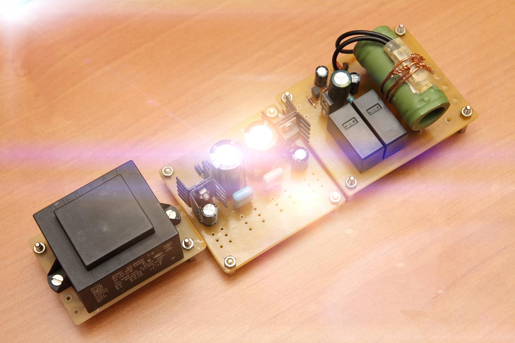

Discrete compensation stabilizator, as example. (not final version yet)🙂😀
Hi. 🙂
Hello,
I cannot judge if it will work. Maybe it does but it will sound bad? Better persuade sonebody who has an Hiraga or similar amp to build this circuit and see if it does give an improvement.
Greetings, Eduard
Hello,
Greetings, Eduard
When I'll make it - then I'll know.🙂

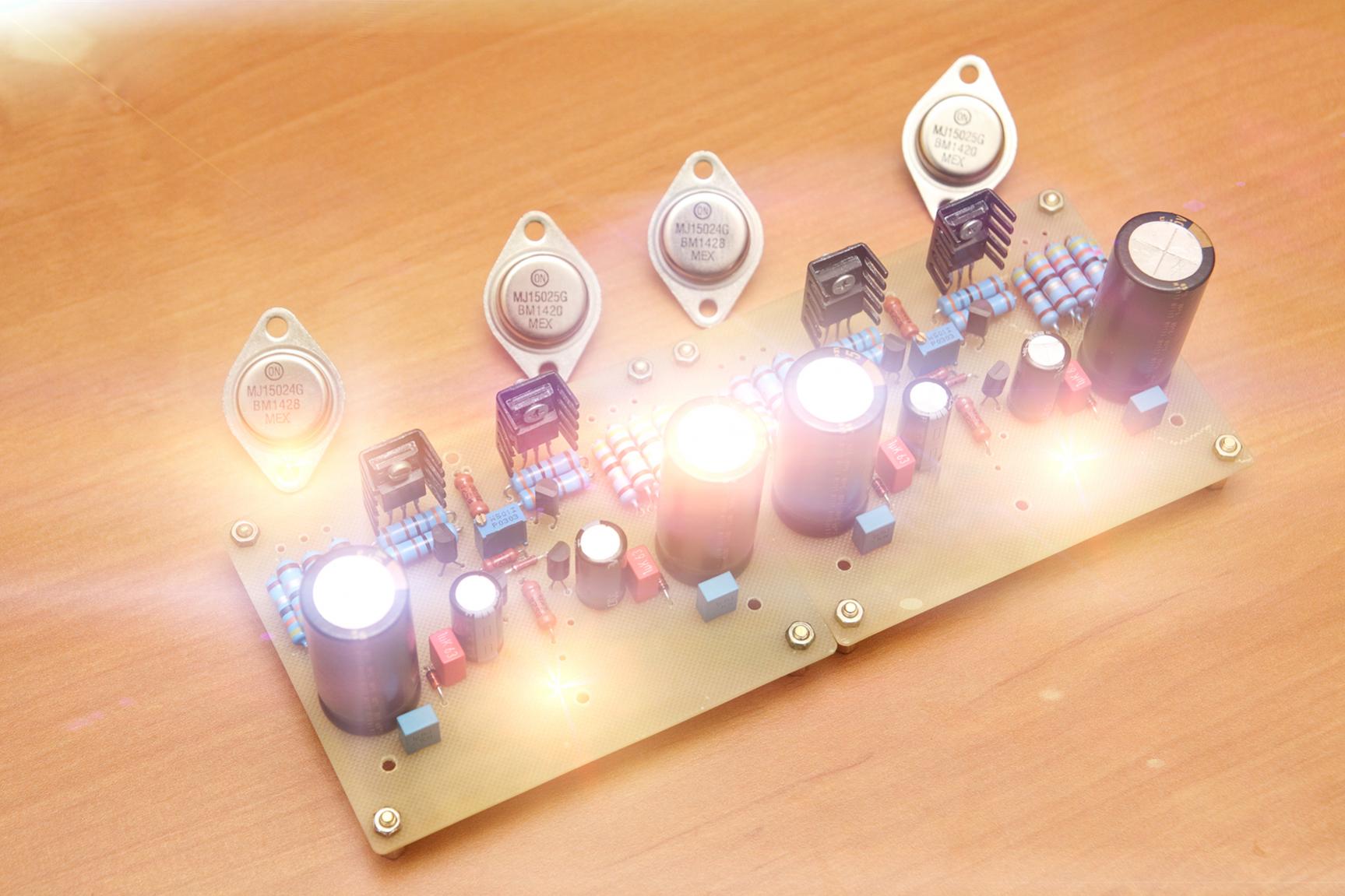

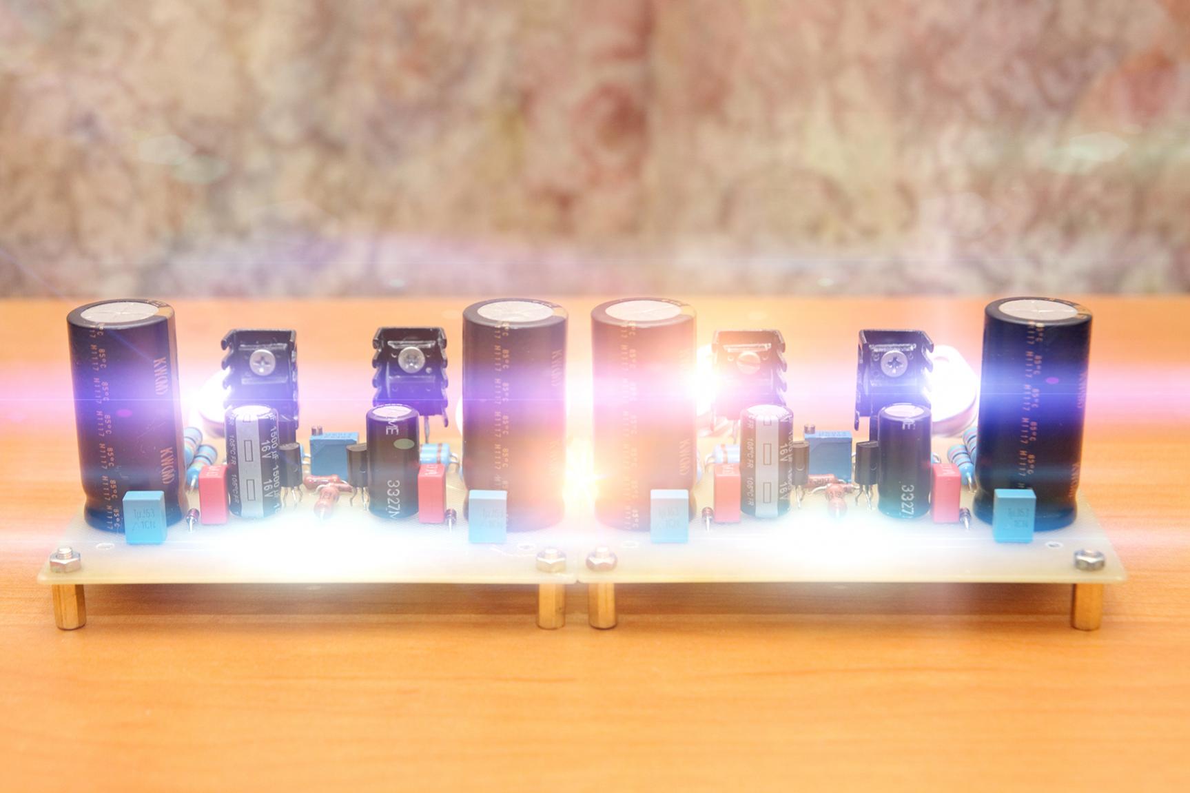

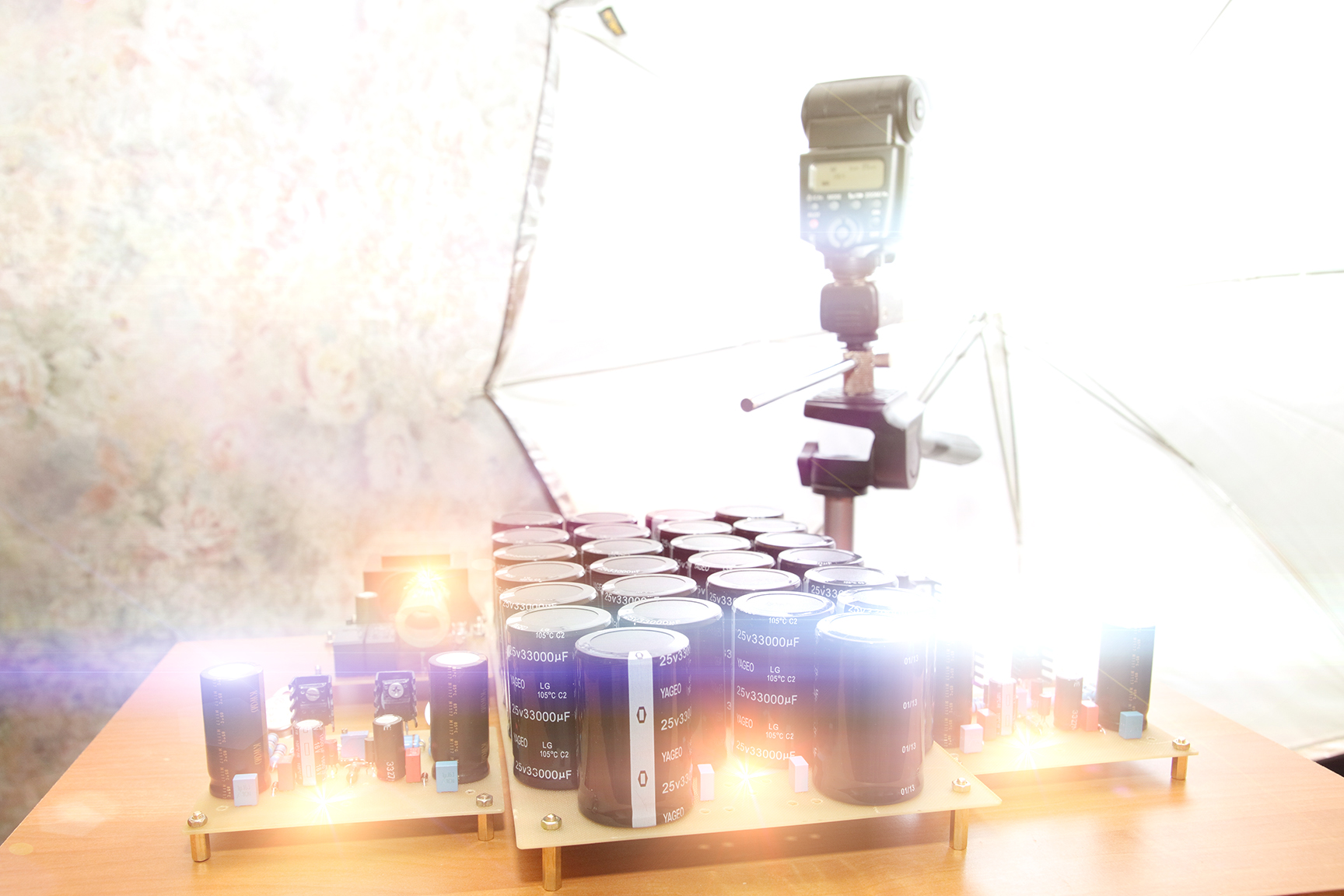

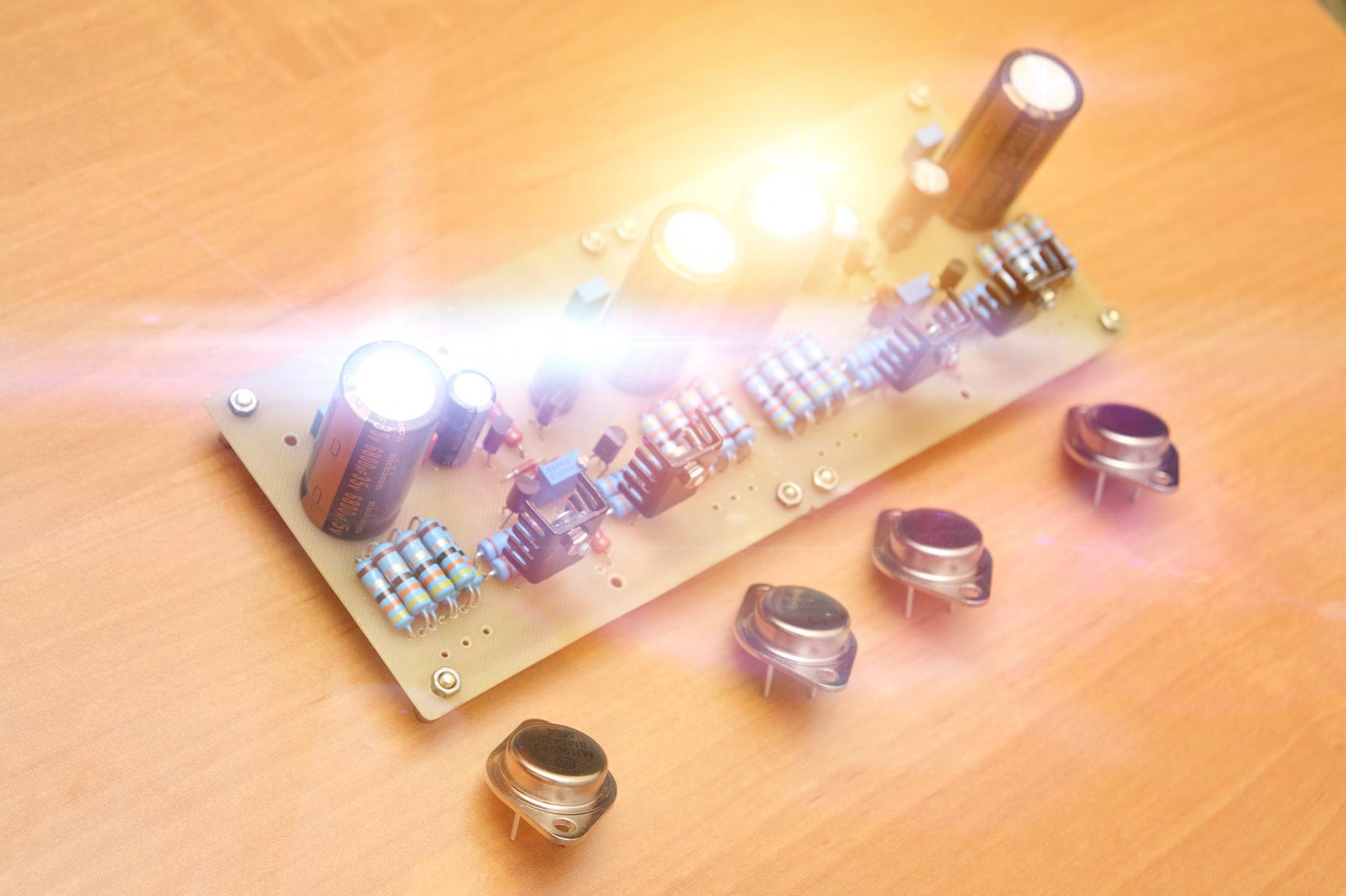

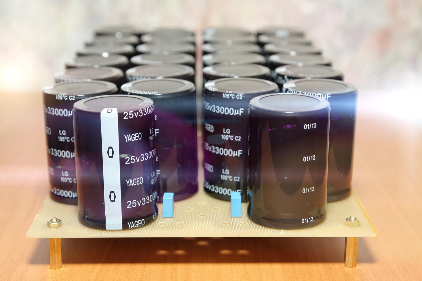

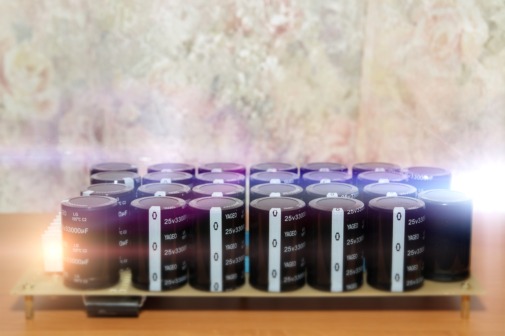

Jean Hiraga's Class A 20W in building process...🙂🙂🙂😱
Nice !
Are they said (the output transistors) to be a good swap in relation to the originals of the BOM ?
Do the need to be sorted ?
Nice !
Small transistors must be sorted very hard (and must have linear HFE on 0,8-4mA), output better to sort (at 1-2A bias).
