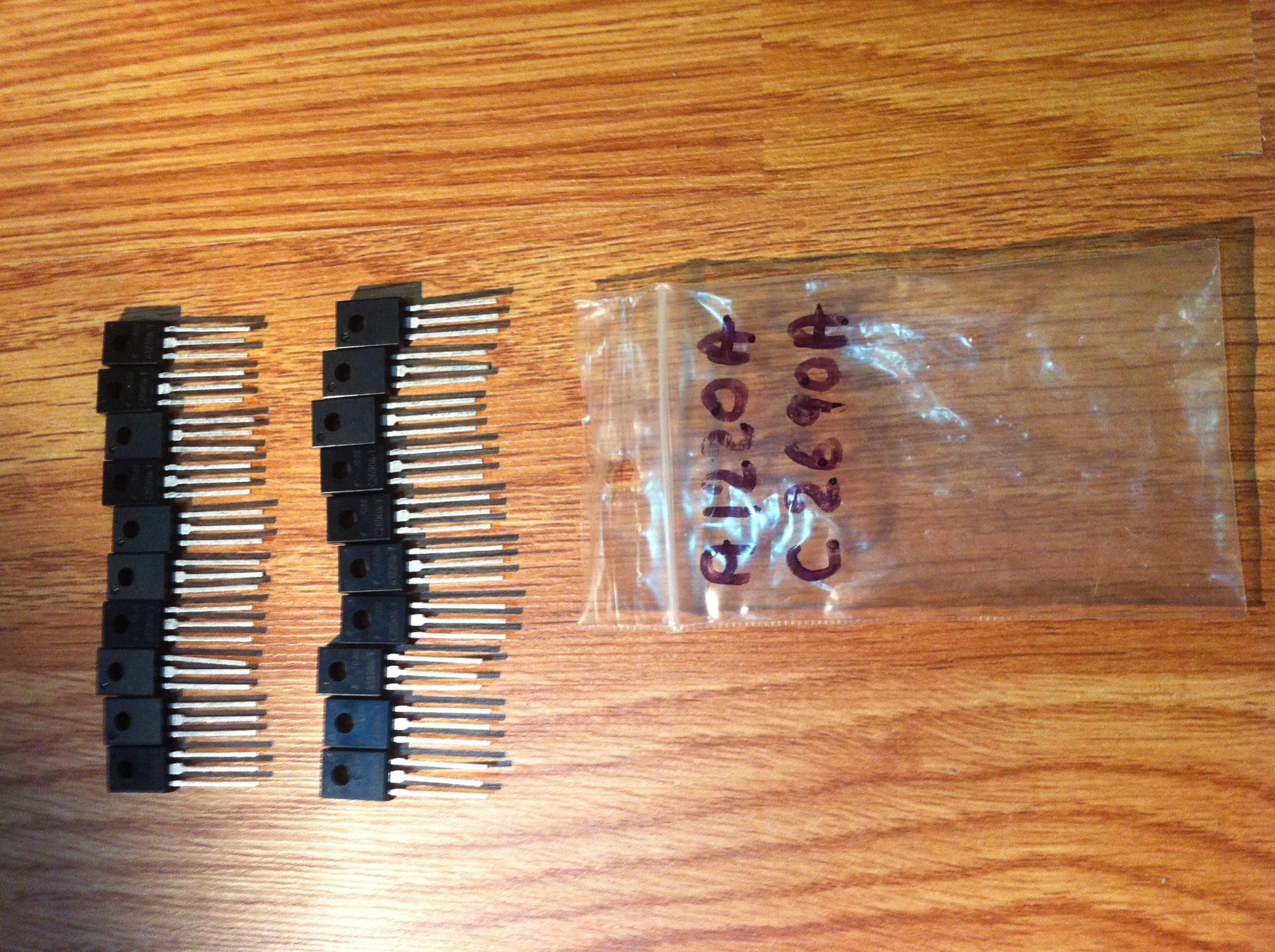

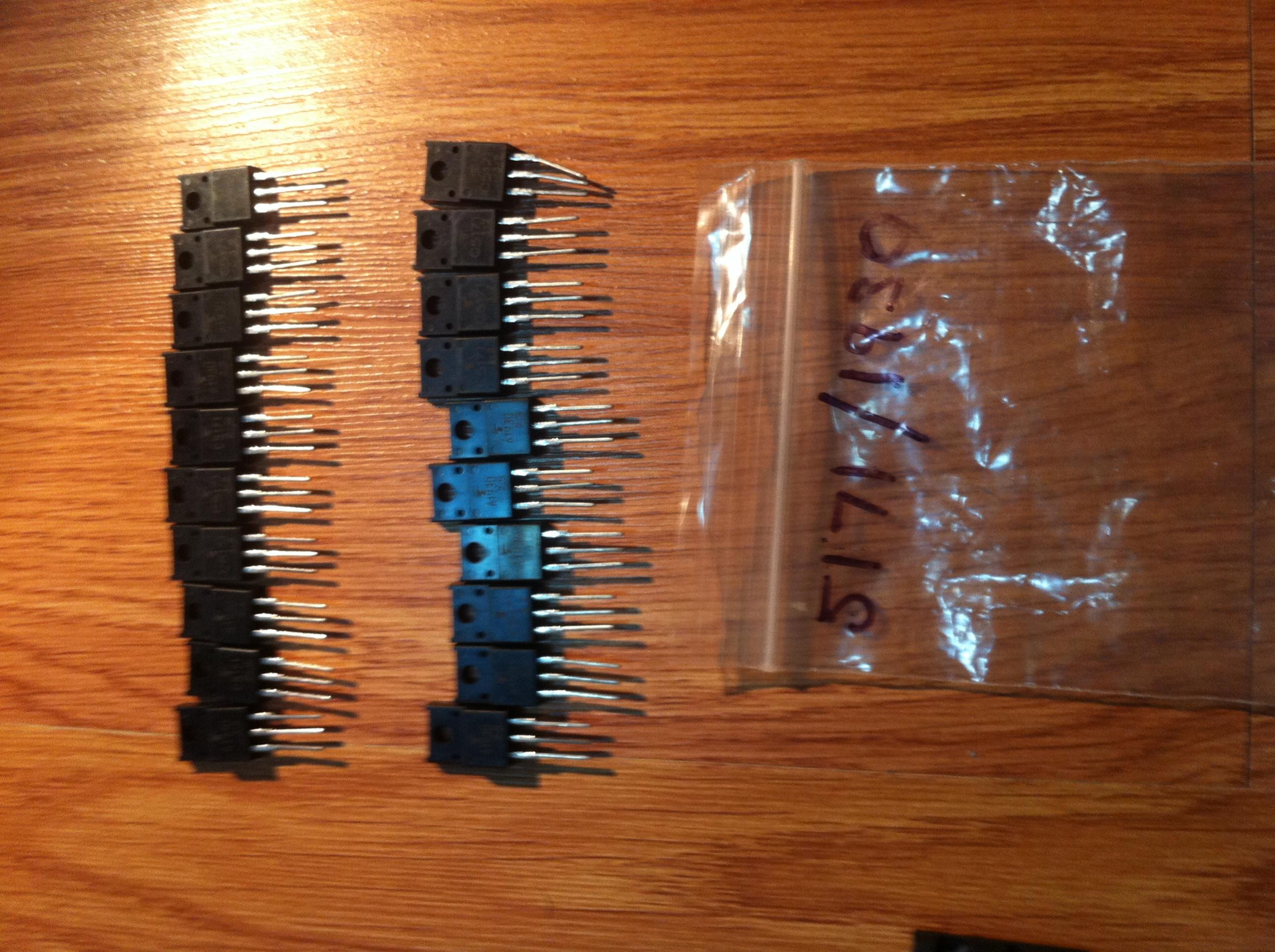

Hello,
Finally in back home from a long journey trip for my job..
Here are some of my thoughts when i made my variant of this amp:
"For drivers i tested the following pairs:
a)2sa1837/c4793
b)2sa1220a/c2690a
c)2sa1930/sc5171
And found the followings:
a) the best pair, with a very precise sound, very good soundstage, pleasant mids, very good imaging, low,punchy bass and tight, extended hights and beautifull overall sound;
b) too fast pair because of the hight FT, flat soundstage (didnt have presence), tight bass but abit soft, the hights where not impressing and the mids where at the same level as the bass and hights so nothing impressing here.
The sound was focused but was hard to distinguish the instruments and effects and because these trannies where too fast it was hard and exausting to listen to the amp. It wasnt pleasant at all.
c) same as the b) variant;
Conclusion: altought all the above pairs where better aprox in all aspects compared to the original drivers used, Cob an FT, it seems that this amp doesnt love drivers with FT faster than 90-100 Mhz altought the CoB is better than the original ones....
I used as output pair 2sa1943/2sc5200 Toshiba NOS for tests.

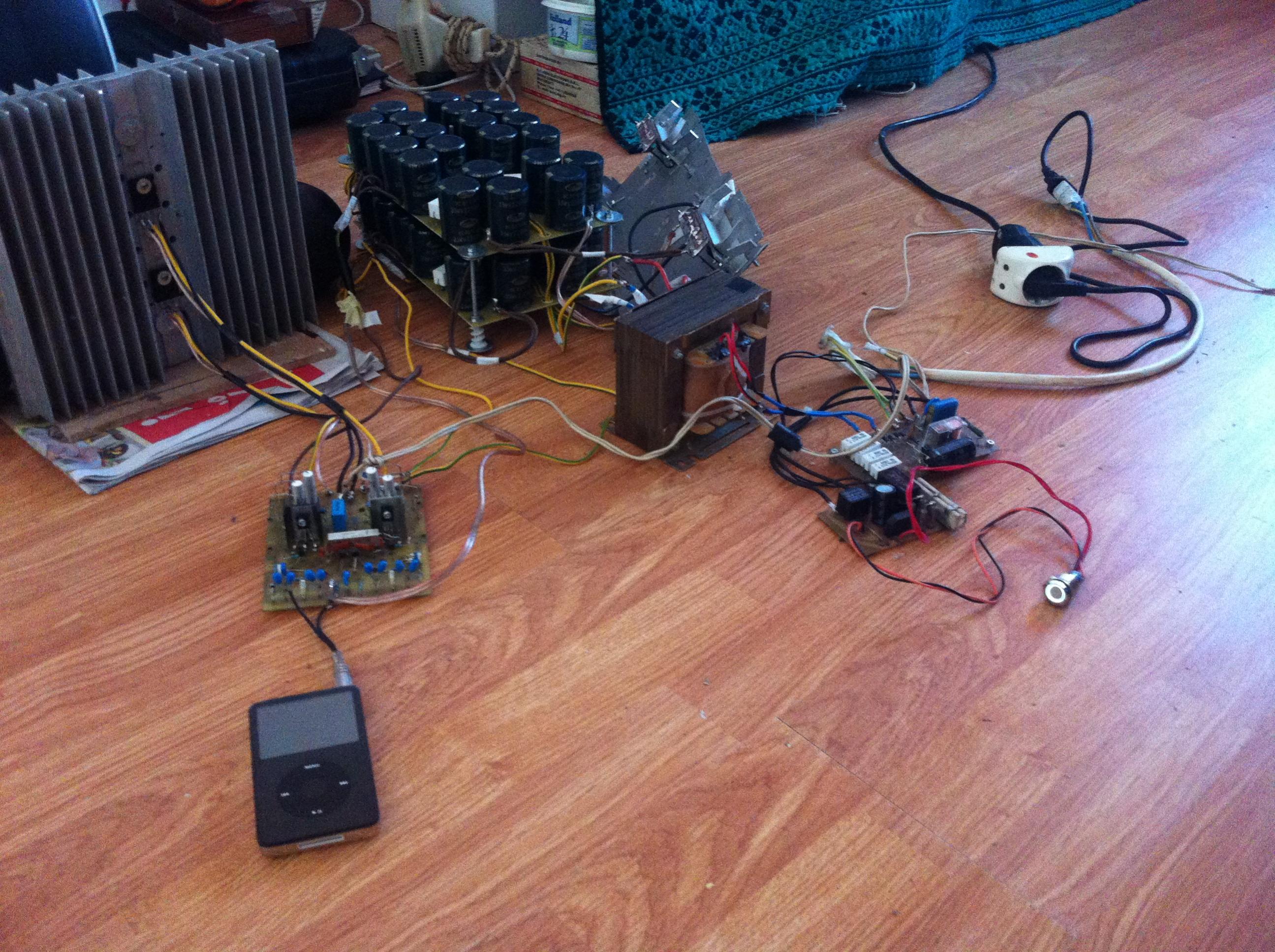

The source: ipod 5.5 classic@80gb@Wolfson DAC chip moded to Rockbox for FLAC format support.
Speakers: modified Tento closed enclosures rated at 40w sinus and 8 ohms from an Kashtan mag.
The music (in Flac format):
* luminary-amsterdam (smith and pledged remix); -- depht of field, vocals, effects;
*julio iglesias-crazy;-- vocal and for the big trompet (dont know the name in english);
* katie melua- nine million bicicle;--guitar, flaut, violin, vocals;
* sting-fragile;--- mandoline, dinamics, vocals, depht of field;
*dave brubeck-take five; dinamics, rithm, timbre;
*mantovani and his orchestra- limelight and moulin rouge;-- soundstage and precision;
*above and beyond--full concert film live from Porchester Hall (not FLAC; it is dirrectly from youtube@1080p); sound stage, sound stage and vocals;
I made the listening tests for 3 days from 8AM to 24:00PM continous listening to the same mellodies over and over again.... I think that after i'll finish the tests i will not want hear again those mellodies..
So my friend i think that MJ15034 and his complement and the 2sa1837/c4793 and other good pairs with COB lower than 40pF and FT lower than 100mhz is best for this amp."
If i remember clear this was exhausting... For a precise difference between the batches of different transistors you have to listen to the amp allot (same mellody, over and over and over again...) and choose what you like best.
