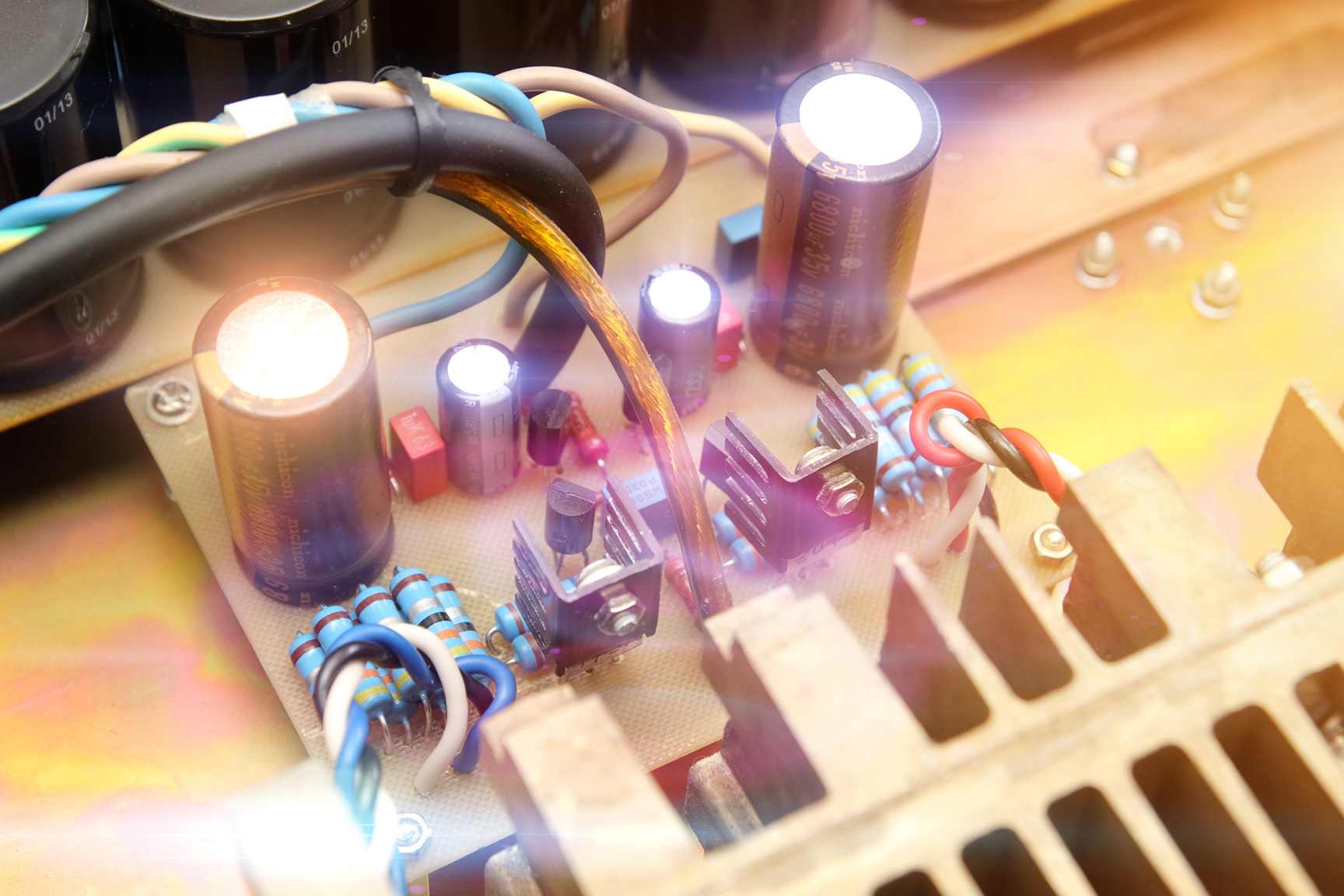

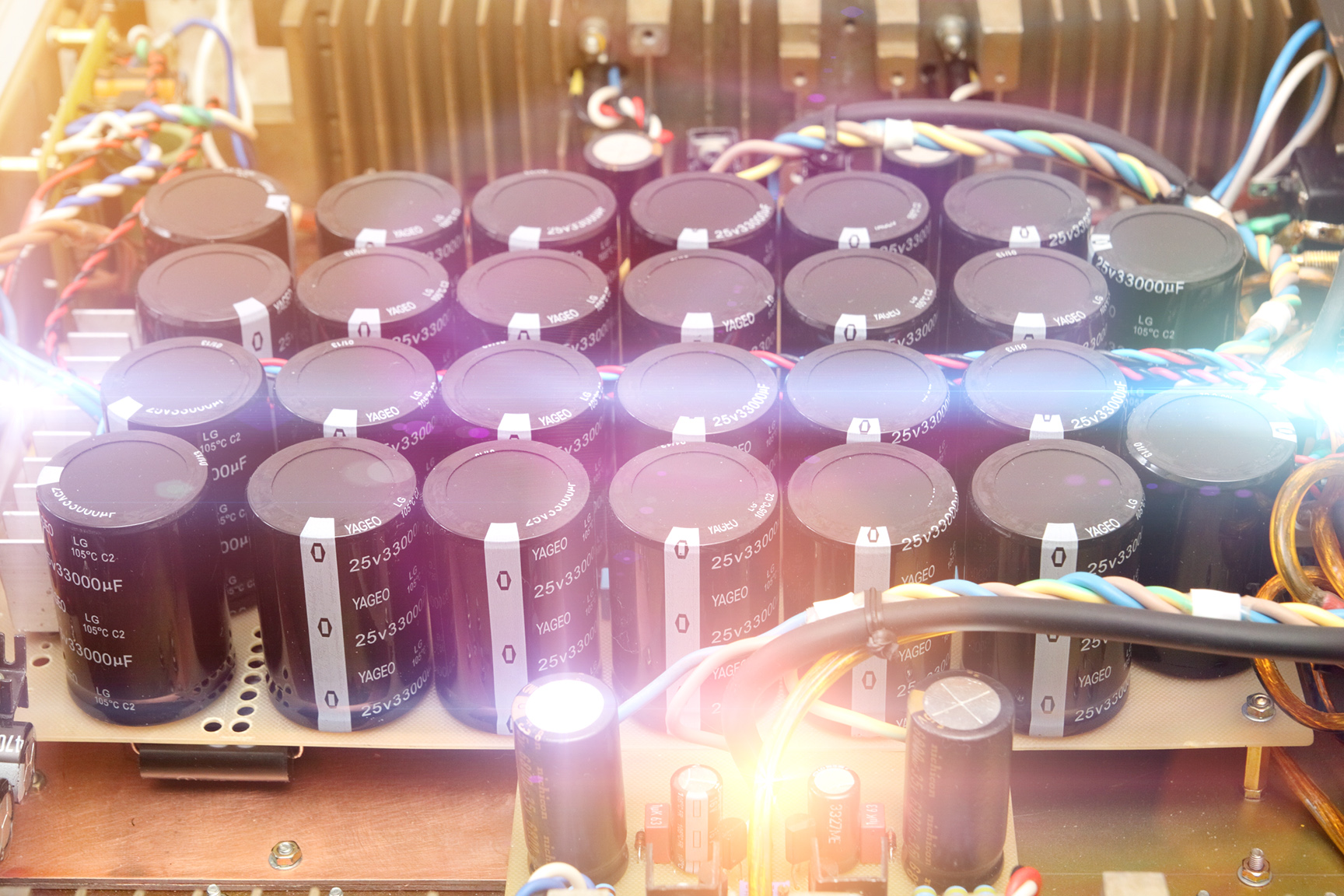

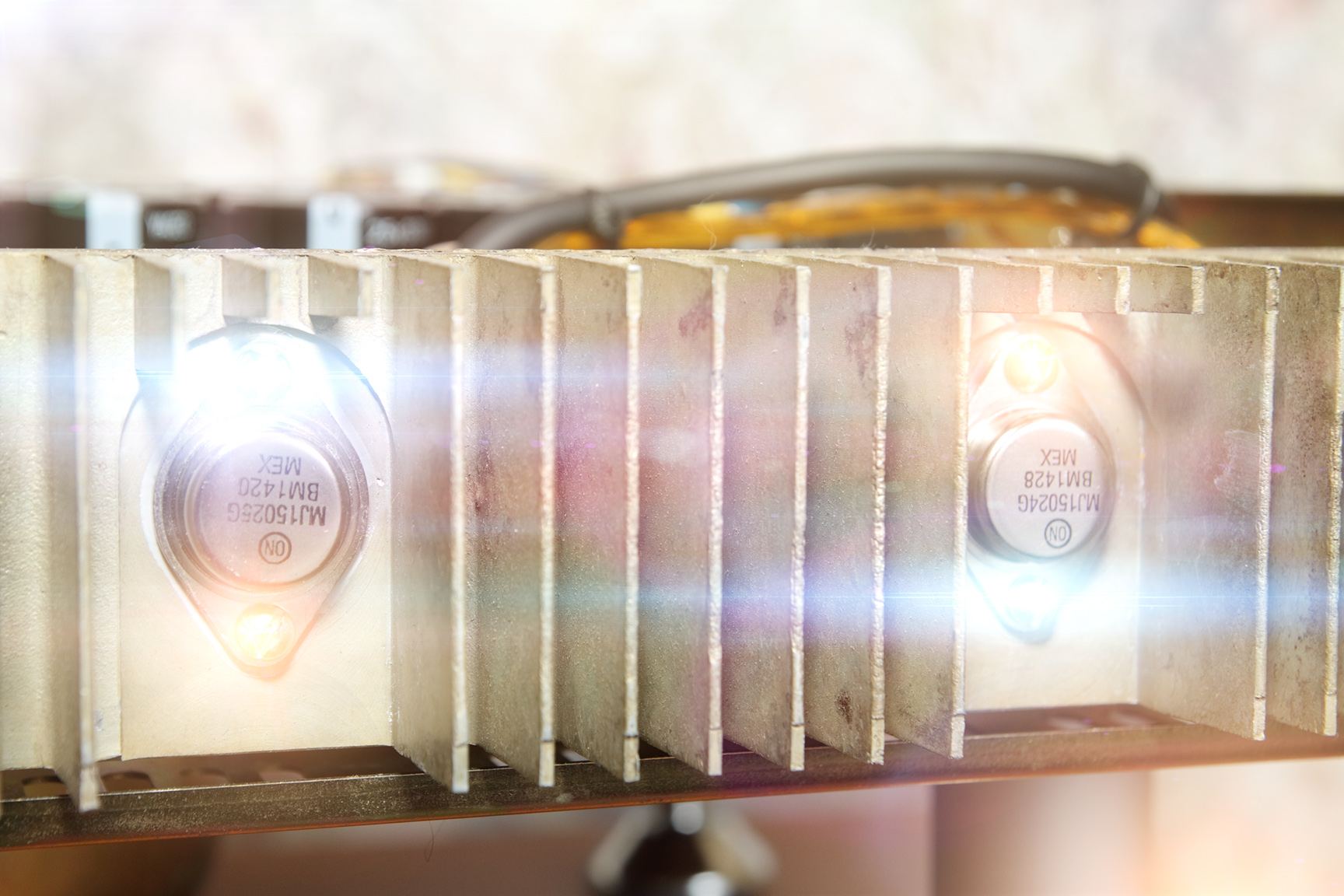

Now I making Hiraga's 20W (1979), with 0,858F (26*33000uF Yageo LG) in filter and 2*6800uF (Nichicon KW) on each channel, beside stabilitrons - 1500uF Panasonic FR.🙂
http://www.diyaudio.com/forums/solid-state/193-hiraga-20w-class-94.html#post4542975
To me MJ15024 & 25 from ON semi power transistors with MJE15031 & 32 drivers gave the best performance.
Had better, deeper bass (more weight) and very well controlled, the mid range was much cleaner the vocals very good
The NEC set gave me warmer sound a bit tube like but the mid area was a bit muddy, les bass and not as controlled. All together sounded a bit flat.
I would chose the ON semi always over the NEC.
I tested the NEC drivers with the ON semi power transistor I did not like the result.
Also I tested with two different type of Toshiba I did not like those either
I did tested MJ11003 & 11004 ON semi power transistors to it was closer to the other ON semi than the NEC. Still not as good as the 11024 &25.
Now I will test the MJL4281 and complementary also I have original Toshiba Green and black transistors. These PC board was designed for these plastic type of transistors.
If the metal can MJ11024/25 will be better will use some short wires to connect to these PC board. I would chose higher voltage caps than 25V(based on my experience)
My toroid is 500VA (for both channel)and get warm after couple hours some people use 300VA only.........
Again the PS is the heart of these amp.

Wires will be 7 cm length with 1.5 millimeter square cross section.🙂
+-19VDC after CRC and bias 1,35A.🙂

7Cm long wire with that thickness must be OK
The caps will survive +-19VDC but to be honest I do not like them.
I hocked up 10PC Nippon CC 33 000uF 25V to a Class A amplifier +-16VDC rail voltage
Compare to the 4PC Mepco 50 000uF or 4PC Mallory 62 000uF CRC the result was a disaster
Also I got 4PC Philips (good quality) 60 000uF 25V and to me useless, I do not like the result. My opinion because the low voltage..
I only purchased those low Voltage caps because they were cheap and the shipping (local) also was cheap. To me the big can industrial or audio caps come first in amps like Hiraga. I think is not a accident Hiraga uses those giant caps and higher voltage in the orig. PS. Now I do not want to upset you! Please tested very well those caps and give some time to burn in but if you have some Mepco, Mallory or CDD etc. min. 35V please compare with that.

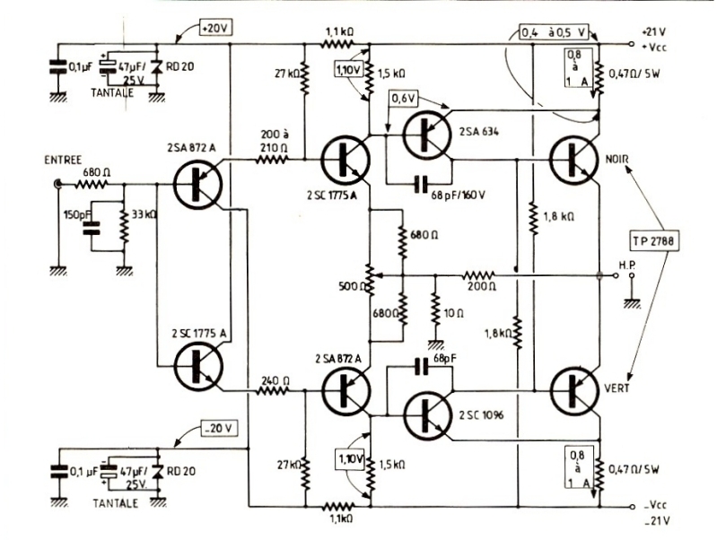

Jean Hiraga's Class A 20W Amplifier (L'Audiophile. April, 1980).

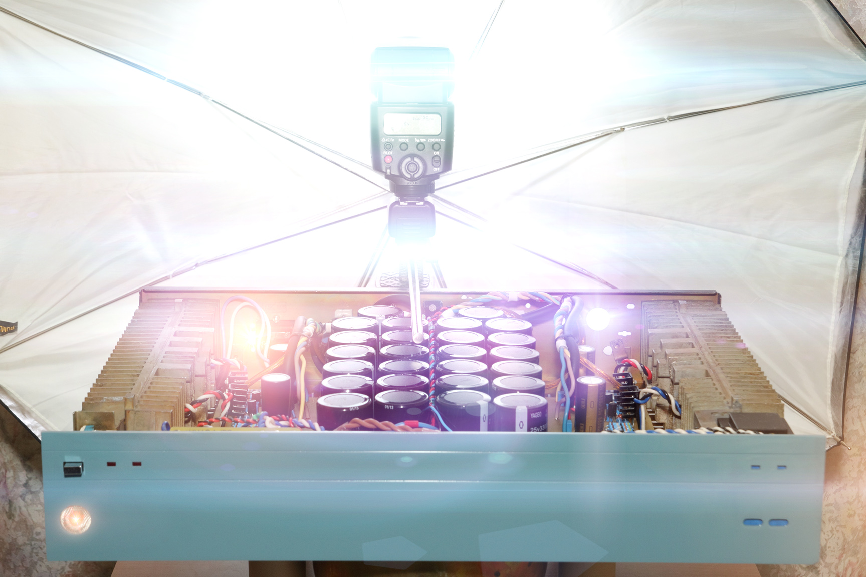

Hi
The size of your heatsink is enough? I used much bigger open style and was very very hot!😛 Be careful no to cook the power transistors.
How do you like the result..
Are you satisfied?
Greetings
Hi
Are you satisfied?
Greetings

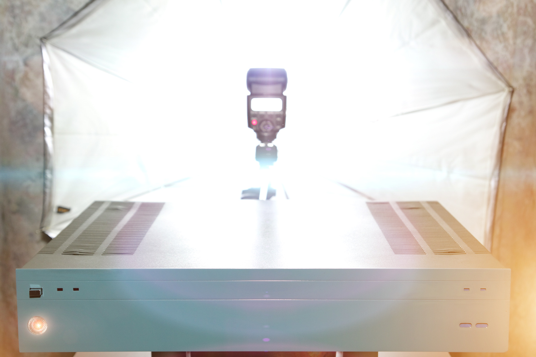

ohhh yeah - very very very ultra hot.
+-19VDC, bias 1,25A, after 3 hour idle - +47C.

Very good resault: the sound is clear, light and soft.🙂

thanks for the explanation Andrew!
what gauge wire did you use?
also is there any significance in splitting the capacitor values between C1 [before the Inductor] and C2:
like C2>C1 because it acts as reservoir and closer to amp board!? my values from previous post are after looking at Sergiu's example [😱 i know, i have lot to read and learn!]
1:10 in original scheme.
I wrotethanks for the explanation Andrew!
I end up with an rC{R+L}CC filter.
thanks for the info!1:10 in original scheme.
sorry, i didn't get you.I wrote
r=from circuitry,C=first cap,R+L will be from the inductor,CC=second set of caps?
yes, instead of rCRC use rCRCC, or rC{R+L}CCthanks for the info!
the bigger CC bank at the end is the significant source of current for the low frequency current demands of the speakers.
But do be wary of ripple in the first C as you mentioned earlier.
This can be improved with rcccc{R+L}CC
many small c in parallel generally have a higher ripple capability than one big capacitor (due to increased cooling as a result of increased surface area).
