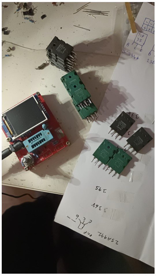

Hello everyone,
for j.hiraga super 20watt.
there are output transistors hfe differences.
2sa1302 107 hfe.
2sc3281 80 hfe. will it cause any problems to use it like this.
I have extra transistors that I removed from an old device, I have extra pairs, I can even use them in parallel to solve the problem.
Thanks in advance for your valuable answers.
I think that the compund output transistor pair make up for small differences: the driver and the output are 'integrated' and give a sort of local feedback. That 'should' be able to cater for such differences. Such that the golabl feed back for iinstance stays the same and does not suffer from lack of headroom.
