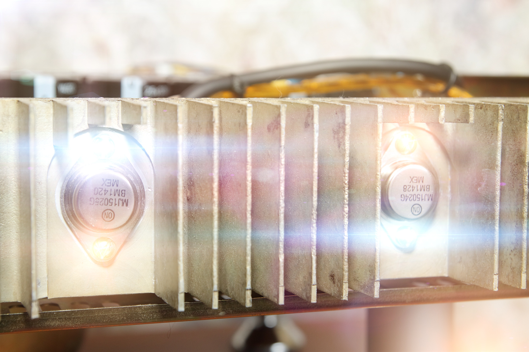

Anyone have an opinion about using MJL 1302 and 3281 as outputs? According to Farnell these are high quality audio transistors.
One of the best. Now I using MJ15024G+MJ15025G, cause my heatsinks made for TO-3.

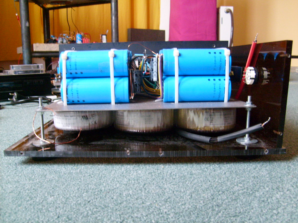

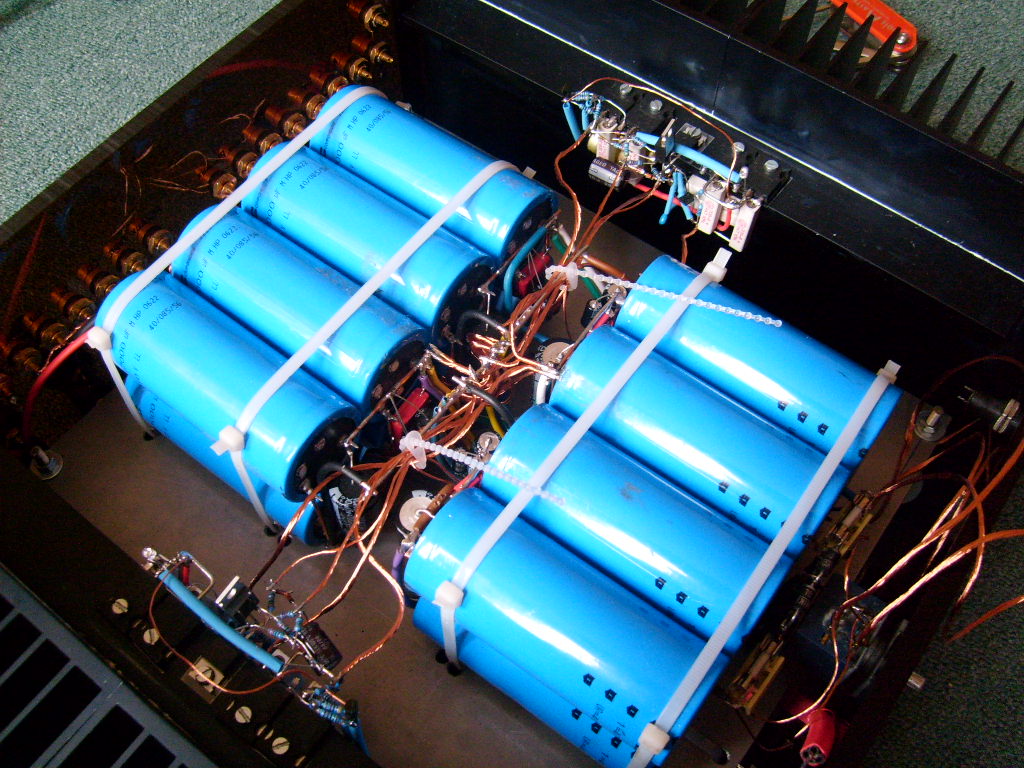

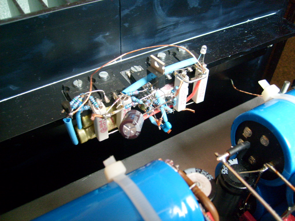

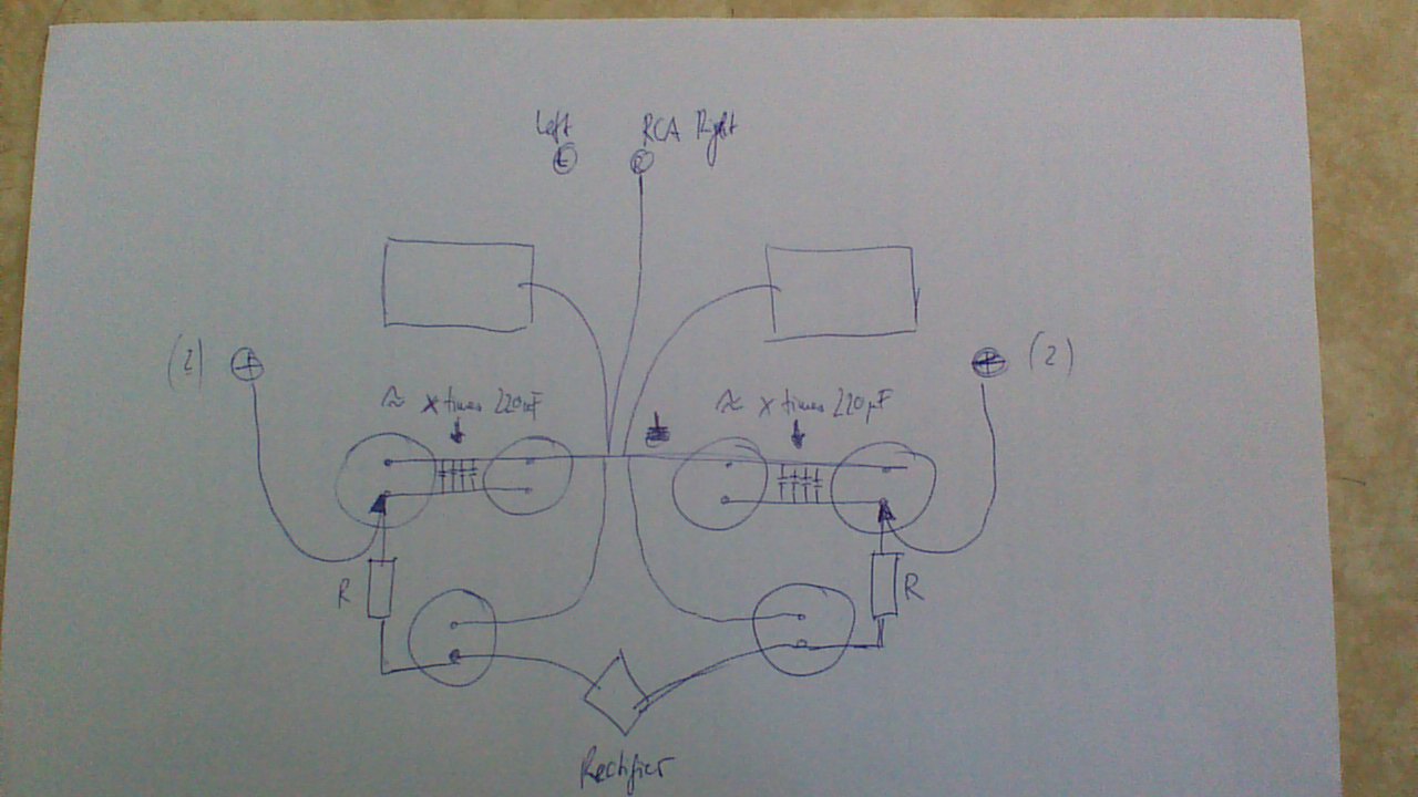

Some suggestions for the origin Classe A:
Replace the big copper strands by solid core, 1,5 mm.
New order of ground an C-R-C - look picture.
Replace the origin bridging cap by x times 220 uF or others, same types! same values! as much as possible.
Input only one channel ground - I prefer right.
Psu - amp: 0,6 mm.
Input - amp: max 0,2 mm.
Amp - output: 0,6 mm.
NO lace! Exept laqueured lace.
... to get a much cleaner, finer sounding origin - or diy - "Le Classe A"-!!!

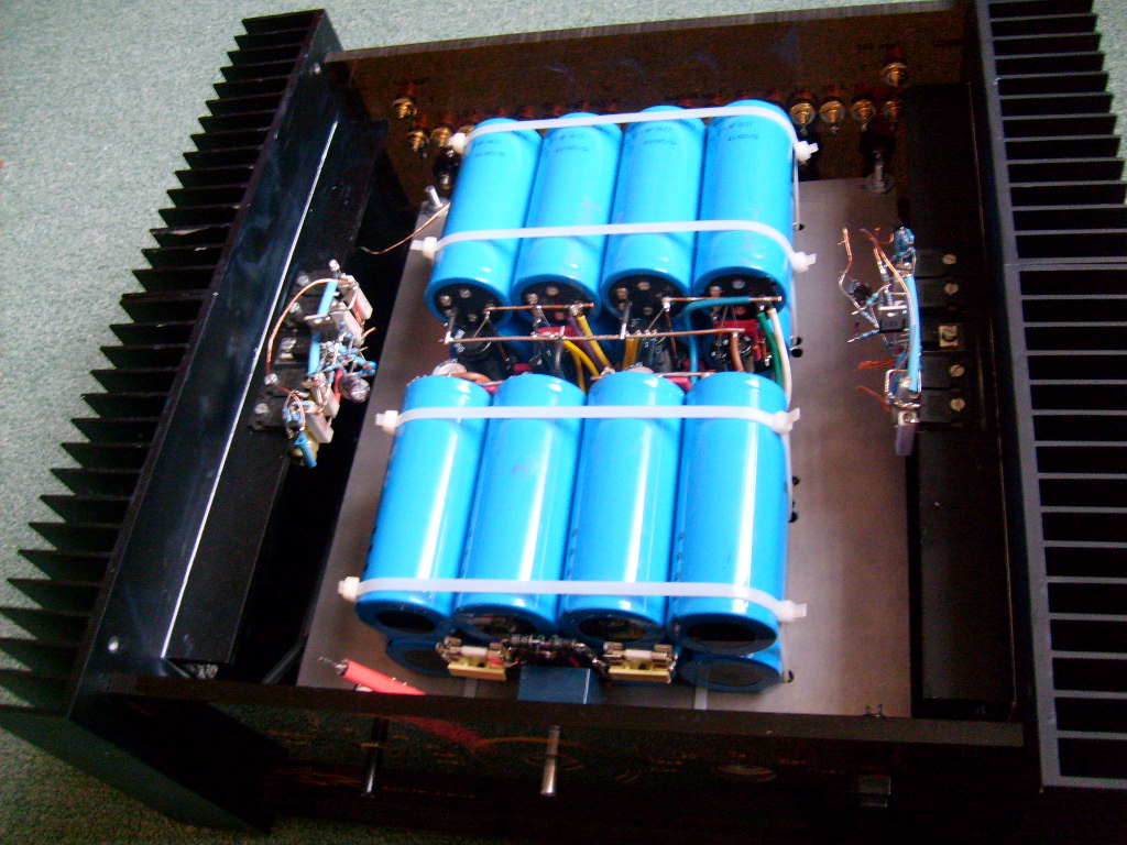

Psu - amp: 0,6 mm.

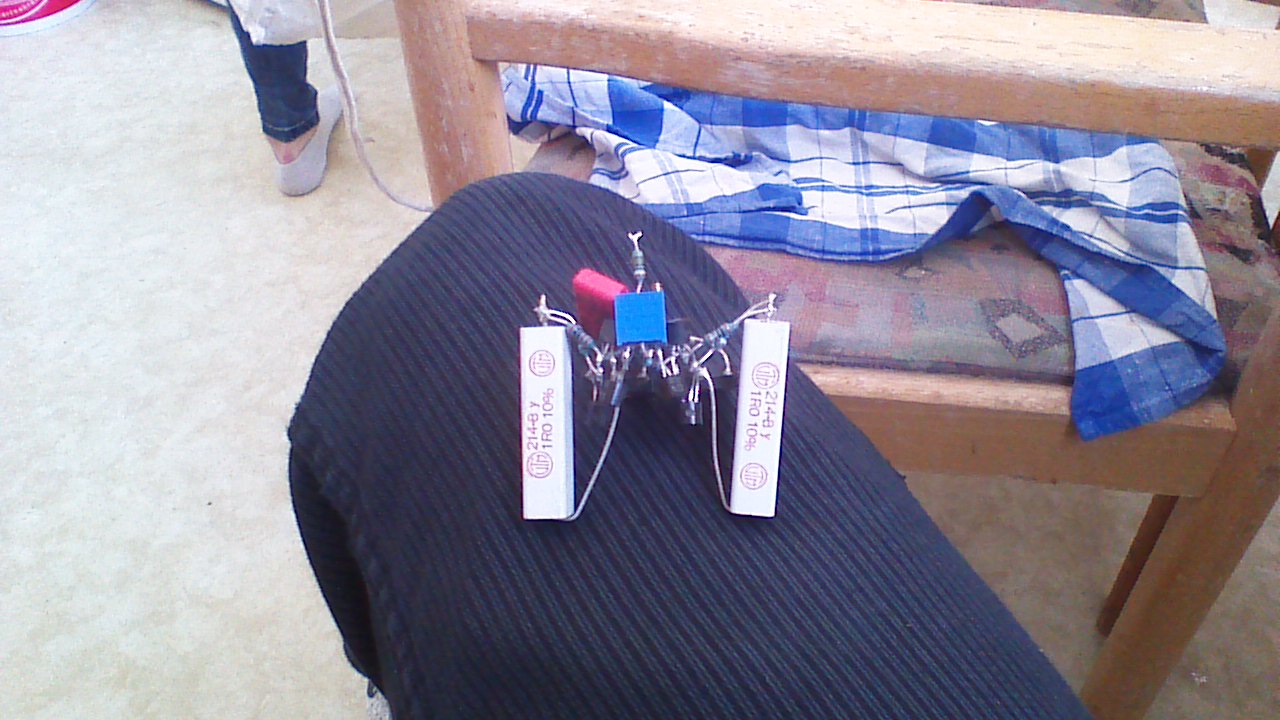

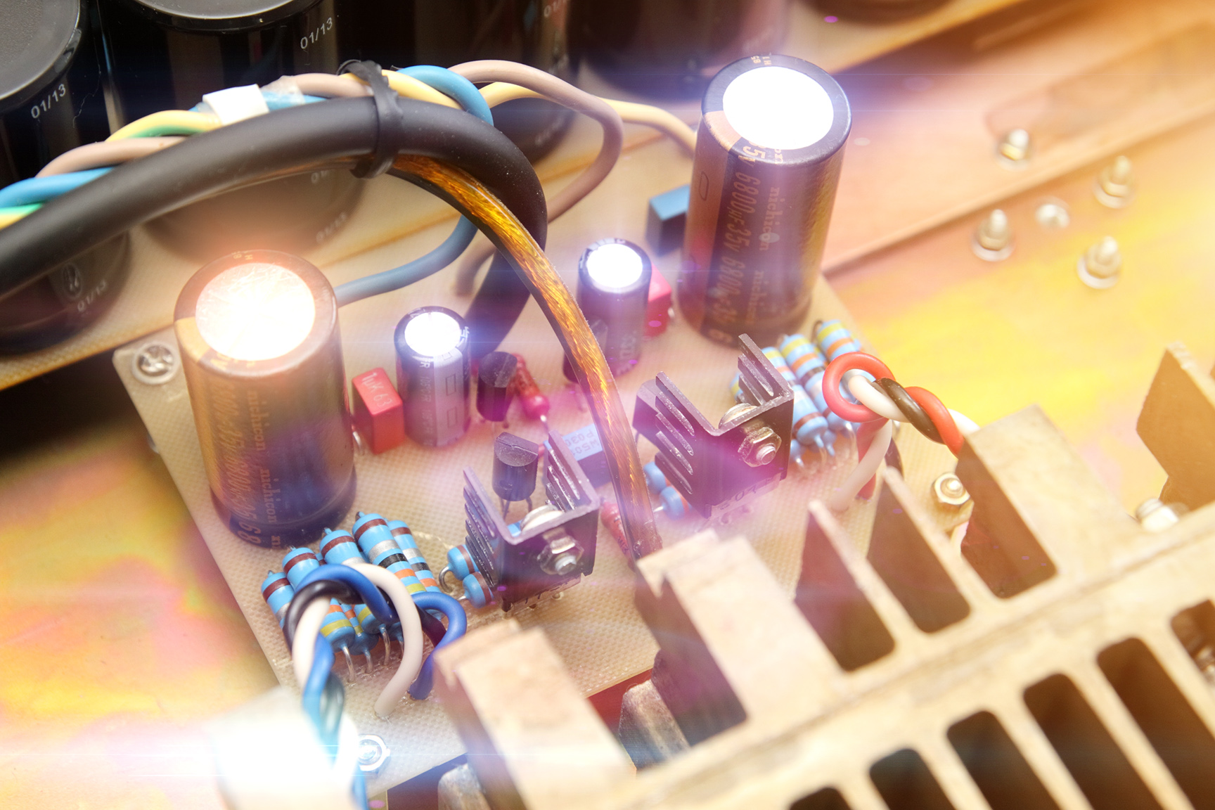

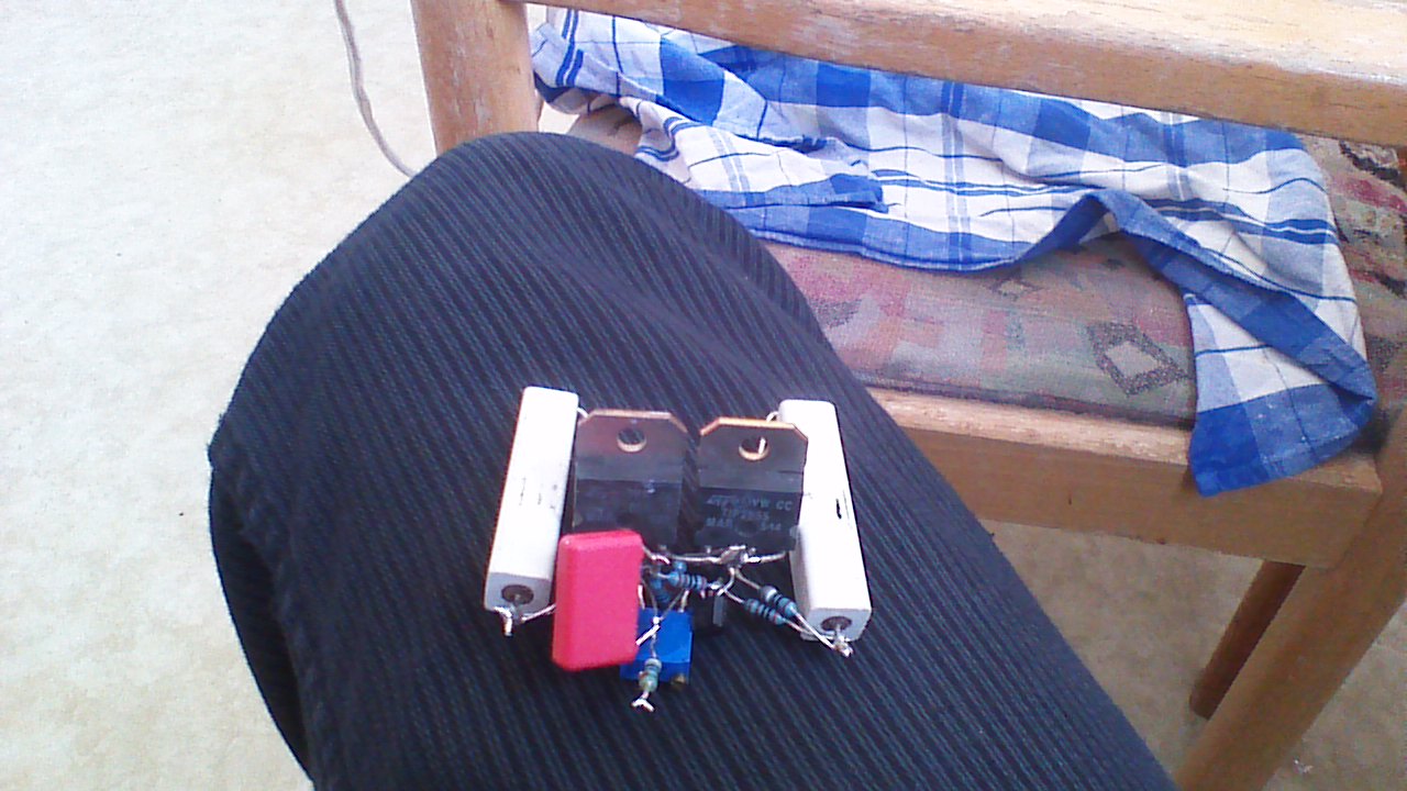

Are these 3D dead bug amps truly PCB free? Do you have one attached to a heat sink and peripherals like inputs, power, output? It would be cool to see how you manage all that without having something bolted down. Cool looking though.
Have found pictures. But not a Hiraga. A Aleph 3. 8 years ago? For a friend. But he did not trust in thin diameters - I love thin diameters.-)

Guys, someone was saying something about using multiple resistors to get 0.33 or 0.4 ohm..... Can't find that post anymore. But it was supposed to improve the Hiraga a lot. Does anyone get this? And what types should be used? Wirewound?
Thanks!
Thanks!
Hi Sjoerd,
Yup, it does improve the sound clarity and other aspects allot and lower the overall noise. To get 0.33 you need to parallel 3 pcs of 1ohm @3w ,metal oxyde. These will get hot even at 3w but acceptable. Or wirewound non inductive types could be used here . I havent tested wirewound n.i. but have tested simple wirewounds and will never go back to them.
