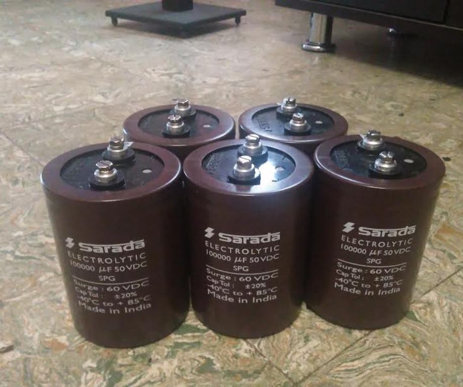

need help is arranging PSU Caps
hi friends,
i'm putting together PSU for Hiraga 30W amp. this is a mono build and I've the following capacitors for each channel:
5X100,000 uF caps
4X10,000 uF caps
what is the best way to wire them? i'll be using 0.3 Ohms , 30W resistor for CRC filter. probably i made a mistake in sourcing odd number of [big]caps for each PSU!?

Hello,
4 10000µF after the rectifier then resistor then 4 100000 µF. Much better is replacing the resistor with a Lundahl ll2733 or ll1694 choke. Or ask a local company to make two nice iron core chokes that can handle the current.
greetings, Eduard

thanks @eduard for the quick response. planning to change to choke little later. right now still in the process of finalizing the build.
so for each rail:
2X10,000 uF + 0.33 Ohm + 2X100,000 uF correct?
i do not want to waste 1 unit of 100,000 uF. probably i'll try to source 2 more of these .

yeah, like that. Just keep some place in the chassis so you can add a choke. Why not make a stereo amp. Then you will just need 2 chokes and not four?
greetings, Eduard

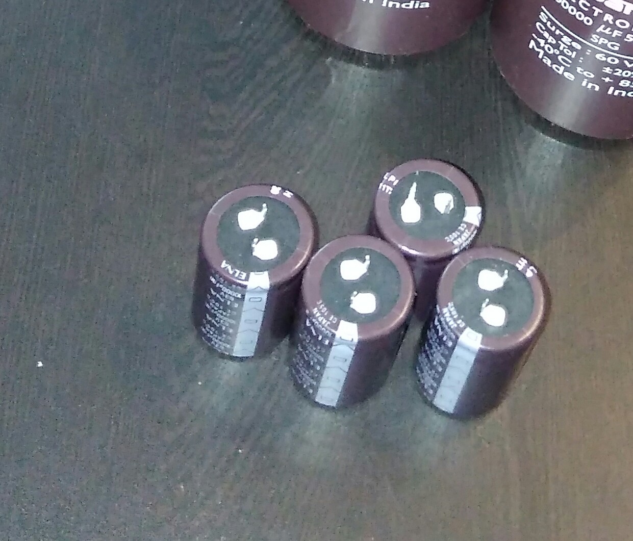

@Steven thanks for the recommendation. i'll check if i can get the choke made locally.
Hi eduard,
regarding my earlier query of capacitors:
can I arrange the capacitors in the following manner?
Rail 1 : 2X10,000[63V DC] uF + 0.33[30W] Ohm + 3X100,000[50V DC] uF
Rail 2 : 2X10,000[63V DC] uF + 0.33[30W] Ohm + 2X100,000[50V DC] uF+ 10X10,000[63V DC] uF
i've got the 1,00,000 uF caps after much struggle [spent lot of time and money] . so don't feel like wasting it 🙁 . manufacturer is asking for a minimum order quantity of 10 units!

Hello,
The best would be to have the two rails using the same values and looking indentical. Also take care where you connect the wires to the resistors and to the circuit. I did post a drawing copied from the French magazine some time ago.
And of coursew use a real choke like the ones made by Lundahl. If the currents flowing through the positive and the negative side are identical you can use one coil for pos and the other for negative side. I did ask Per Lundahl himself so time ago. Then you will need 2 chokes for two mono amps.
In the past the French did use 200 mH for a 50 watt class A amp and the Nemesis so i did ask if i could use it for my Hiraga. They said sure why not.
Greetings, Eduard
