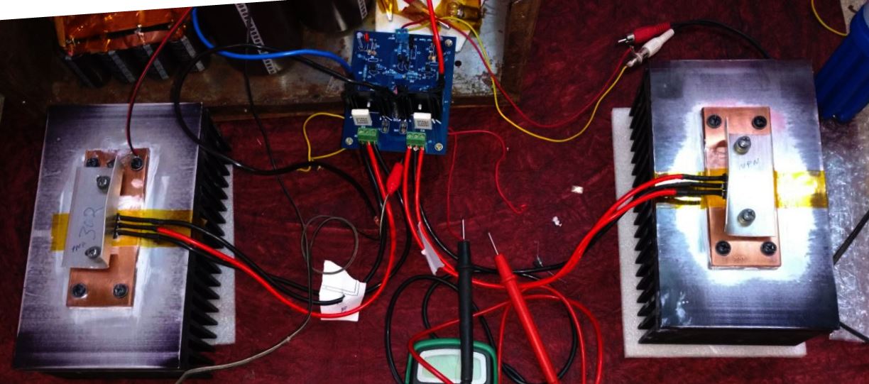

wanted to check the PSU - excuse me for the wiring mess. voltage without load is 28.8 volts! this is with 20-0-20 secondary [400VA] trafo. if i connect automotive lights [2 bulbs of 12V in series - not sure of the wattage - they are the small signal indicators] output voltage drops by around 1 volt. my amp board needs 24 volts per rail - hopefully it'll work fine.
i kept the circuit powered on for few minutes. to begin with there were no fireworks 😛 . i didn't see anything heating up either. i thought the resistors would heat up but they were very slightly warm to touch [wire wound, ceramic type, 0.5 Ohms, 25 W].
after powering down, if i connect the contraption of bulbs, they drain out the juice within few seconds [around 5-6 secs per rail].

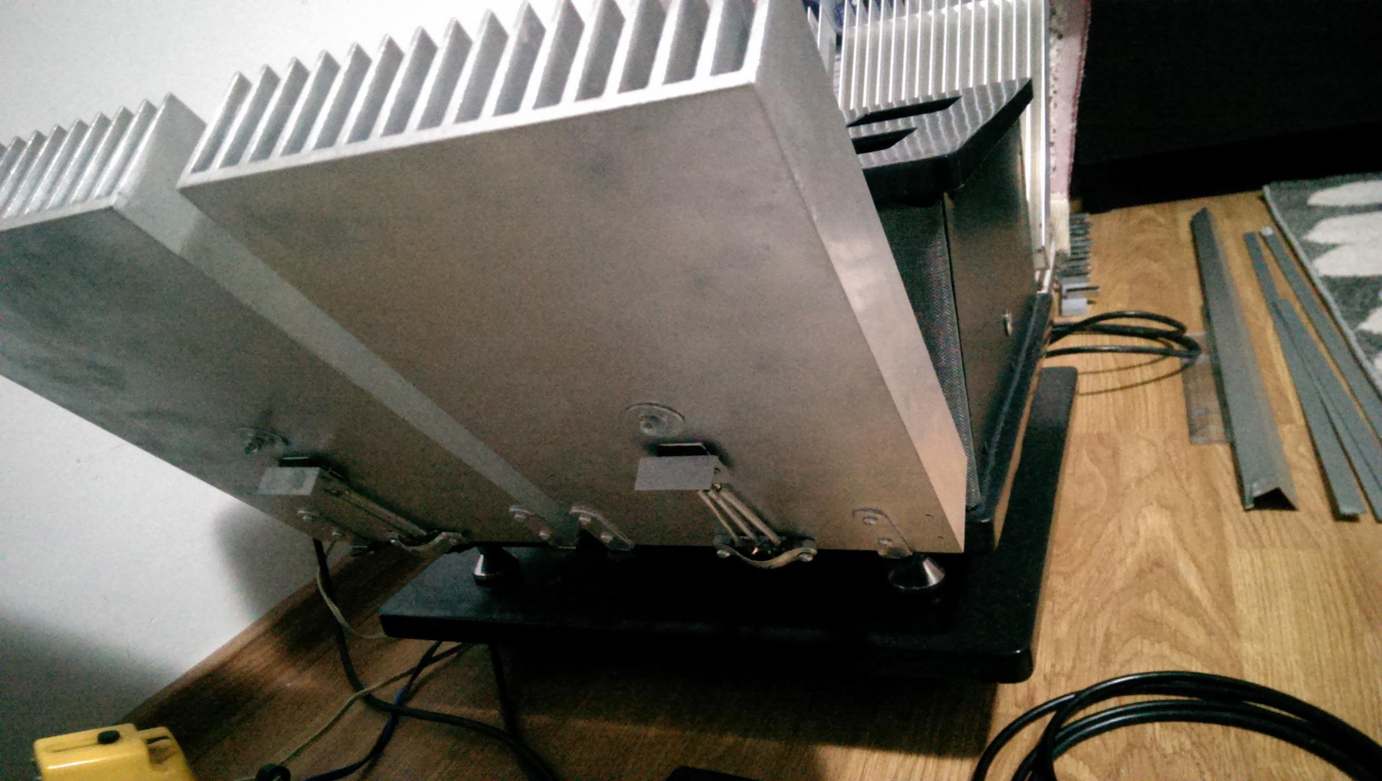

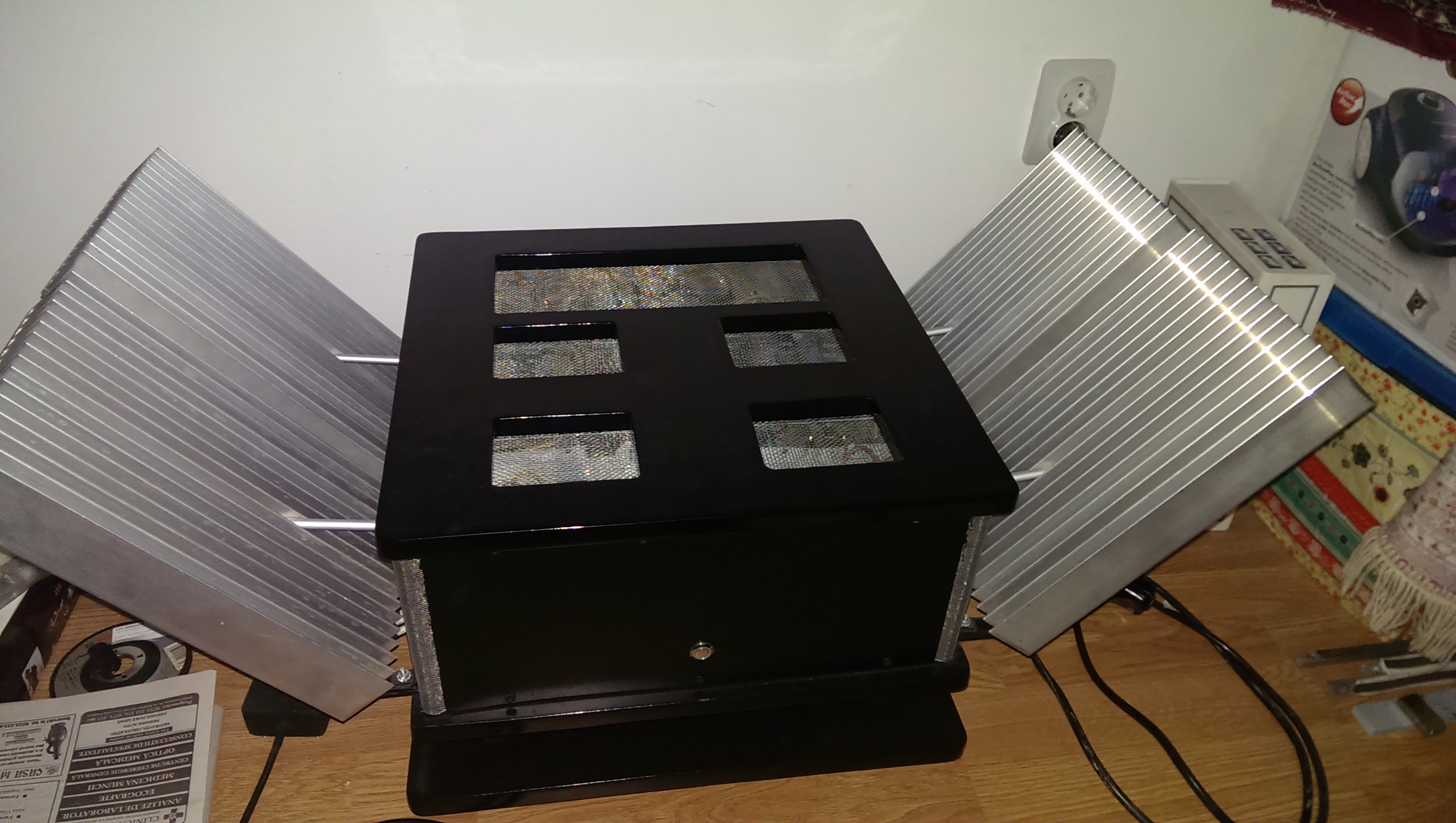

Look at my modified super class a from the pics bellow. I have it for almost two years now and didnt have a problem with heat or thermal tracking even in the summer when its pretty warm in my listening room. The rads are insulated from the chasis earthing and the outputs are sticked directly onto the rads. Now you have to understand the temperature issue very clear if you want to prolongue the outputs life when you are runing 1.65A bias through them especially in the summer, when the rads run hot even through they are pretty big (in my case). Believe me that 1.5A its like a limit for the outputs and if you run the bias higher they will tend to run extremely hot. So please keep that in mind first as a caution that needs to be taken care.

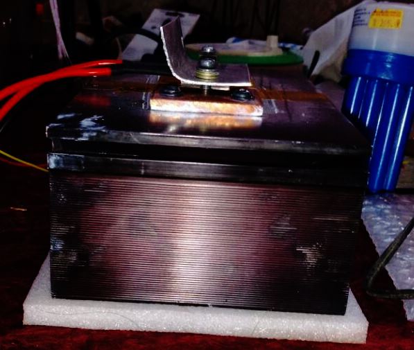

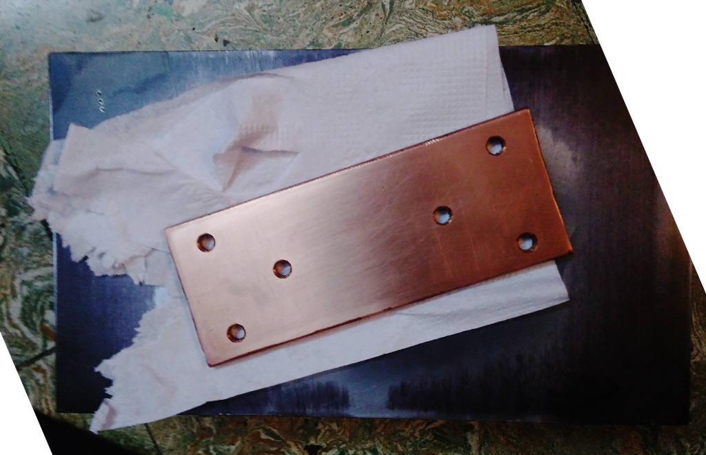

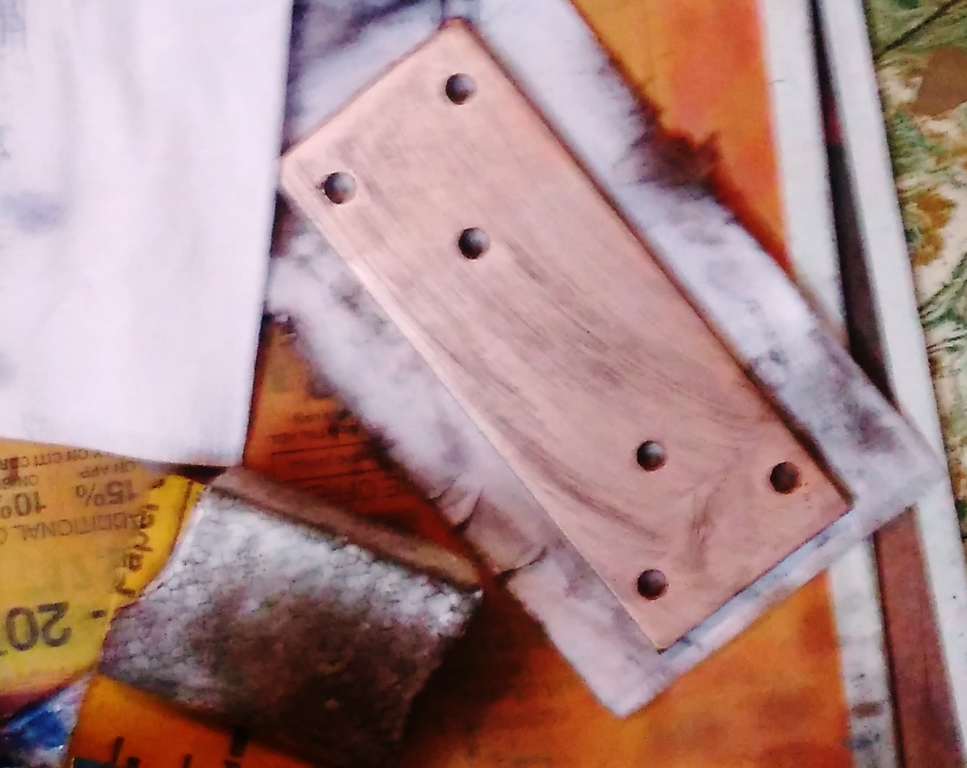

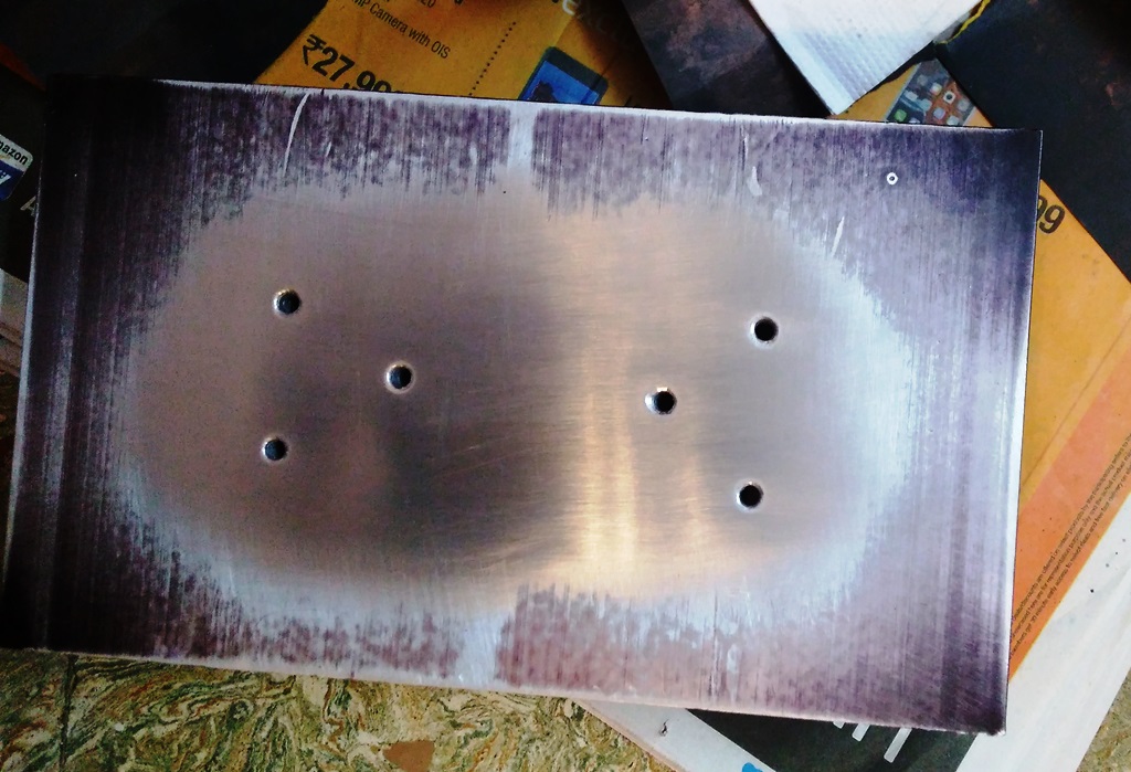

pics of radiators and copper heat spreader. still a work in progress. wet sanding starting with 320 grit to 1500 and finally with 2000- keeping in mind the shape of both the surfaces. it's takes lot of time and still better than the stock surfaces.
dimension of aluminium heat sink: height: 125mm, length: 215mm fin length: 75mm and it weighs little more than 2.5 kg.

🙂) nope. I let the amp run continously for aprox a day in each case for two weeks in the summer and measure the temps at about two hours to see how different rads and radiator positions work at different periods in a day at high and lower temperatures respectively. I have tried another two smaller rads and these bigger rads in different configurations (verticall, 15degrees, 45degrees, horizontall, stack effect with different distances and with diffent orientations). Anyway my conclusion is that in the summer, the cooling situation changes drastically. It seems that when the room temp rises, the air flow between the cooling fins of the rads diminishez drastically thus the cooling diminishez. So to counter this effect i oriented the rads to maximize air flow and the 45 degrees orientation was optimum because of the big "exposed active area" (if i may say so) of the rads. This sollution also ensures a 45degrees position of the output capsules wich are oriented now with the face down wich ensures a uniform disipation area for the outputs. This chosen solution combined with the direct contact between the output tranies and the rads (with silver grease) ensures a healthy almost 14degrees celsius down for rads and a difference of 4~5 degrees between outputs and rads wich is a good thing considering that i want a long life for the outputs.
Then i wanted more so i buyed fatter rads with taller fins and height. I used them in the same formula as described above and got a healthy 52degrees for the capsules and 47-48degrees for each rad at 24-25 degrees room temp. :drink:
I think that a new thread with cooling sollutions for class a should be opened and discussed and measurements posted there. I have searched allot on the web for different cooling sollutions but found very few results...🙁 :scratch:

Mica thickness is very variable.
Much that comes cheaply are >5thou thick and a few are >9thou.
Kapton seems to come in 3thicknesses, 1thou, 2thou, 6thou.
Mica and Kapton have similar thermal resistance and when both have a very thin layer of thermal goop applied to both surfaces they become even more similar.
Aim for the thinnest of either 1thou Kapton, or <1thou Mica, with a good thermal goop that is minimum thickness.
Only few grades of Keratherm are better. Most silpads are worse, but some can match thin Kapton/Mica.

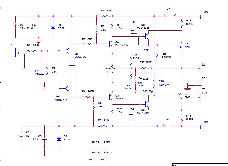

when i first powered it up, the Q current was more than 2 Amps! later with the inputs from a friend, i increased the bias resistors[R5 and R6] from 33K to 35.7K. now the Q current is between 1.58Amps to 1.78Amps depending on the mains voltage. after troubleshooting some noise issues speakers play excellent music! but there is a hum in the speakers when there is no music/source input. i.e. if i switch off my music player [Cowon S9] the hum is back and if i switch it on even without music being played, the speakers are completely silent - i can't hear any noise even if i almost press my ears to the speakers.
circuit [Amp PCB is from Jim's Audio]:

i've few queries:
1. what might be the reason for the noise when no input is connected?
2. when i run the amp, i think heat sinks get really hot - i can't touch them with my fingers for more than couple of seconds. but this temperature seems to remain constant even at the end of 2 hours. heat sink size is more than 2.5Kilos per NPN/PNP. is this normal?
3. i see that my mains voltage fluctuates between 210volts in the morning[rail voltage of +/-27V] to 240+volts in the night[rail voltage of +/-29V] and this seems to have direct impact on the Q current [which stabilizes around 1.58 in the day to 1.78 in the night]. is this normal?
