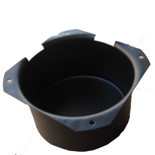

As for the shield, it shouldnt be no more then 8bucks per shield and should look like the one from the photo bellow. Or diy yourself from a thick carbon steel (it doesnt remain magnetised).

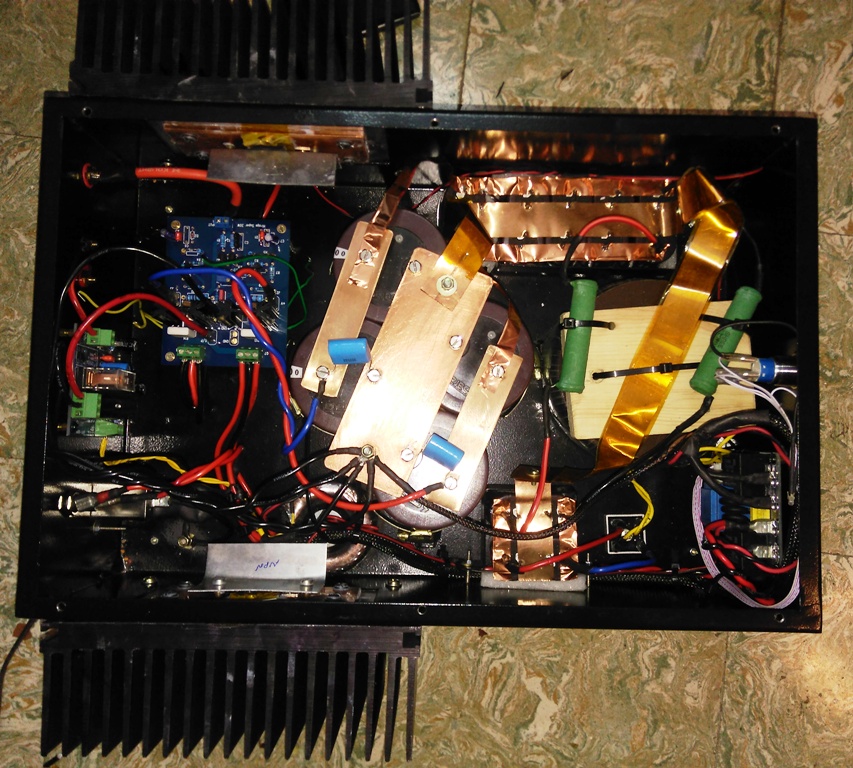

Thanks Sergiu ! Amp bias on one channel is slightly higher compared to other -around 0.025 volts. But both of them have similar bias resistance of 35.7 Kohms . Probably I'll increase the bias resistance by 1K and check!
Regarding the toroidal Bowl, I'll check if I can get it made .. hopefully amp chassis should accommodate it.. it's already right!

Sadik i forgot to tell you also to shield those nasty toroidals because they are emiting strong magnetic field..
In your case you can sandwich them to cancel the magnetic field without a shield.
Even if E+I trafos have lower emi in my case i put a carbon steel screen in front of them. Look at my pics a few pages back.
You should take into consideration that if you and Som worked so hard and long to achieve the best results possible, it is pitty to ruin things up at the finish line.

@Sergiu , if you are referring to connection on binding posts, yeah for now wires are soldered on spades which are screwed to binding post core. i would take your advice and solder them directly onto binding post after i change them. because, after i bought the current ones, i realized that the core of the binding post is made of Steel - i'll be upgrading them to Brass made posts over the weekend.
my rest of the copper wires are tinned at wherever screw down connectors are involved and same treatment with wires having ring terminals or spade connectors.
can't wait to post pictures of my amp - gotta wait till i update the above.
also, this morning - same amp had max of 0.577 bias voltage [1.74 Amp of Bias Current]. my mains voltage sees a lot of fluctuation.

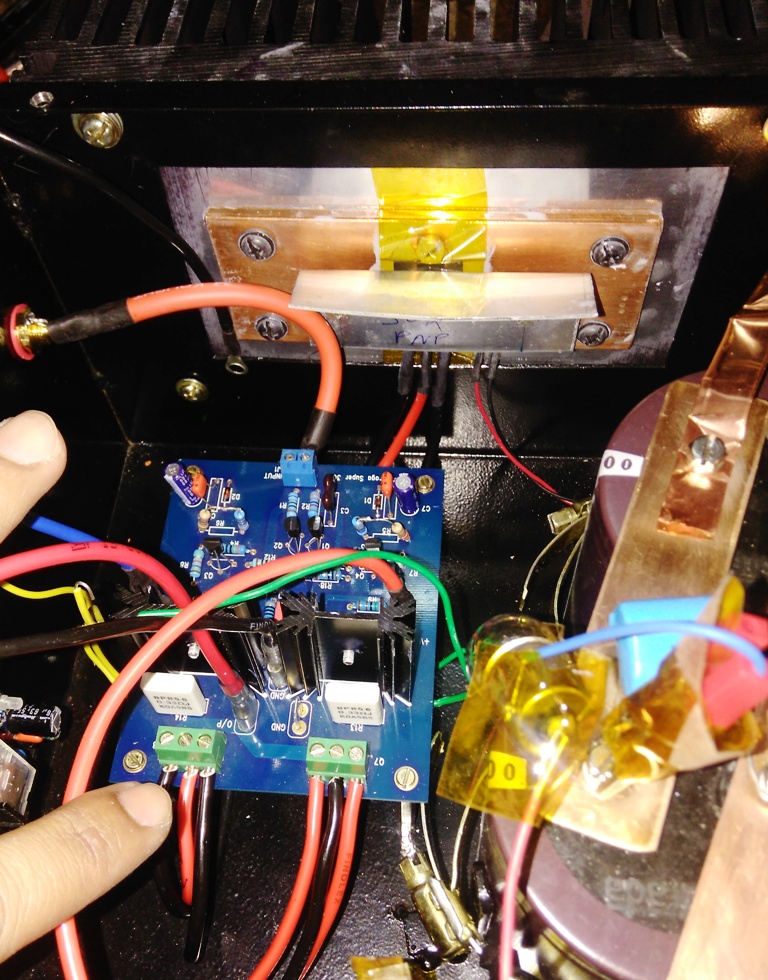

hi all, update regarding the bias settings, i updated the bias resistors to control the bias currents:
on channel A, i added 1K resistor taking the total bias resistor to 36.6 K Ohms.
results after powering/playning for for around 4 hours: 1.77 Amps of Bias Current at ~30VDC rail voltages[Night], temperature ~54 degree Celsius and 1.69 Amps at ~27VDC[Day] rail voltages
on channel B, i added 800 Ohms resistor [since this channel had lesser bias current] - total resistors 36.4 Ohms
result after powering/playing for around 3 hours: 1.76 Amps of Bias Current at ~30VDC rail voltages[Night], temperature ~51 degree Celsius] and 1.66 Amps at ~27VDC rail voltages[Day]
i also covered the RCA input cable inside the cabinet in techflex since it is running close to heat sinks. not sure if it's because of this or resistors : i can hear a very faint noise from the speakers at 2 inches distance which was not there earlier. this persists even if i disconnect the input to the amps. though i can't make out in normal conditions but in dead silence [around 3AM] i could hear them as i was seated very close to speakers. what could be the issue?

hi all,
i've connected the Alpair 10.3M raw drivers for testing/burn in on both channels. i seem to have got rid of most of the noise but one issue remains. i have 2 mono blocks : channel A and channel B
1. if i play music from both the amps, i can hear a faint noise [sounds like 'krrr..] from the speakers even when the music is volume is lowest [or on mute].
2. if i switch off amp B while amp A still playing then the noise is gone completely.
3. but if i reverse this : i.e switch off amp A and amp B is playing i can still hear the noise.
4. and if i disconnect the amp A completely[remove the RCA cables] then there is no noise when amp B is playing.
above combination simplified - while input[preamp] is connected:
1. A[On] + B[On] = Noise
2. A[On] + B[Off] = Silent
3. A[Off] + B[On] = Noise
4. B[On]= Silent
i tried different sources and RCA cables/switching of input channels but above issue remains. what could be the issue? is amp B is the culprit?

okay, i seem to have resolved the issue.
on Amp B:
1. i used PTFE tape to properly insulate the RCA posts to isolate it from chassis. RCA posts did come with isolating rings but looks like the sheet metal of chassis is thicker then those rings.
2. i redid the RCA wire input to amp PCB by shortening the wire and re-soldering all the joints.
3. i tightened all the ground wire terminals and nuts [star ground and protective earth]
above steps have helped me in eliminating the electrical noise in speakers completely. now the wait for speaker cabinets begins. right now raw drivers [Alpair 10.3M] have been connected to amps directly. i must say they sound clean , ofcourse with muted low notes since they are simply mounted in a hole carved in their own packaging cardboard box.
amps are still playing without their top plate as i'm monitoring bias voltage and heat sink temperatures. they seem to have settled nicely for now. the moment i get the speaker cabinets made my stereo set-up would be complete!

Sergiu, where can these nice looking shields be obtained?
albert

Hello Albert, they are from alliexpres (https://www.aliexpress.com/w/wholesale-cover-for-toroidal-transformer.html) but i did found some of these on my local shop cheaper.

Thanks, looks good. Here all the local shops seems to have disappeared. 😕
Here in RO these shops are still a valid source. 😎 Of course here in our country, they usually sell carbon resistors and cheap stuff, BUT if you look carefully you can find some obsolete trannies (if you know what you are looking for) , russian military class resistors, caps, trimmers, some Dales some nos russian valves. Interesting stuff... Its petty that they are extinguished one by one in your country.
