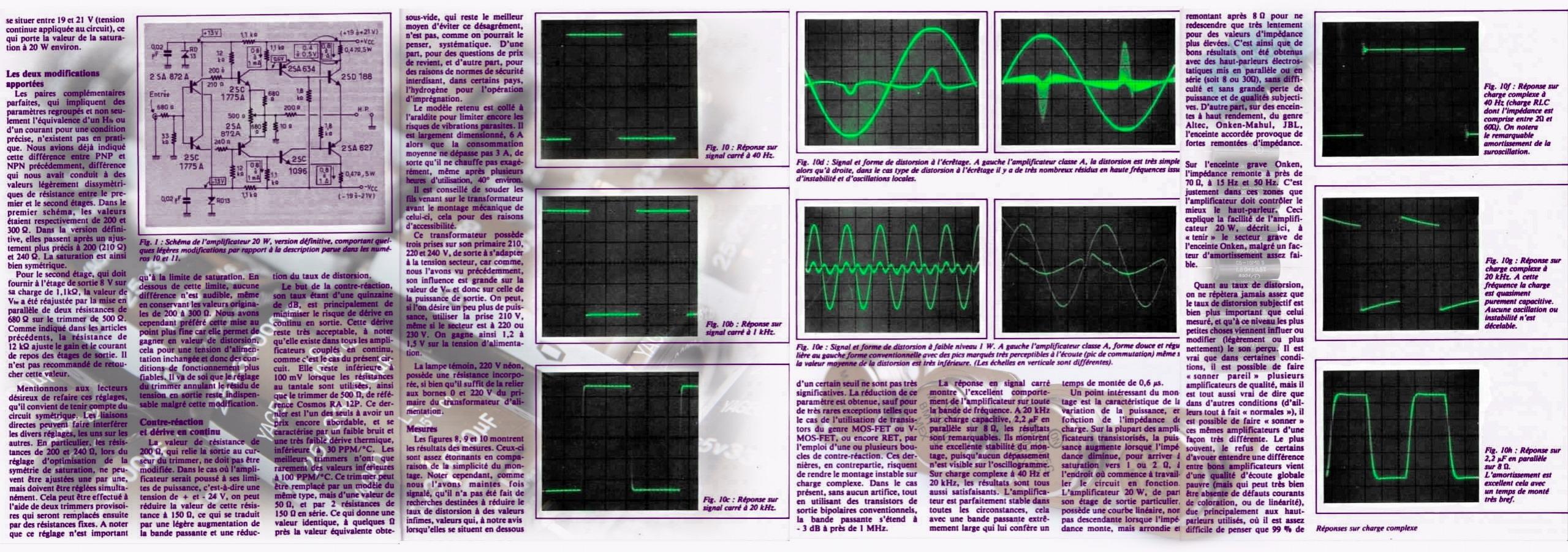

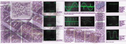

Rise time 500-600 ns (approx). FR up to 1 MHz (-3 db). And yep - excellent stability on capacitance load.
Thank you Damon, very kind of you.
I know that picture, but I can't find the voltage values between witch this rise time is measured.
What is the slew rate for a rise time of 0,6us ? (in this case).

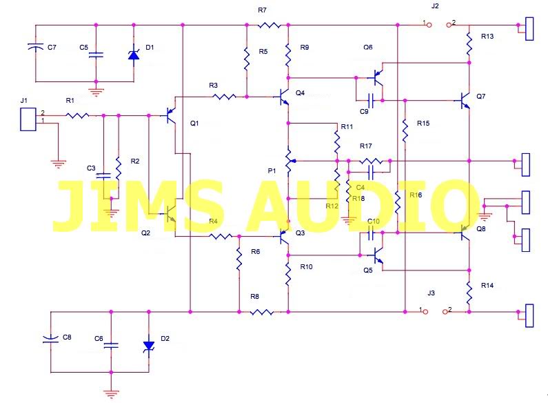

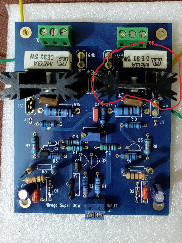

hi all,
it has been few months that i've been enjoying my Hiraga. amp boards are from Jim's audio off ebay.
few days earlier, one of the amp board stopped working. not sure what is causing the issue, but the moment i connect the amp board to power supply, R14 resistor [0.33 Ohm, 5 W - the one on the right top side in the below pic] burns red hot and gets destroyed. i tried replacing resistor and Q8[MJE15034] driver transistor as well but of no use [even the old transistor reads fine on DMM]. can anybody help me in identifying the issue?
-i've measure the power input to board and it is within the limits.
-output transistor seems to be fine too [i've not removed this from the heatsink for measurement though]

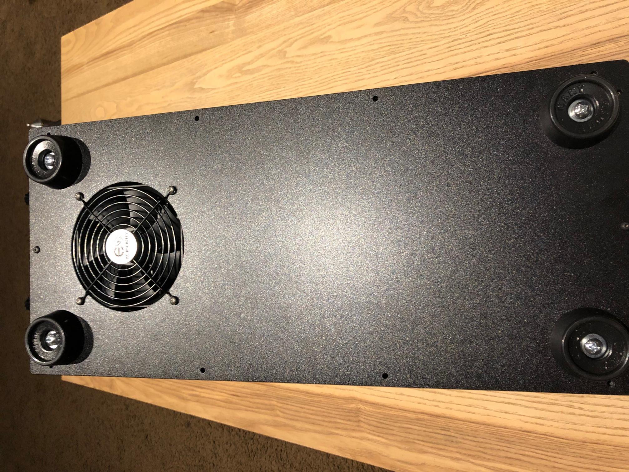

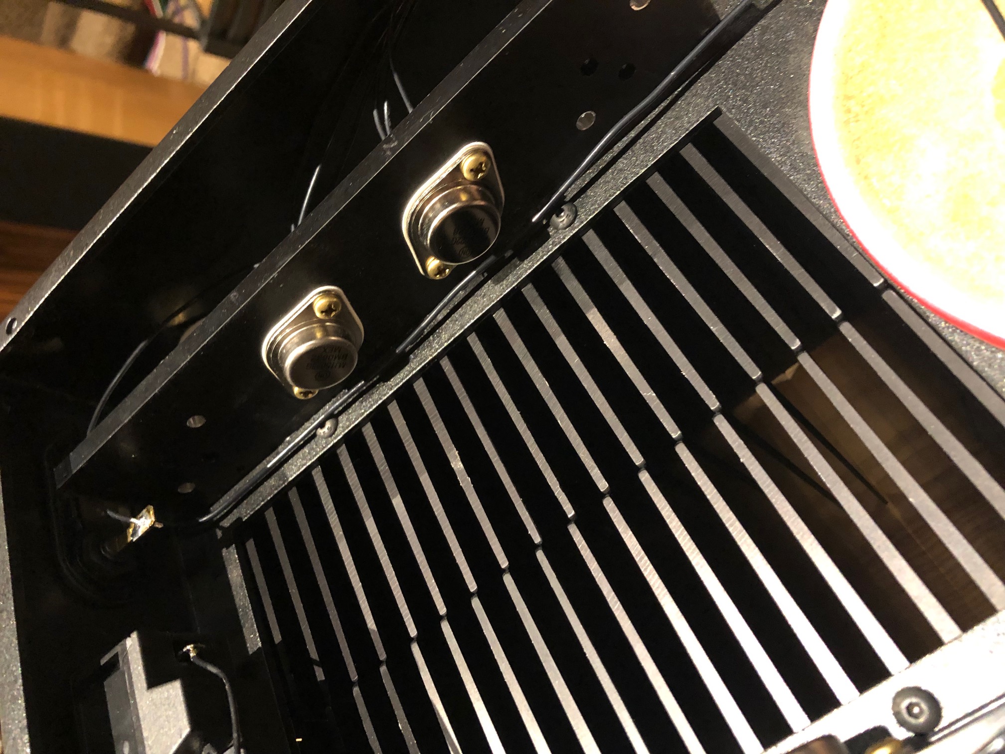

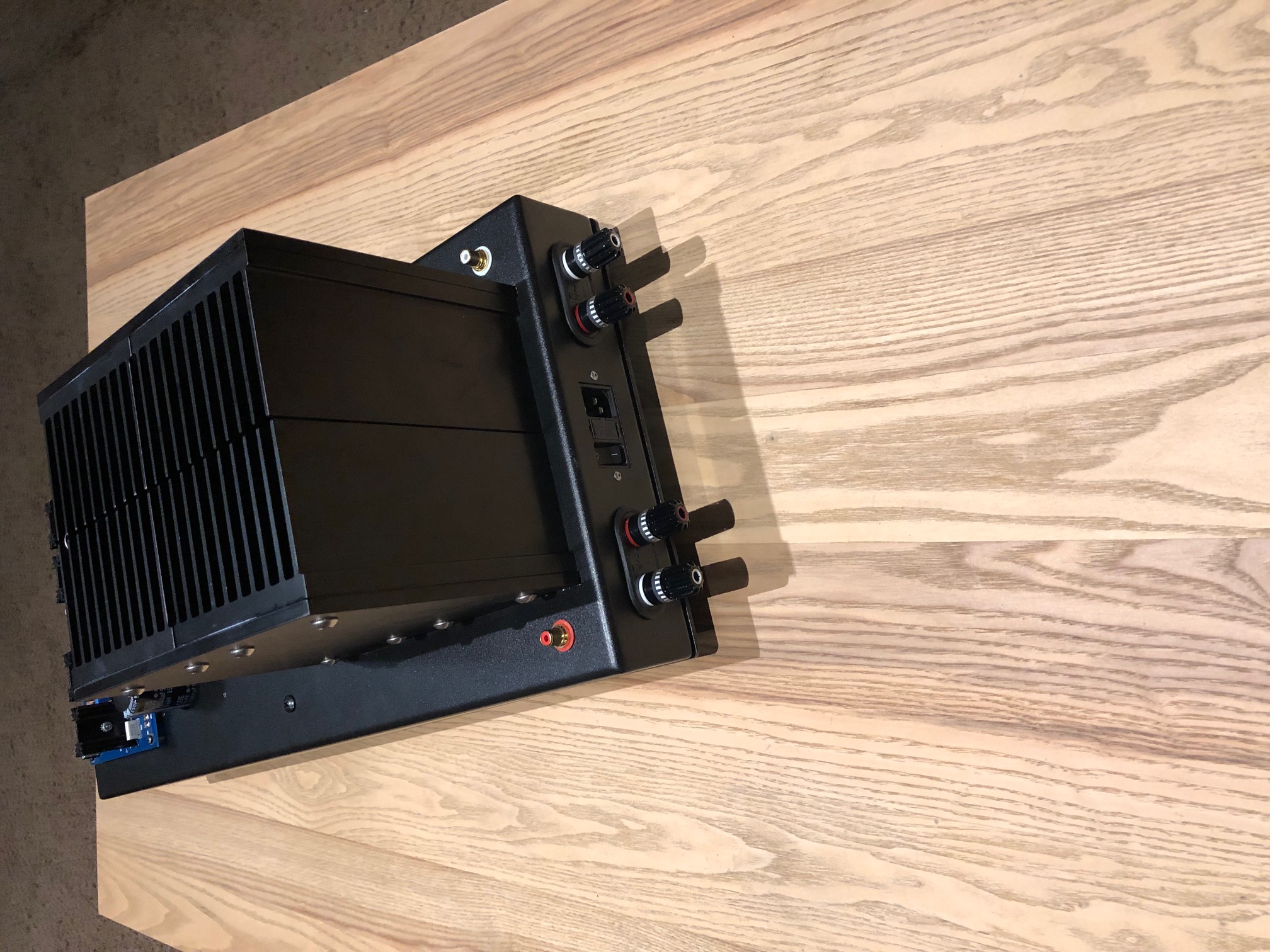

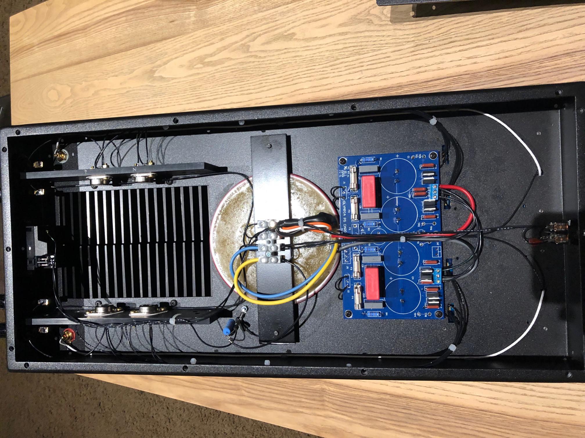

Finally finished this little fun side project. Used KSA992/KSC1845 on the front end and MJE15029/28 for drivers on one board 2SA1837/2SC4793 on the other - have no idea how that happened 🙂 they were built several years ago. Outputs are MJ15022G / 23G
Still need to have faceplates made - I made 3 of the Chassis years ago too - need to get a 5V DC supply for the fan going as well before I Bias at full value - right now they are biased at 800mA.
Smooth sound with lots of detail - a remarkable design.
Good Listening
Peter

Hi Som, did you figured out yet? I think your output blew.. Been through that..

Nice! You guys are making such a nice looking finished projects. I have no problem making pcb, drilling holes, soldering parts, adjusting bias, making it all working, but putting it in nice box with neat front is a pain.

Hi Sergiu! how are you?been long..
not yet, i've exhausted my supply of resistors and driver transistors. amp board is still lying outside. strangely all the components read fine on DMM. probably there must be some kinda short on the pcb while de-soldering - difficult to find out though.
output transistor measures fine on DMM - will have a look at it again. if Output has blown it would be a pain to source the pair again! 🙁
might have to think about locally available alternate options.
worst case, I'll order one set of amp board from Jim's.
