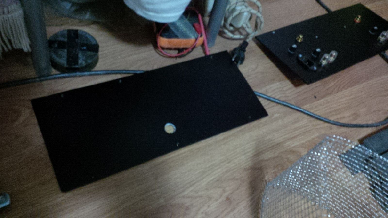

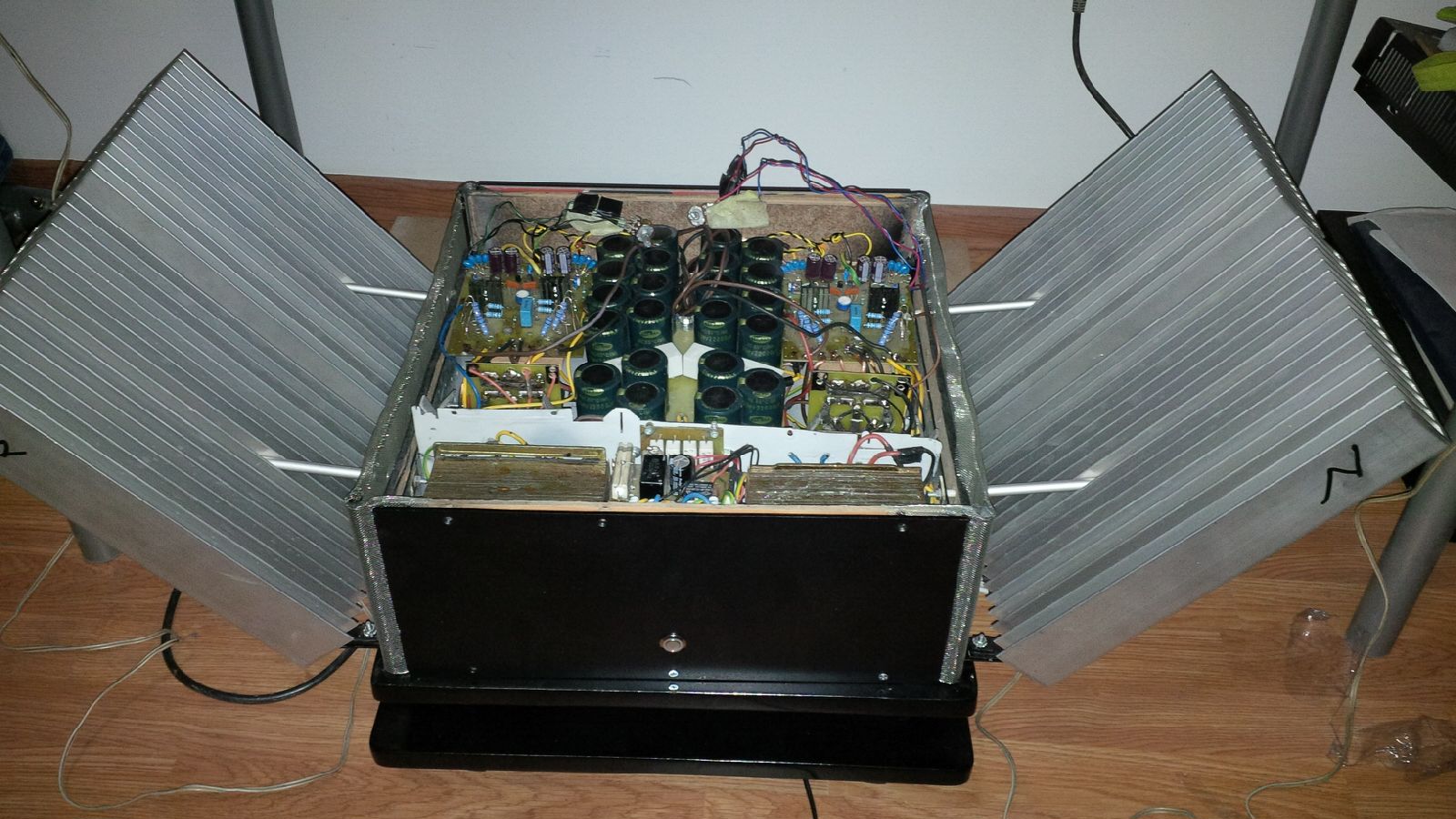

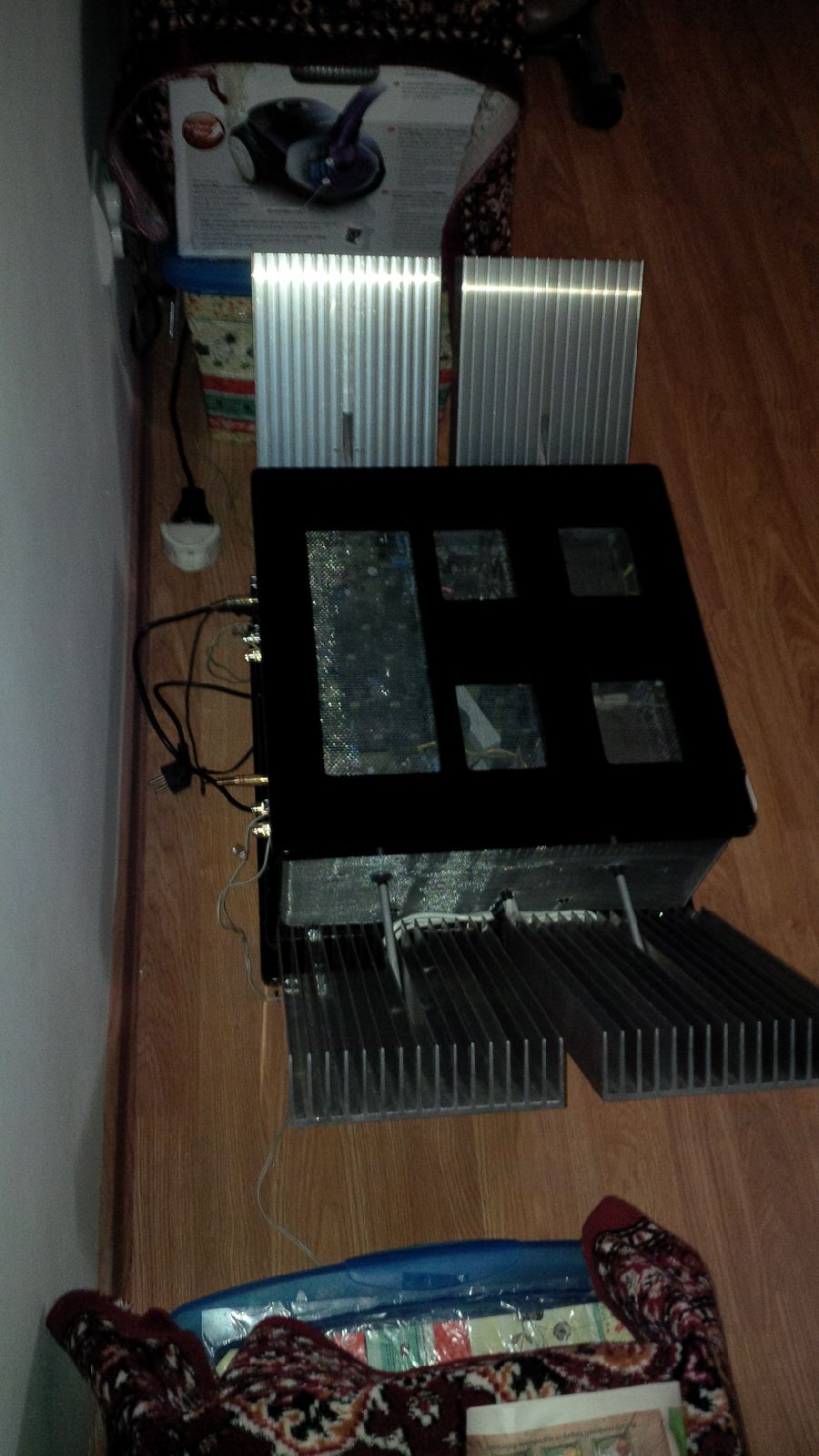

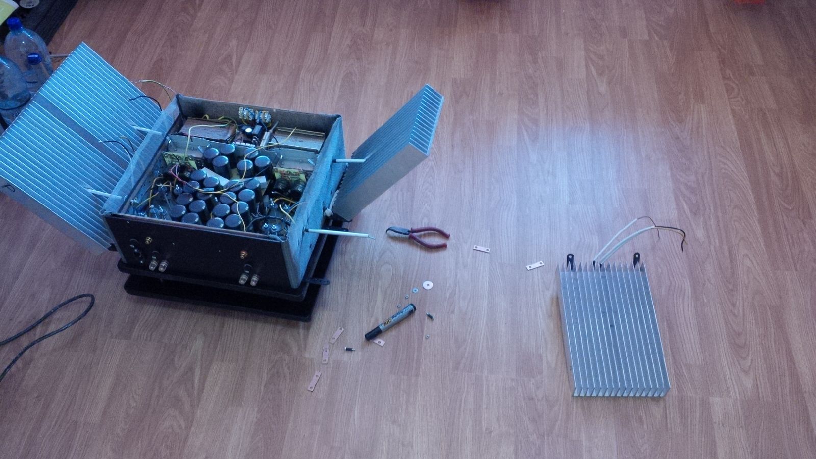

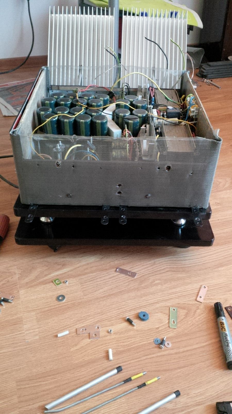

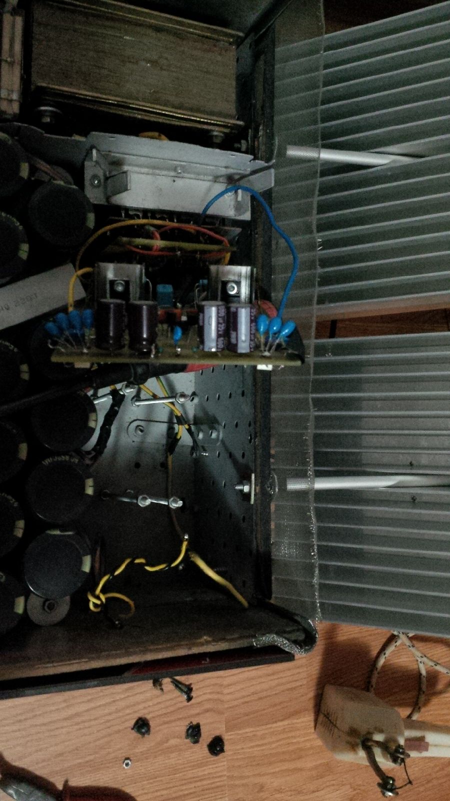

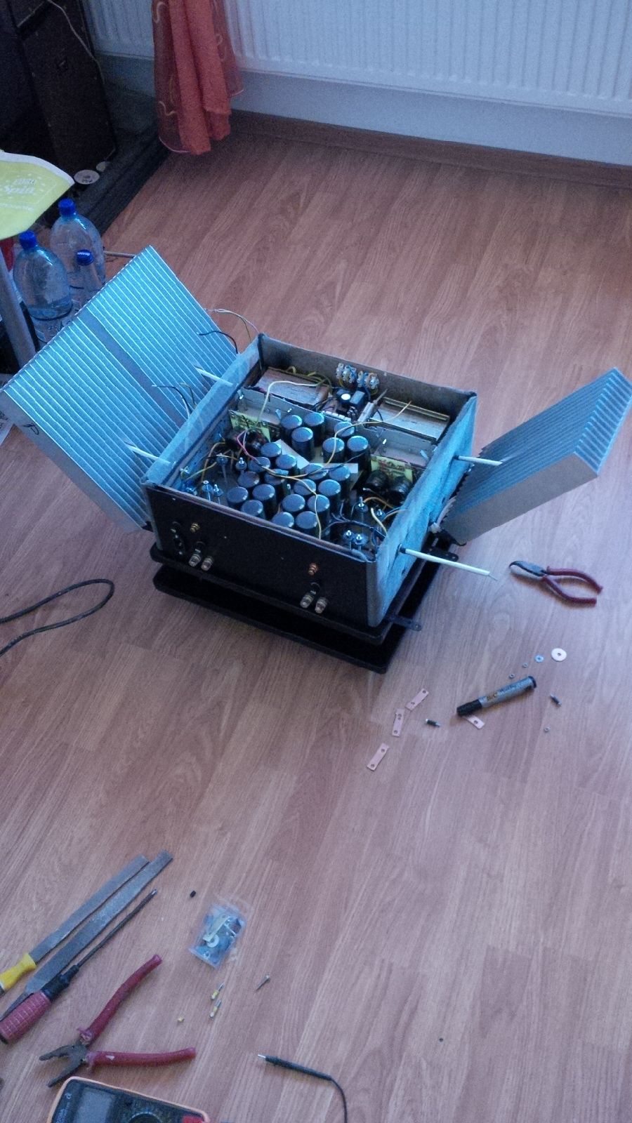

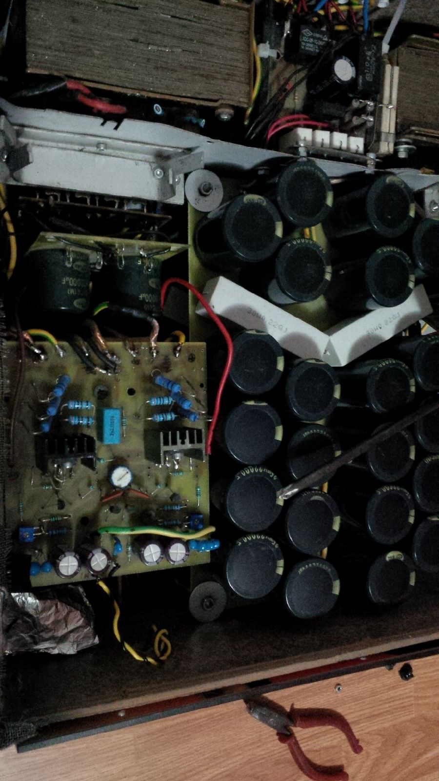

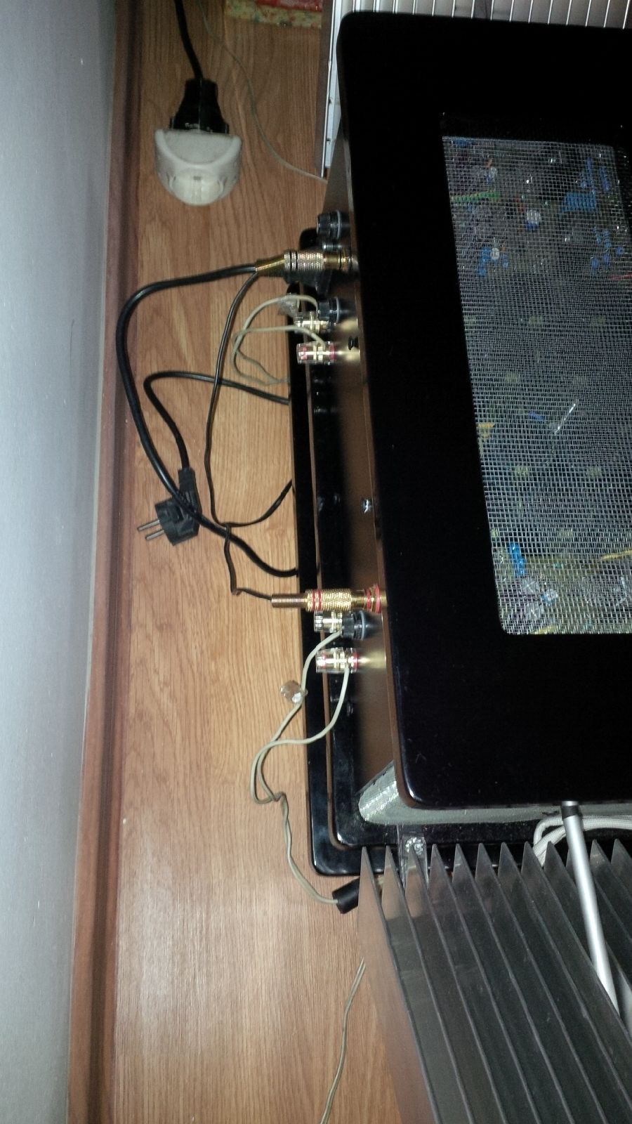

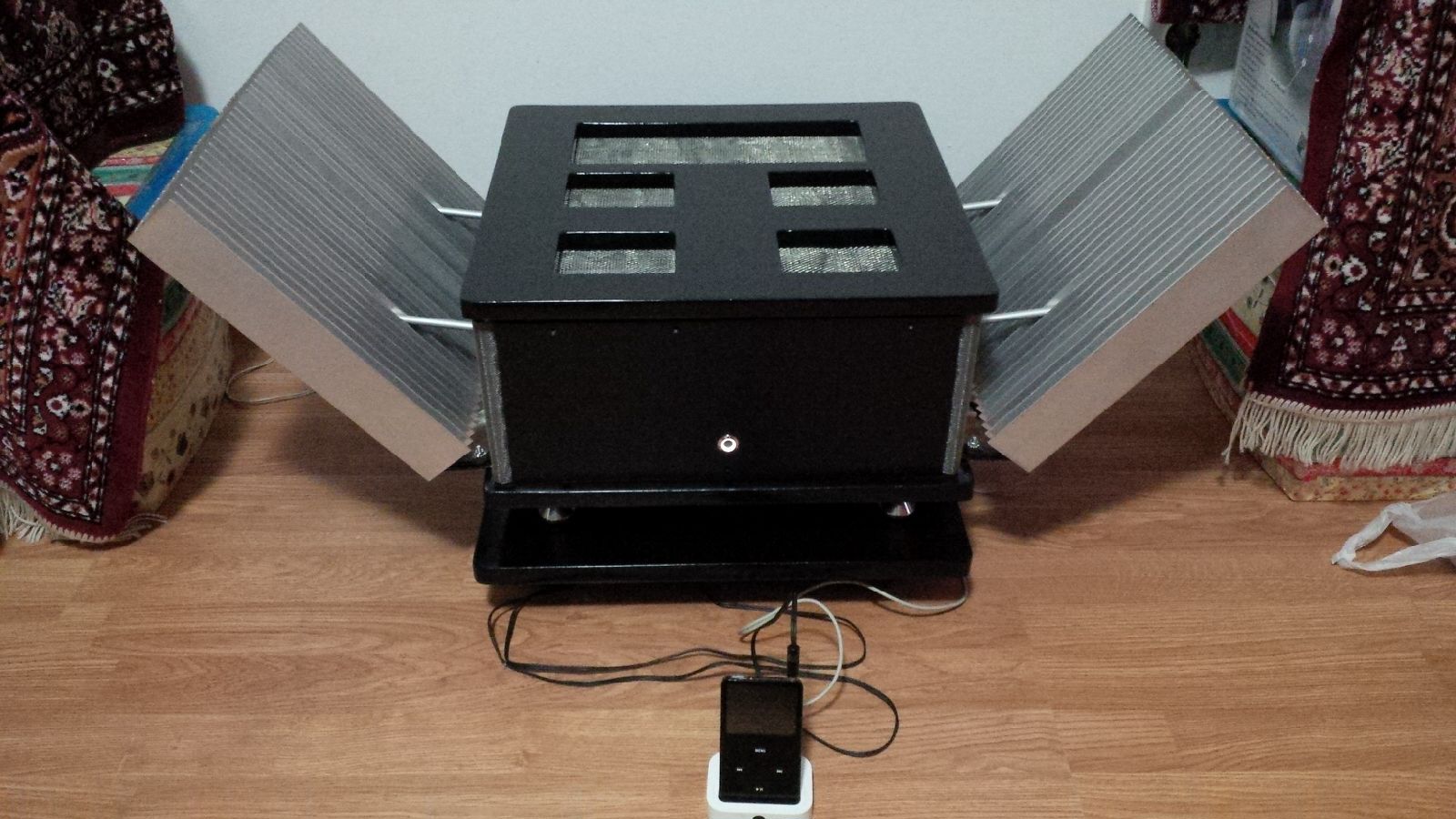

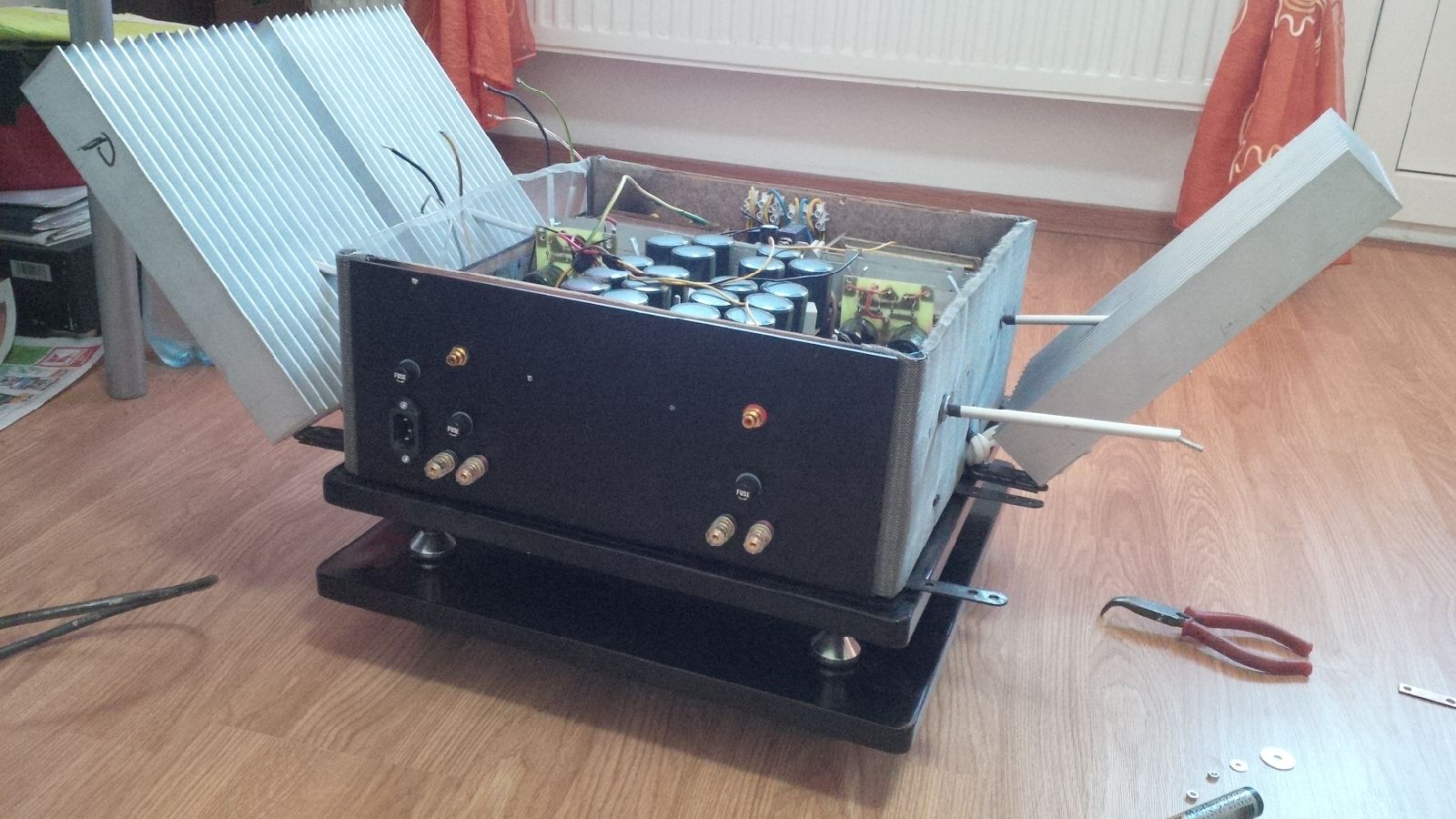

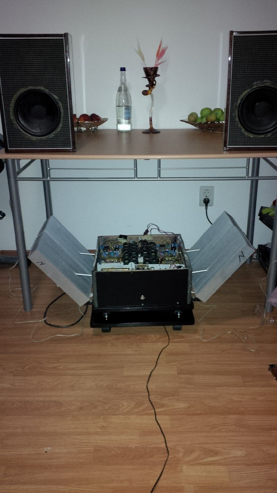

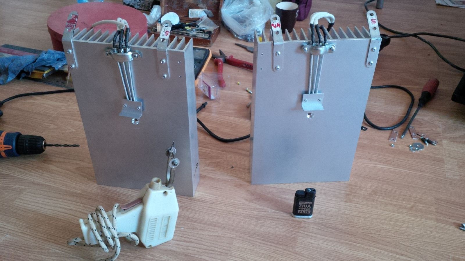

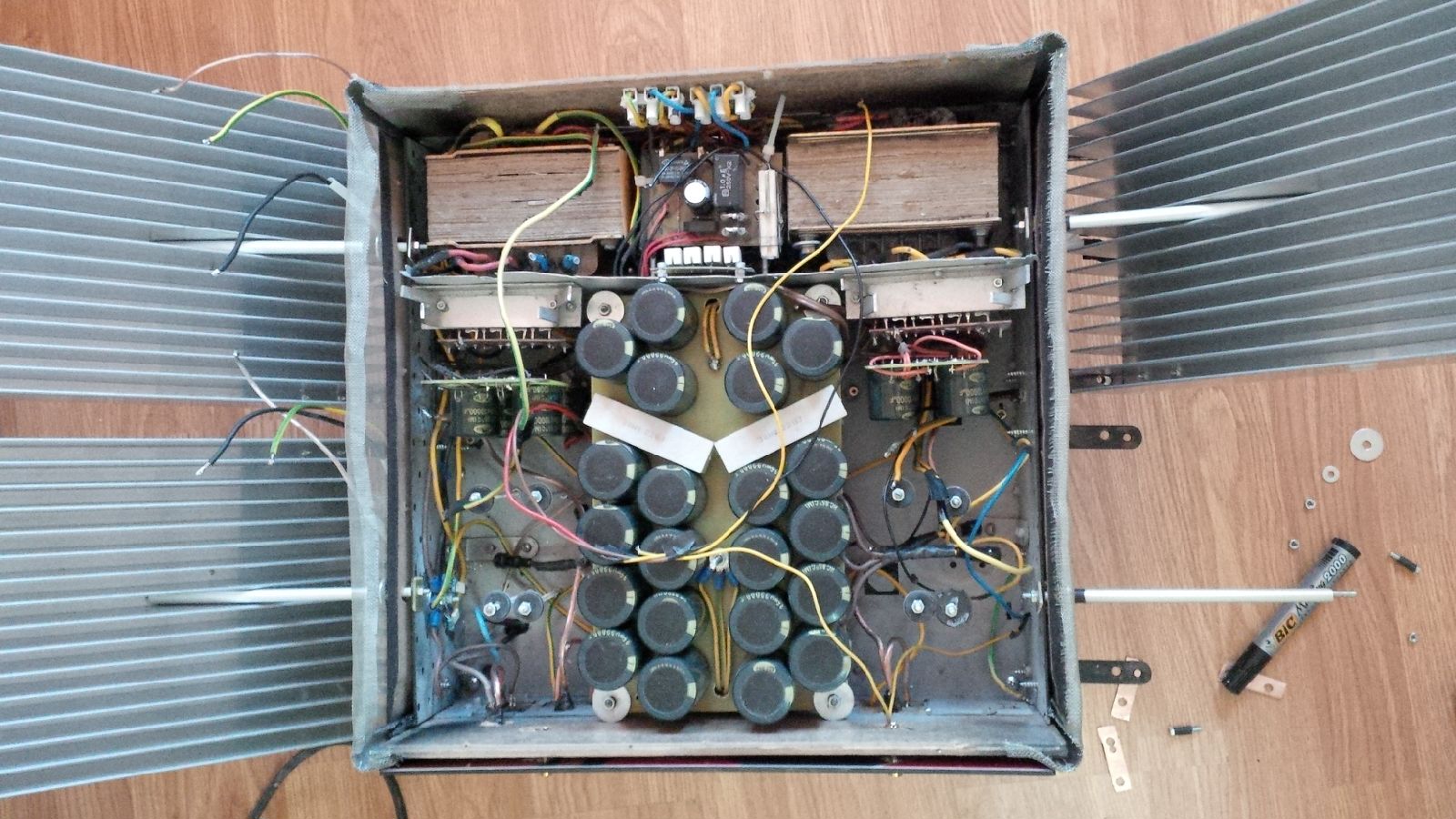

At last, my work is done. My Jean Hiraga Super class A
Hello my dear colleagues,
I can now proudly present, after one year of construction at this amp and allot of hours of labour for the case, wiring, listening tests... I had to say that I tested approx all the possible variants of components, and wiring (wire gauge, earthing, and cable managemnt),except for the regulated psu, Kubota regulated psu mod for input and CLC mode for output. ( keep these mods for later upgrade)...
Here are the specs:
1. Two 300w trafos, bicafillar winded (equal impedance on both rails) ,custom made, one for each channel.
2. Ultrafast soft recovery high voltage high current diodes + 484000 uF filtering (22 pcs of 22000uF/35v for each channel CRC): 66000uF+0.22ohm/30w+176000uF/35v //per rail
3.Four small 10 w paralleled secondaryes for equal impedance, two per channel giving 20 w of juice just for the input.
4. Ultrafast soft recovery low voltage low current diodes + CRCRC psu for the input psu : 10000uF/35v+2*1ohm/3w paralelld resistors+ 10000uF/35v+ 3*1ohm/3w paralelld resistor + 2*1000uF+1*680uf low resistance Nichicon caps giving a total of 22680 uF per rail.
5. All of the components are matched on the amps within 1% passive components, 1% input trannies, 5% drivers and 8 % matching for outputs. I had chosen the drivers and outputs after listening to them in the long listening and exhausting session nights, and from 5 different series of outputs and drivers with different cobs, ft, and Pd's (on semiconductors, sanken, toshibas).
6. The amp receives 23vcc for the input stage and 27.2 vcc for the output on each channel, and a bias of 1.65 A idle current (sounds way relaxed and better at this current) and its outputing on 1000hz sinusoidal signal 38w@8ohm sinus into dummi load at clip and 35w into my speakers with ease.. The idle stays rock sollid after 30 mins of varming up at 2mV on left and 4mV on right channel.
7. Soft start (diy audio version).
8. A big radiator for each output, with no insulator between each output trannie and the rads, only Prolimatech silver thermal grease and the rads completely isolated from the chasis. As you can see they are optimally oriented with the fins up and trannies bellow for the best heat dissipation because I saw when you rise the bias on this amp the temp rises rapidely, fact wich made me change two sets of rads till now, and tgis is the third pair. The is allot of heat dissipation here and if you want a longer life for the oitputs you have to go with the biggest rads that you can find.
Now they are running at 48 degrees celsius per output trannie @ 19 degree ambient in the winter..
I think that the whole amp has aprox 30-35kilos and it is really hard to lift. It has wheels for moving.
Almost everithing is made from scratch.
I will open a new thread with all of my findings about this amp till now and about my choices for the different components.
Thank you all for the help to all of you : 6L6, ZenMode, Ovidiu, AlexxMM, and all the other colleagues from the Hiraga 20w amp thread who helped me with good advices and sugestions.
Cheers to you all.
Altought it hasnt got an audiophille music source, now its runing on ipod classic 5.5 @ wolfson dac chip and Rockbox moded, it still blows you away with its realism, sweetness, soundstage, bass, controll, dynamics,and level of details.
Cheers
Sergiu

Good job Sergiu,
It does look different!
Rick
Thank you. The design is great, but sounds far better than it looks.
Now I have too look at a preamp for it. I was looking at a Kaneda preamp but there are very few comments and materials or articles on the net about it...😡
It is curious that I havent found a preamp from Hiraga other than for turntable.. I dont know why. Its strange.
Cheers
Sergiu

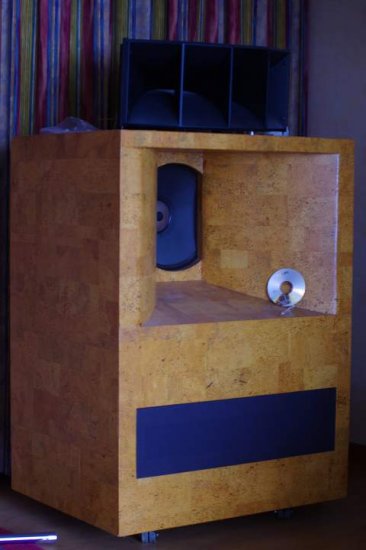

I did hear several solid state designs in France. Lost count but i did visit that shop at least 30 times. Not all of them were by Monsieur Hiraga.
Usually they were using Voice of the theatre ( altec bass bin and sandfilled wooden horn with TAD2001 driver for 600 hertz up see picture) which sounds very nice with the 20 or 30 watt Hiraga amps but also sounds nice with single ended triodes.
But the bigger amplifiers ( not by Hiraga himself) were rather complicated to build. A lot of active parts which needed to be matched i guess. I did meet several people who did have problems with these amps. Once did visit a show where one of the amps did have an '' oscilating sound ''

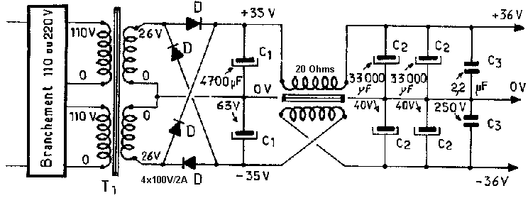

The 20/30 watts hiraga are a much easier bet. If you can have transistors that are kind of matched you are half way.. What i did also do is using the same '' heatsink '' for the drivers. Of course you will have to isolate them from the heatsink to not cause a short circuit !!. I remember if you touch one of the driver which will make its temperature go up DC at the output will change. Touching other driver dc would change into opposite direction!
Nobody so far did start using Lundahl choke instead of the power resistor in the power supply. Dont worry to much about some extra dc resistance and current rating. In the Hiraga there isnt much of voltage across the choke so it can handle extra current before it will saturate.
The choke(s) is (are) a small investment but typical diy others should try first because everyone is on a budget lol.
