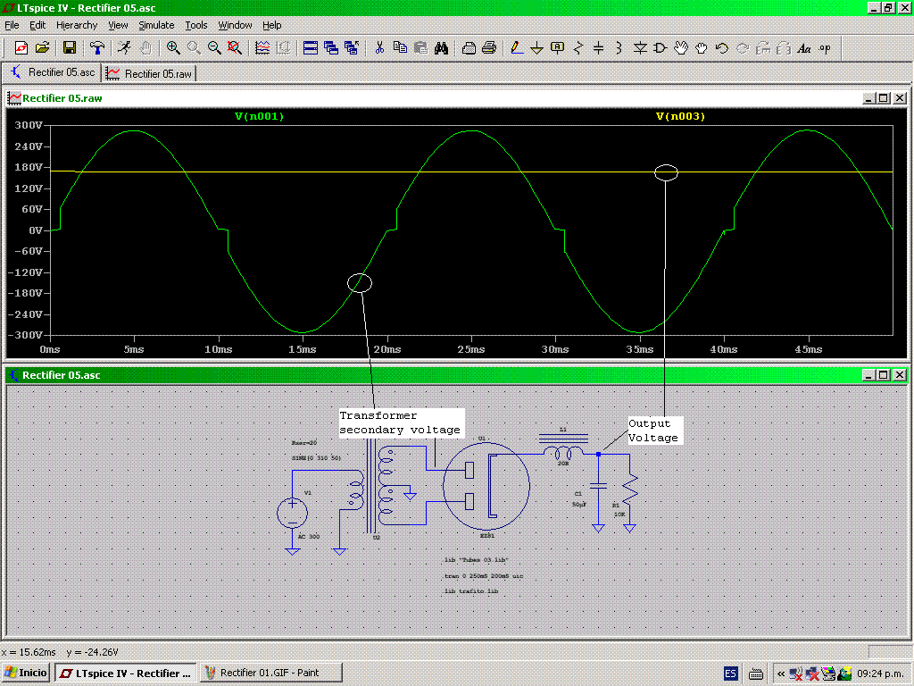

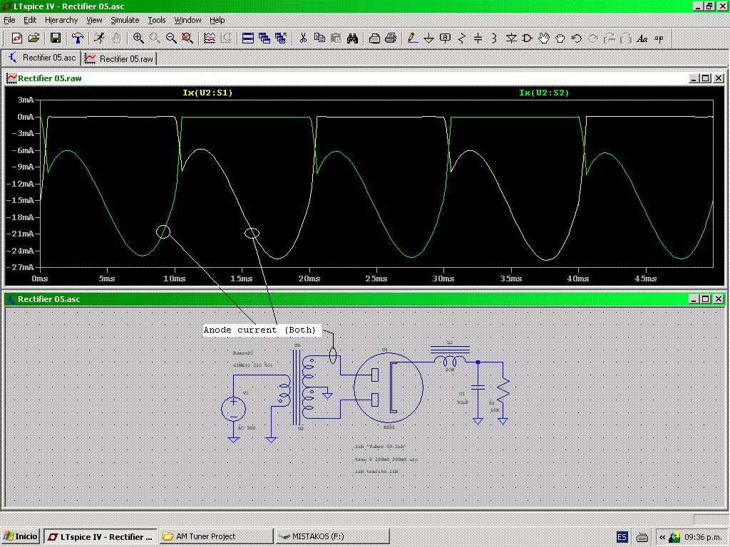

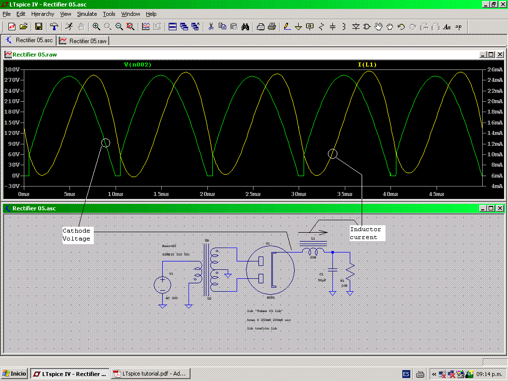

This is a brief explanation of the power supply unit I will make for my tuner.
Although it is suggested that input choke filters are mainly used for high current application and or where a high degree of regulation between light and full load without any active regulation, it possesses some advantages I will try to show in this sketches. I strongly like this kind of filters, because it make better use of the rectifier tube (Although it is overdimensioned for the current I will take from it), it also drains essentially sinusoidal current from the transformer, providing that the inductor current is not allowed to be reduced to zero, or the inductor is said to run dry. Then it acts a natural PFC.
The images below are self explanatory.

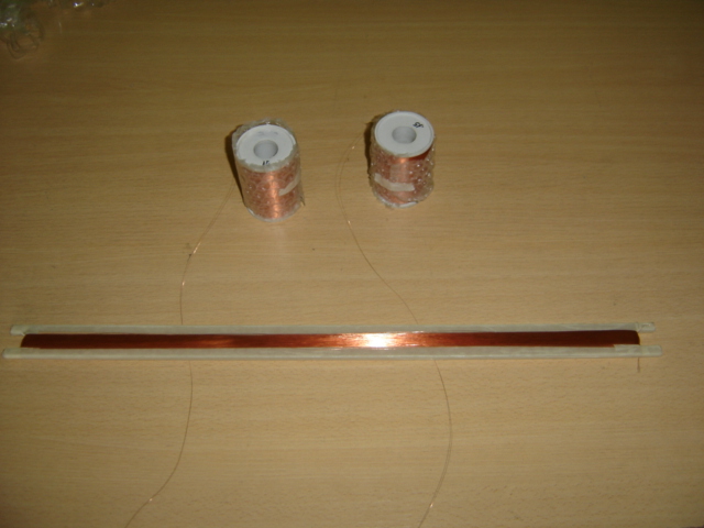

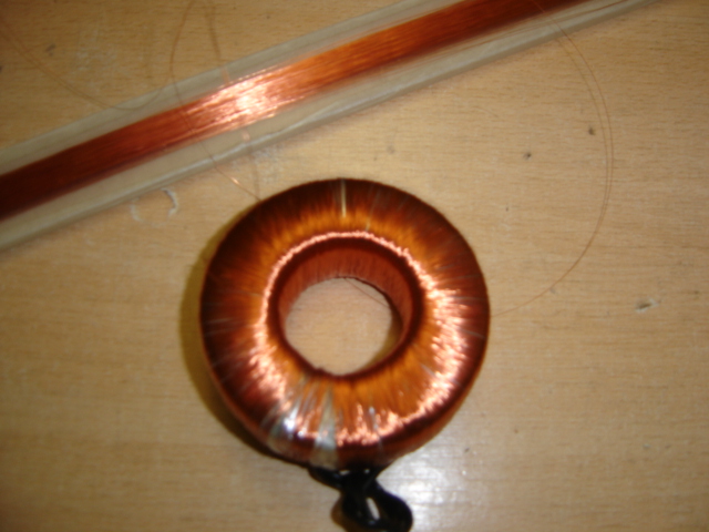

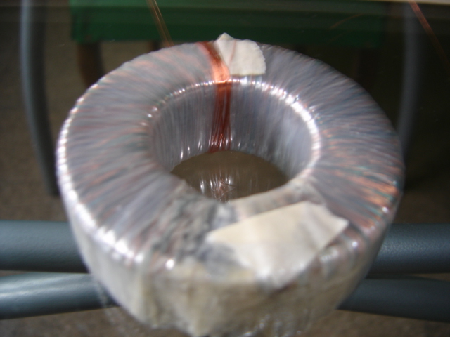

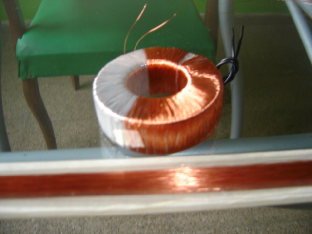

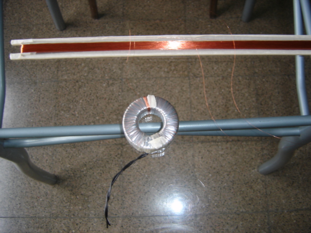

The toroidal mains transformer under construction
Here, some photos of the power transformer at some intermediate stages while rewinding.
