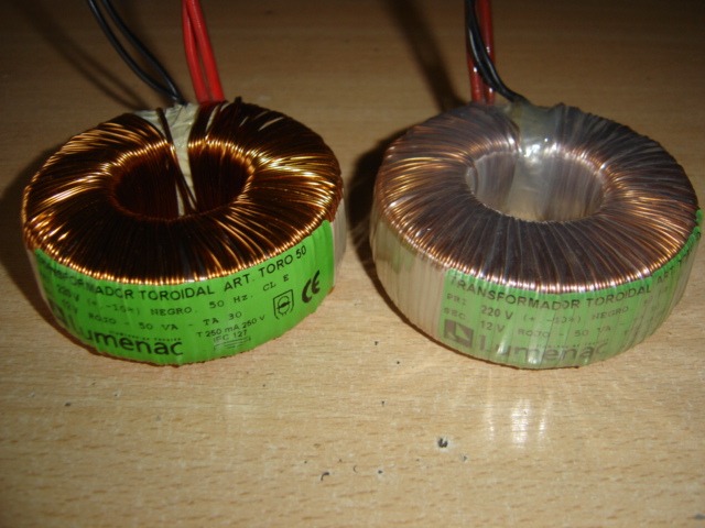

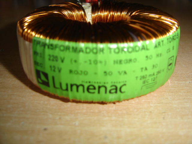

The next steep is to make the PCB, when I finished it, I'll post some photos of the finished project. And this moment, I'm designing the power supply unit, with toroidal transformer rewinding for this project, a tube EZ81 for rectifier and with choke input filter.

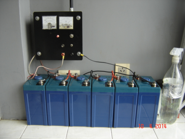

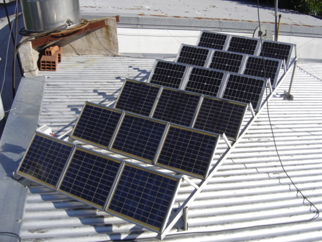

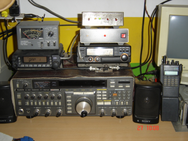

Yes, I'm ham since 1987, LW1DSE. I don't know him. Here are my radios and the power source.
OK, thank you, although the las May we had only 4 or 5 days of full sunny, the rest only rain, clouds, fog and mist. 25 days without Rha‼
(I must to use a usual charger to maintain the batteries alive).
Also, not in the photos, I have a fridge operated from the 12V supply.

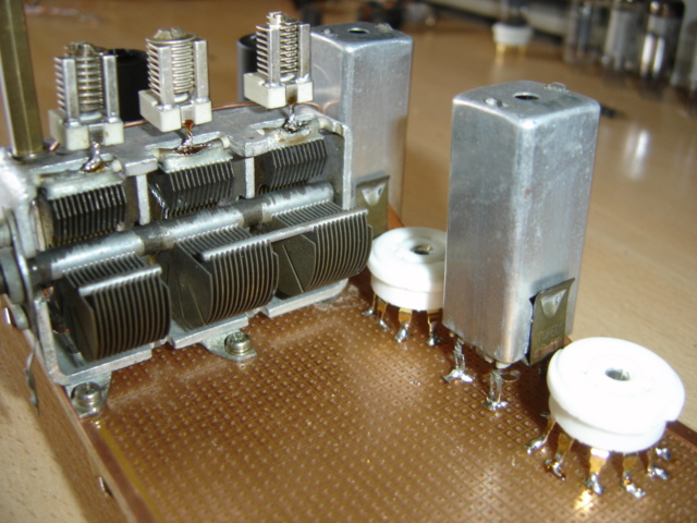

I am still not convinced that the AM detector uses both diodes.
Yes, boy. I do uses the diode. I could see an advantage in about 6 dB in the recovered audio, respect to the diodes in parallel. Note that the second IF transformer has none of the ends grounded for RF signals, then both are live. I want to post an oscillogram, but I haven't a signal generator, and normal air signals varies too quickly for my camera can take a good detailed photo.
Also, as a tube diode has a relatively high internal resistance, the positive side of the signal that one of lets out, then the other catches it.
Believe me, it works pretty fine‼
I suspect that adding a scope probe will disturb the circuit, as your AM detector works at quite high impedances.
I can see that one diode (EBF89 pin 7) will conduct when the grounded (via R8 1M) end of the secondary is negative and the other end is positive. What I can't see is why the other diode will conduct when the situation is reversed. If it really does work, then all I can think is that stray capacitance somehow provides a grounded virtual centre tap for the secondary.
The oscilloscope doesn't disturb the circuit, as I always used it connecting the prove to the cathode of the follower. Respect to the high impedance, you are right, it works at about 1MΩ as I told in the above paragraphs, following the book's suggestions: decrease all I can the AC and DC loading of the diode. But future decreasing the resistive part, becomes the parasitics (Mainly capacitances) relevant and disturb the idea.
Look at this. If the lower diode conducts, it makes it with some resistance, so, the entire secondary transformer is maintained at somewhat positive voltage above ground. This positive voltage is catched by the second diode, the one added at the live side of the secondary. Also what you said are partially true, because the diodes have some capacitance and some resistance (Ignore inductances at this frequency), so there exists some AC currents though the diodes.

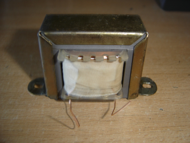

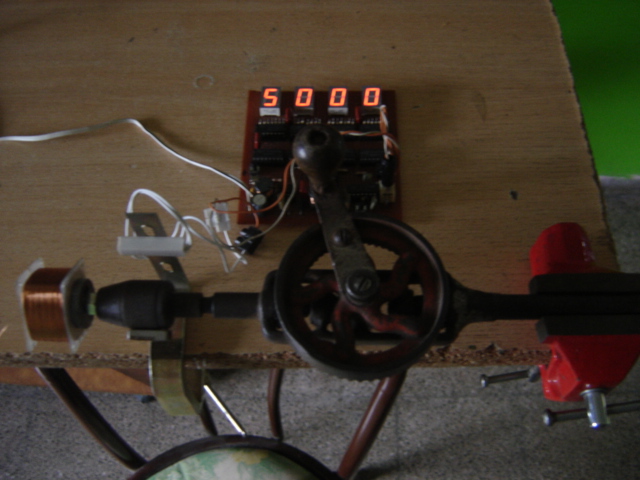

Still more photos for this project: the choke input while being winding, and the transformers, one of the the secondary was dismantled to give place to the 220+220V secondary, still not completed.

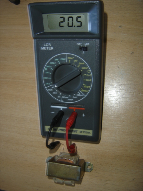

The choke is composed of 5000 turns in a bobbin for lam. 42 (14*20mm) of 0.15mm wire diammeter, for a 22Hy 30mA inductor. Air gap is 2 * 0.3mm wide.

Ok, I think I am beginning to get it. The extra diode compensates for the relatively high value of the 1M ground leak. Without the diode, the secondary would tend to float up to a positive voltage. I think my mistake was in thinking that the extra diode gave you full-wave rectification (hence +6dB), when it actually helps to repair the half-wave rectification given by the other diode.Osvaldo de Banfield said:Look at this. If the lower diode conducts, it makes it with some resistance, so, the entire secondary transformer is maintained at somewhat positive voltage above ground. This positive voltage is catched by the second diode, the one added at the live side of the secondary.
Given that you have a triode, an infinite impedance detector might be better.
Well, boy, excellent. I believe we are understanding each. Respect with the infinite impedance detector, some people has talked about it, but as I wrote in the firsts paragraphs, I wanted to try some new ideas, so I applied them to my receiver.

Kevin: as the project is still under development, the PCB will be the last steep to take. Currently, I'm working in the power supply, a toroidal transformer partially rewind (Secondaries) and the inductor for the choke input rectifier.
The project is working with a temporary power supply, but the running voltage is too high for this tubes, +275V. So the final project will feed with 180/200VDC, a more reasonable one. The main rectifier will be a EZ81, and a second one 6AL5 will provide the negative bias for the circuit. I bought the wire for the secondary (0.15mm diammeter) by an internet supply called Mercado Libre (Something like Ebay) but local for Argentina, but the wire still isn't at my hands.
Here are some photos of the inductor designed and finished.
