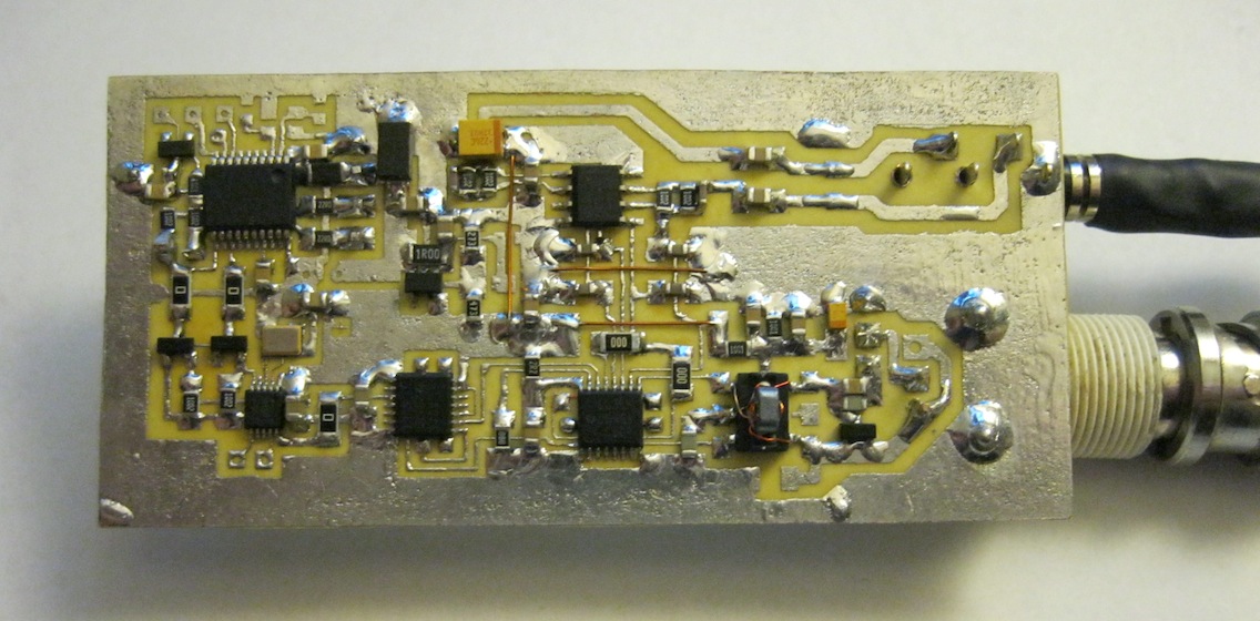

I'm attaching photo one of my SDR prototypes.
More on that here:
ZMSDR V3 testiranje YU3MA
On second photo is shown my first SDR prototype on breadboard made many years ago. Believe me that I did'n find sound difference in reception compared to Icom 706MKII! Just imagine how good SDR can work with more advanced electronic and fast A/D converters ...

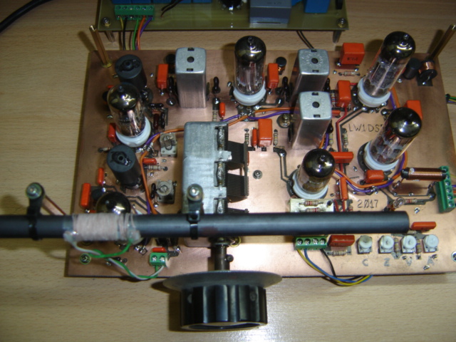

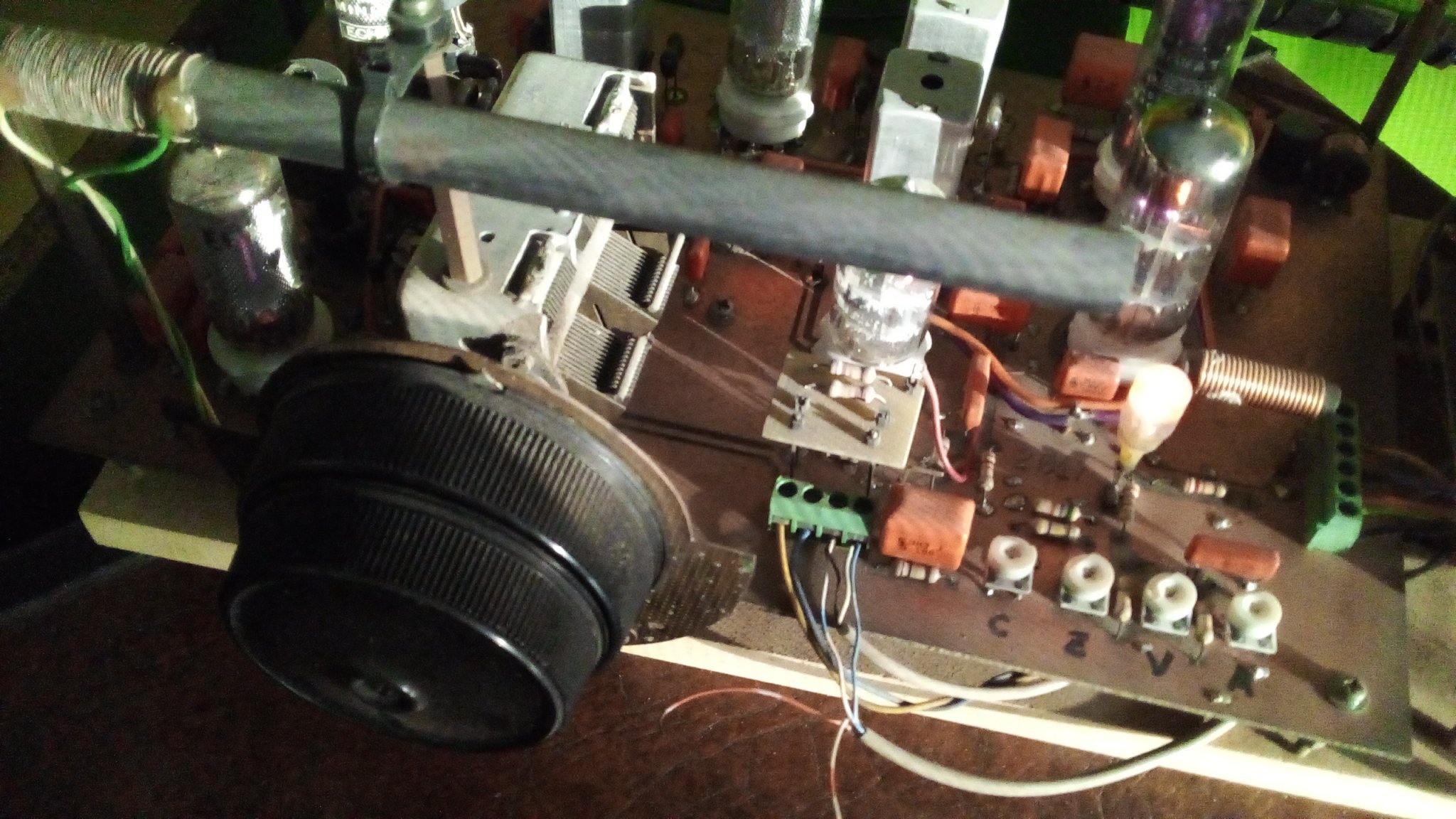

A new ferrite bar, the original was 8mm diameter, this new is 12mm, and the same length, 208mm. The improvement is notable, when in the AGC there was -8V with the original, now there are -9V. Less turns drops the resistance of the wire, improving the Q, and the large the cross section, more force lines are captured by the rod, so, more signal induced.
attachment.php

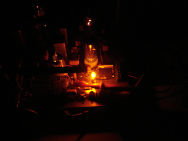

Finally, the tuner in the darkness, showing the neon voltage stabilizer (Reference) and the ECL82's heater.
attachment.php

Looks absolutely great Osvaldo! Interesting that a loop stick antenna change would provide as much improvement as it does. Can you loosely couple a long wire antenna to the loop stick or is there too much electrical interference for this to work well at your location?
I guess the AGC levels are pretty high which means there is plenty of signal present for a good SNR.
Yes, it is possible, but as the tuner has tuned RF stage, it is plenty of gain (The RF stage gains theoretically about 20 times although not measured yet) and surely it will became overloaded easily. Plus it, the tuner is not conceived for DXing, but for pleasant listening. From this, the carefully design of the entire set, mainly the audio detection.
Surely. Also note that the AGC line breaks at some low signal level, giving the maximum amplification from the RF stage, idea borrowed from older tube TV sets.

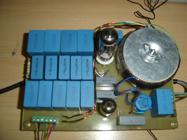

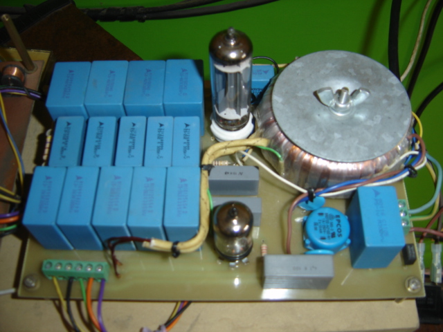

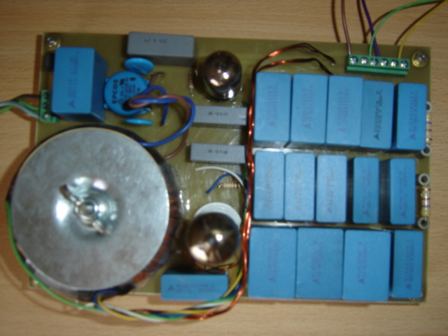

Some weeks ago, the power toroidal transformer became short circuited in the high voltage secondary. I wound it using bifilar 0.18mm enameled copper wire, but it appears that:
1.- The isolation between wires is not sufficient to sustain an entire secondary voltage or;
2.- The loops that was formed when passing the H shaped tool containing the wire through the hole of the core, in the wire, caused a breakage of the insulation enamel in the wire, and although it supported some time (2 years), it definitively fault.
The short circuit was not a real one, it has all the half winding resistance, so although the transformer ran very hot, it still had some output voltages. Then, the primary was OK. The, I unwound the low voltage (Heaters) windings, the bias winding, and the plastic insulation. Once the faulted secondary was at hand, I cut it using an cutting pliers and saved it to recycle the copper.
The new secondary was made using the same wire (0.18mm) but this time in single. The job, obviously was doubled, demanding about four day, not exclusively dedicated to it ( I also slept, ate, etc.). Both sides of the rectifier's plate was equalized in voltage (the trafo has about 10T per volt, so it is easy to tune it to 0VAC between them, wiring temporarily in anti-series or series opposed, not in the normal additive series). The ohmic resistance difference was in the ohm range, which from this point of view is negligible.
Once the HV secondary was tested about 10 minutes, then the low voltage secondaries were wound again, using the same wire. Some time before, the trafo was ready, and placed again in the PSU board. The tuner is now playing again powerful. Here two pics of the old and the new traffo, with the output leads re-positioned in a more properly way.

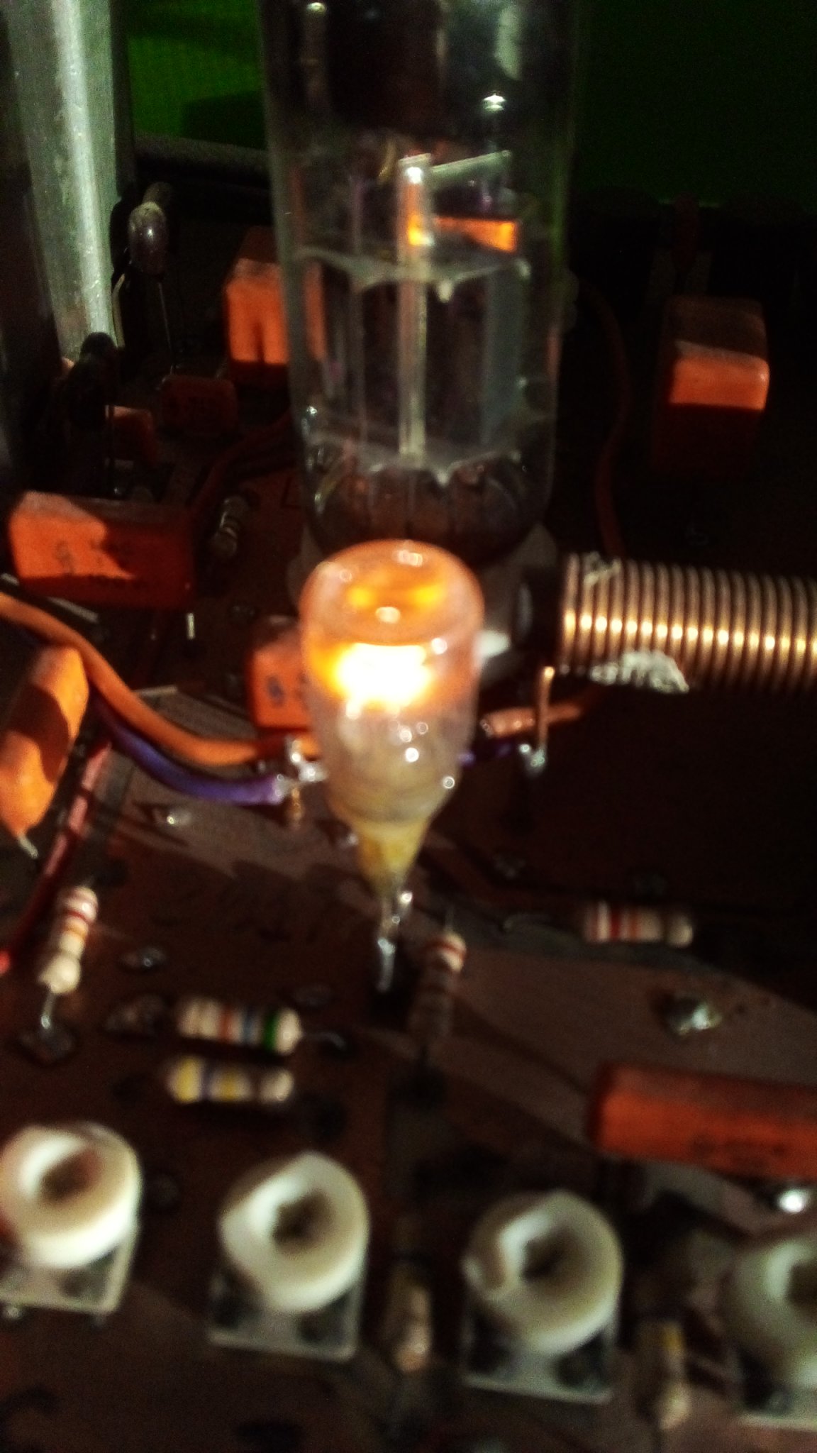

This thread has been started about five years ago. I continue listening to the tuner dayly. Some minor changes I did to it. One is to replace the tunning knob to one used in old transmitters with a self made speed reduction. It has a double effect, the inner one is a direct shaft driver while the outer one has a 10:1 angular movement reduction improving fine tunning. The audio output capacitor has been changed from 1ųF to 3.3ųF @ 100V.
Finally the neon regulator failed to start firing and then I replace with a new unit of larger size. I used a panel 220V neon with socket and resistor removed. Its firing voltage is a bit lower than the original, so the feedback resistor from the regulator has also been updated.
