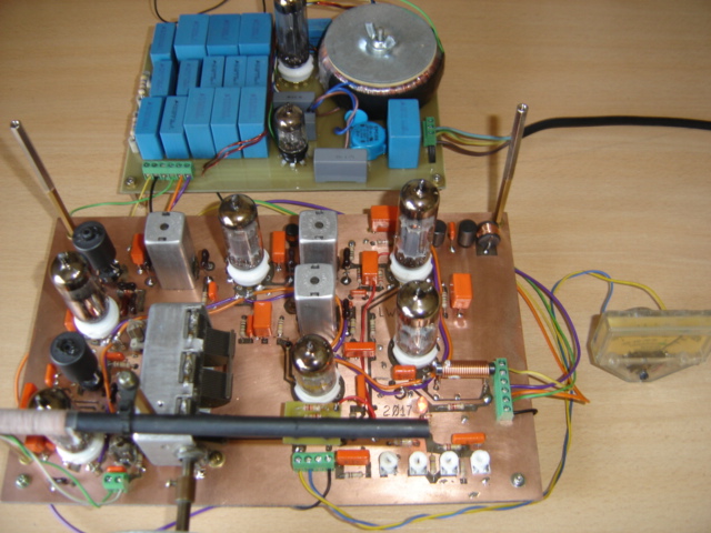

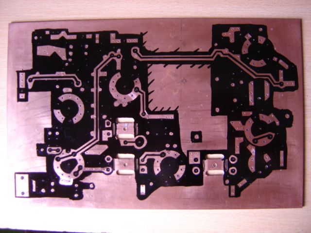

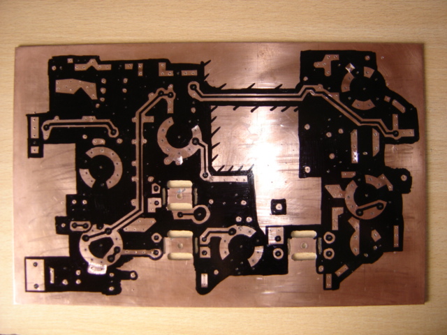

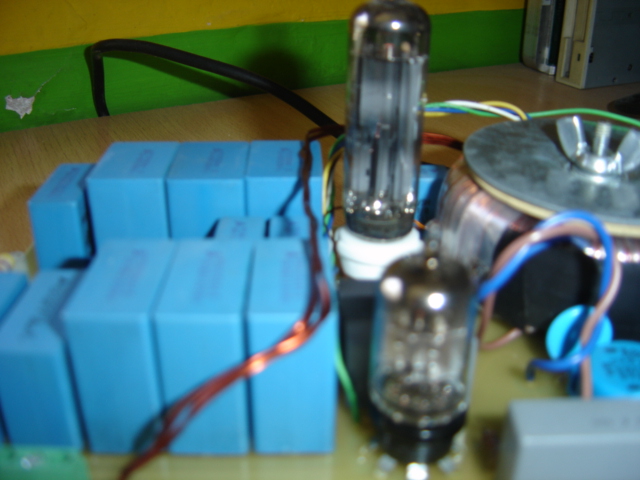

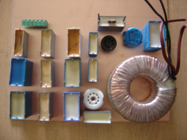

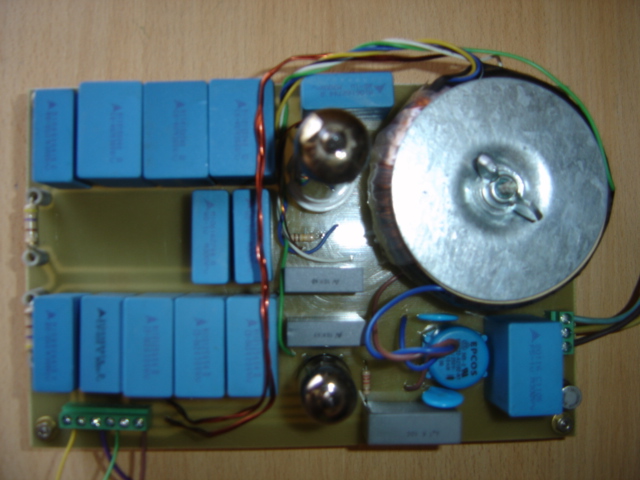

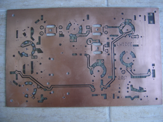

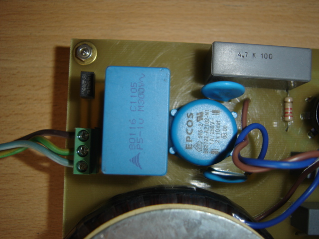

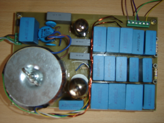

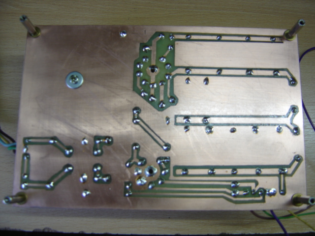

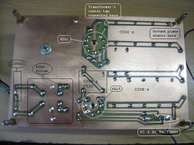

The PSU has been finished!
Here is the PCB of the PSU, now, finished.

Looking good! You are much more intrepid than I am, I would have built that P2P on a little metal chassis. I can't remember the last time I hand laid out a PCB and etched it myself, it must be getting close to 30yrs ago.
Demonstrates that you are very resourceful and it's interesting to watch you make progress.
Hi Kevin‼ Many thanks for your comments, always very positive.
I have an old HP laser printer 4L and the stuff to make professional PCBs (Autotrax 1.61). What happens to me is that It takes much more time than a hand made PCB like this, and also I doubt about the process of to transfer from the sheet to the material. I had brought negative UV films, and sensitive PCBs, but I doubt about the finished results.
I had a 4L that died just a couple of years ago after 17yrs of faithful service.. The replacement, an Epson Workforce Inkjet, higher resolution, is much faster, has a duplexer, prints in photographic quality color, prints on any standard size of paper to 13 x 19 inches, and actually cost less than the Laserjet 4L. It also scans, faxes, and copies. (works with my phone, tablet, linux and windows boxes and windows laptops over wifi or ethernet)

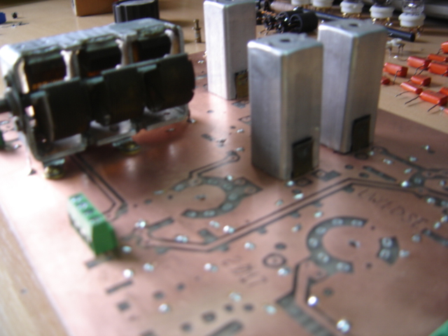

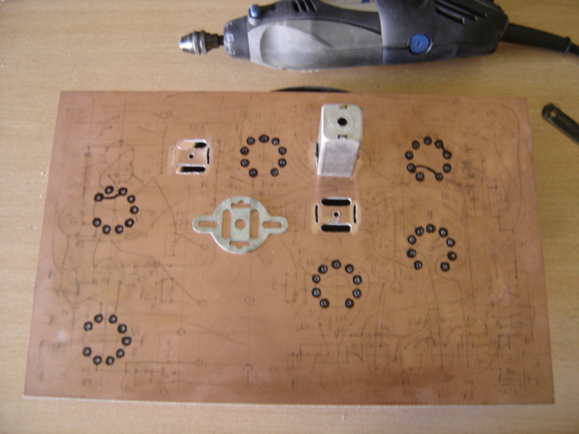

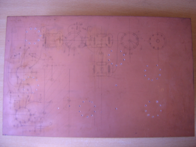

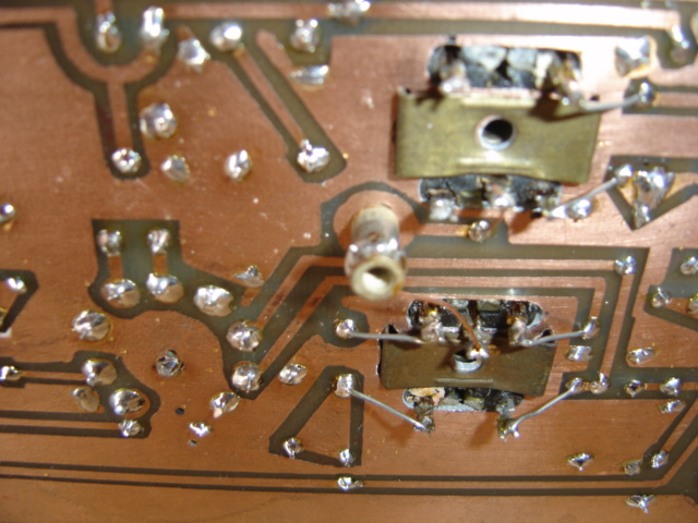

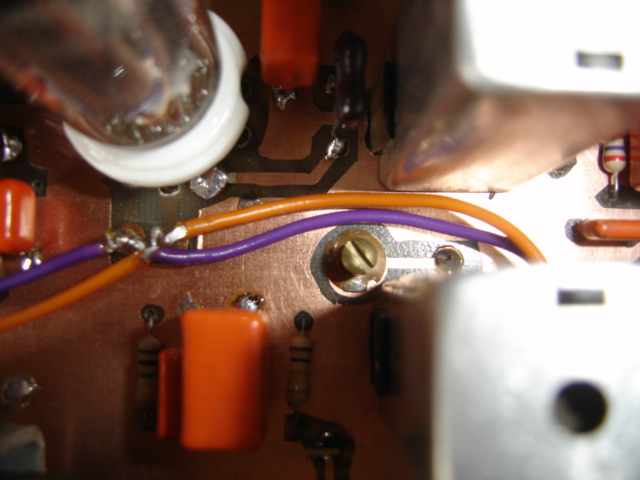

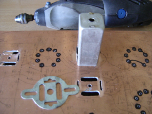

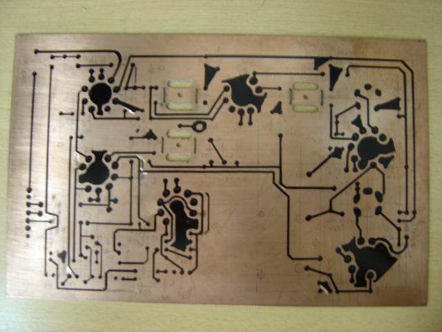

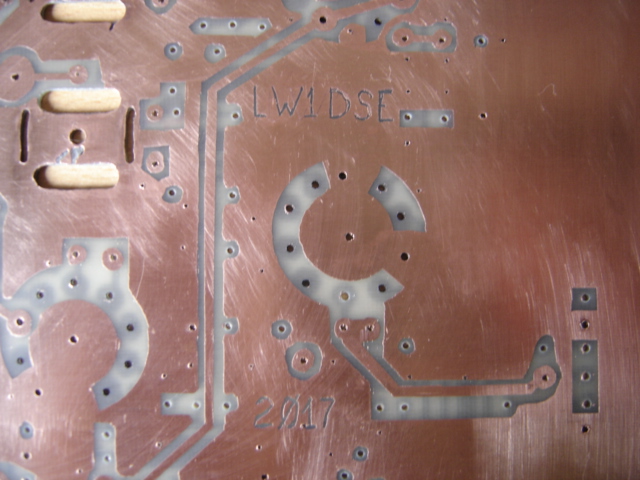

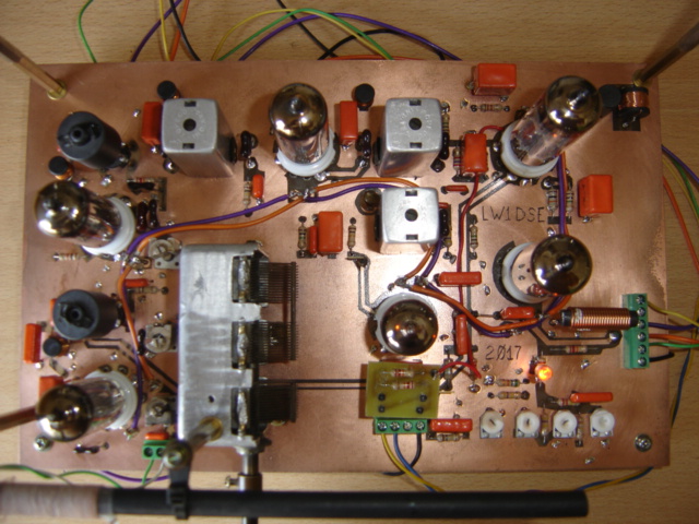

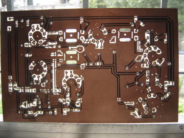

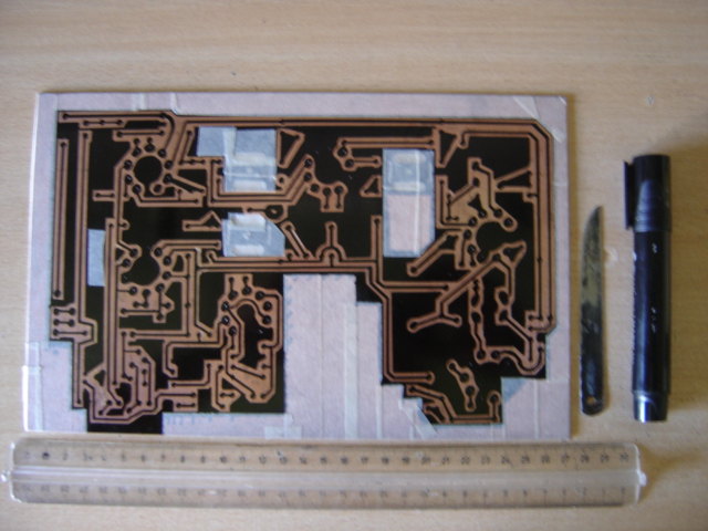

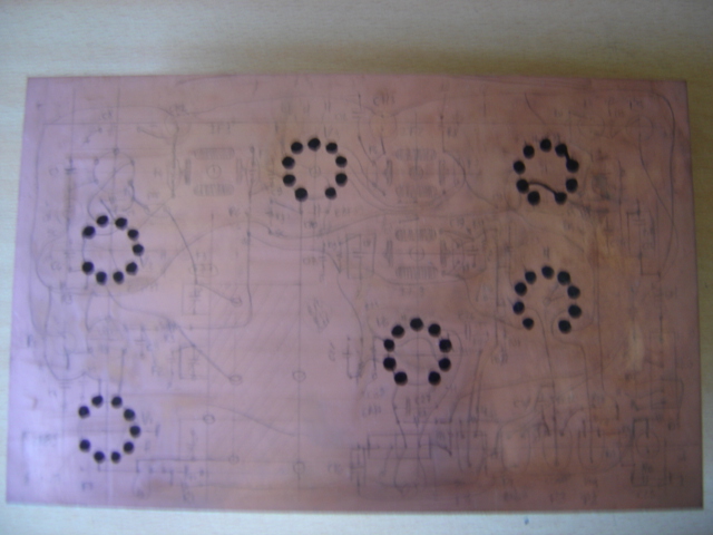

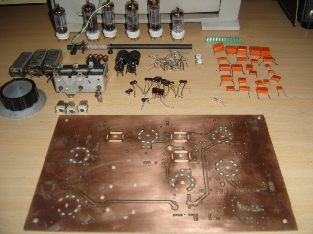

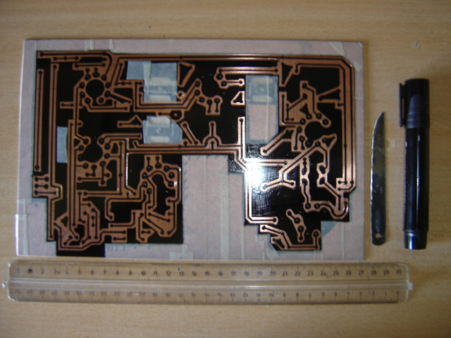

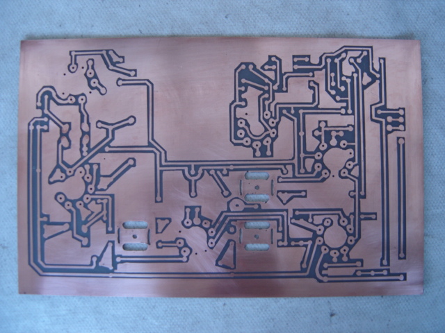

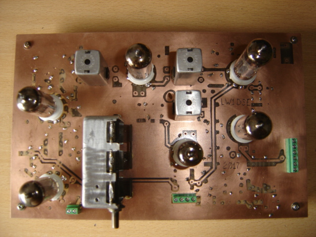

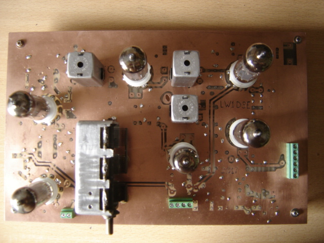

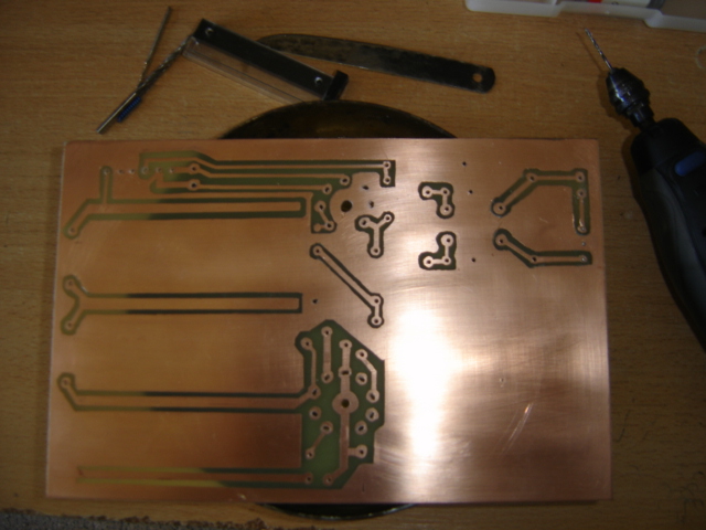

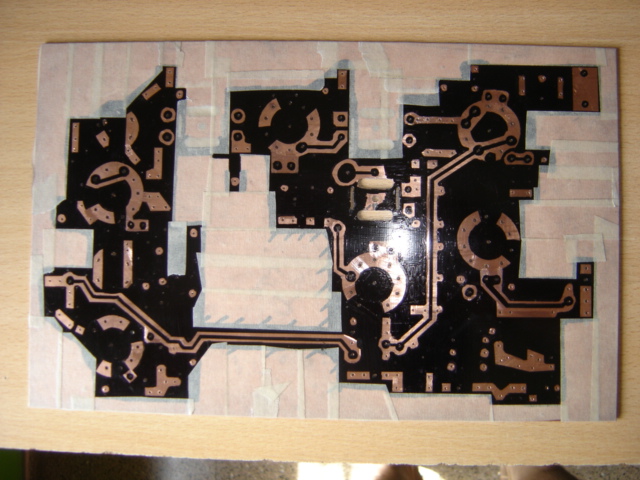

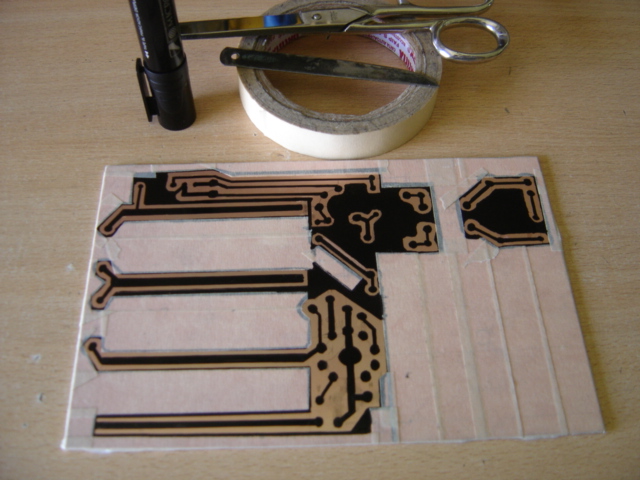

The past two weeks, I was in vacations time, and in between other things I did, I finished the project. Here I will post some photos of the hand-made double sided PCB for the tuner.

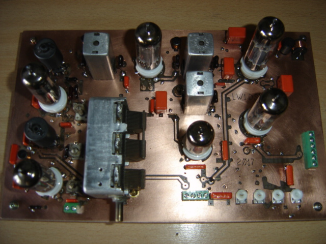

Once the PCB is finished, then it will receive the components.

High Audio Quality AM Tuner

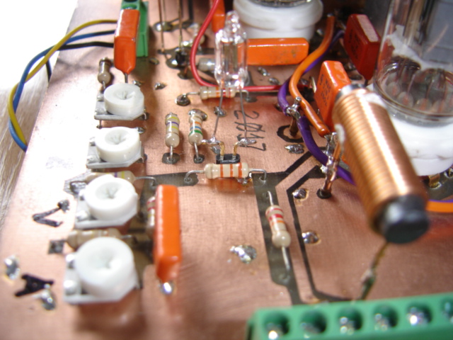

Finally, the tuner is singing successfully, and the tittle of the thread can be modified, getting rid of the parenthesis and now I can say "High Audio Quality AM Tuner".
