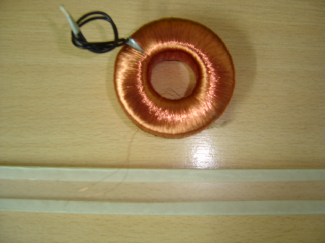

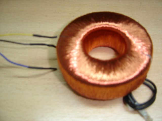

Here are there some photos of the finished high voltage secondary, now ready to receive the lower voltage heater’s windings.
attachment.php
attachment.php
attachment.php
attachment.php

Measurements made over my rewinding secondary transformer:
High voltage (Plate to plate)...............................: 512 V (5)
Resistance of the high voltage sec. winding...........: 458 Ω
Resistance of the primary winding........................: 46 Ω*
Inductance of the high voltage winding (P to P).....: 37 H
Inductance of the primary..................................: 6.5 H
Primary leakage inductance.................................: 6 mH (6)
Secondary leakage inductance.............................: 35 mH (7)
Capacitance between coils .................................: 670 pF (8)
(Note final resistance somewhat below the 240Ω * 2 = 480Ω above estimated)
(5) Under no load condition.
(6) Both secondaries (3 wires) shorted together.
(7) Both primary ends (2 leads) shorted together.
(8) Both ends of the coils (pri. and sec.) shorted together respectively.
This data will be updated when I finished the two reminder secondaries.

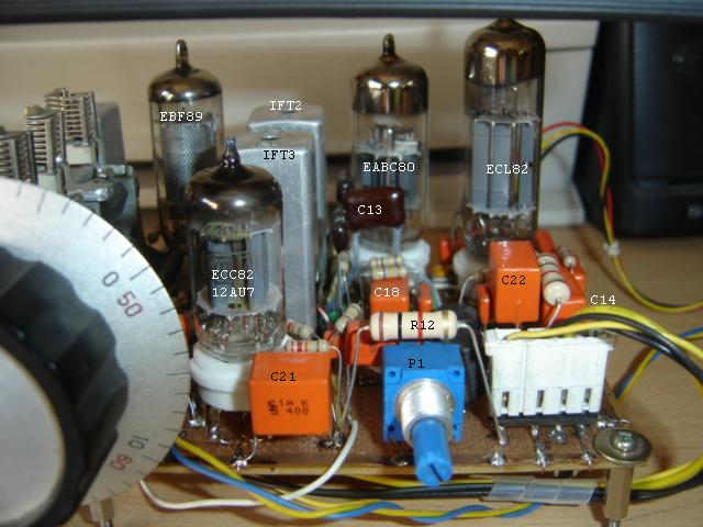

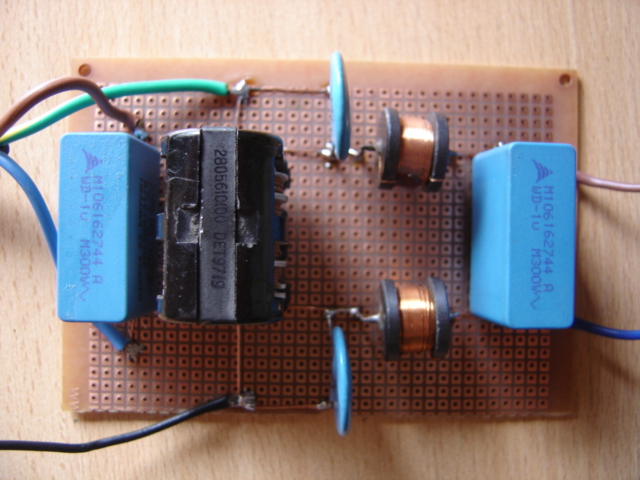

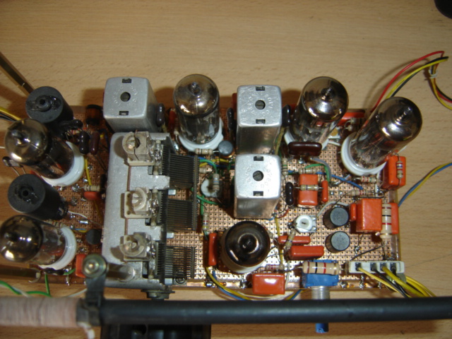

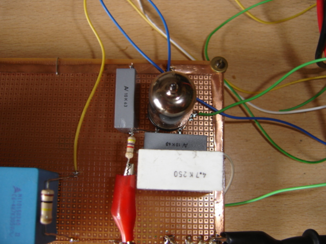

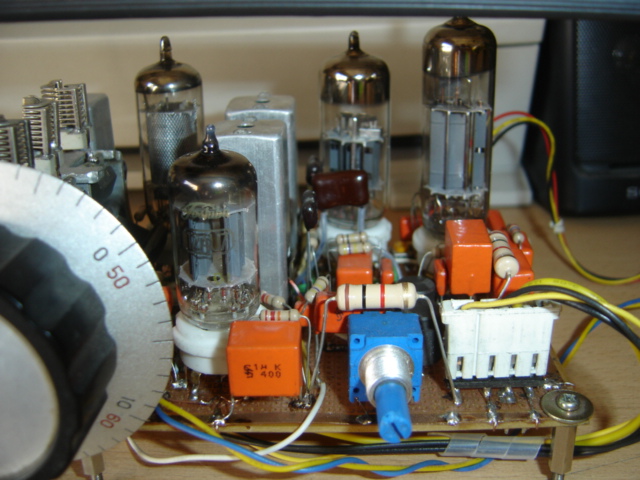

Some smaller upgrades
I had done certain upgrades to the project. As I want to run it at +180VDC, and the bench supply has +275V (Slightly overvoltageing the RF pentodes suggested to work with up to 250V), and I must to rewind the transformer because once finished it drops to floor making it unusable, I must to re-design the series regulator to work with only 75V plate to cathode. Then between the tube candidates I found an ECL82, whose pentode section wired as triode is the new series pass element and the triode is the new cathode follower for the audio filter. But as the regulator only needed to readjust the bias preset, the follower must be entirely re-designed (transcoductance of ECL82's triode is more than twice the ECC82 one, and then the output impedance offered to the filter was incorrect presenting a +4dB overvoltage at the higher end of the audio bandpass) to meet both input and output impedances matching and to get the filter properly terminated. Here are two photos of the new prototype, and soon the new schematic will be posted.
Also some smaller caps was used to decouple the circuits between them.

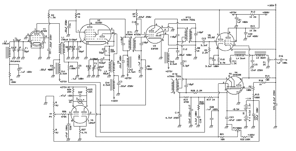

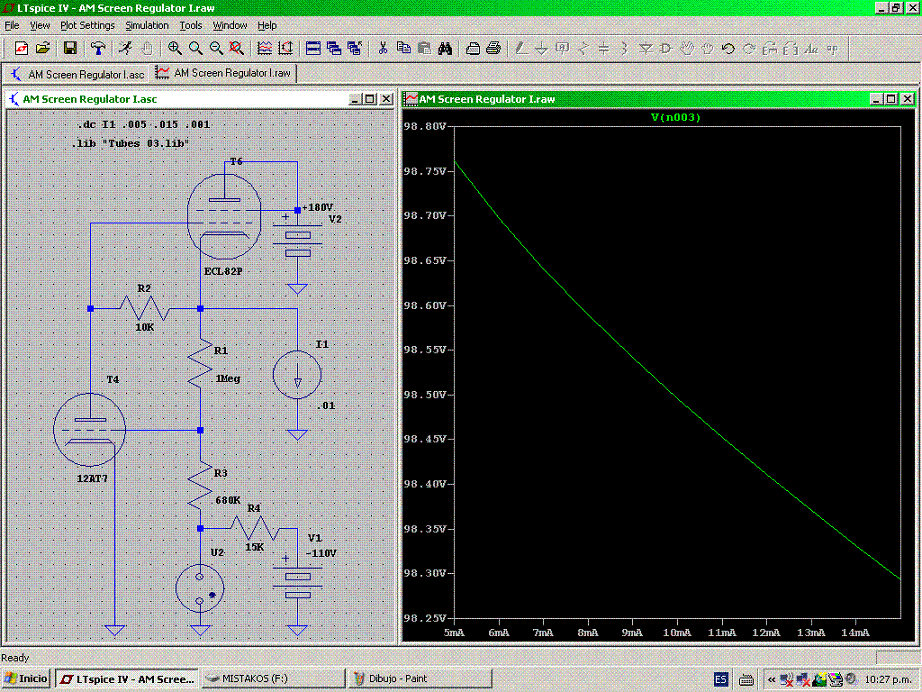

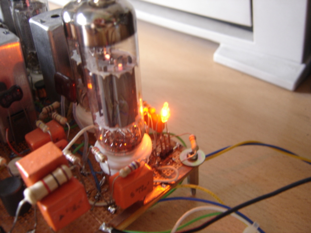

Screen regulator upgrade
This is the new screen regulator for the AM Tuner Project, still under development.
As the double triode ECC82 has been replaced (modifying the circuit) by a triode pentode ECL82, and in order to use the European set of tubes, the circuit has been redesigned, although its spirit is the same.
Now, the pentode section has been strapped as a triode, and a great improvement has been obtained. Compare the simulation below with these in previous sketch. This is because two main reasons. One is the bigger tranconductance of the cathode follower stage, more than twice the ECC82’s triode, whic in tur conducts to a lower output impedance at the cathode’s end. The other, is the bigger return factor from the voltage divider, as now the NiCd batteries has been removed and replaced by a negative voltage obtained from the main transformer, rectified with a 6AL5 and then stabilized thanks a neon pilot lamp, letting me to have about -65V as the voltage reference. The reminder circuit is the same and continue behaviouring as a upgraded version of the See-Saw classic circuit.
The voltage wanted is about +105V, but in the simulation, the adjusting pot has been omitted giving an error in the output voltage, but the impedance from the circuit is clearly improved.

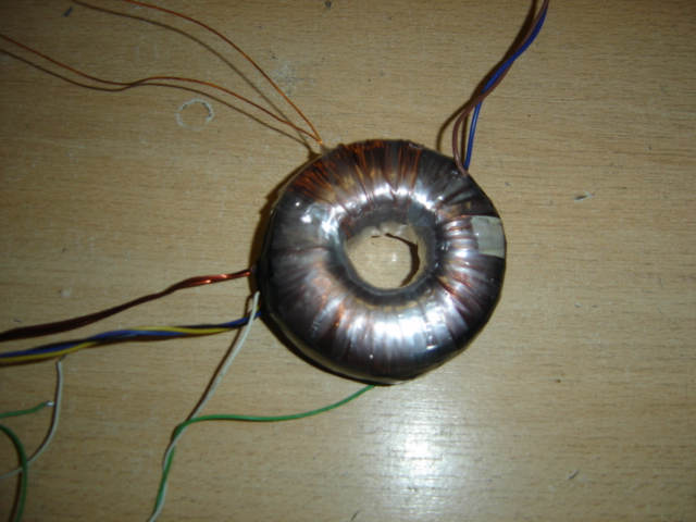

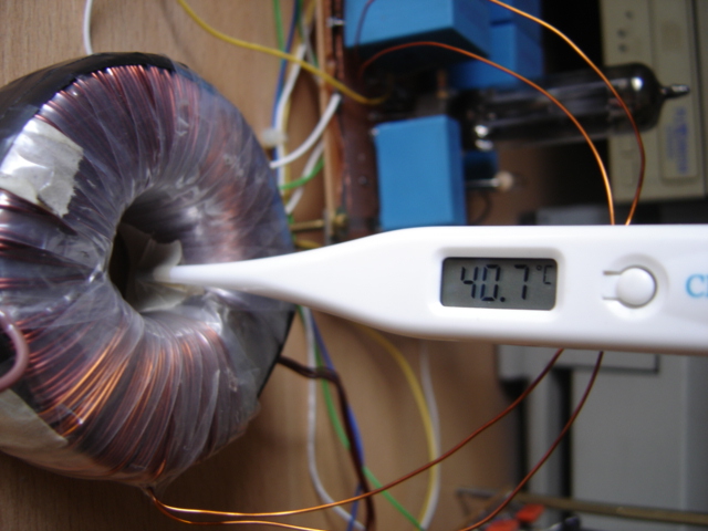

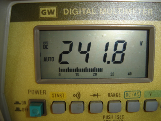

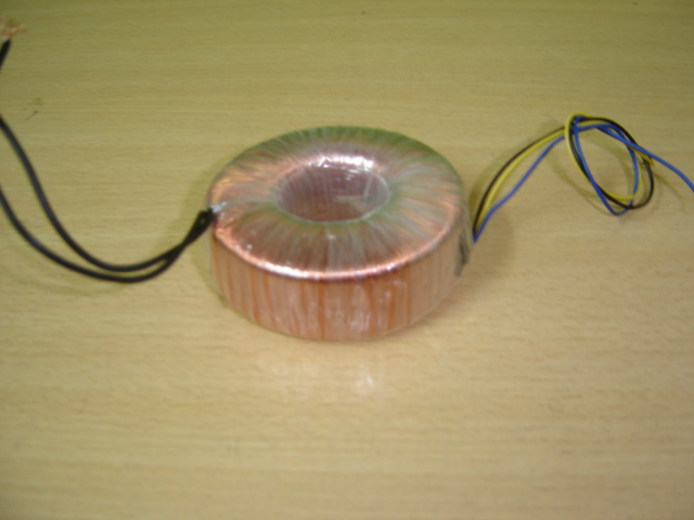

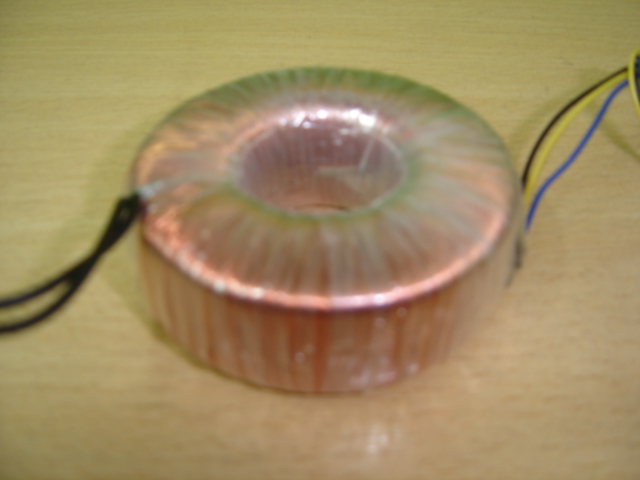

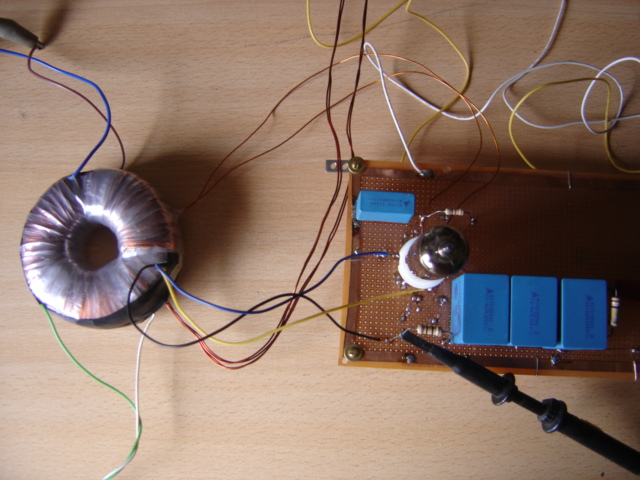

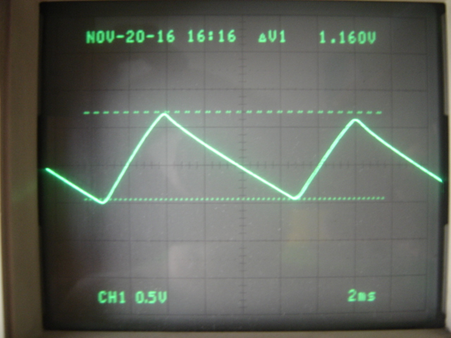

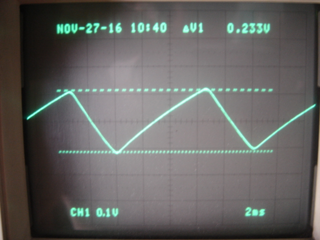

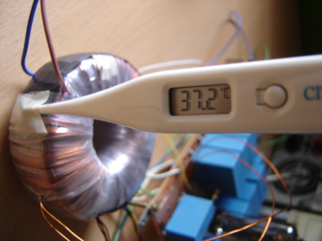

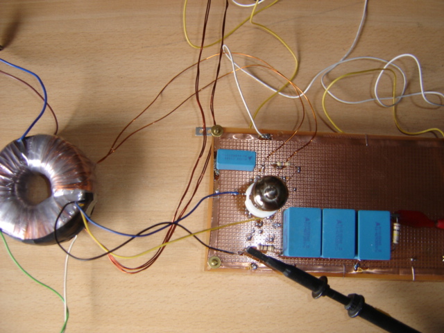

Transformer is finished‼
Last weekend I finished the transformer. It has several hours of patience, but it is now finished, and working. Although, it has been redesigned and moves to capacitor input at the filter, not inductor how I wanted from the start of the project. Whence it can be deduced that the working time is less as the output voltage at the high voltage secondary is lower. But as I must to do it twice, then, I must to stop it here. Now, some pics of the finished transformer and the (very ugly‼) prototype of the power supply, still under construction. Also, the tuner itself has been reworked, getting id from the NiCd battery to here used to bias part of the circuit.

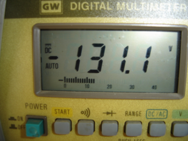

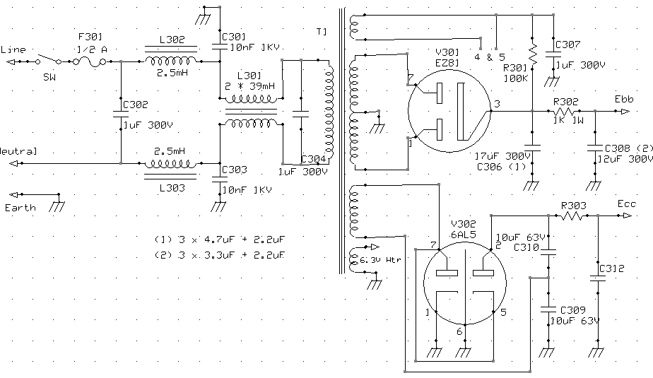

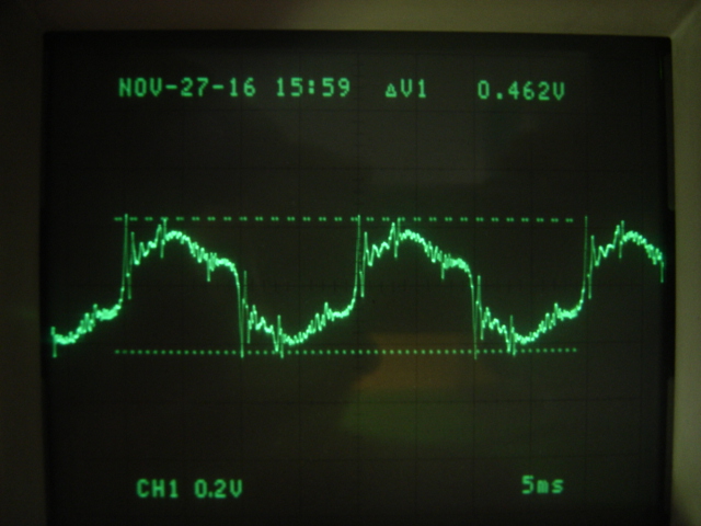

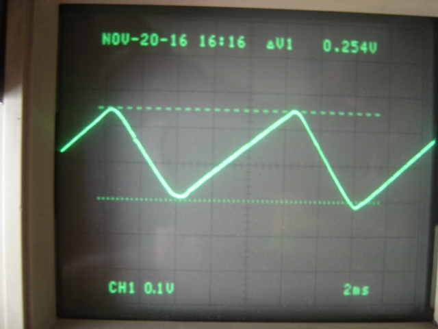

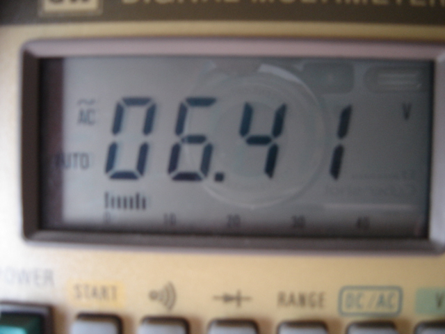

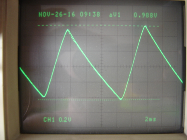

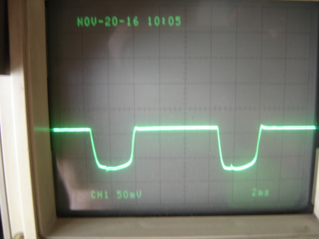

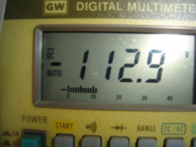

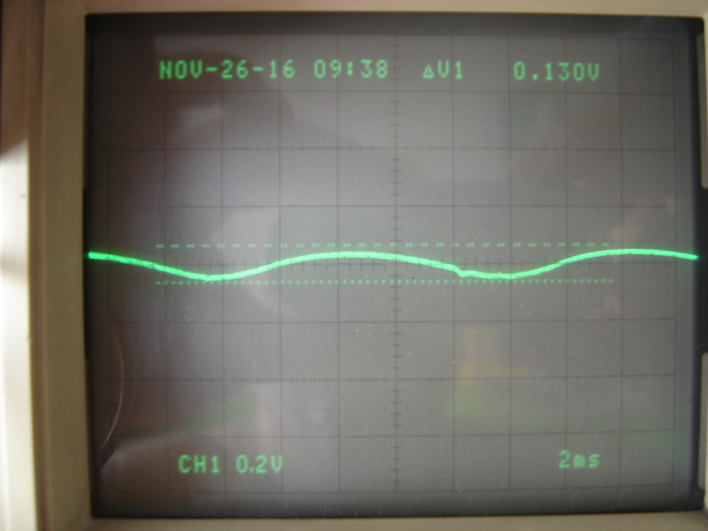

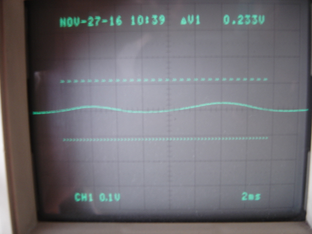

Some measurements made in the supply. the current ripple has been measures inserting a 10Ω 1W resistor in the center tap of the transformer. The second oscillogram is the ripple at the -110V line (voltage doubler) and the third is the same at the main output capacitor, the 3 * 4.7µF blue units. They had rescued from scrapped devices. Next to them, the output voltages.
Soon the schematic and the new calculus.
As I said above, the transformer has been modified in order to reduce the number of turns, as I had to do it twice because the first time, once finished the high voltage secondary, it drops to the floor and became useless. So, for those who want to follow my procedure, here are some data I collected and measured in my transformer. In the first part, I present the data collected from the original transformer, then the new calculus and in the third part, data measured in the transformer, and finally the transformer under normal use in the tuner.

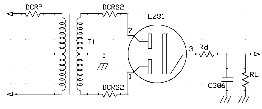

Re-computing of the transformer’s windings:
As the space in the core is limited and the thinner wires can’t support safely high voltages in a bifilar winding, I’ll redo the calculus in order to make the
Filter input with capacitor, as opposite than the original idea of to use choke input, and then, save space in the core. The voltage at the ouput of the filter will be roughly:
E(DC) = √2 E(RMS)
Whence, inverting the equation, and to get about 240VDC at the output, I need that:
E(RMS) = E(DC) / √2
The rectifier’s drop can be estimated from the graphs in the data sheet from the FAPESA’S book (The old Argentina factory of Philips) in page 205 for the EZ81 double diode, where I saw that it is about 6V for near of 30mA. I also know the DC loss in the inductor 20V, then I need:
E(RMS) = (E(DC) / √2) + E(L) + E(EZ81) = (240V / √2) + 21V + 6V = 197V
Then, the output voltage is chosen in about 200V.

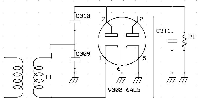

To get the negative voltages necessary to biasing some stages of the tuner, I’ll use a secondary whose output will be doubled using both sections of a 6AL5 of about:
E(RMS) = (E(DC) / 2√2) + 2 * E(6AL5) = (100V / 2√2) + 2 * (2V) = 39.4V
Once again, I choose a 45V at the transformer’s secondary. Which will be about -110VDC at the doubler’s output. Again, the voltage drop at the estimated current has been read from the data sheet.

Voltage doubler design:
attachment.php
As I can read in chapter 30 page 1174 and associated graphs from Radiotron book by Langford Smith, where the author wrote about rectifiers and voltage multipliers, the value of the capacitors conforming the full wave doubler, it must satisfy the requirement of woRlC > 300 to get a final value near 2√2E(RMS).
The load of the supply from the tuner is low and can be estimated:
Ecc 100V
Rl = ----- = ------ = 33KΩ
Ic 3mA
Solving the above equation for the capacitance, I get:
300 300
C309 & C310 > --------- = -------------------- = 14.5µF
wo * Rl 2pi * 100Hz * 33KΩ
I can try two units rescued from wasted apparatus, whose values are 10µF @ 63V, y and eventually add a second mesh with C311.
Output filter capacitor C306:
attachment.php
Proceeding in a way similar to the above, I can design the main rectifier circuit. From the family of curves in page 1173 of the previously cited book, the value of the output capacitor must satisfy that woRlC > 100 to get an output voltage near to √2E(RMS) en la salida.
The load resistance is:
Ebb 240V
Rl = ----- = ------ = 12KΩ
Ib 20mA
Whence:
100 100
C306 > --------- = ------------------- = 13.3µF
wo * Rl 2pi * 100Hz * 12KΩ
Then I'll use 3 capacitors labeled 4.7µF @ 300VDC, and I'll add to them an extra cap of 2.2µF @ 300VDC.
Now, rearranging the equation, I have:
woRlC = 2pi * 100Hz * 12KΩ * (3 * 4.7µF + 2.2µF) = 122
From the data sheet (FAPESA tube manual) for EZ81 in page 205, I get an approximation for the diode's resistance, Rd:
-- Ed 5V
Rd ÷ ---- = ------ = 200Ω
Id 25mA
Transformer's secondary resistance was estimated above and was about 280Ω, and primary's was 50Ω, and if I transfer it to the secondary, I have:
N2 2000T
DCRPs = DCRP * ---- = 50Ω * -------- = 48Ω
N1 2070
The total resistance seen from each anode is:
Rs = DCRPs + DCRS2 = 280Ω + 48Ω = 328Ω
With this data, I refer to Radiotron, page 1175, I calculate some parameter of the rectifier, using his own nomenclature:
rd = 0.88 Rd = 0.88 * 200Ω = 176Ω
Rs = Rs + rd = 328Ω + 176Ω = 504Ω
With all this information I can compute the ripple at the output. To do it, and from page 1177 I get:
|rd| = rd / 0.93 = 176Ω / .93 = 190Ω
|Rs| = Rs + |rd| = 328Ω + 190Ω = 518Ω
|Rs| 518Ω
------ % = ------ = 4.3%
RL 12KΩ
From the graph 30.9 in page 1176 I get the value of the ripple percentage respect to the DC is 0.7% approximately.
Then:
|Er| = 0.7% * 240V = 1.7V
To get the peak to peak value, I make the conversion approximating the waveform to a saw tooth, and I have:
Erpp = |Er| * √12= 1.7V * √12 = 5.9Vpp
In the prototype, and in a photo below, I got about 12Vpp of ripple, which is a bit high. Then I plan to add a second mesh, using post RC filtering.

Some tests to the finished transformer:
Primary Inductance.........................: 4.7 H
Primary Leackage Inductance............: 6.2 mH (*)
Primary Resistance..........................: 46 Ω
Secondary Inductance S2 (total).......: 15.6 H
Leackage Inductance S2..................: 13.2 mH (*)
Secondary Resistance S2 (total)........: 230 Ω
Secondary voltage S2......................: 200 V
Secondary Inductance S3.................: No measurable
Secondary Resistance S3 (apx.).........: 0.55 Ω
Secondary voltage S3......................: 7 V
Secondary Inductance S4.................: 0.27 H
Secondary Leackage Inductance S4....: 10.4 mH (*)
Secondary Resistance S4 (apx.).........: 80 Ω
Secondary voltage S3.......................: 47 V
Secondary Voltage S1......................: 6.8 V
Secondary Inductance S1.................: No measurable
Secondary Resistance S1 (apx.).........: 1 Ω
Capacitance from primary to S2.........: 0.67 nF
Capacitance from S2 to S3...............: 0.52 nF
Capacitance from primary a S3..........: 0.3 nF
Capacitance from primary a S4..........: 0.12 nF
Capacitance from S2 to S4...............: 0.14 nF
Capacitance from S2 a S3................: 0.18 nF
Capacitance from S1 a S3................: 0.12 nF
(*) Winding shorted at its ends.

Hi Osvaldo,
Lots of progress over the past few weeks. I particularly like the line filter implementation, it should really help to keep line born RF noise out of the tuner.
6AL5 were somewhat common as bias rectifiers, wondering if in FW doubler configuration their peak current capability is sufficient - is the winding resistance sufficient to limit the current to a safe value particularly during the first few cycles of charging current?
Hi Osvaldo,
Many many thanks for your interest.
6AL5 has a DC current capability of 9mA per section. Current drained will be under 3mA. As it has a common heater string with the rest of the set, it will be slowly charging during warm up at current limited because of low temperature of its cathodes. Secondary voltage is only 47V, so I don't believe it will fail.
In my Regenerative Receiver, some years ago published here, I also use a line filter. Mercury and sodium vapor lamps in the street illumination cause lots of noise conducted by the wiring itself. And in a toroidal transformer, it is very difficult to add a screen between primary and secondaries, as it is in EI counterparts, without causing a shorted turn failure.
Continue sending your comments, they are welcomed; and continue improving your health.
First firing and live hours of my trafo.
Here some pics from my power supply for the tuner. Observe main parameters, and check also how they agree with the calculae below.
First, the operation temperature after 3 hours of playing, no air flow nor wind:
attachment.php
attachment.php
Then, main heater voltage under full load:
attachment.php
Perfect!
Now, the mains ripple after and before the CRC filter:
attachment.php
attachment.php
Please note that this oscilloscope's original proves had an automatic x10 pin reader, as the probes had been replaced, the reading are no longer multiplied, the make your own x10 multiplication on voltage readings.

Line filter
Here are the mains line filter, as a prototype only. Very ugly, no?
attachment.php
Now, line current viewed inserting an 1Ω 1W resistor in series with the neutral, and using the scope as differential input to eliminate common mode signals at both ends. After and before filtering.
attachment.php
attachment.php
