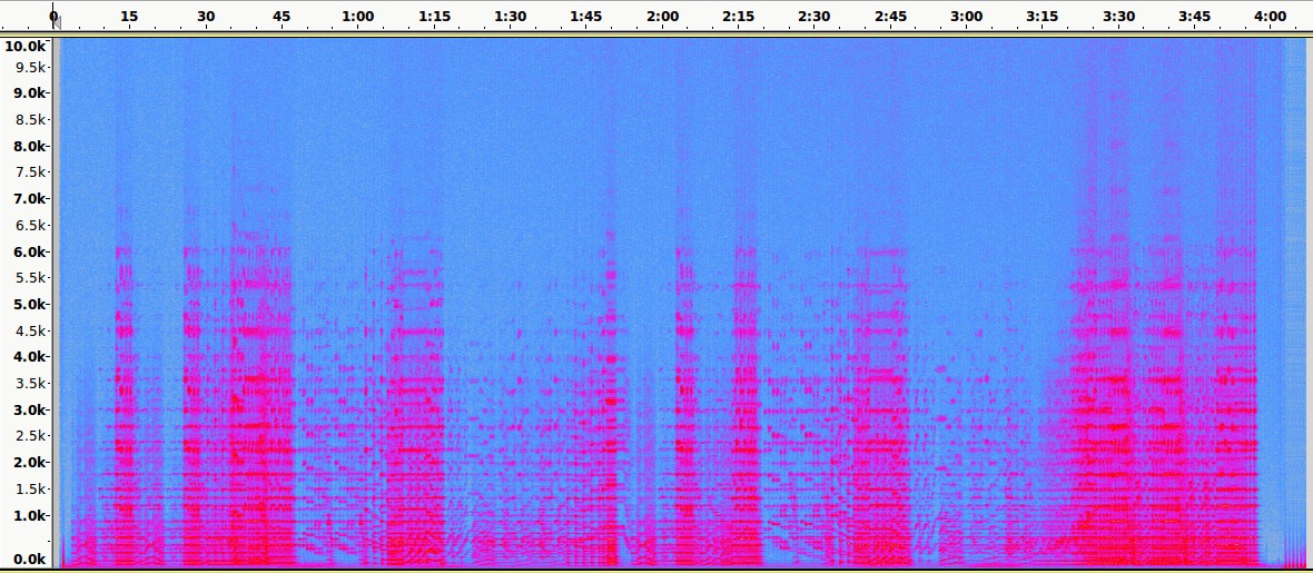

I can't tell you exactly, because I lack of instrumental needed to make some affirmation. But aurally, it sounds much better that my older with IC's. The high frequencies of the S's, for example, are clearly defined, and almost as good as an FM transmission, particularly when speaking is a woman.
The T filter in the detector, is a key in this point, as defines much more accurately than the IF channel, because it doesn't move (bandwidth) with AGC changes.

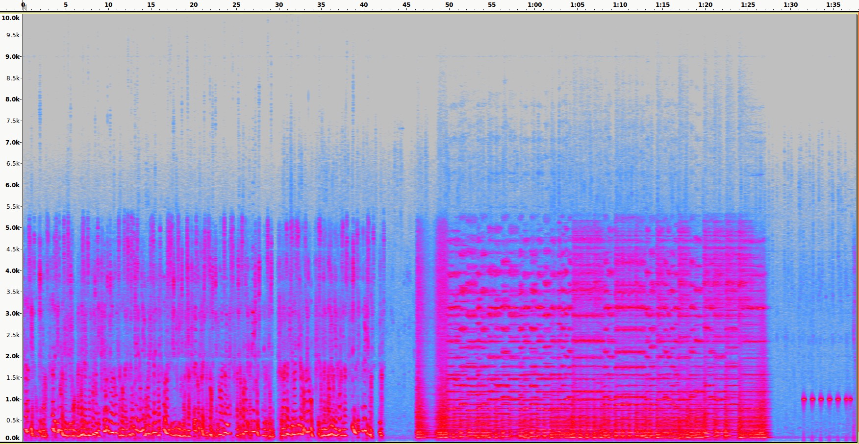

You could record the line output of your tuner with an audio interface and have a look at the spectrogram in Audacity.
As an example, the image attached shows a spectrogram of an 84 year old 78rpm record, with a recorded bandwidth of 6kHz.

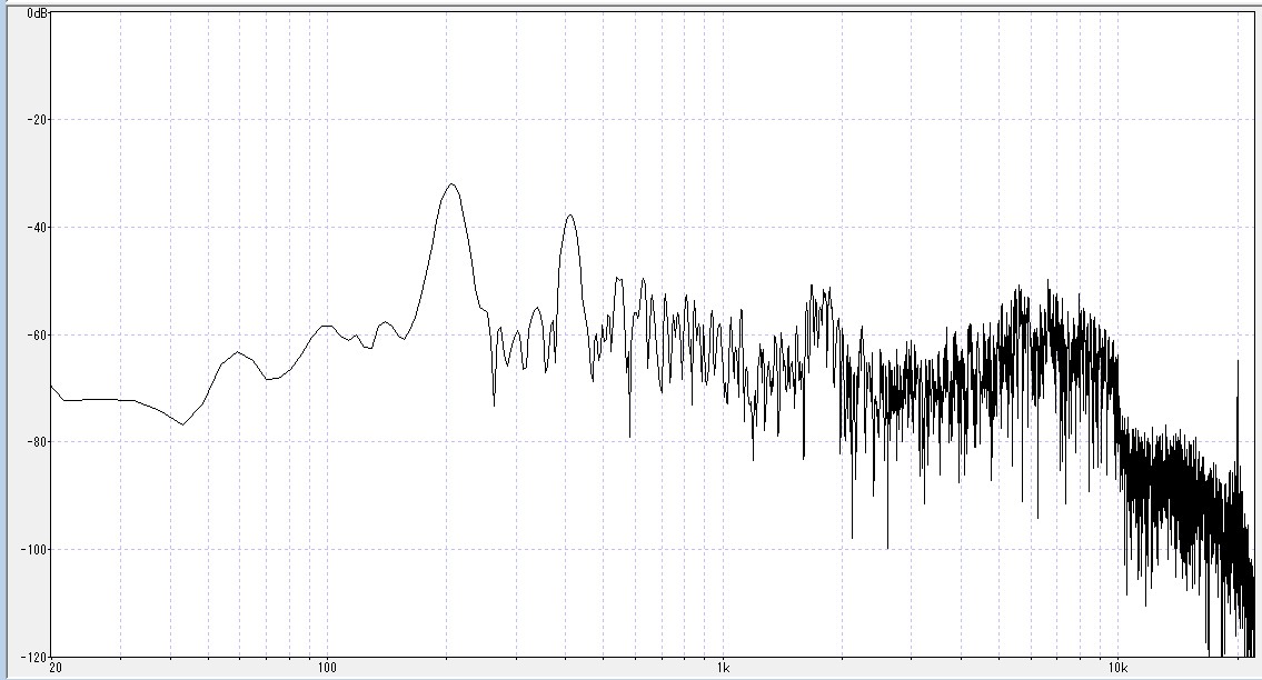

AM BW appears to be 10KHz here.
Some time ago, radio stations used the odd tenth's of KHz, say, 710, 750, 790KHz. But from about a decade, also even tent's were raising, 720, 740, 760KHz and so on.

Received spectrum of one of the AM stations I support, taken minutes ago. The tuner is an Inovonics modulation monitor with deemphasis enabled.
