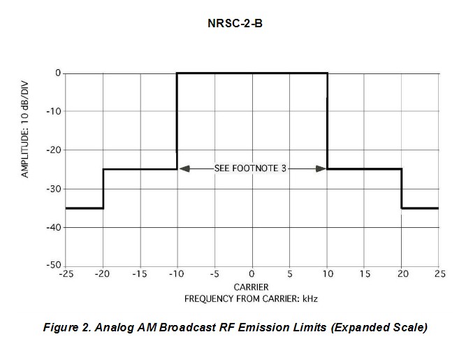

The maximum allowable received audio bandwidth in North America is 10 kHz.

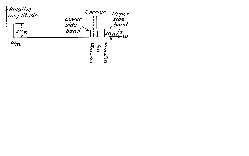

"The bandwidth of AM signals can be easily predicted using the now familiar formula: BW = 2 fm. "
where fm = the maximum modulating frequency

As I remember, the RF bandwidth is twice the frequency modulating the carrier (audio), and at 100% modulation reach one fourth the power at the carrier (half voltage amplitude).

Yes, the bandwidth of an AM signal is exactly twice the audio bandwidth - assuming low distortion in the modulator and any subsequent amplifiers. 100% modulation of a single tone means each sideband has half the amplitude (i.e. one quarter the power) of the carrier.
Yes, the bandwidth of an AM signal is exactly twice the audio bandwidth..
That's correct, and the maximum allowable analogue audio bandwidth in North America is 10 kHz for non-IBOC stations.
Wikipedia says: "Nowadays in most of the Americas, mediumwave broadcast stations are separated by 10 kHz and have two sidebands of up to ±5 kHz in theory, although in practice stations transmit audio of up to 10 kHz."
AM broadcast is a waste of power, many hundred kilowatts emitted just for the sake of the receivers' simplicity. And the usable information is carried in 25% of the total emitted power.
https://www.gpo.gov/fdsys/pkg/CFR-2006-title47-vol4/xml/CFR-2006-title47-vol4-sec73-44.xml
It seems FCC does not limit below 10.2 kHz. It is the interest of stations not to hang into each others' sideband, probably this is why they limit volunteerly at +/-4.5 or +/-5 kHz. Most receivers do it anyway.

AM carries the baseband information in up to 33% of the total power.lcsaszar said:AM broadcast is a waste of power, many hundred kilowatts emitted just for the sake of the receivers' simplicity. And the usable information is carried in 25% of the total emitted power.

That would require 20kHz bandwith, no such thing.
That's the NRSC AM mask son, go outside for a bit.

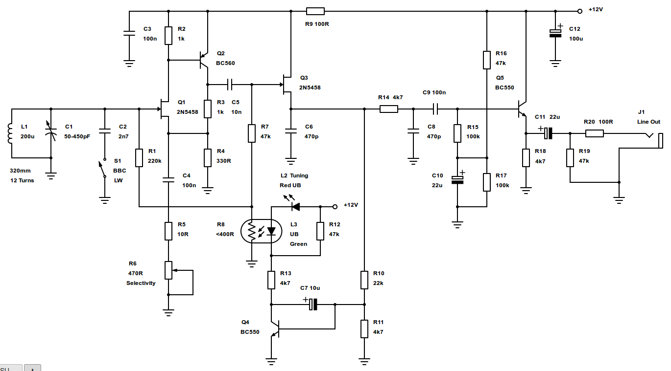

Here's my take. An automatic regenerative receiver using a low distortion impedance detector. The output level remains constant due to the AGC regen adjustment, making the receiver immune to fading. The only inductor is the loop antenna!

See R6! You can manually adjust the selectivity. Can you do that with a typical superhet? 😀
Bandwidth usefully decreases as stations become quieter, reducing noise.
In America are to many stations on the same frequency, propagation in the day time close to zero, even with the max allowed 50kW, that means local stations. At night are hundreds of stations within reach, not many would provide quality reception, that means again local. For that a crystal detector radio is sufficient. Providing wide bandwidth and the highest sound quality. On the other hand, if one is for talk radio listening there is no need for quality, but a directional antenna is a must , so that means a pocket radio with a ferrite antenna.
With a typical superhet you don't need to keep twiddling with the bandwidth. And won't R6 affect the signal level too?monty78pig said:Can you do that with a typical superhet?
A regenerative set with one tuned circuit will have poor skirt selectivity, so only suitable for listening to strong local stations on a relatively uncrowded band. There is a reason why domestic radio sets moved from regeneration to superhet, despite the extra complexity of a superhet.
Well, consider this. When the station gets weaker, regeneration increases, reducing bandwidth. So strong stations can benefit from wide-band reception while weak ones are received with narrow-band to reduce interference and noise.
Look at AGC subsystem based around Q4. You'll see that adjusting R6 only affects the amount of regenerative feedback, while the output level stays constant. Clever, eh 😉 ?
