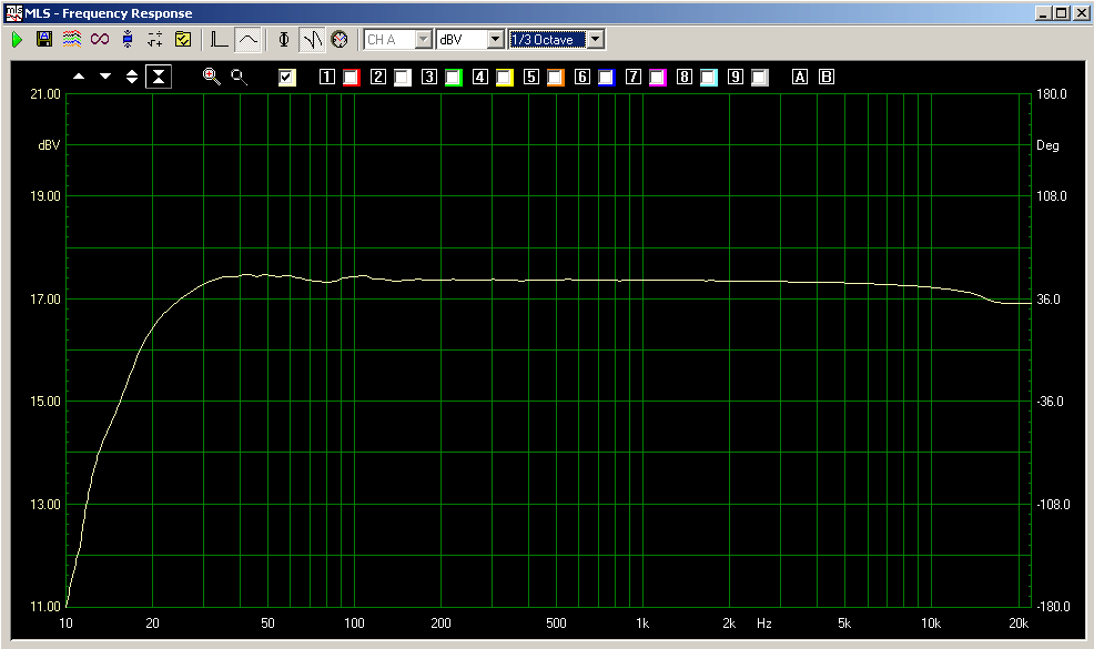

LL1668/25mA 100H arrived and tested!
Here the final frequency response.
only -1db at 20Hz with 10Vrms on 8ohm
This is a very very good result.
Soon the sonic performance test with 2 channels.

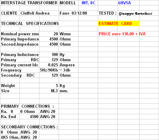

I don't see real solutions to have a Jensen copper film like interstage in this design with 6HV5A.
Probably a solution could be use the Bartolucci interstage transf. INT7 with 100H.
I am waiting on the first days of January both the interstage transformers, Lundahl and Bartolucci.

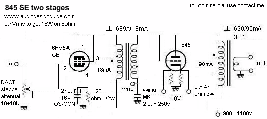

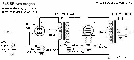

Sorry, These is an error in the schematic, the interstage transformer should be the LL1692A and not the LL1689
LL1692A/18mA have these characteristics in ALT_S connection:
125H at 4:3.5
max out 175Vrms
I will ask to Ludahl about the insulation rating.

Generally, Ra of a pentode run in triode mode is much less than the pentode Ra. Possibly the Ra is ~ 1000 ohms or less so IT's with less than 100 H should work. The pentode Ra of the 6HV5A is 4600.
I'm no engineer so please correct me.
There can be no pentode mode of a 6HV5 since it only has one grid. It is a true physical triode. It has added beam forming plates that prevent the electron stream from irradiating parts of the inner tube structure and anode by statically fixed physical shadowing.
Someone please correct me if I am mistaken.

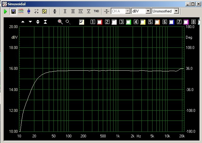

I have found a problem in the first release using LL1668.
If the core/chassie of the LL1668 is connected to the ground of the amplifier there is an isolation problem and frequency response is compromised at 12KHz.
I have spoken with Lundahl about the LL1668 problem.
It is not an isulation problem, the Lundahl product can work until 1500V without problem.
It depend by the parasite capacitor so It can be resolved with a simple separation of the LL1668 and the chassie ground.
Follows the new frequency response of the last LC version using Ll1668 and Mundorf 2.2uF.
I will test soon the interstage transformers Lundahl LL1692A and Bartolucci.
