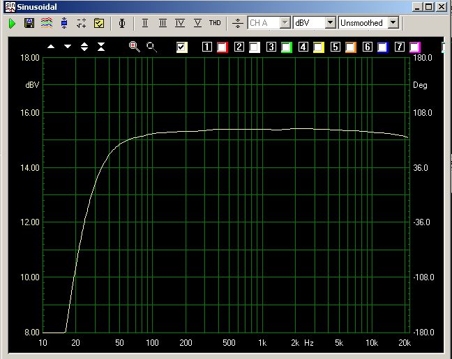

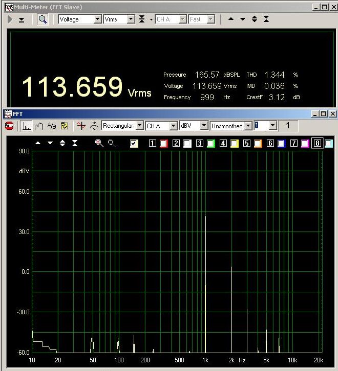

yesterday evening I have started some measurement about 6HV5A used like 845 driver.
The schematic was very simple: inductance on anode, Rk = 100ohm, Ck = 470uF, Rg = 75Kohm and output capacitor 2.2uF on 33 or 100Kohm load.
With medium voltage operation (about 600V) these tubes give low sperformances because distortion is high 1.1% at 25Vrms.
The good result are obtain using 980V and 100ohm on catode to keep the power nead the 30w (35w is the maximun allowed), bias about 30mA.
With these value I have got the good 1% at 120Vrms on 33Kohm load.
The freq. response is limited to 50Hz(-3db) with 20H but it will be 10Hz(-3db) using 100H 50mA Sowter 8982.
The voltage amplification is 120/0.7=155x.

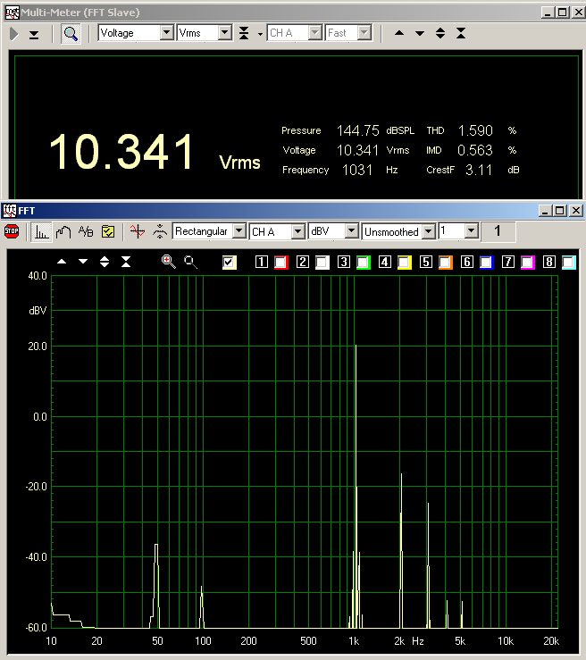

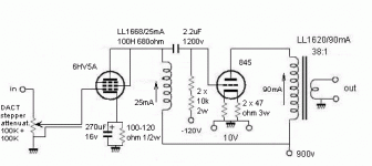

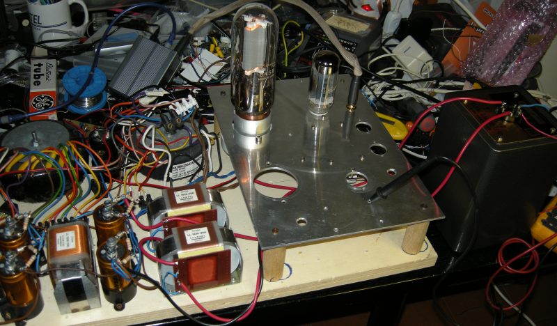

Finally the first test result using 6HV5A to drive 845
6HV5A loaded by 20H (Rdc=70ohm) and Rk=100ohm Ck=220uF
950V 28mA
845 loades by Tango X-10S 10K/8ohm Vg=150v Rg=22Kohm
950V 100mA
10Vrms on 8ohm with 2% thd
Interstage 2.2uF // 0.33uF Audyn-Cap Plus
Very good sound
Very good voltage gain
Power can be increased using 1100V instead of 950v
Soon next test and photos

This amplifier is in develop phase so some changes will be necessary to ear the final result.
In a first comparation test yesterady evening I like very much the sound of this new amp.
The my 845 amp. use Jensen copper film paper in oil interstage and this new two stage 845 use a MKP cap so a real comparation is not possible.
The my 845 amp. use Valve Art 845 and this new two stage use 845 Shuguang.
So a real comparation at this time is not possible but I will do this in the next weeks.
