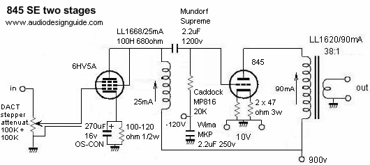

Not to distract too much from the discussion on your 2 stage 845
amplifier, which is a cool concept as is the HV pulse regulator triode
as a high mu driver (gm=65,000) and this one has a nice low Rp.

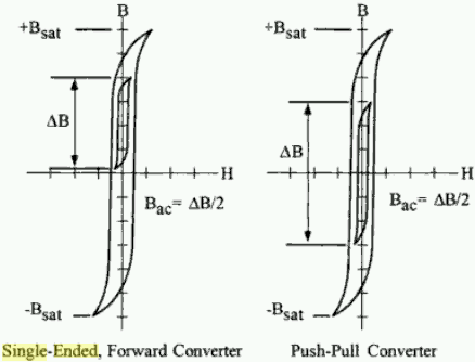

But since you brought it up, the notion of this magnetic "zero crossing"
has me intrigued. I refer particularly to the "kinked" dashed line in
figure 4 of the article you reference above.
The thing is, my own experience with magnetics doesn't support
the existence of the kinked curve as a magnetic operating loop
of a core in any transformer. I'm not saying it doesn't exist, but
the only place I've ever seen it is "penciled in" on a B-H diagram
to explain the deficiencies of a push-pull audio output stage.
My understanding of what's happening is more like the diagram I
attached from a magnetics text. The outer loop is the saturation
loop, going to saturation at each end of the loop. It's a characteristic
of the core, frequency, etc.
The inner loop, or minor loop, is the actual signal drive at a particular
level below saturation. There is no kink in the middle of either SE
or PP minor loops shown. As I understand, there is no kink in the
middle of any minor loop. The hysteresis occurs at the ends, and this
is where the direction of magnetization reverses (not in the middle
where the polarity of the drive voltage changes). This is as I
understand because the flux changes when the direction of the
voltage changes i.e. positive-going to negative-going and back.
The article you reference also seems to have some inconsistency
in the use of coercive force with more common usage as synonymous
with field strength H. I think there is also some confusion between
hysteresis and small-signal magnetizing current.
I do believe there is a difference between SE and PP due to the
effect of the air gap, and I would recommend Menno Van Der Veen's
2007 AES paper looking at small-signal permeability within the region
of the core magnetizing current. To summarize, he suggests that a
larger core with an air gap, as necessitated by the SE transformer
design, holds it's relative permeability down to smaller signal levels.
Perhaps because the gap lowers permeability to start with?
Higher permeability at low signal levels means higher inductance
and lower distortion, which gives better preservation of low level
detail. There are other ways to mitigate the low level issue like
core material with lower remanence, lower Rp of the output tube.
But basically that effect would be extreme widening and squaring of
the minor B-H loop for very small signal levels, resulting in distortion
and loss of low level detail, as opposed to a kink in the large signal
B-H loop.
At least this is my current understanding.

Hi again Andrea,
No, not quite. Do not use a PP! I propose a LL18mA but to compensate with reversed current through the secondary(it is all in the schematic).
So if you have this 18mA SE and want to run 25mA through it you have to compensate with something like 10mA in the opposite direction through the secondary. The net current in the core will then be below 18mA!
I guess the optimal compensation current and airgap will have to be determined through tests.
You can find more info on Dave Slagles www.intactaudio.com forum in the "current cancellation" section. He has also come to the conclusion that the gap should not be eliminated in the purpose to get max inductance.
Did some sims and these also shows that at least 100H should be used but preferably more. So maybe a 10mA Lundahl with 15mA compensation?
By the way both Michael and I have lately participated in threads in this section and also made experiments with mainstoroids as both OPTs and ITs. Then there is no other option but to treat them as PPs.

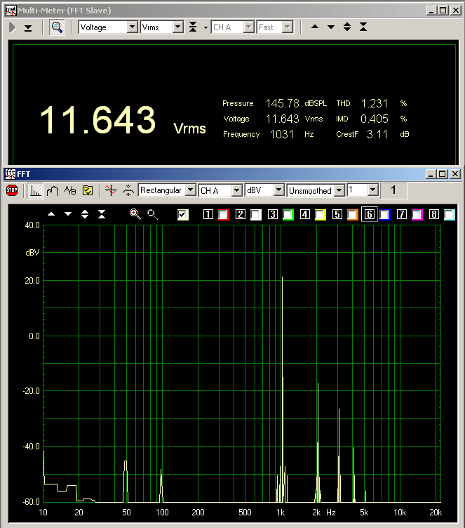

If we consider a max 90w to get a long life time of vaccum tube and with 1100v the bias should be Ia=90/1100=81mA.
Yesterday evening at 950v I have measured half distortion with 100mA than the value at 80mA so before decide to go to higher voltage it is necessary a test and other measurement.
Use different power supply voltage for driver and output stage is possible but this will increase a lot the cost.

I totally agree about a "part of signal". But the way I see it, it will not cross before the AC-signal passes the standing 18mA DC-current. So if bias is set to 25mA it is the last 7mA that maybe could be a problem. And at what signal-level is that with the 6HV5A?
I read the article and it is mentioned that the good thing about SE is "more coherent and more detailed than PP at low volume". So i think this virtue should then be kept with a current compensated transformer like above.
So which is best, a choke and a cap or a compensated SE? Think this is up to the builder/listener to judge.
I´ll make my friend Hoktuna try this theory in a GM70 together with 6C45 and a 18mA LL1660 we are planning. For what we have heard/read the 6C45 is happier with a standing current well over 20mA.

In a first comparation test with my 845 ver. 3 (beta release) the sound of this new amp. is more clear and detailed.
This evening I have replaced on both the amplifiers the interstage capacitor with a Mundorf Mcap Supreme silver/gold/oil 2.2uF 1200Vdc.
The Jensen copper film paper in oil add some bad effect on sonic performances.
After this modification the sound of these two amps. is very similar and it is very difficult to decide which is better so I will wait some my friends to have an objective result.

Hi there
Ciao Andrea
You should try a monster beefy SE IT made by Bartolucci
http://www.ricercaesviluppo-fano.it/it/index.php?option=list&cat=7
called INT6 (or maybe INT3 ) :
INT.6
7000Ω
80mA
15W
100 Hy
203Ω
Ω
3Hz / 42kHz
4,2 Kg
Are these measures real?
Probably it's bigger than your little swedish OPT.
regards

Never tested Bartolucci products but I have read good comments about these transformers.
Actually I use only amorphous cores by Lundahl because there is a good increment in sonic performances if compared to the same model with normal core.
So it is impossible to know if is better a normal core like the Bartolucci INT6 or a choke+good cap. on the signal path.
I will ask to Lundahl the possibility to develop a new interstage with amorphous core SE to get 100H with a gap for 30-50mA.
This transformer could be used also to make test using 2A3 like driver.

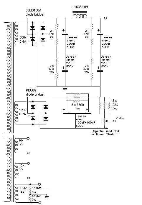

Some notes about power supply used.
As diode bridges could be used KBU8M or UF5408 in the same configuration.
Someone add little caps in parallael to diodes to reduce the noise created by current peak generation.
The separation of transformers (filaments and anodic) is suggested only if you think to use in the future dc filaments because in this case the peak generated on diode bridge create noise and this will arrive amplified on anodic secondaries.
The anodic voltage with these caps. can be used for both channel but off cource a separation will give the best result.
If you will separe the anodic it is possible reduce all the Jensen caps to 100uF instead of 220uF.
It is possible use the same anodic secondary and separate the channels with 2 choke.
The Jensen electrolytic since to be very good but it is possible use Solen 50uF 1500v MKP or new Mundorf 100uF 550v Tubecap in series.
The drive both channels the bias circuit need another Spectrol 534 trimmer and another set of 3 x 22kohm resistor to set the rigth bias for each 845 and separate the grid.

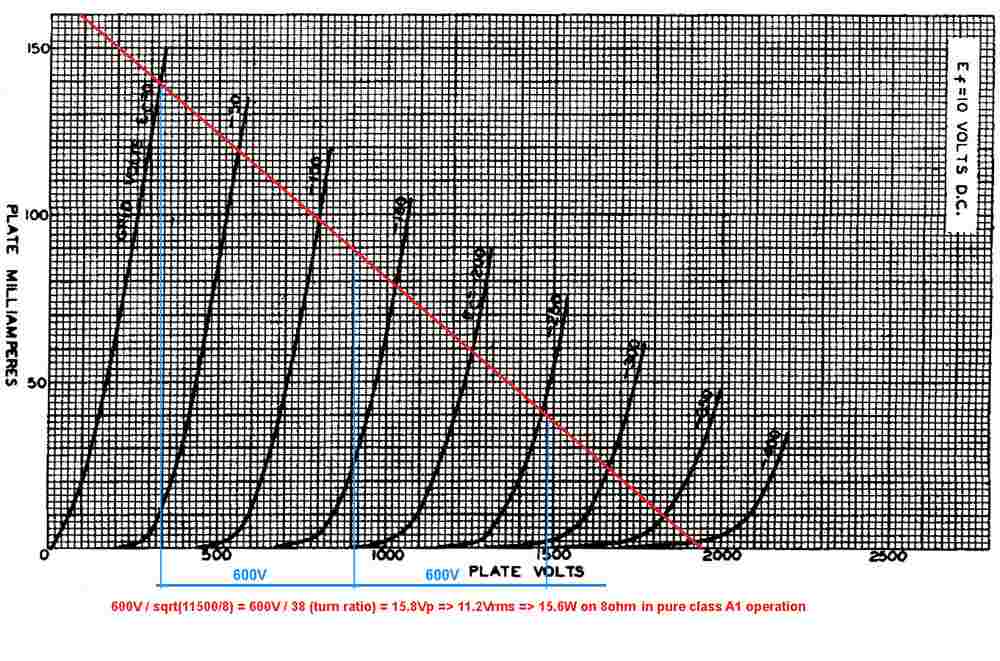

Andrea,
with a bias pont at -120 vdc, at the best you can have 240V pp to drive the 845; this means that you can have 11 Veff on 8ohm=15 Wrms.
The problem, for me, is that with 6HV5 in this configuration you can loose some signal due the output impedance of the stage with the load 20k (the grid resistence of 845) .
With the Gomes ( for me is a single stage) you have a very low output resistance that can drive without problem the grid also in A1; if you have mesaured 0,13 mA, with Gomes you can reach about 20 time more the current.
For A2 i have some doubt also with the 6HV5.
Ciao
Walter

Here the output characteristics of the 845 tube with load line at 11500 ohm and operation point at 90mA 900V.
Plot the load line is simple I=900/11500=0.078A=78mA so to find the upper current point of the line I=78mA + 90mA = 170mA.
The calculation of Walter is correct but the power in these conditions is the same for any kind of driver.
Some peak on A2 will allow to increase a little the power if the driver will have enougth bias current.

Here the last measurements
Vp=1000V
Ia=90mA
Rg=50K MK132 Caddock
Ci=2.2uF 1200v Mundorf Supreme
Rk=100ohm
Ck=220uF
La=20H to modify to 100H
11.6Vrms on 8ohm with a perfect distorstion decay
Pout=11.6*11.6/8ohm=17W
-0.5db at 20000Hz
-3.0db at 25Hz with 20H so 5Hz with 100H
