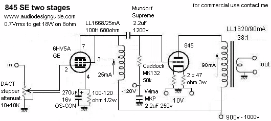

ATTENTION:
It is necessary change the input stepper attenuator to 10K because otherwise the frequency response will be limited due to the input capacitor of 6HV5A.
This mean that the input impedance of this amplifier will be 10K.
If you decide to use 1000v instead of 900v is not possible use only 2 x 500v Jensen electr. in serie but you need 3 items in series.

You need only 0.76Vrms as input to get the max power 17W (11.6Vrms on 8ohm) so the voltage gain is
11.6 / 0.76 = 15.26 => 24db
Any CD Player or phono-preampl. can drive it directly without a preampl.
Rout about 2ohm with 10K (Tango X10S) load on 845, 1.7ohm with 11K5 (Lundahl LL1620/90mA AM)

Using 47Kohm in series to the input the band is reduced to 10KHz at -3db so it is easy calculate the input capacitor of the 6HV5A.
Ft(-3db)=1 / (2 * 3.14 * C * R)
C = 1 / (2 * 3.14 * Ft * R) = 1 / ( 2 * 3.14 * 10000 * 47000) =
340pF
This value probably is less because I don't have considered the output impedance of my mesurement system (Clio System).
so with 10K stepper attenuator at the lower position we have a band about
Ft(-3db) = 47KHz
and with 20K
Ft(-3db) = 23KHz
I suggest 10Kohm stepper attenuator but also 20K can be used without problem because only at the lower position the band is limited to the 23KHz.

Output impedance near 2 ohm is the best value possible with single ended amplifier without feedback.
To get lower value it is necessary reduce to much the output power.
Many commercial vacuum stage amplifiers have value about 3 ohm and declare a double power with these same output tubes.
All the 300b amplifier using 3K load transformers have on putptu impedance about 2.5 - 3ohm.

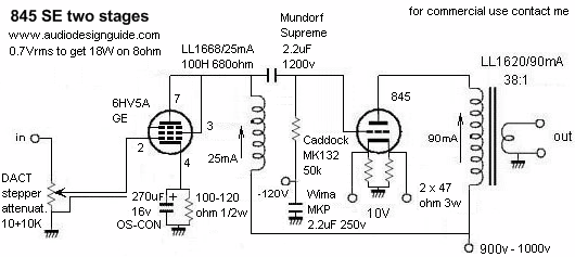

audiodesign said:Just to post last schematics.
How does that filament work with no voltage?
audiodesign said:Galon,
What you mean ?
There is a mistake in your schematic that shows the 845's 10V filament supply shorted directly together and to ground. The 10V connections are just drawn in the wrong spot.. 😀
Hi Andrea,
I have seen that you changed some valueas on schematic.
Regarding the input, as our telephone conversation where I asked you the Cag of 6HV5A (there are no spec on data sheet) because with a gain of 150 I supposed (for the Miller effect) the input cpacitance was not low and you calculations are good.
Regarding the grid resistor of 845 now I am almost agree with you.
What I have seen on specification of Lundhal 1620 is the max Vrms at the primary with the configuration you choose; it is reported 380 vrms ( is not specified the frequency, unfortunately), this means that with a ratio of 38:1 I must have 10 Vrms at the 8 ohm load (about 12w rms), this can be a limit.
Another possible limit is the current suggested for this trafo, 80 mA (for the configuration you choose); it seems too low for this application.
The problem is always handling a great current swing at low frequencies.

Lundahl on the LL1620 datasheet declare a max primary voltage of 380Vrms at 30Hz (13W on 8ohm) but I have demostrated many times on my projects that this value is not a real limit.
In any case with a real loudspeakers connected to this amp. you can get many more power because the impedance will go to lower value and the same LL1620 can give 25W on 4ohm.
The Lundahl transformers are semi/custom so you can order without problem a LL1620/80mA, LL1620/90mA and LL1620/100mA.
The inductance value of the primary on LL1620 must be considered if you change current (gap) but it is simple to calculate.
