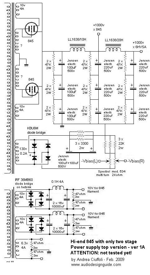

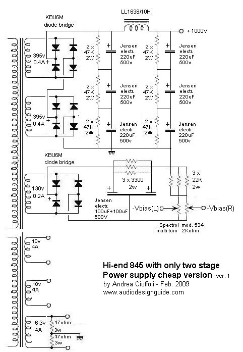

audiodesign said:1000v power - top version - not tested yet!
Andrea,
Please DO NOT use rare and increasingly scarce 845's as rectifier tubes!!!! You are far better served using a pair of 866A mercury vapor rectifiers or the Xenon equivalent 3B28. You could also work very happily with a pair of single diode per envelope TV damper rectifier tubes. They would give you an automatic time delay on the B+ which would help increase the life of your 845 audio finals. I would also recommend that a choke input filter be used if the plate xfmer secondary voltage may be chosen at will as this will provide superior B+ stability. A bleeder R of sufficient wattage rating to handle 20% or so of the supply power (good design practise) is needed with a choke input to avoid skyrocketing first voltage, then droop as the load comes on.
Your project is very inspiring! I may use the 6HV5 or 6JD5 to drive another DH ouptut tube sometime. I do not have any 845's. I would have to find a couple of lumps of iron in my junk box that would work well enough as I.T.'s.
Do you happen to have any 6JD5 beam triodes that you could also run in your circuit (drop-in equivalent) and try the distortion analysis? I have both and wonder if one is marginally better than the other in this unique application.
Bob,
have you some models about the single diode per envelope TV damper rectifier tubes ?
I have tested GZ34 NOS and new with good result but these cannot be used in this case for the high voltage, to check if in brigde connection are good (like Audionote Ongaku).
My experience with 6D22 is terrible, many many diodes in fault after few days in normal conditions.
