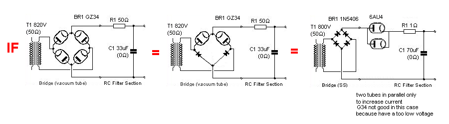

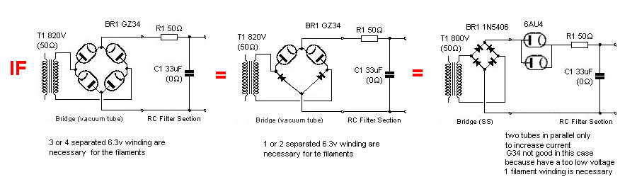

We must consider 2 elements in the power supply design with vacuum tubes:
1) vacuum tubes with cap anode is dangerous
2) using full wave single diode power supply we will have a very high voltage in the amplifier 2 x 800 volt so 1600v that increase the dangerousness level
P.S. in any case I am not sure that vacuum tube diodes make a difference in the sound

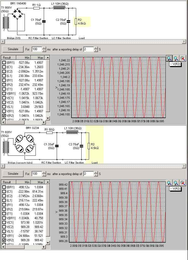

Here 2 simulation with the usefull tool PSU Designer II by Ducan Amplification

Andrea,
This is a good technique which I employed to get much greater B+ voltage (620 V B+) from my xfmer while still using only a single 5V4 rectifier tube in my low power SET A2 amp. I was not suggesting that you use this circuit.
The damper diodes I suggested do not use anode cap connections. Granted, the 866's and 3B28's did. I agree wth you they create safety issues.
What I did suggest was that you make either a two diode solid state employing xfmer CT full wave rectifier, or a solid state full wave bridge and then run the DC output, unfiltered yet, through a pair of 6AU4 TV dampers in parallel (they are only good for 190 mA MAX each) to give it time delay. The choke input to the supply filter goes to the two 6AU4 parallelled cathodes. Isolated 6.3 VAC filament winding for the two 6AU4's was recommended. You could probably even use the very common 6AX4 as you are paralleling two damper tubes here. Should check specs on that.
http://www.mif.pg.gda.pl/homepages/frank/sheets/137/6/6AX4GT.pdf
Only good for 125 mA per tube. That is still enough for you but close to the limit. 6AU4GT is WAY better.
Socket pinout is the same so you could upgrade any time.
With the choke input (5-10 Henries) you can use a large filter capacitor without worry about damaging the vacuum tube rectifier damper diodes. I am going to guess that is how you destroyed your 6D22's. Too much electrolytic cap hanging directly off the 6D22's.

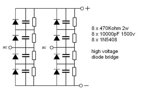

single 1N5406 are not good for 1Kv output
the schematic is only to see the different connections

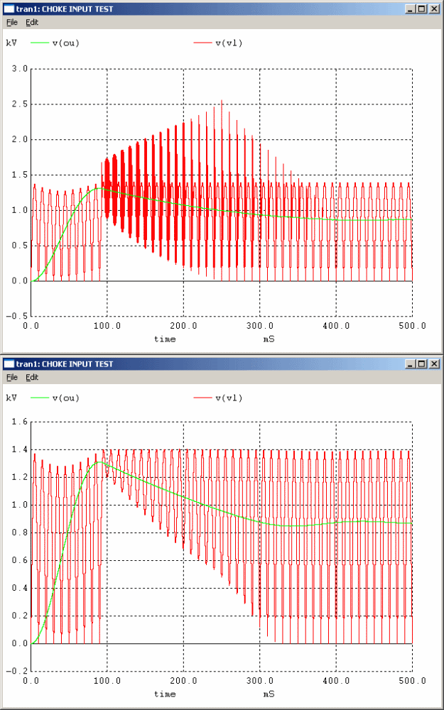

I have calculated the RC network to add in parallel to the choke input with these formula:
2*pi*F= 1/sqrt(L*C)
if the frequency is 50Hz after the diode bridge we will have 2 x 50Hz = 100Hz
2*3.14*100 = 1/sqrt(L*C) so
sqrt(L*C) = 1 / 2*3.14*100 = 1 / 628
L * C = (1/628)^2 = 2.5E-6
C = 2.5E-6 / L
if L=8H C=0.31uF
Here the Winspice simulation output of a simple choke input power supply with and without the RC network.
It is clear that the RC network is necessary to prevent high voltage spikes in start-up phase (second plot with RC).
vl = voltage after diode bridge
ou = output voltage
For RC network I have used a series of 100ohm and 0.31uF in parallel to the choke L=8H Rdc=57ohm, filter cap. 100uF load 5Kohm

here the schematic of the discrete diode bridge to use using a transformer with a single secondary at 800v

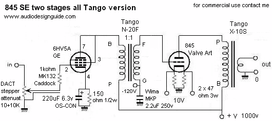

Here the final all Tango version schematic.
the measurements has been sent in a previous reply.
17W on 8ohm with 1-2% thd
necessary 0.5-0.6Vrms to get max good output.
sonic peformances comments soon.
to get the max power I have set the bias to 90mA Vg=133v but the Tango X-10S has been design for only 70mA.

I have used input choke in design with lower voltage like this one:
http://www.audiodesignguide.com/my/pse3.html
I suggest this design if you have medium-high loudspeakers (95-100db) or little room because the output power should be about 4-5w.
