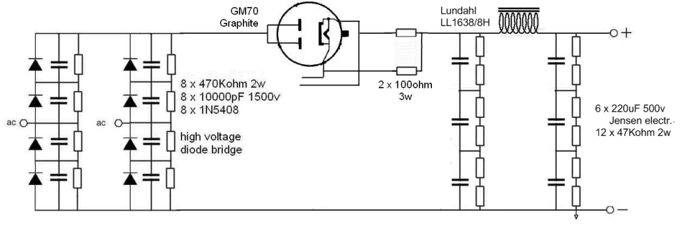

This evening the first test using the GM70 Graphite like diode in the configuration of the attached image.
1000v without the GM70
940v with the GM70 like diode
Until now I don't see problems.

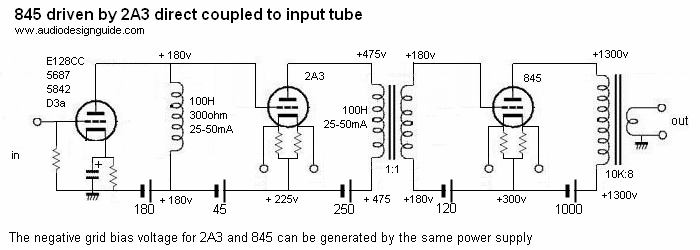

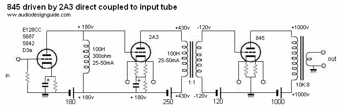

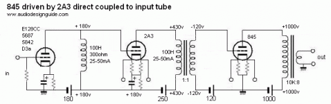

The idea of this evening.
845 driver by 2A3 direct coupled to the input tube.
This allow to skip the strange 6HV5A TV vacuum tube but it mantain high performances with a very short signal path.
This is not a final schematic!

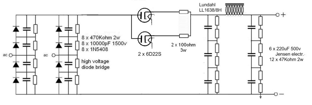

Power Supply sonic perfomance test, 1 is the best
1) dual 6D22S after the solid state diodes bridge
2) no vacuum tube diode after the solid state diodes bridge
3) single GM70 after to the solid state diodes bridge
with the GM70 the sound is too smooth, with 2 x 6D22S the sound since to be more natural
In dual mono configuration will be necessary only one 6D22S per each channel

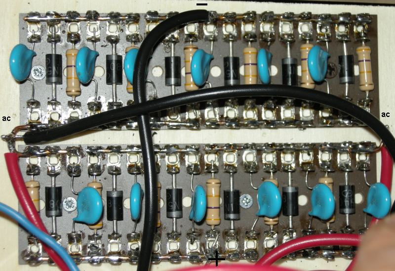

I never ever understood why one should use a vacuum diode after a full SS bridge. Would a mixed bridge (SS+tube) be "better"?
The mixed configuration can give the same sound with less tubes
http://www.audiodesignguide.com/Claudio845/VTPS_solutions.png
I cannot understand in the schematic sent the meaning of the 10MK after the solid state bridge and before the 6d22s.
One note: the difference on sound of combination 1 and 2 are very little and probably it is possible get the same result with the 1 adding a resistor before the first cap
