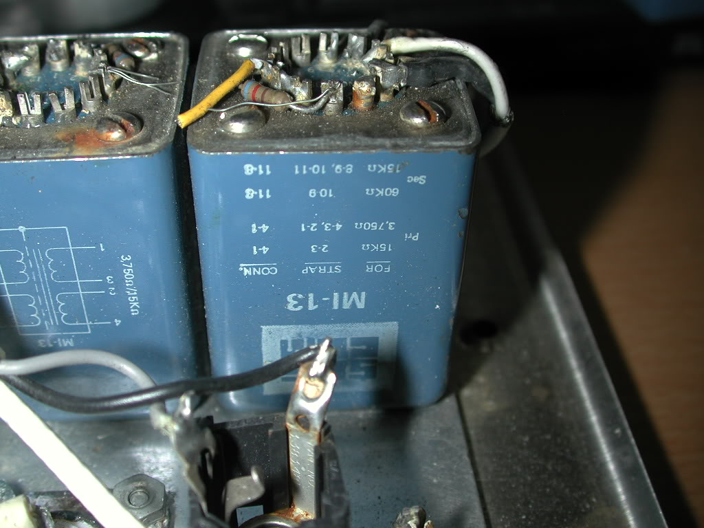

Hello
Can I use these interstage transformer to drive my GM70 tube with D3A or with any other tube..
2 X SESCOM MI-13 INTERSTAGE TRANSFORMER | eBay
Unfortunately I can't afford to go with Tango interstage, I live on disability support unfortunately because I had car accident with bike.😱
I try to find some solution so I can put together my GM70.
Any help, comment welcome!😉

I think those would be worth trying if you have them, provided you aren't planning to run the GM70 in A2. With A1 you won't have to worry about DC current in the grid winding.
Hello
Thank you for your reply!
I do not have them but I can afford these or similar price interstage.
I want to be sure if I invest in them I can use them.
15K:15K a bit to high com pare to the 5K Andrea uses, I don't know.
I'll wait on more opinion. Or may be someone know better solution (what would feet better these amp)
Greetings gabor

Hi!
They don't seem to be able to handle DC in the primary, at least nothing printed on them. Given their size they are probably not meant for DC. So they wouldbe good for parafeed drive only.
If you ask me for my opinion: use another tube. The D3A is a poor choice as a driver tube for transmitting output tubes IMHO
Thomas
Thomas

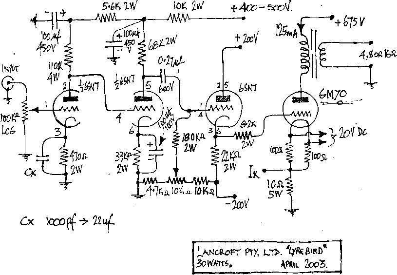

Hi!
If you follow my posts on this forum, I'm advocating good headroom. At least 6dB. That means the driver tube should be able to deliver twice as much voltage swing as is needed to drive the output tube to full power.
Also keep in mind grid current effects start to kick in at bias voltages smaller than -1V. If you want to stay clear of that range, the available voltage from the D3A is limited.
Of course it all also depends on the op point of your ouput tube, that determines the required voltage swing.
Also depends on your gain requirements
This is a general choice which you probabaly should make together with the other points above to be able to determine your driver tube.
You can check the schematics on my blog for some ideas, especially the 211 amp schematic, which uses a 6HS5 driver
Thomas
What would be your advise as a driver tube?
That would need interstage or with out?

Hello Thomas
My plate voltage will be 900V, it is still OK to go with6HS5 tube.
I see U use Lundhal interstage, I think a pair of that I can afford.
I will study your amp after your answer about the 900V plate voltage.
I have some D3A at hand , also I have some12GN7A tubes. I won on ebay 4PC Sylvania 6HS5 tubes for $1 plus shipping. After I study Andrea amplifier with these tube I ask the seller to cancel the purchase.
I see U use stock Lundhal interstage not some special like Andrea.
Do you think with 900V plate voltage on GM70 I can drive with these tube?
Now is early morning 2:48 in Toronto, tomorrow I will do my home work.
Greetings Jeno

Hi!
Yes it would still work at 900V. Cathode resistor might need some adaption.
Also if you want to drive a GM70 I would not use the 4.5:1 step down ratio I used, but 2.25:1 which the Lundahl also offers. This is because you need a higher voltage swing at the grid compared to the 211.
The 2.25:1 step down will still provide a good low driving impedance of about 1kOhm and have good headroom.
You can contact me about parts for such projects I have most of the stuff available.
Best regards
Thomas
